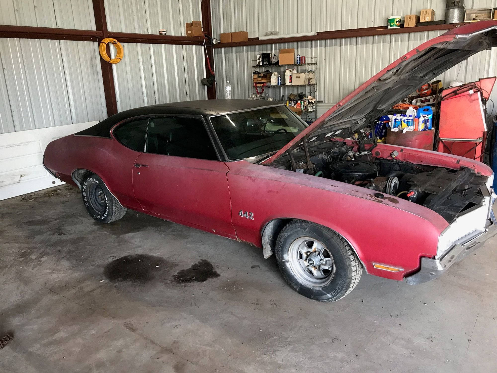

Hi all,
I just purchased a 1970 Olds 442 2 door coupe with a 455, A/C, 3:23 gears, posi, automatic TH400. 17,678 original miles field find. The car was covered but needs a lot of tlc. I just had all the bushings replaced, added posi, new ball joints and rebuilt the entire front end, new brakes. It has E heads cast intake and Rochester 4 bl. It was leaking oil everywhere so I replaced all the seals and gaskets. I put in a MSD HEI distributor, now it runs great but is lacking a bit of HP.
I want to put on an aluminum intake. Any suggestions?
Also I need to replace the dual exhaust, I am thinking 2.5" stainless using factory exhaust manifolds. It sounds like headers have issues. The factory cam is a 435/435 lift. This is not a W-30 can anyone recommend a higher lift cam? I think the W-30 cam is 228 degrees with 474 lift. I really want more performance
Also do you think a 700r4 or 200r4 is worth the expense?
sure would appreciate any help

Nice ride. You have come to the right place. Looks like the car has aftermarket a/c.
Not sure about aftermarket heated mirrors but I've never looked for retro fit modern mirrors.
3.23's are good gears, 200r4 will bolt up with minimal trouble. Other OD trans' will require more work.

17678 miles? Really? How about 117678 or even 217678?
Do not use the W-30 cam. Modern cams offer far better choices. Match your cam to the gear and compression ratio. Performer 455 is a very good option for your build but you need to choose all the pieces to work together. Headers add performance and are only an issue if you buy the wrong header. Use quality gaskets like Remflex and good fasteners.

Thank you for your input, I really appreciate it. Are roller cams and lifters worth the money?

Edelbrock Performer vs Edelbrock 04B
Hi all,
I have a Edelbrock 04B aluminum intake manifold, A friend wants to sell be a Polished Performer and Polished Holley Carb w/ an electric choke. They are both new in the box. Is the difference between the two manifolds noticeable? The Polished sure looks nice but nice looks seldom equal great performance. Will either fit under the hood. My 70' 442 has a stock 455 in it. It has a 4 core brass radiator in it, with a Transmission cooler. would a Aluminum 4 core be better?
So much to learn, this is a fun project.

This is just me, but with those low miles documented I'd keep it as original as possible. That goes for the carb, intake and radiator if they're functioning or could be restored to function well. Each of these items have a code showing them as correct for your 1970 442. If you do decide to change things I'd keep the original parts and store them away so it could be changed back someday if you decide to.
The four row radiator is the heavy duty option and cooled the 455 adequately when the car was new and being driven back in the day.
Would you take a picture of the trim tag on the firewall to share with us? That's located on the firewall under the hood, near the brake master cylinder.

Cutlassefi Dyno tested the OB4 and Edelbrock Performer along with others. The OB4 was the bottom of the barrel, get the Performer. A Roller cam will provide better vacuum and power with more lift for a given duration and no worries of flat lobes. Cutlassefi is the guy to contact for cams.
