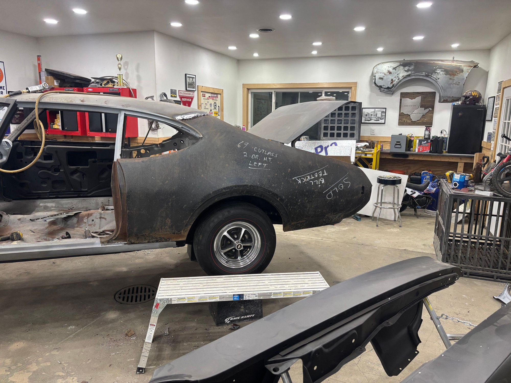

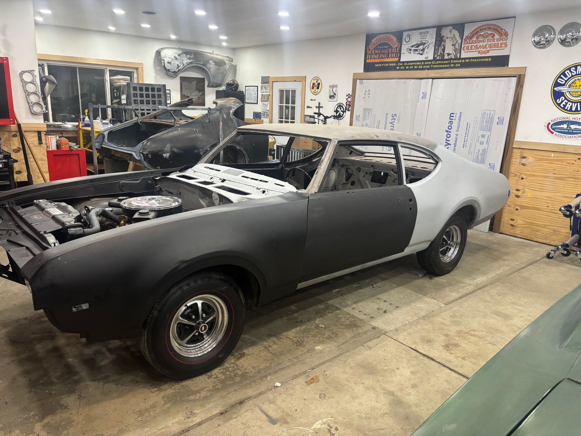

It was fun for me to build my w30 and share it with everyone on this forum I couldn’t wait to start another project. I recently acquired a 69 F85 W31, it is the Dick Davis race car. This car is very cool, it has a race history and was in Muscle Car Review Magazine as a barn find. After i finished up my w30 i was searching for the next project and came across this car on Facebook. And thought it would be a cool car to add to the collection. The previous owner Tom spent the last 7 to 8 years doing research on previous owners, collecting hard to find parts and putting his blood and sweat into this car. I was lucky enough to acquire and continue the project. This car has a cool story and my intention is to restore it back to the first day Mr.Davis brought it home. The goal is to have this car complete and in the Mcacn show in 2027. After going to the show this year I got extremely motivated to get moving on this project. The car was previously at mcacn in the barn find section in 2017 so it would be awesome to go back 10 years later good as new. My brother James, the guys from the you tube channel Auto Refinery Steve and Joe as well as Tom will all be apart of this car. As always your guys opinions and criticisms good or bad are great motivators for me thank you in advance. Check out some pics

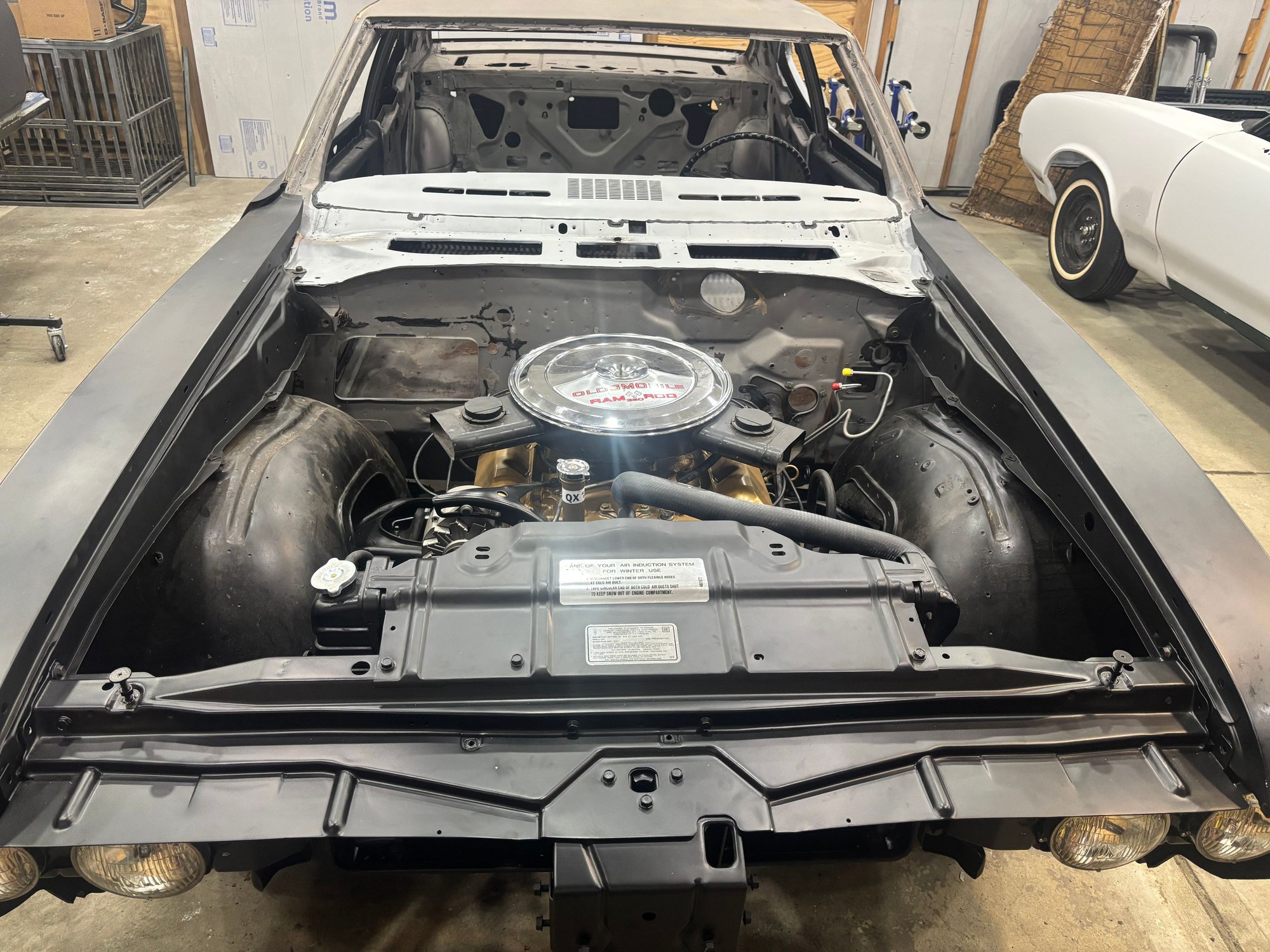

Great to see another one getting saved. I really enjoyed following your last effort so it'll be fun to see this take shape. What trans and rear gear was it born with? Also, any idea why it doesn't appear to have the scoops in any of the period photos?

Not sure about the scoops, i have 2 pictures from the day he brought it home one of the engine bay which it has the hoses for the scoops and a side shot. Car was born with a m20 and 3.91 rear gear
Looks like they might have been in the way of the tow hook mounts.

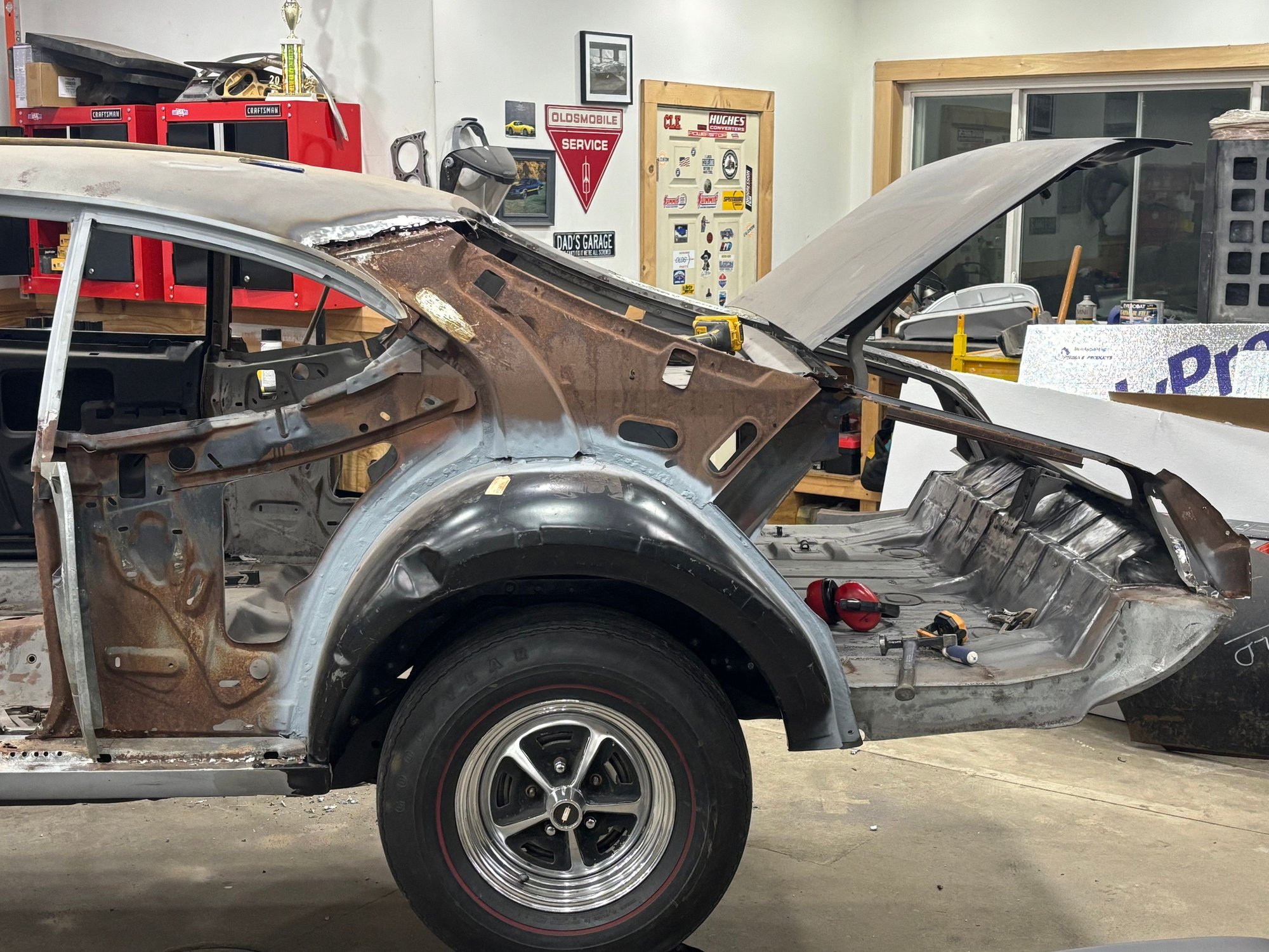

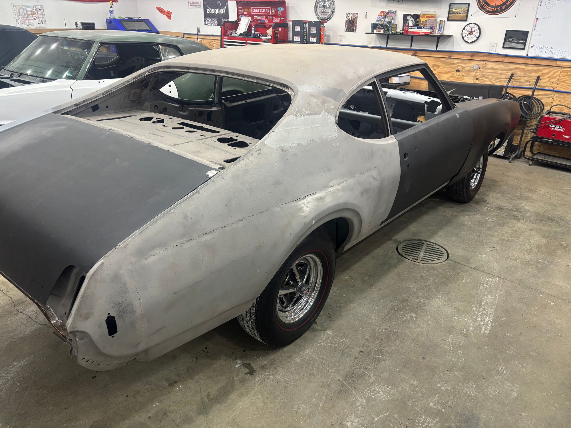

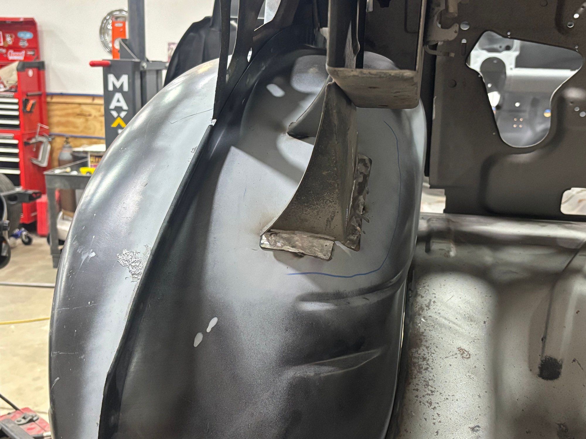

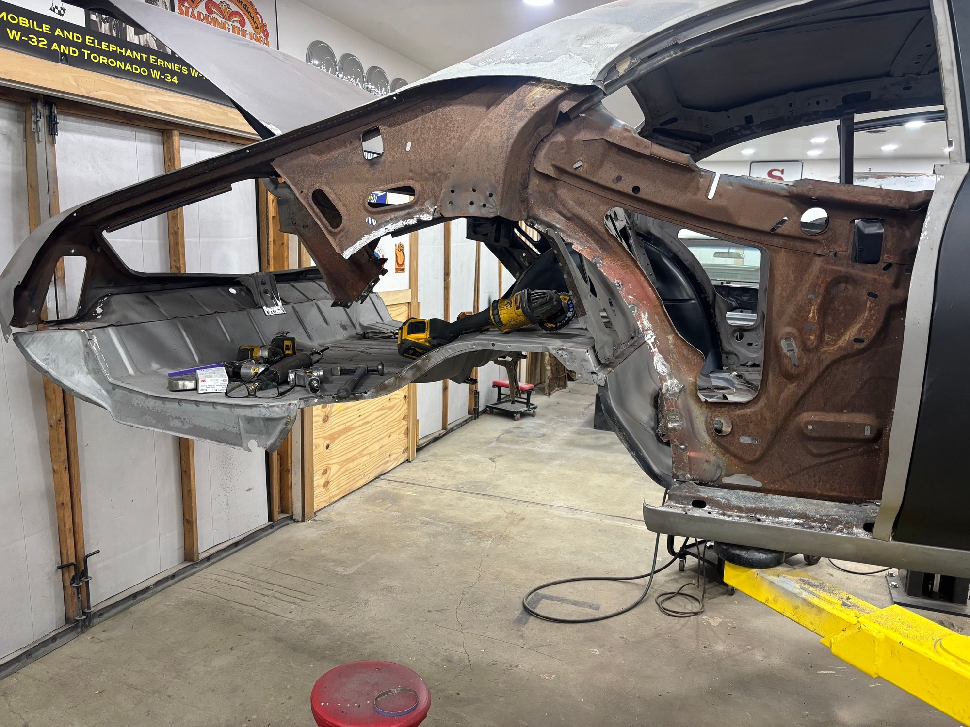

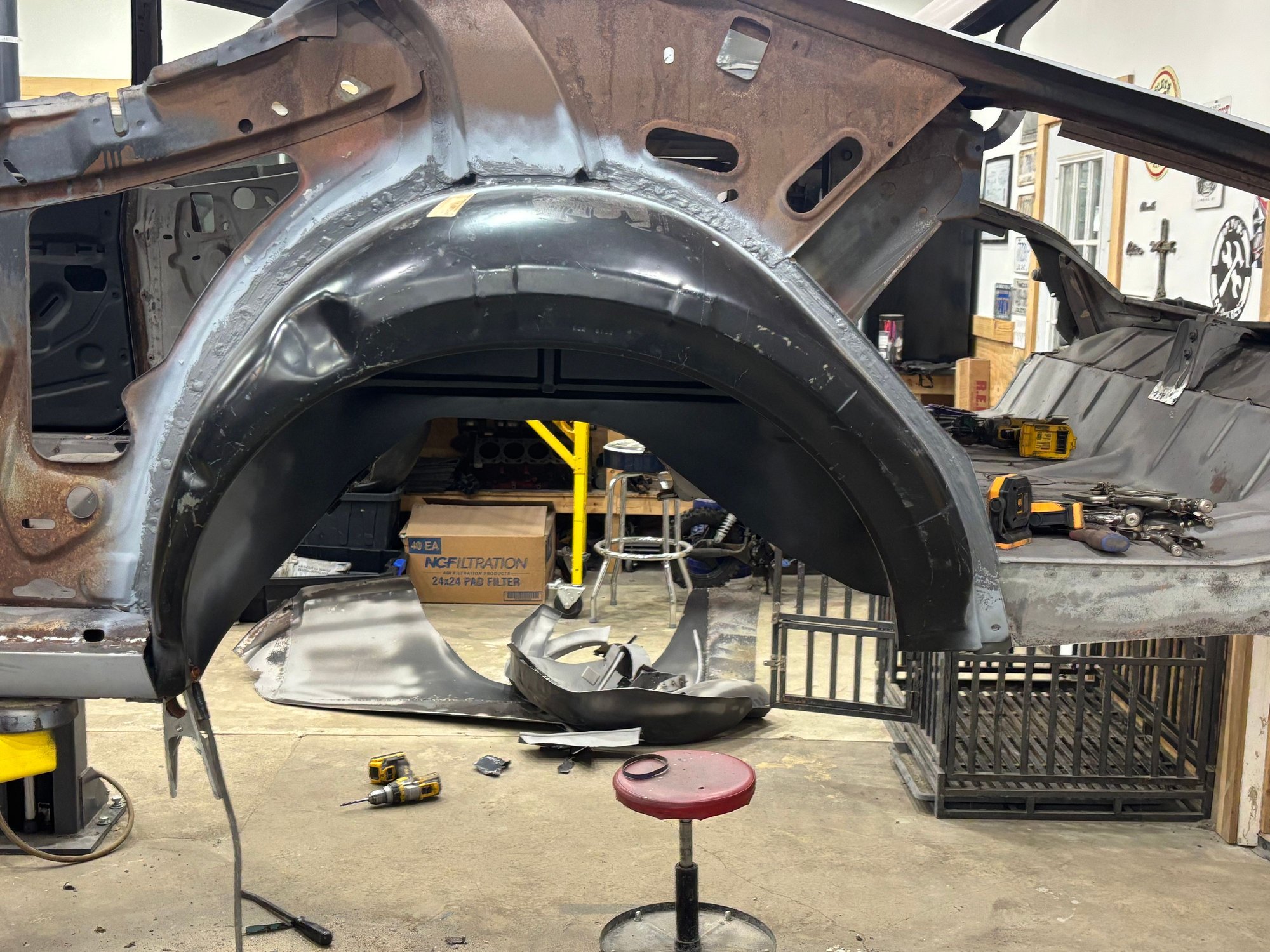

I got a few things done this weekend until i ran out of welding gas. Im gonna replace both inner and outer wheel houses they’re pretty boogered up. I have nos outer wheel houses and i got the inners from parts place, I also have a set of nos quarter panels that ill be installing on the car. My goal is to have both quarters installed by New Years. Here’s a few pics

Old Dec 18, 2025 | 07:14 PM
nick@wri-net.com's Avatar
Weav2-69s
Joined: Mar 2021
Posts: 241
From: Doylestown

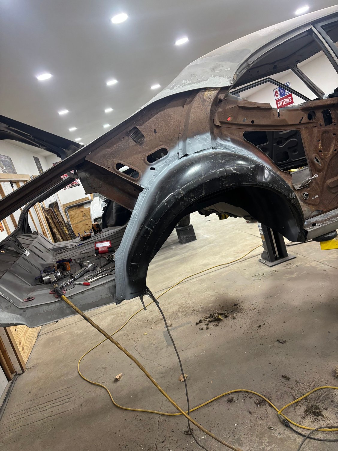

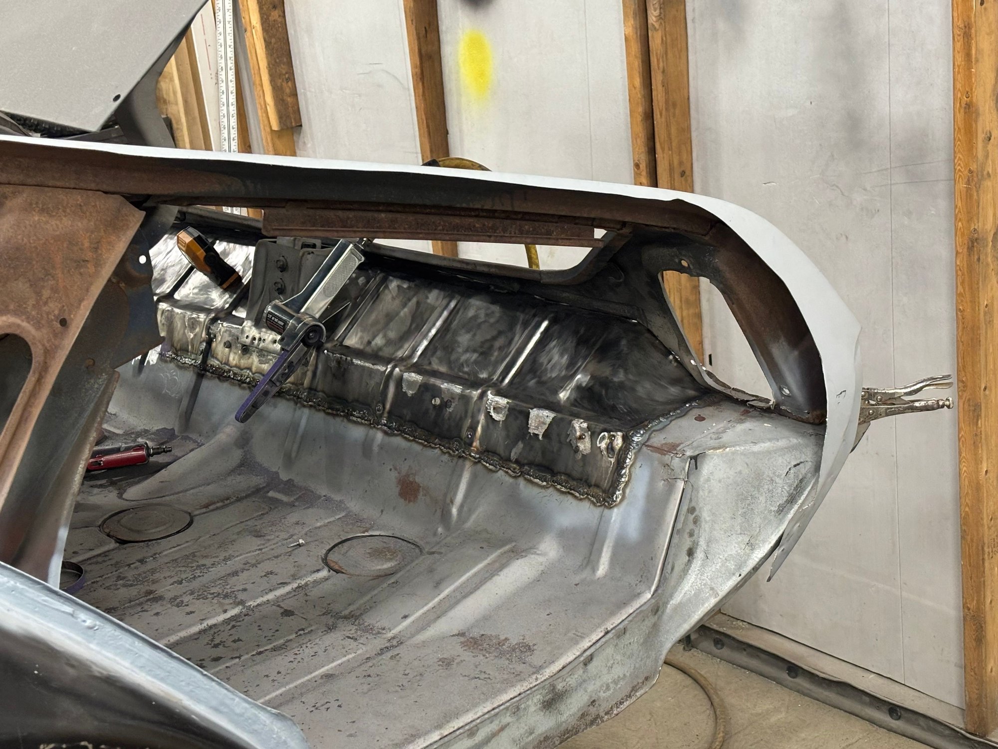

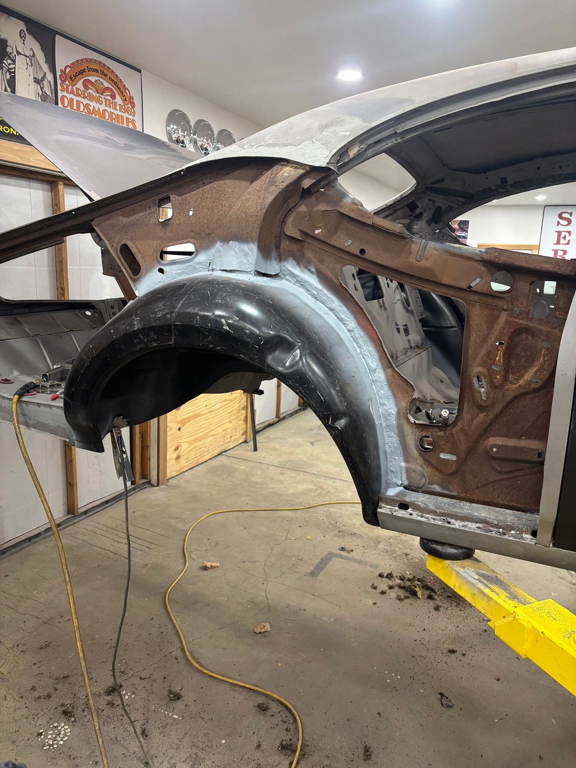

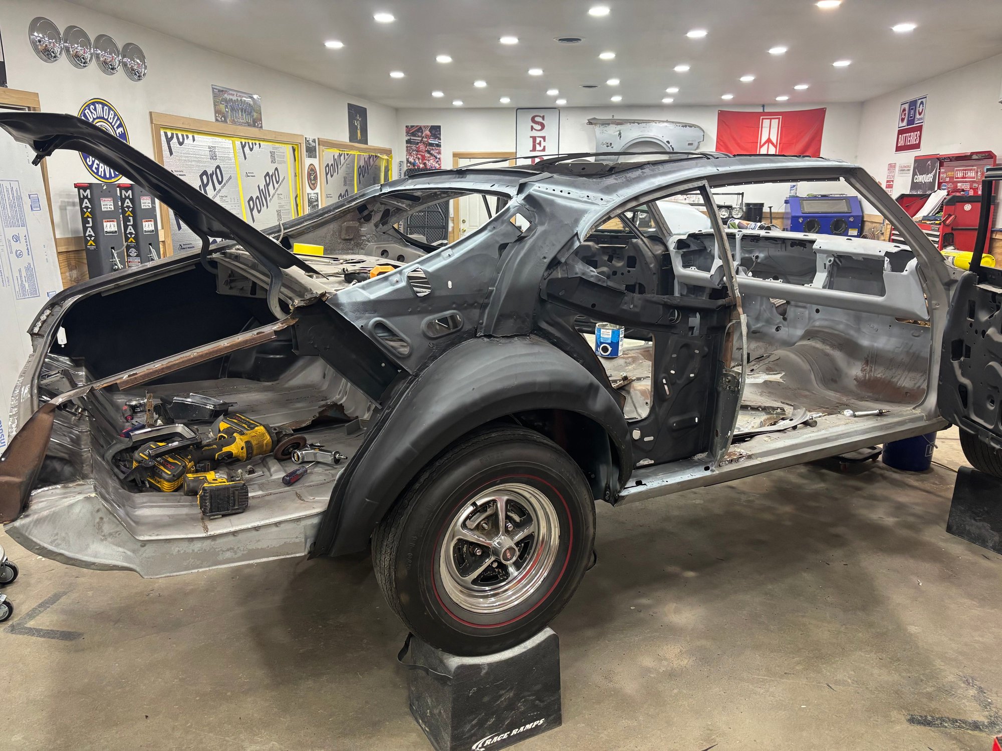

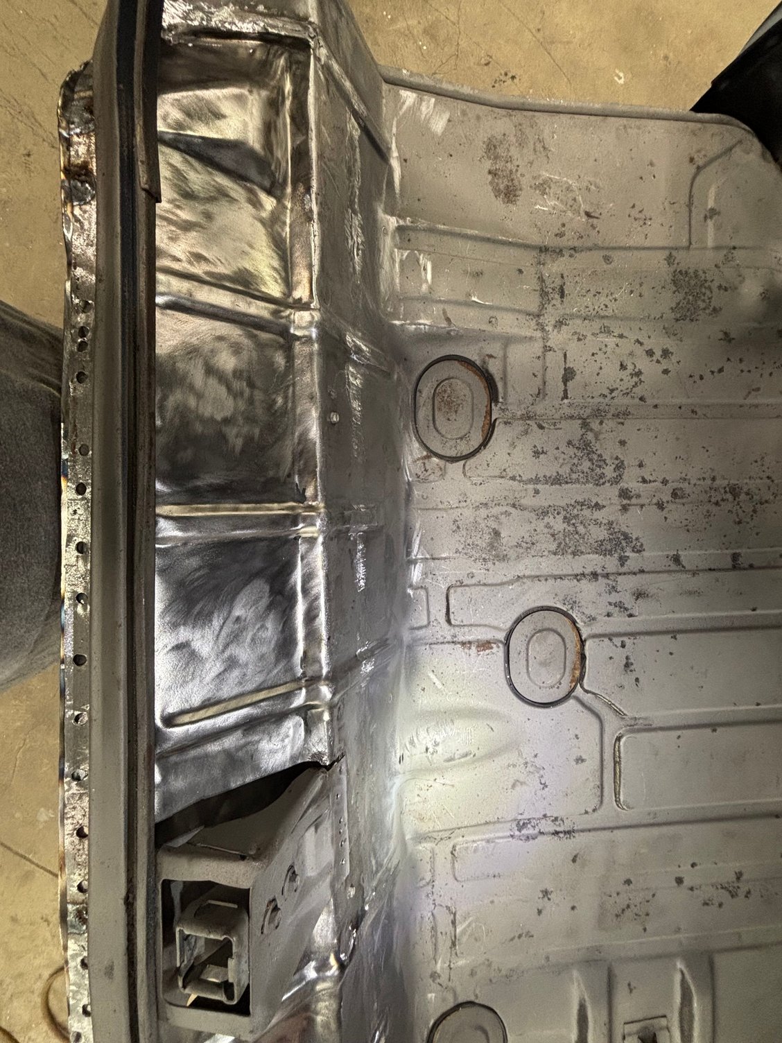

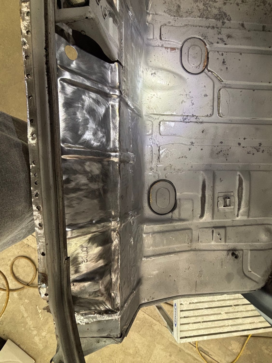

I got the driver side inner and outer wheel house installed and welded in, also got the passenger side cutout and started prepping it. Passenger side was pretty ugly compared to the driver side. Here’s a couple pics

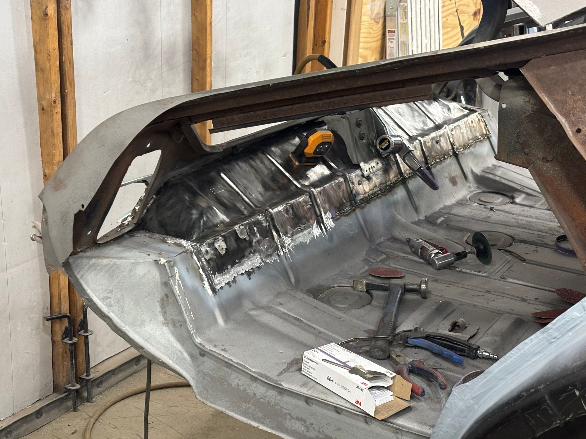

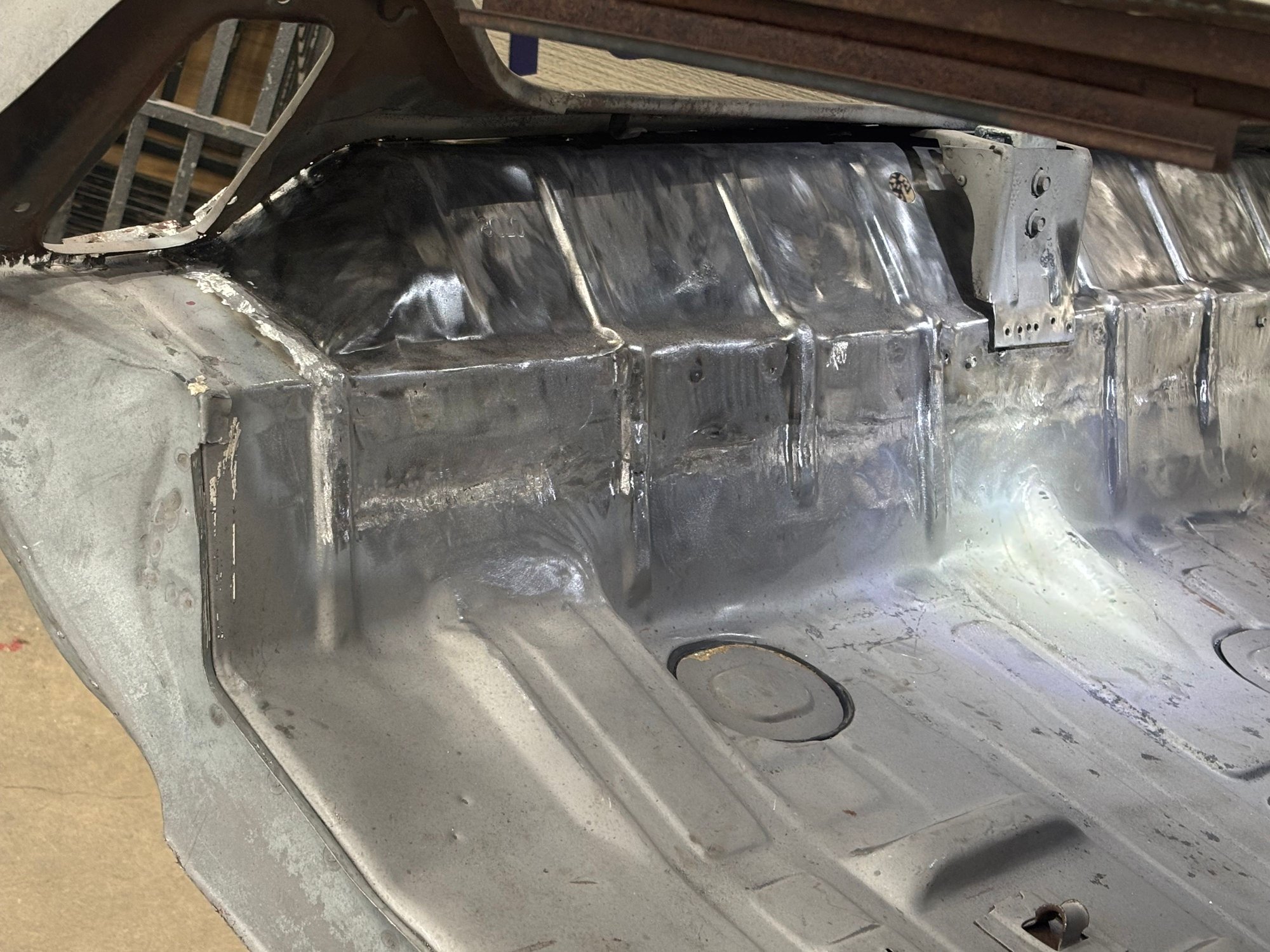

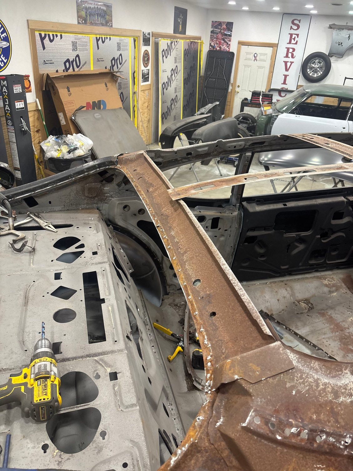

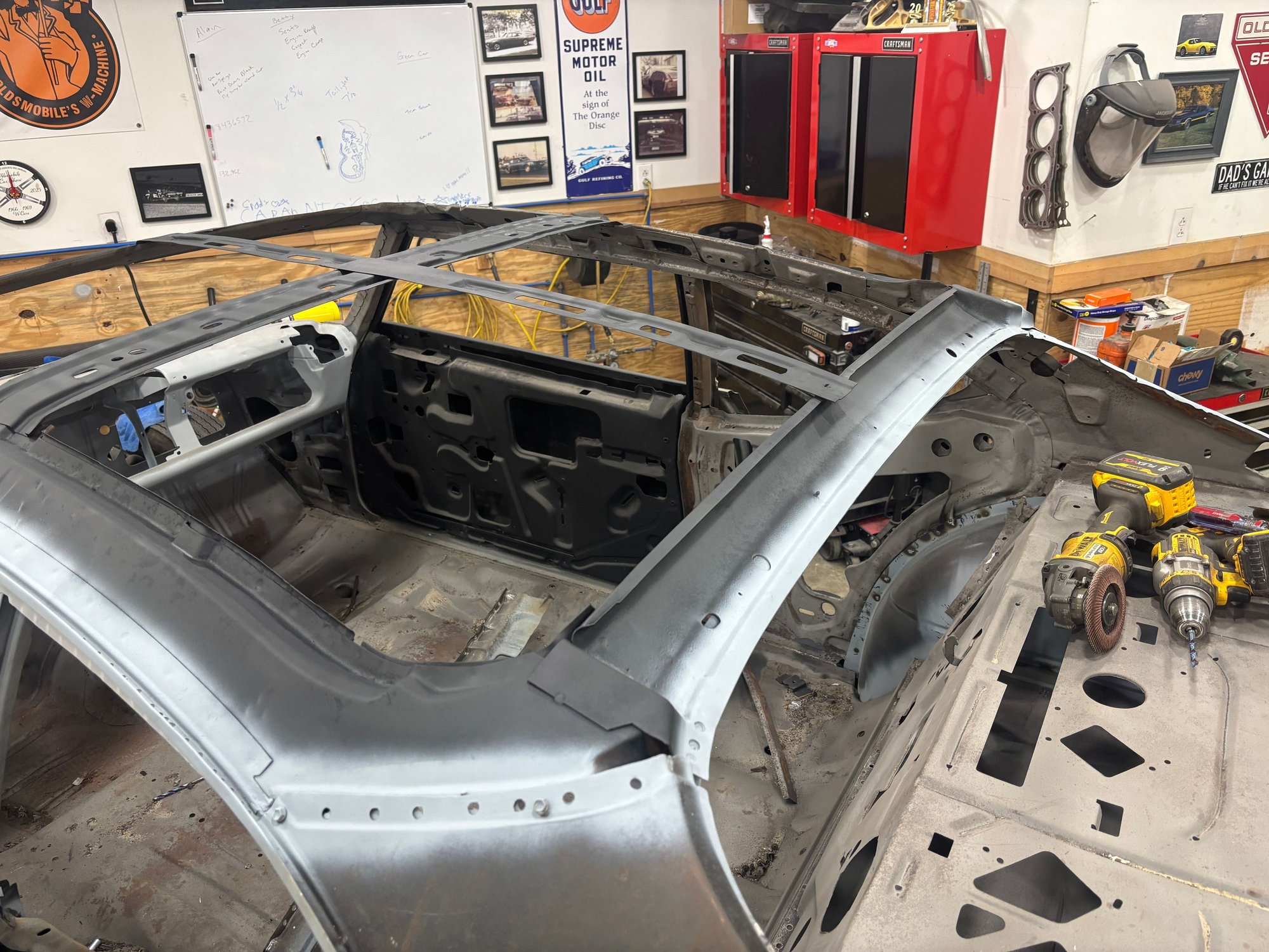

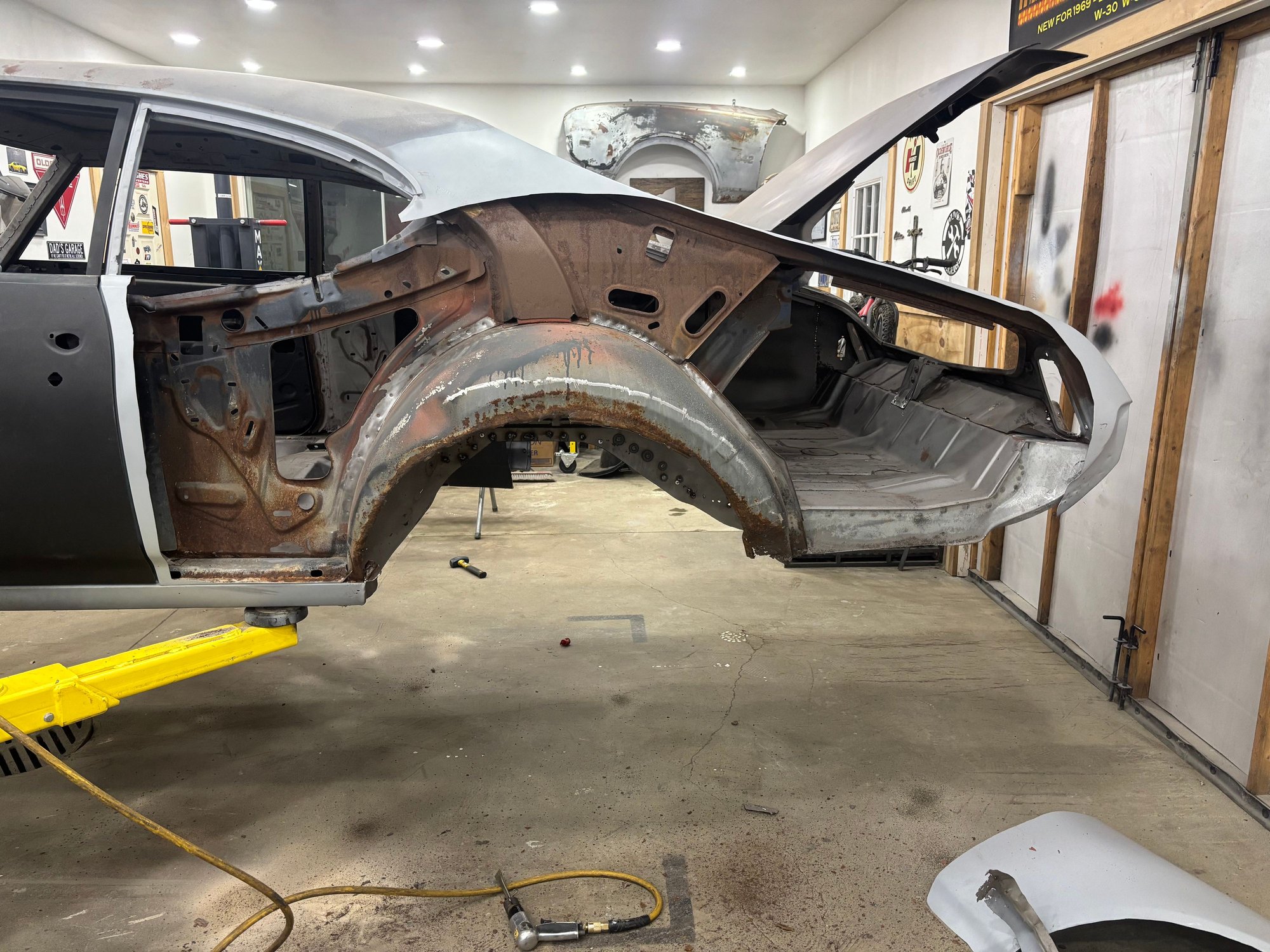

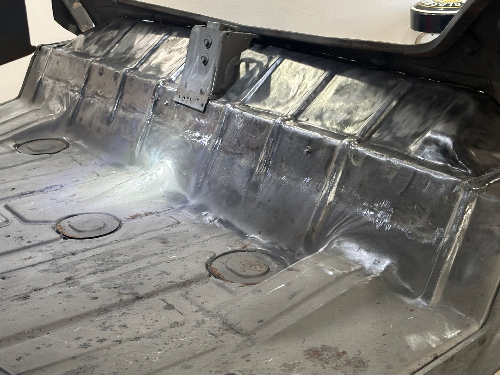

Hope everyone had a happy holidays, right now i got both inner and outer wheel houses on both sides complete. The back end of the trunk is patched in and got the driver side quarter panel test fit. Next I’m gonna clean up all the metal structure behind the quarter and seal it, prep the panel and weld that sucker in

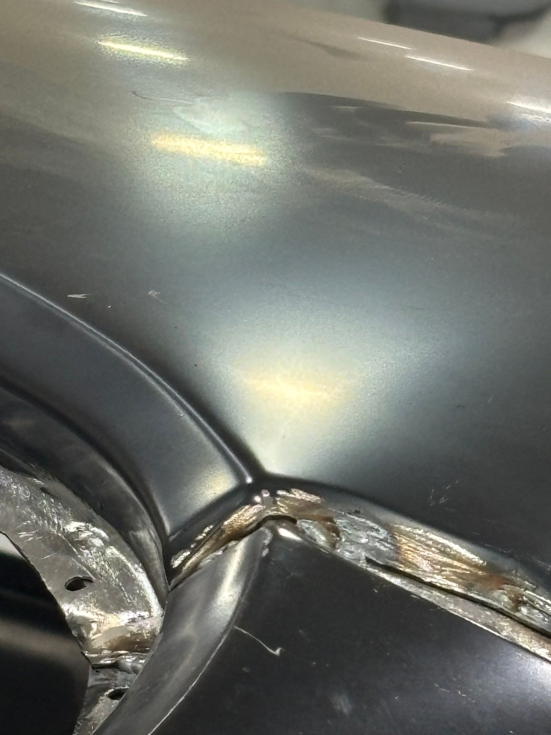

Old Jan 3, 2026 | 04:49 AM
Andy's Avatar
Joined: Jan 2020
Posts: 2,895
From: Sarasota Florida

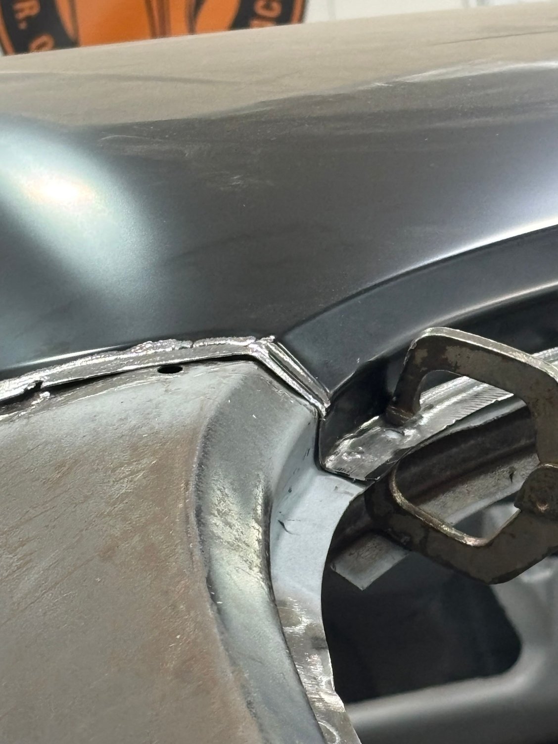

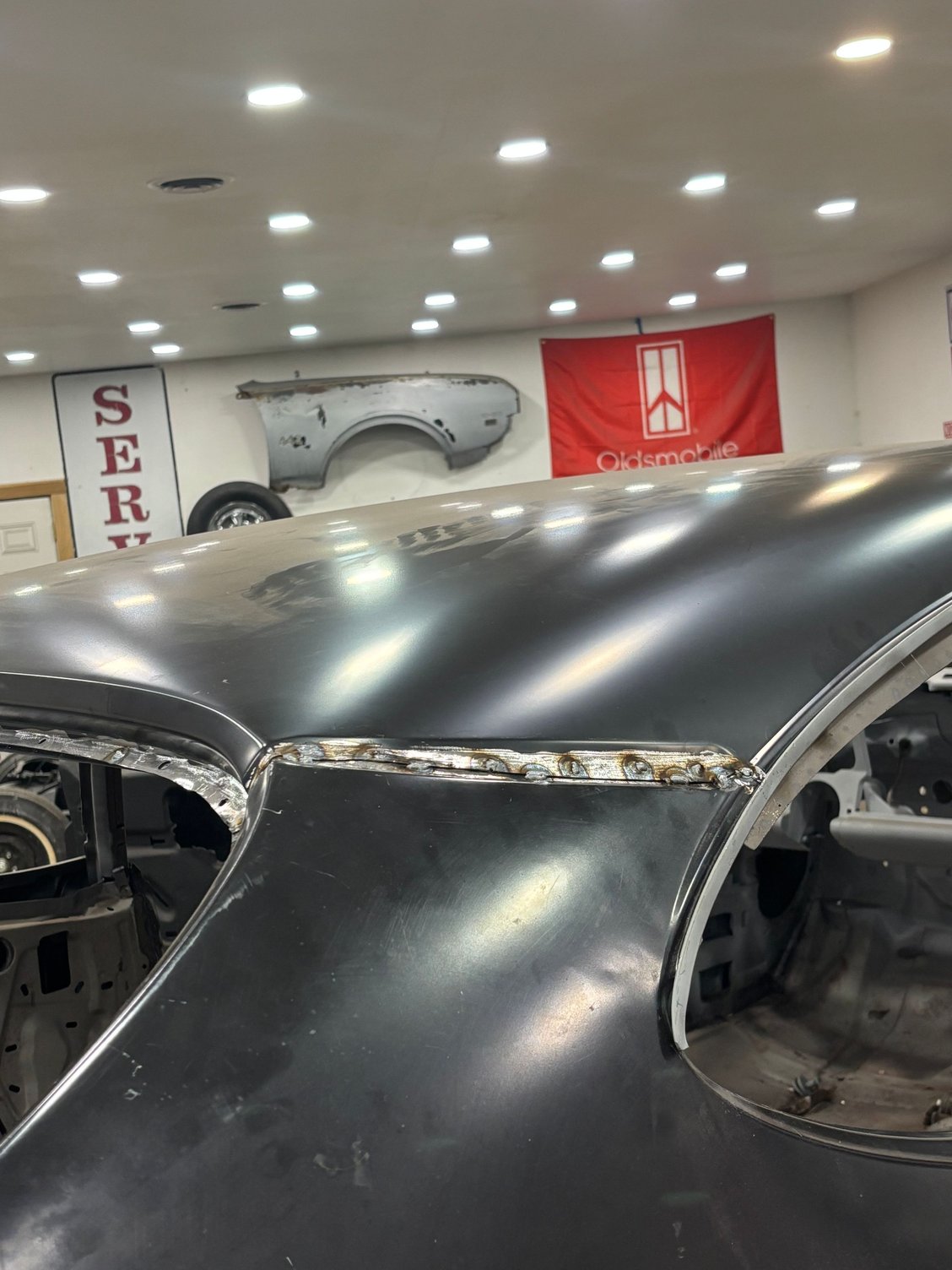

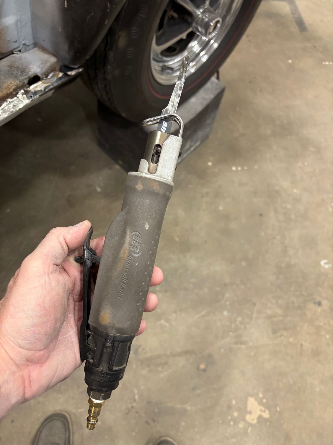

Damn nice metal work.. did you use a cut off wheel on the quarter panel or something else? Looks to smooth to have been a cut off wheel? Excellent job..

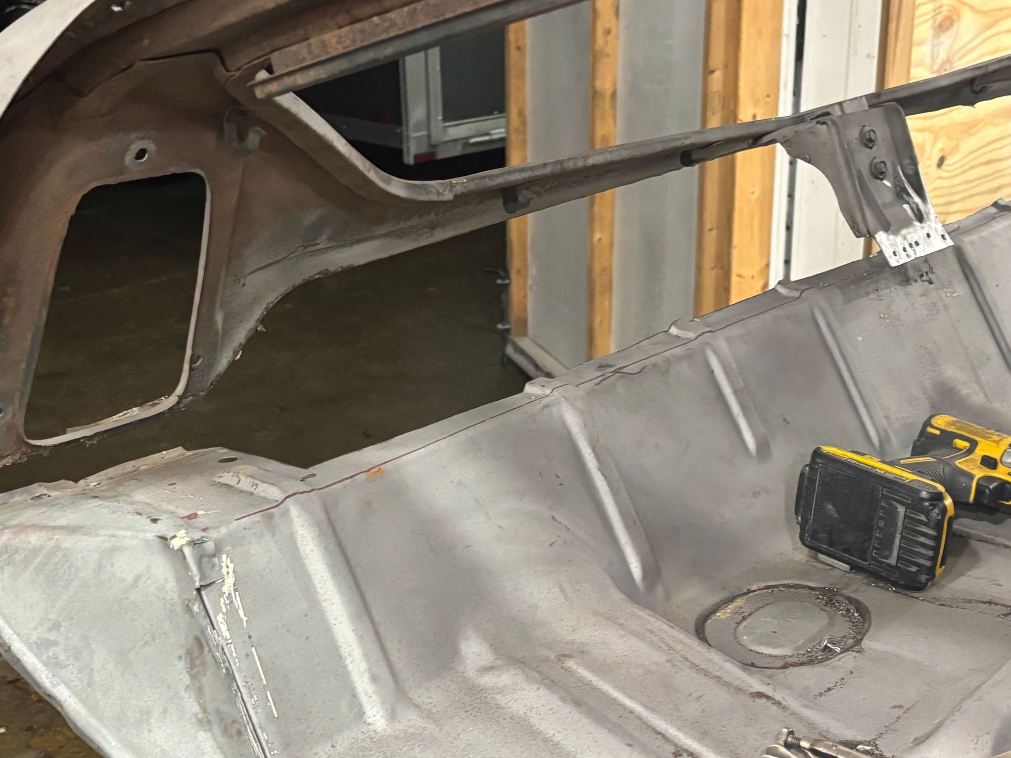

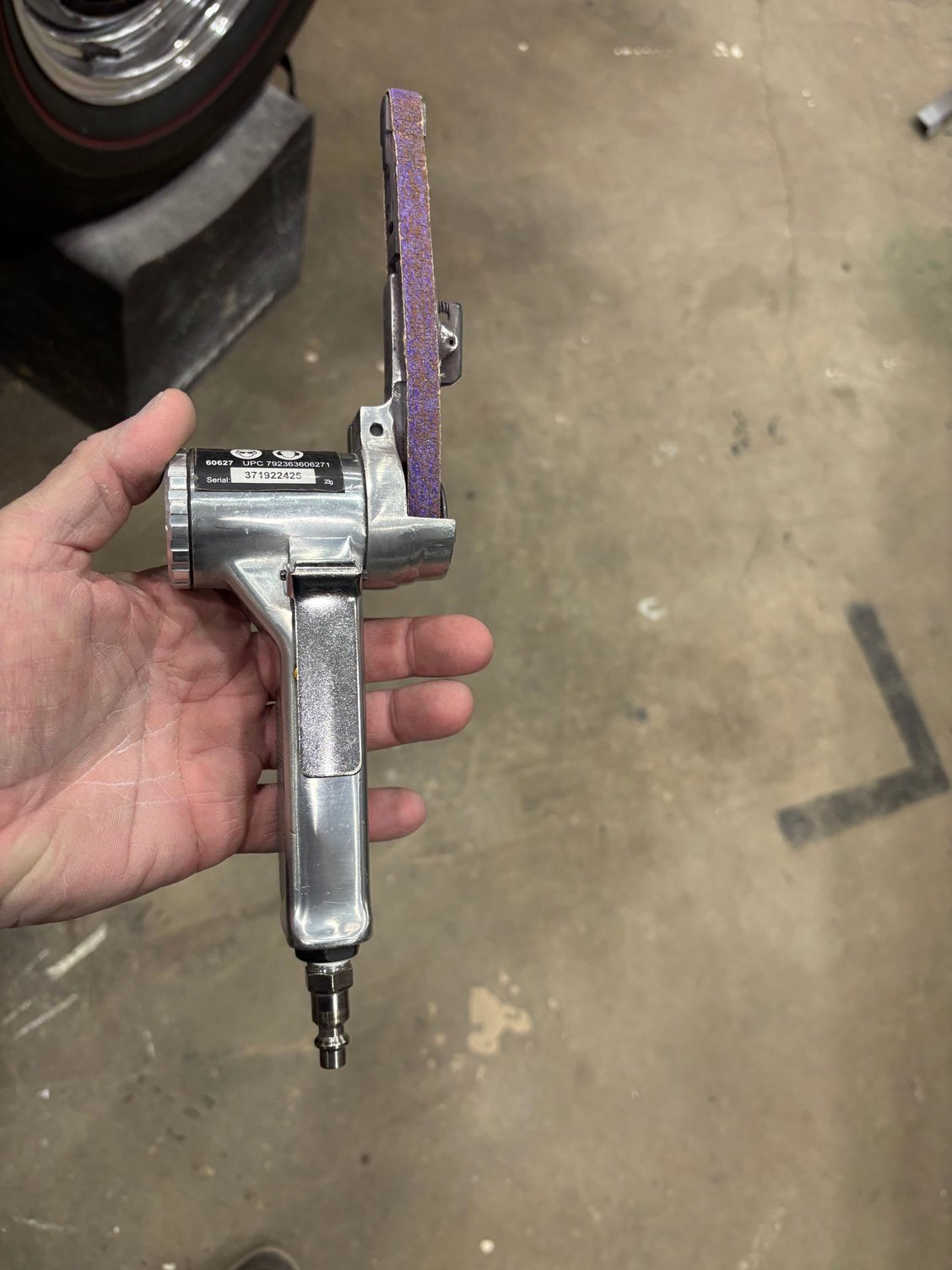

These are my favorite tools for surgery

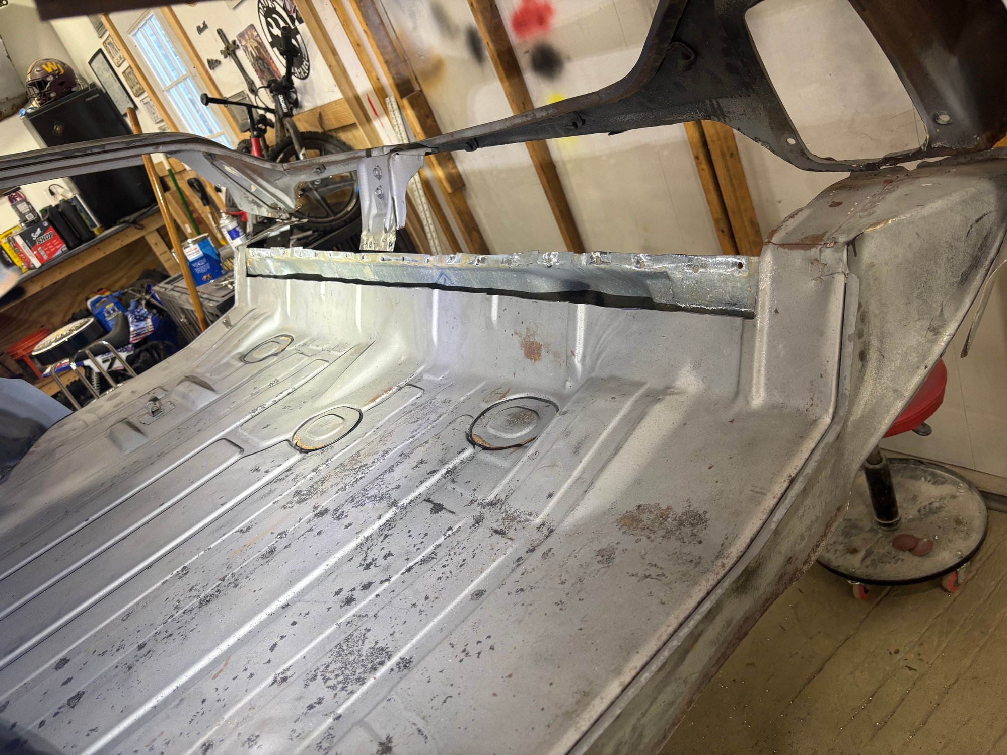

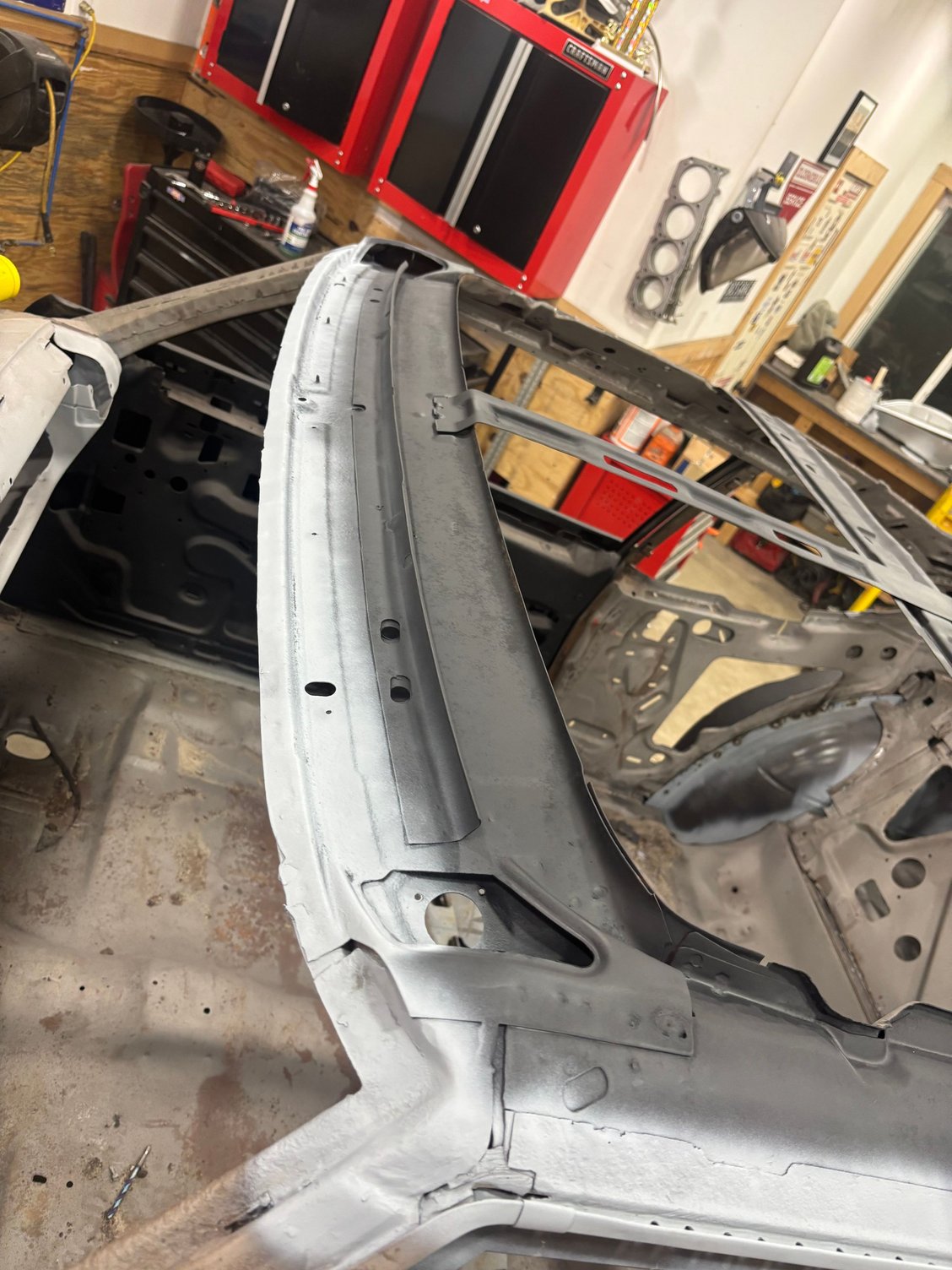

Took the wire wheel to the under structure then sprayed Eastwoods rust inhibitor on it, then sprayed Eastwoods weld through primer over areas im gonna weld the quarter too.

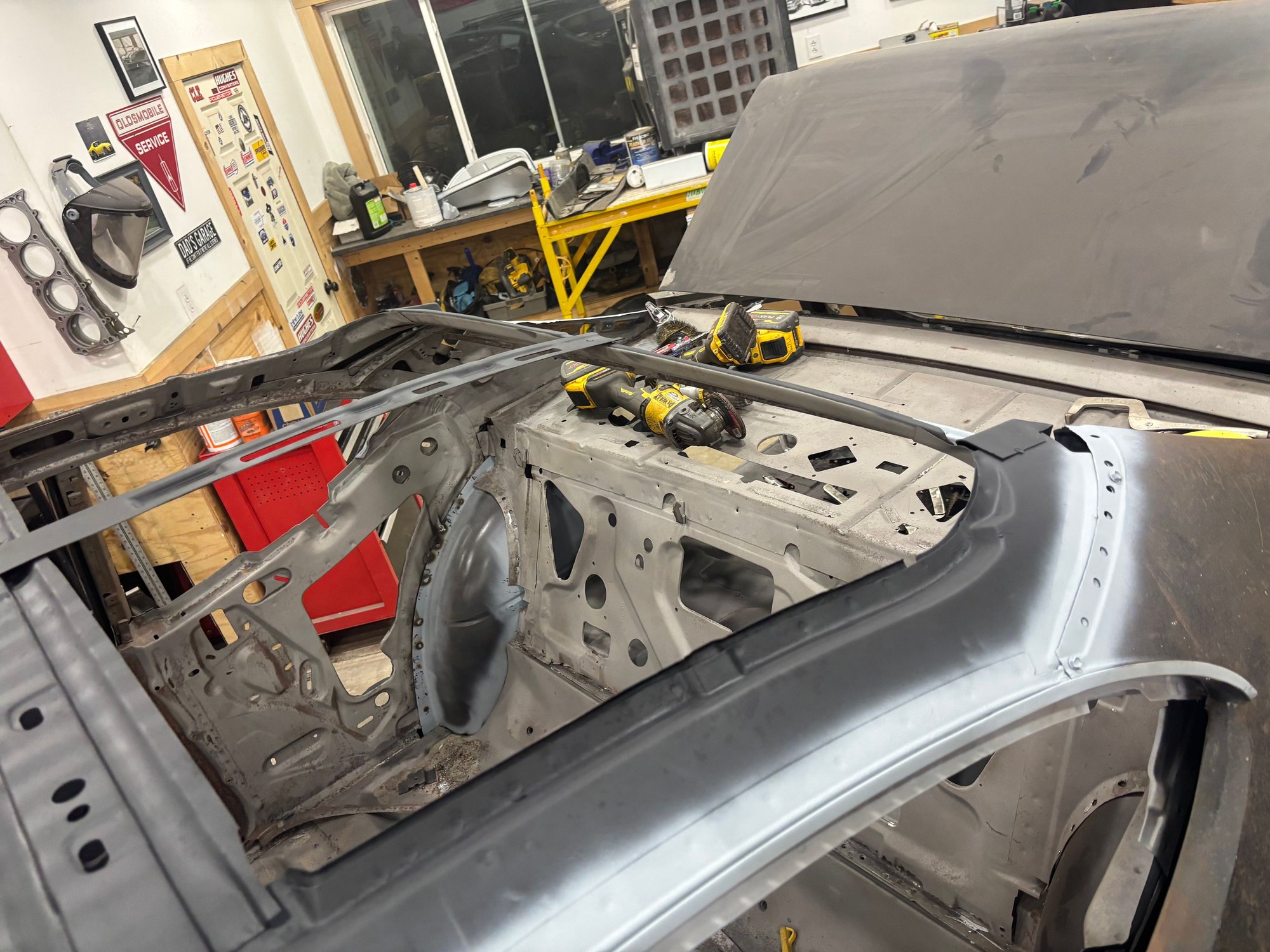

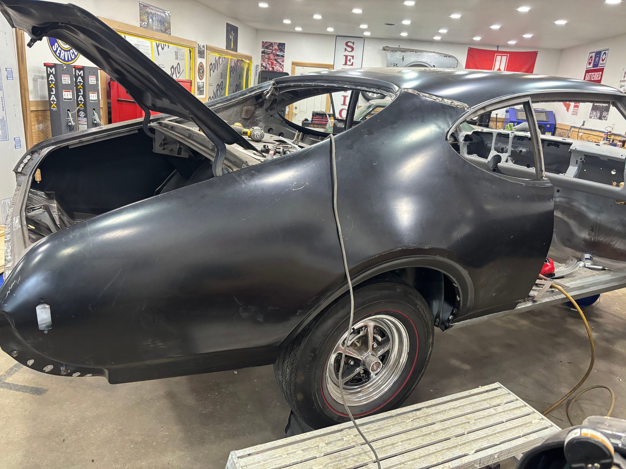

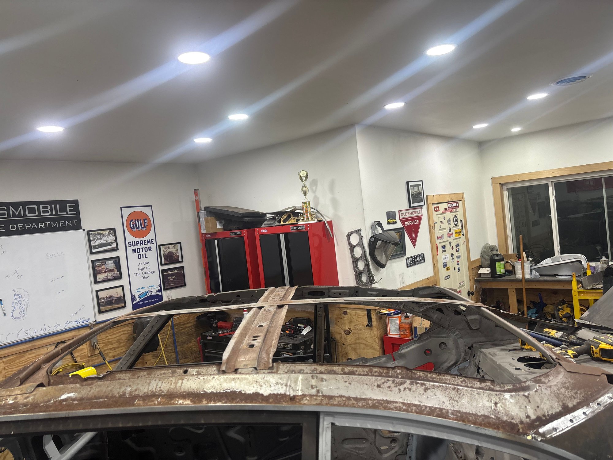

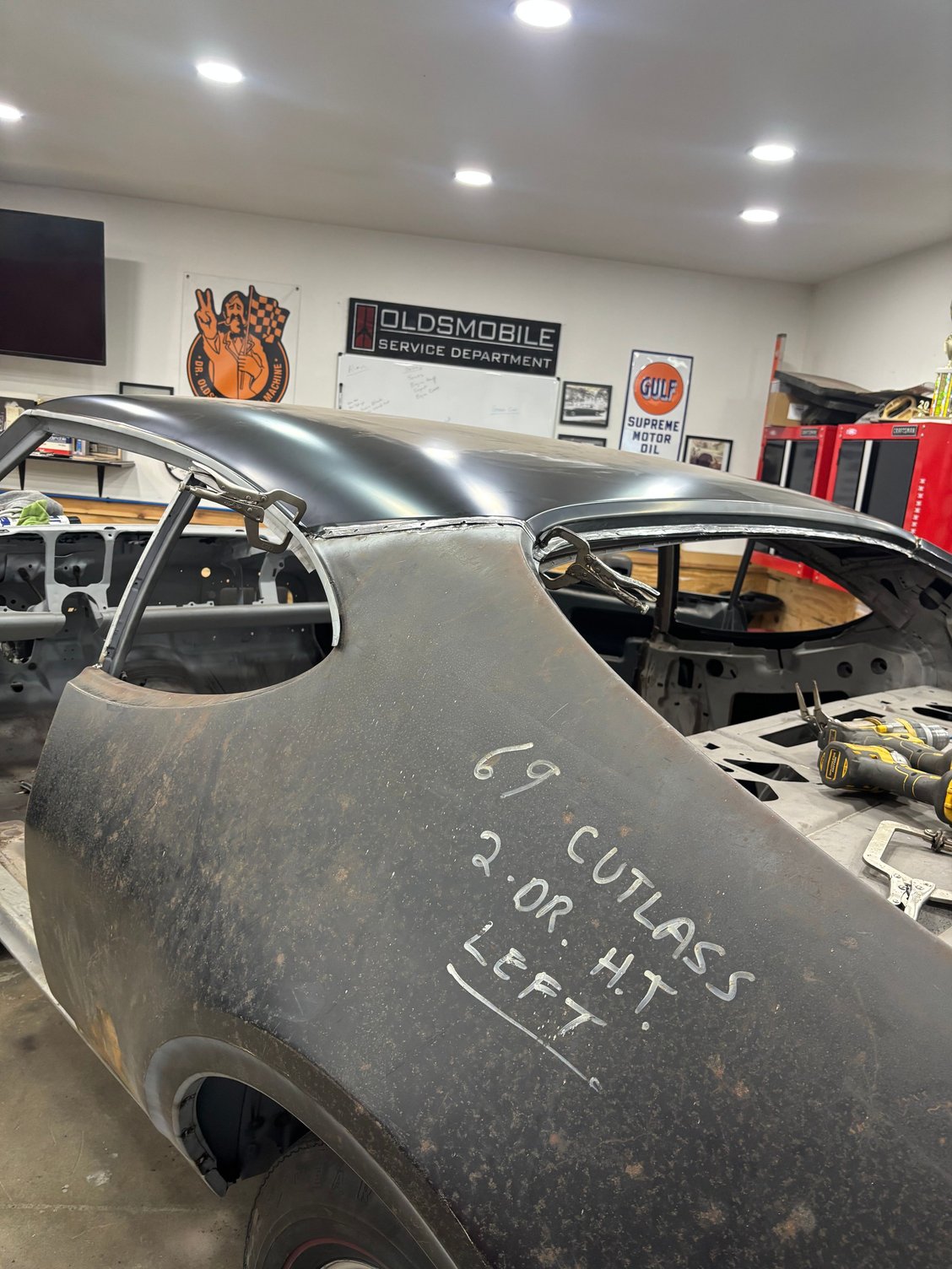

I got the driver side quarter panel on and ab 1/2 way welded up, and then went ahead and removed the roof skin cleaned it up with the wire wheel and sealed it up with rust inhibitor and weld through primer where ill be plug welding

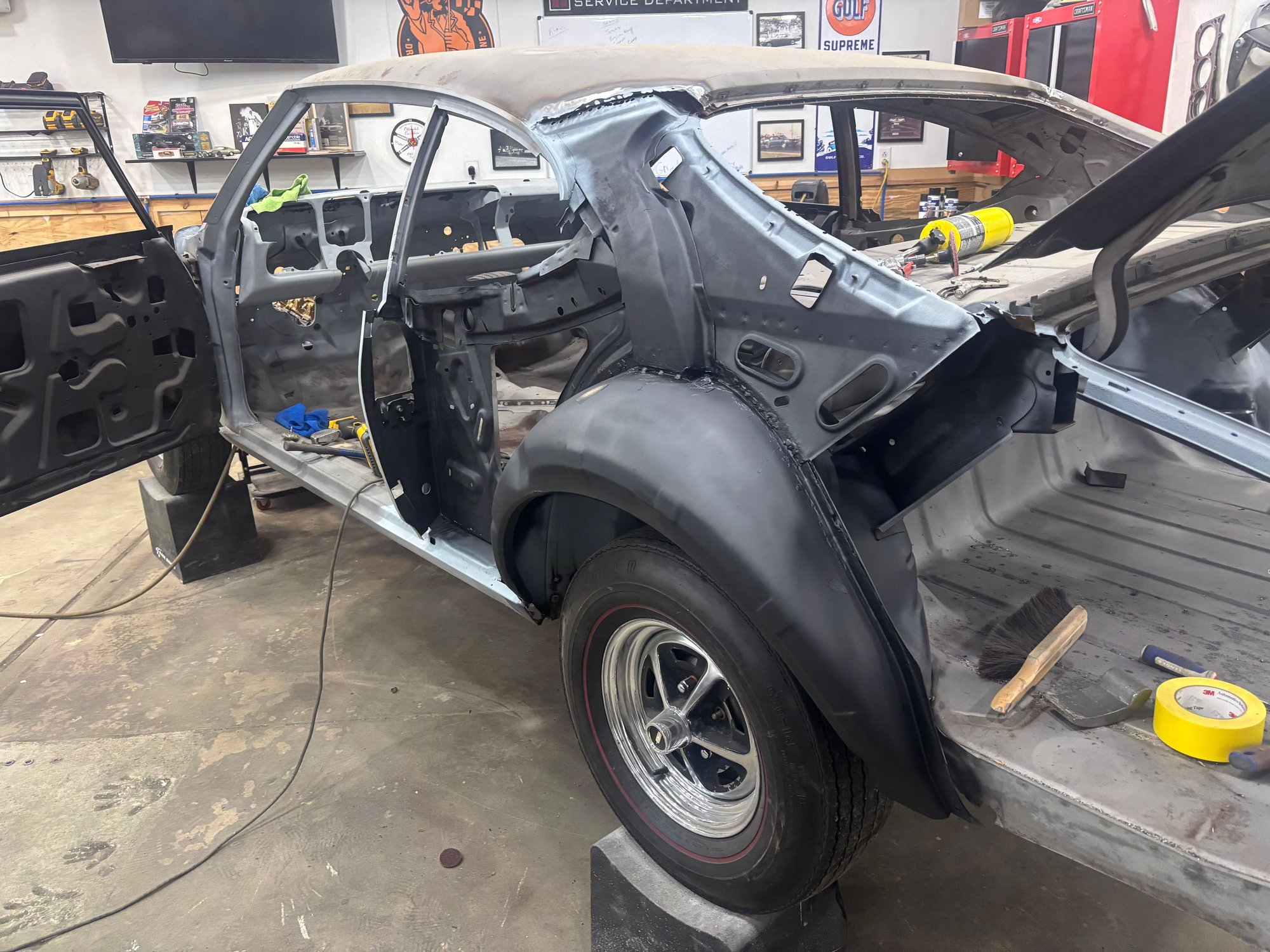

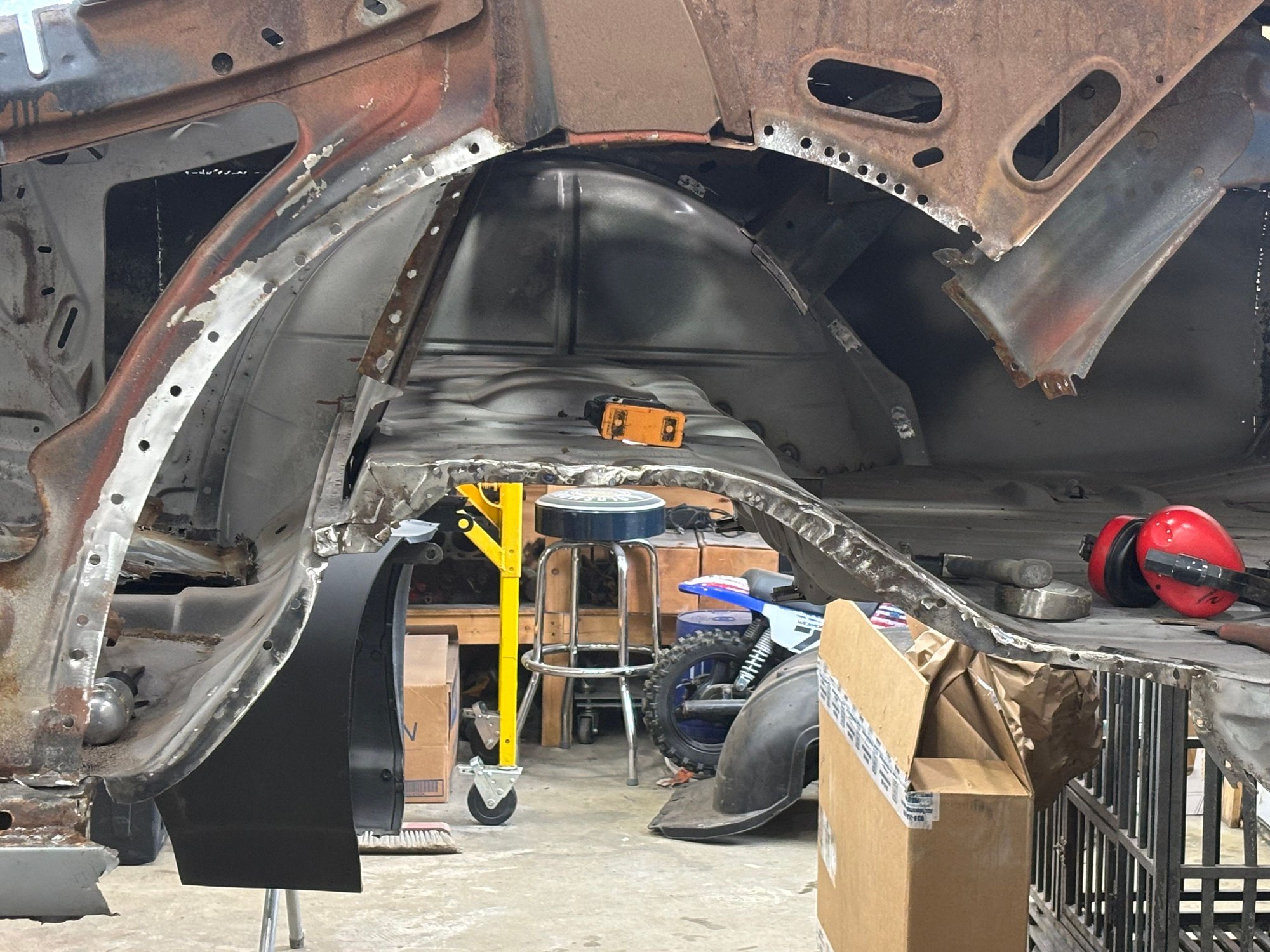

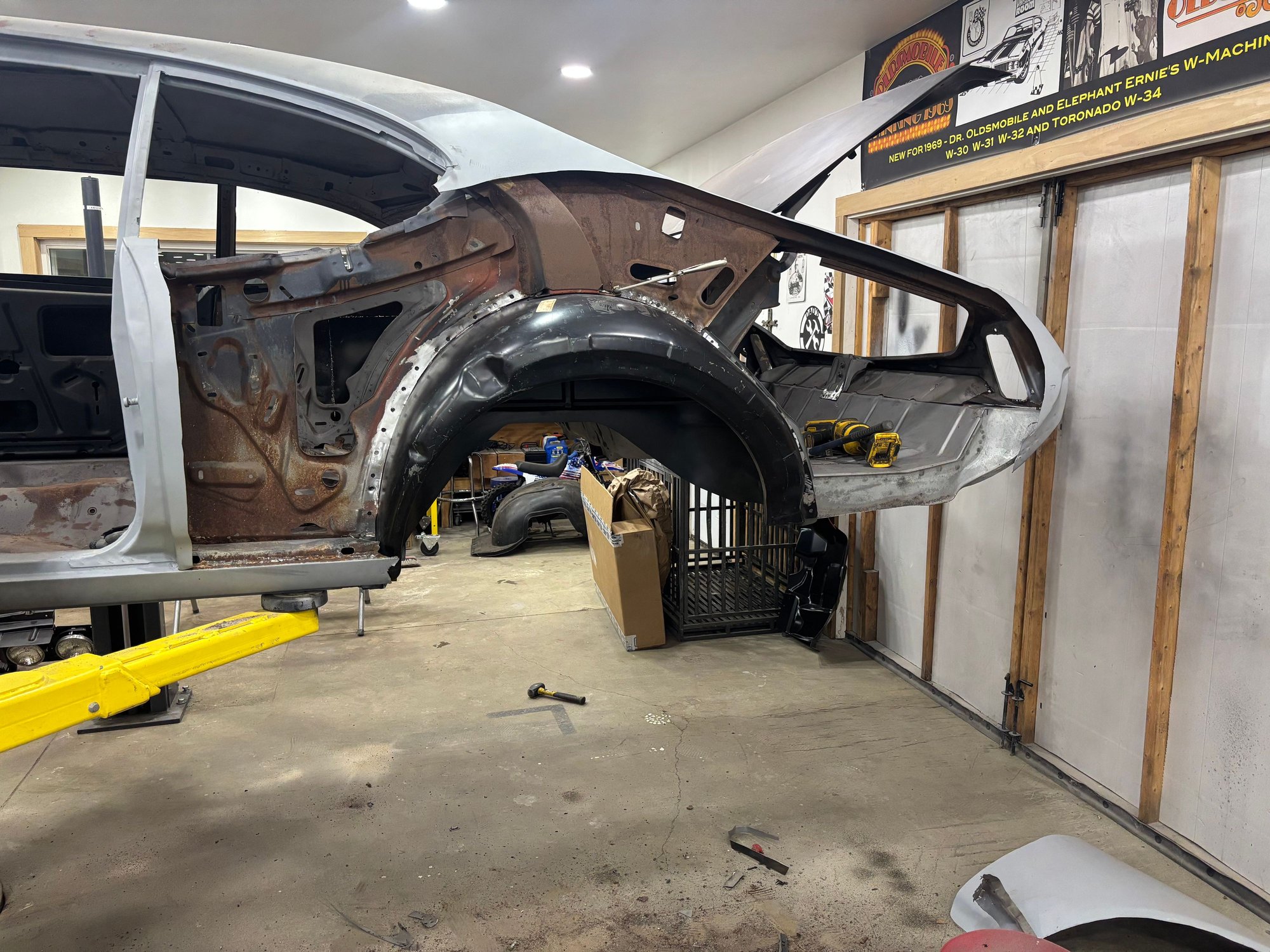

Got the rest of passenger quarter off and got the new one mocked up. Hopefully i can get the quarters complete and the roof skin test fit in next couple weeks
Old Jan 14, 2026 | 04:43 AM
Andy's Avatar
Joined: Jan 2020
Posts: 2,895
Nice surgery there. Repop quarters I assume, how did it fit? Looks great.
Old Jan 14, 2026 | 04:53 AM
Weav2-69s
Joined: Mar 2021
Posts: 241
From: Doylestown
My roof skin is repop my quarters are nos they fit perfectly.

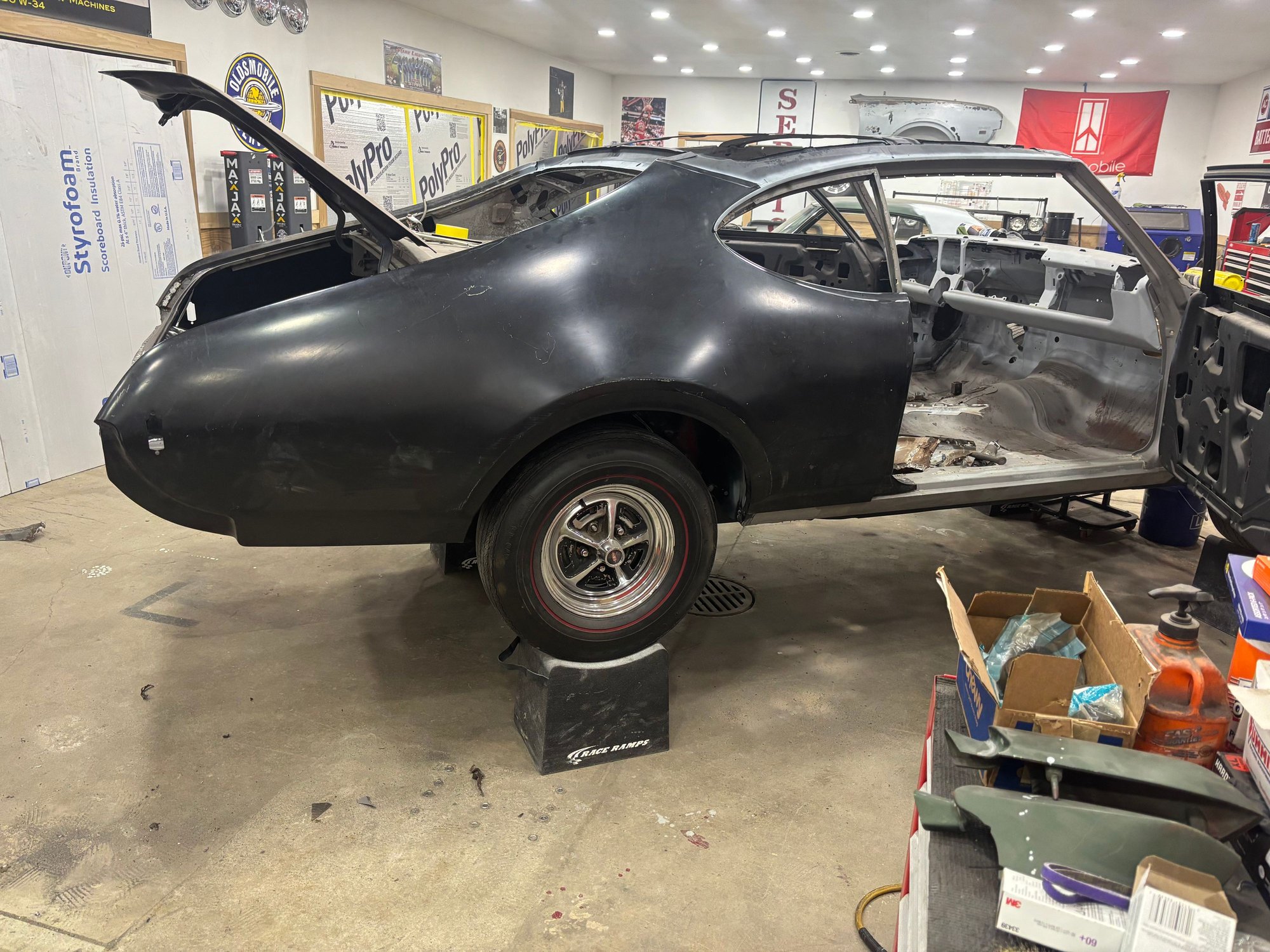

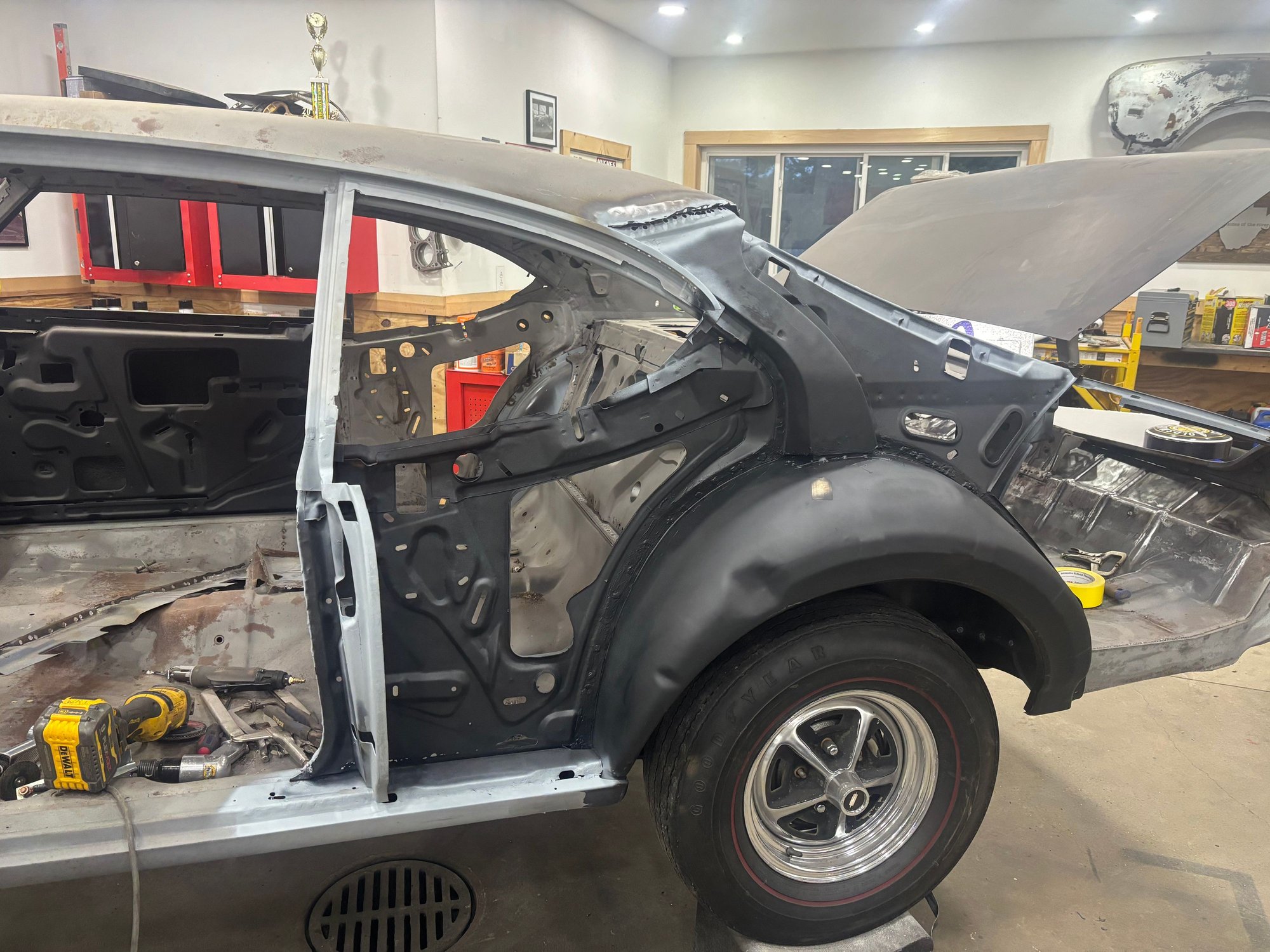

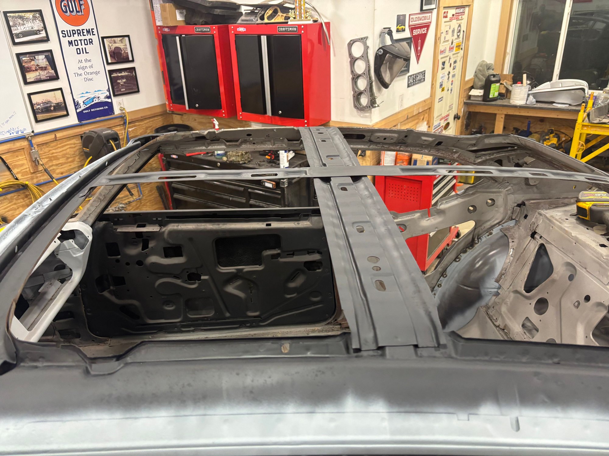

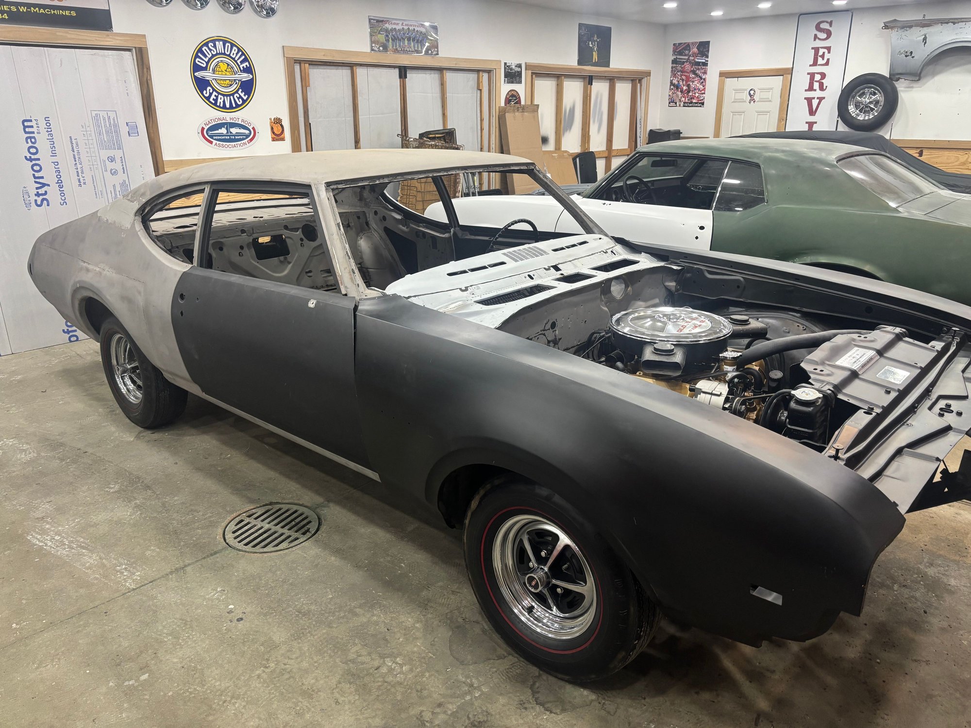

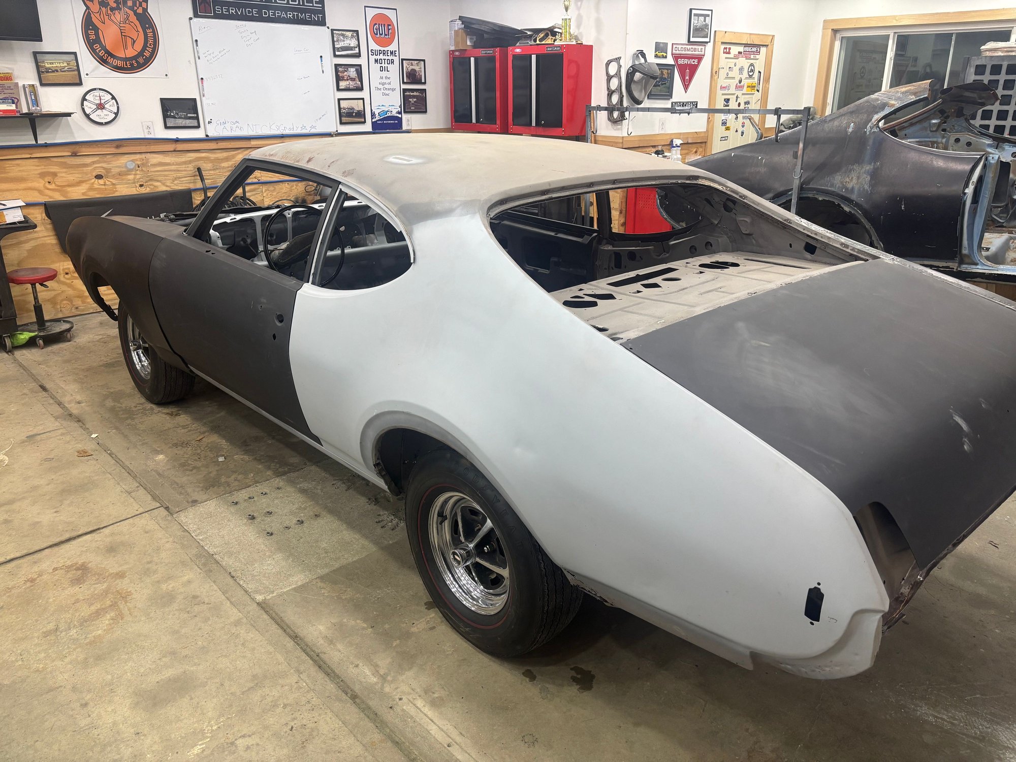

Last night i got a lot done on this old girl. Passenger side quarter is on and the roof skin is tacked in place, i was really surprised how well the roof skin fit with minimal mods. Here’s couple pics, ill get this all welded in on Sunday and start working on patching holes on floor.

Looking good. Projects need not take 15 years to complete.
A month in and it has new quarters, a roof skin, wheel houses and repaired tail panel. This is how you restore cars.
