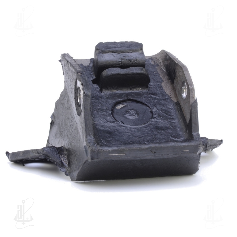

    Here are the mounts I bought. They were listed for the factory 330. Anchor #2261
    Your saying i need the mounts for the 400 like anchor # 2328

    Correct....Might not cure all the header problems but at least you will have the right mounts for a BBO in a 67.

    The big block motor mounts will not work with the small block frame stands. The built in steel stop on the motor mount holds the mount 1/2" to high for the holes to align.

    I am confused then. I parted out a rusty 67 442 that had 1973 plates. I kept the frame stands because I knew I would be putting a BBO in the 66. When I pulled the frame apart in the 66 I measured and compared the mounts and they are identicle.
    I will ask Robert what his combo of mounts is with these headers

    Sorry to mislead you. Its true that the frame mounts are the same but so are the motor mounts. You had the right setup the first time. Here is a note from Robert that has these headers in a 67 but is not a member here yet. The cooling system he is talking about is a 85 Suburban radiator is a direct bolt on.

    This link should help him out with the proper mounts and enegine frame pads. He should not have to cut or craft anything the 400, 425, 455 are a direct bolt in. I have the Hooker headers also; you seen first habd how tight it is on drivers side for; however my install is with a stock GM 4-field stsrter. If I ever need to service the starter I will replce it with a RobMac mini. Yes its best to have the headers in the engine bay before completely dropping the engine in. If the car does not have factory A/C the pass side header will go in with the engine in the bay. You may want to mention the cheap but trick cooling system we have in our hot rods.

    Thanks for the link and the help. This is the information that I read on motormounts, but couldn't find. I'll save it now. I know these cars shift a little with 40 plus years of use, so I guess my header fitment problems might just be a result of that. I'll look in to the radiator. Sounds like a "cool" swap. Pun intended. Looking at the image I would have to agree it looks like a drop-in replacement and $150.00 is hard to beat.

    I will dig up the part# we used and several other guys on ROP have used to, Its an aluminum radiator for 179.00 at Autozone.

    Autozone part# we used is 433840 You need Napa #900 and 901 hose adapters too because the hose outlets on the radiator are smaller. Cooler fittings are on the passenger side. Its aluminum with plastic tanks.
