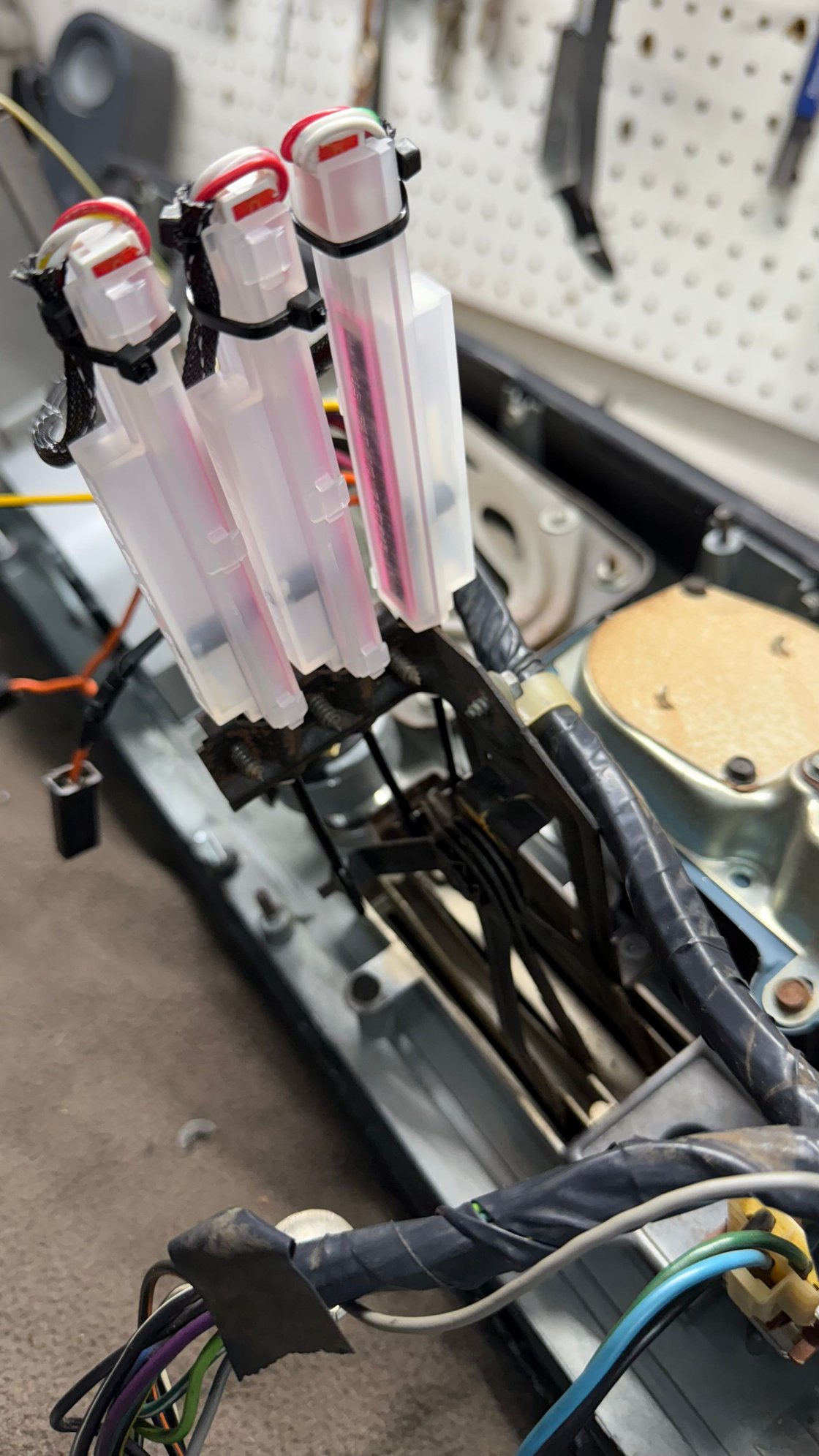

they now repop the complete console set up

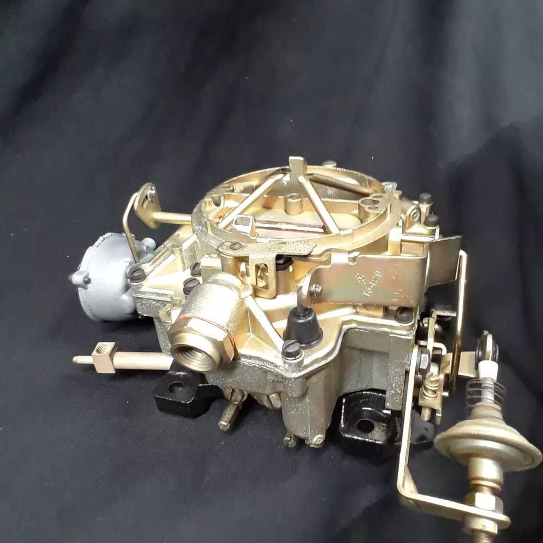

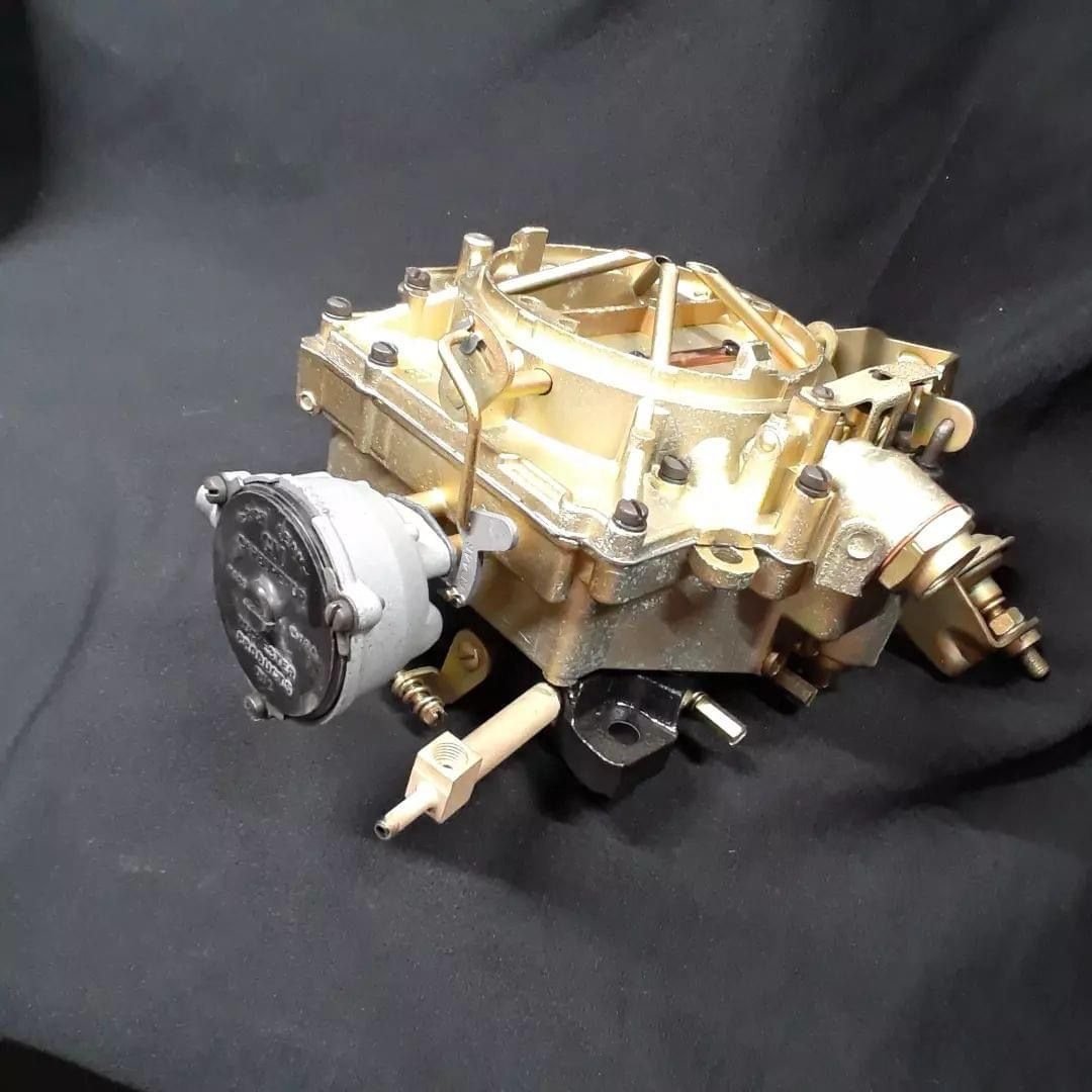

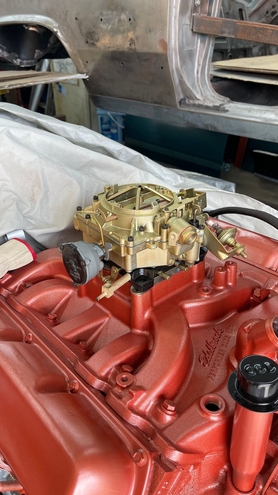

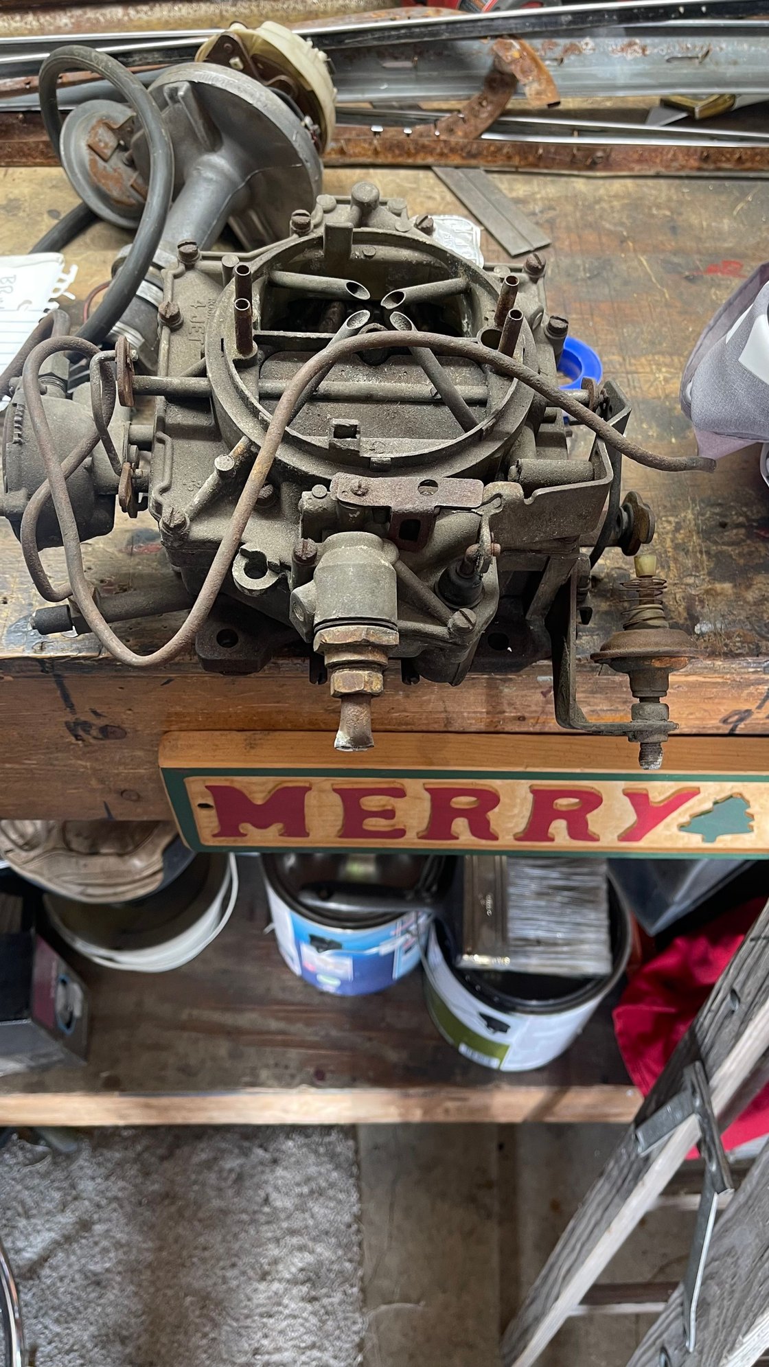

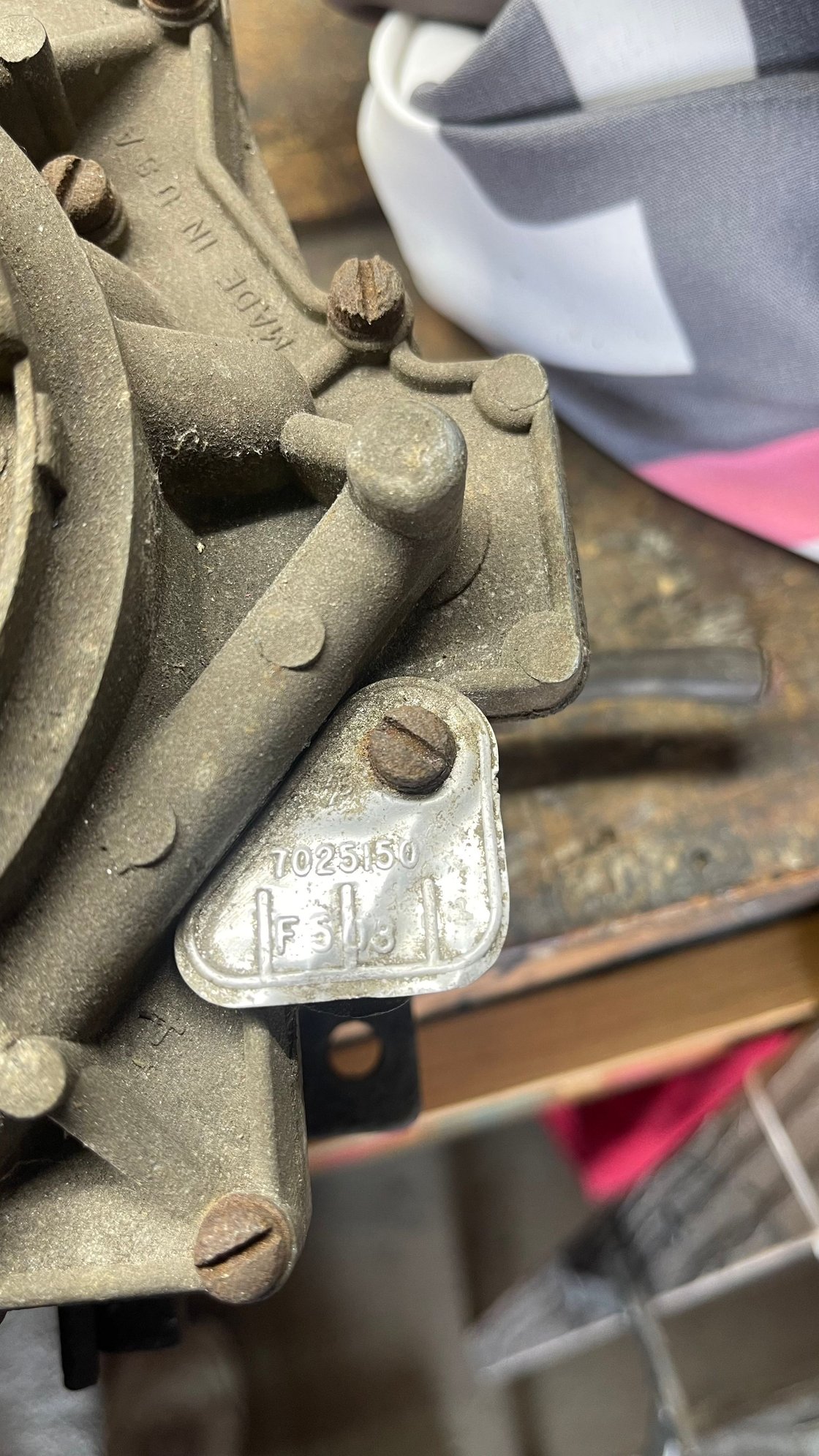

light show is over, time to get crack a lacking. lol i bought a rochestor 4gc from a local guy that matches my car date wise, sent it off to Ken at Everyday performance to rebuild, calibrate and tune to my intake and cam, and have chromate plated. i have been buying parts since december so that when the carb does come back in 3-5 weeks, i will be ready to start the car for the first time in 30 years. i tore down my steering column and distributor this weekend. some one put the wrong thread type but on the steering wheel. when i removed the bolt, it took the threads with it. i also noticed a groove in the shaft itself wear the lower bearing rides. not sure if the groove is factory or not. i can have the shaft cut down and new threads for the steering wheel, it's the groove in the shaft where the bearing rides that i'm a little concerned with. oh well, things should start moving pretty fast over the next 3 months. goal is to at least have the car drive able by the time the weather in northern Ky breaks, which is usually April. we'll see.

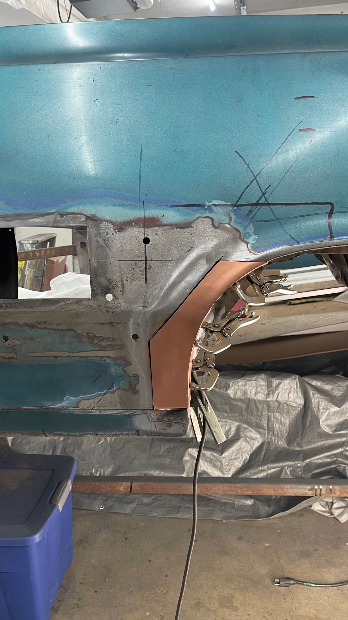

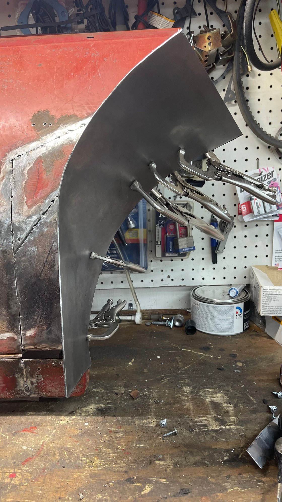

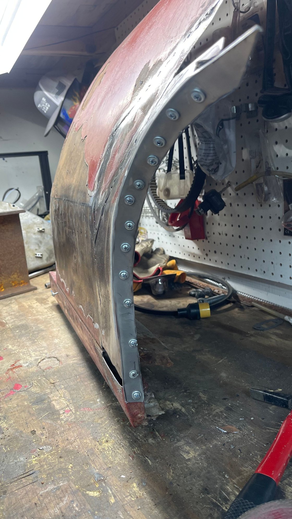

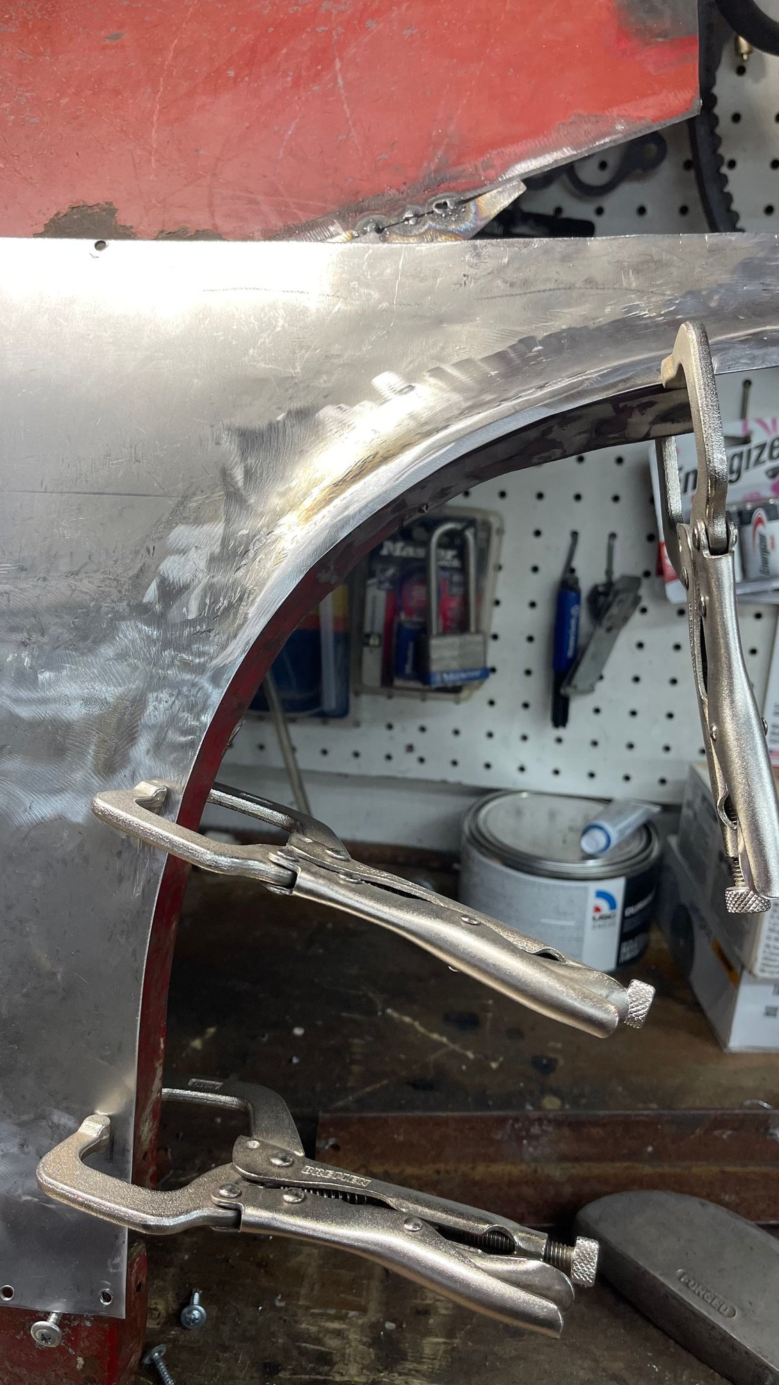

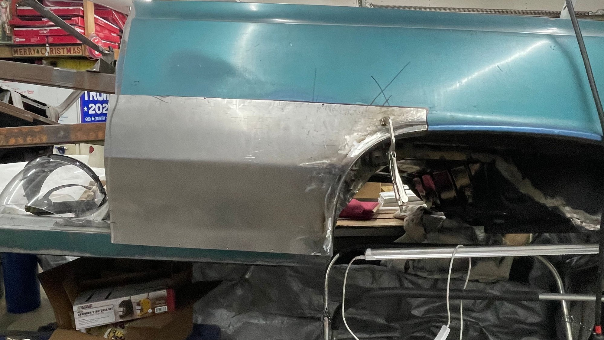

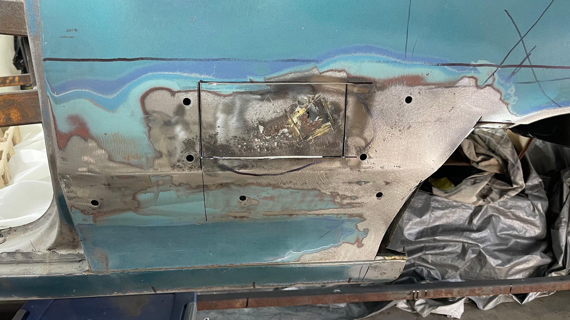

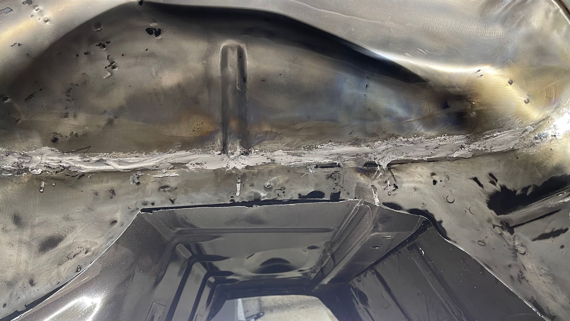

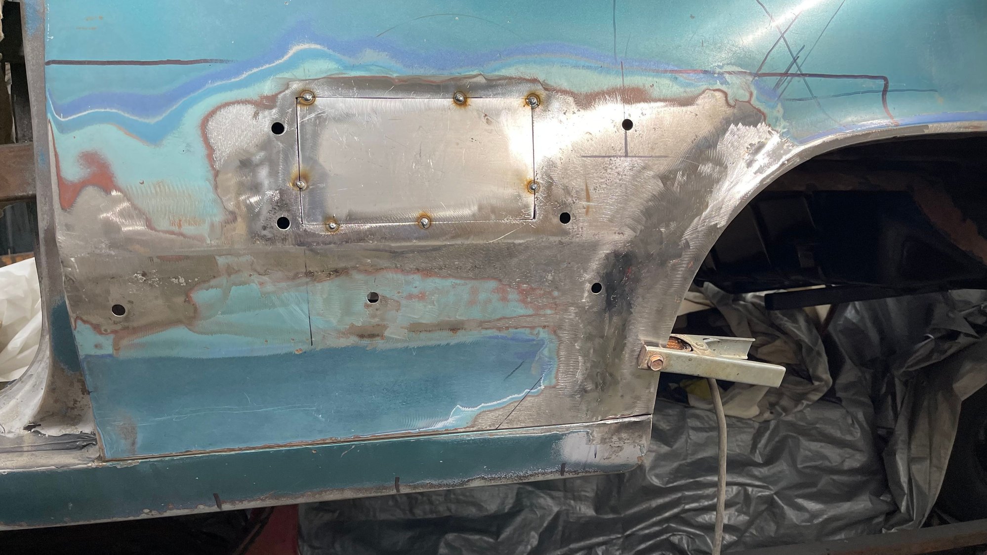

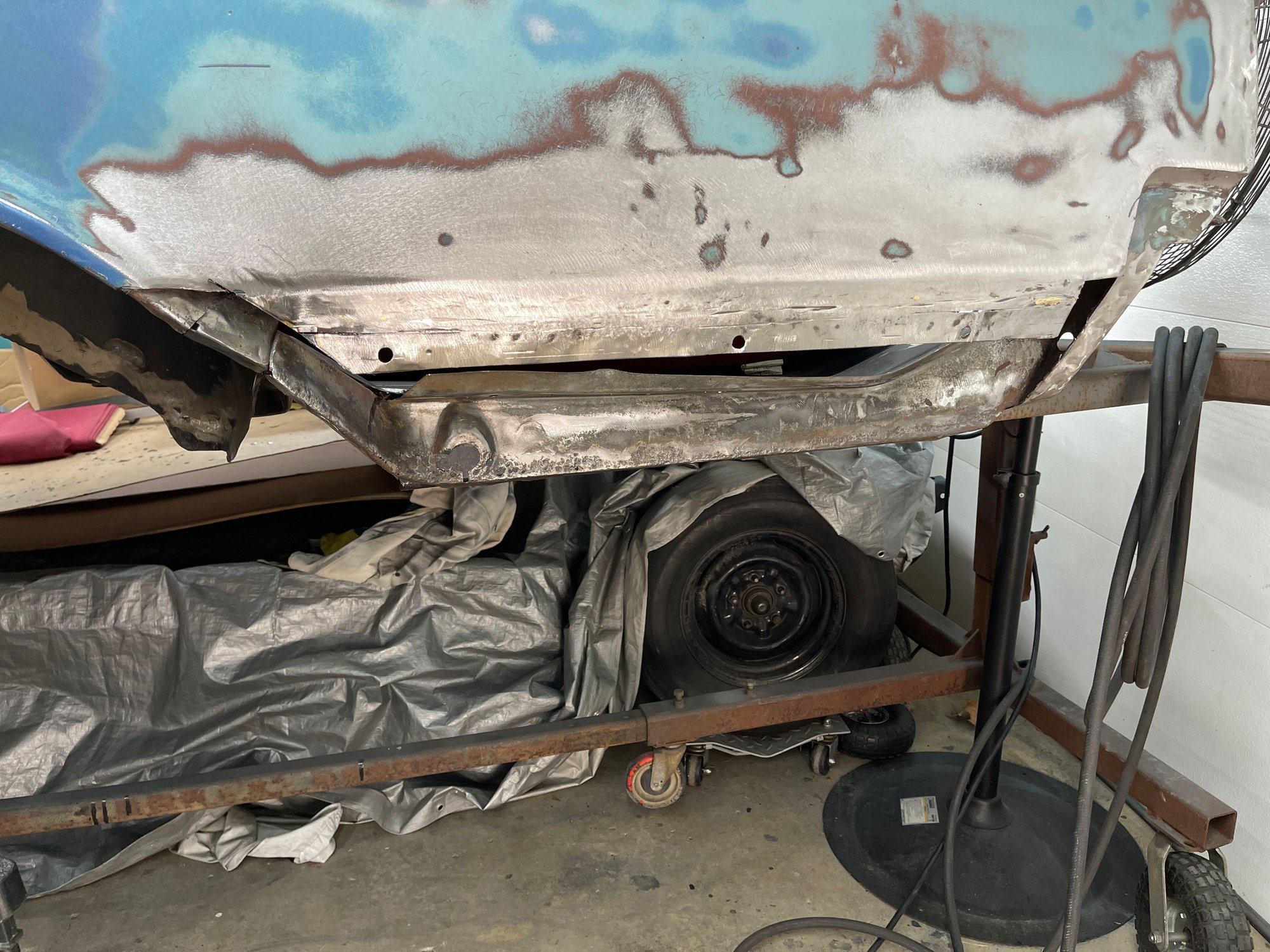

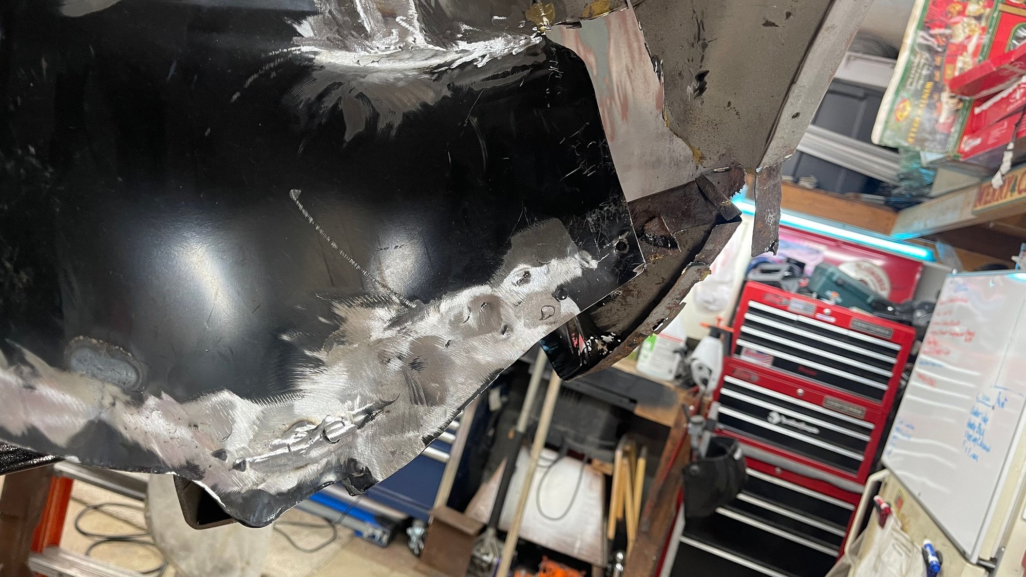

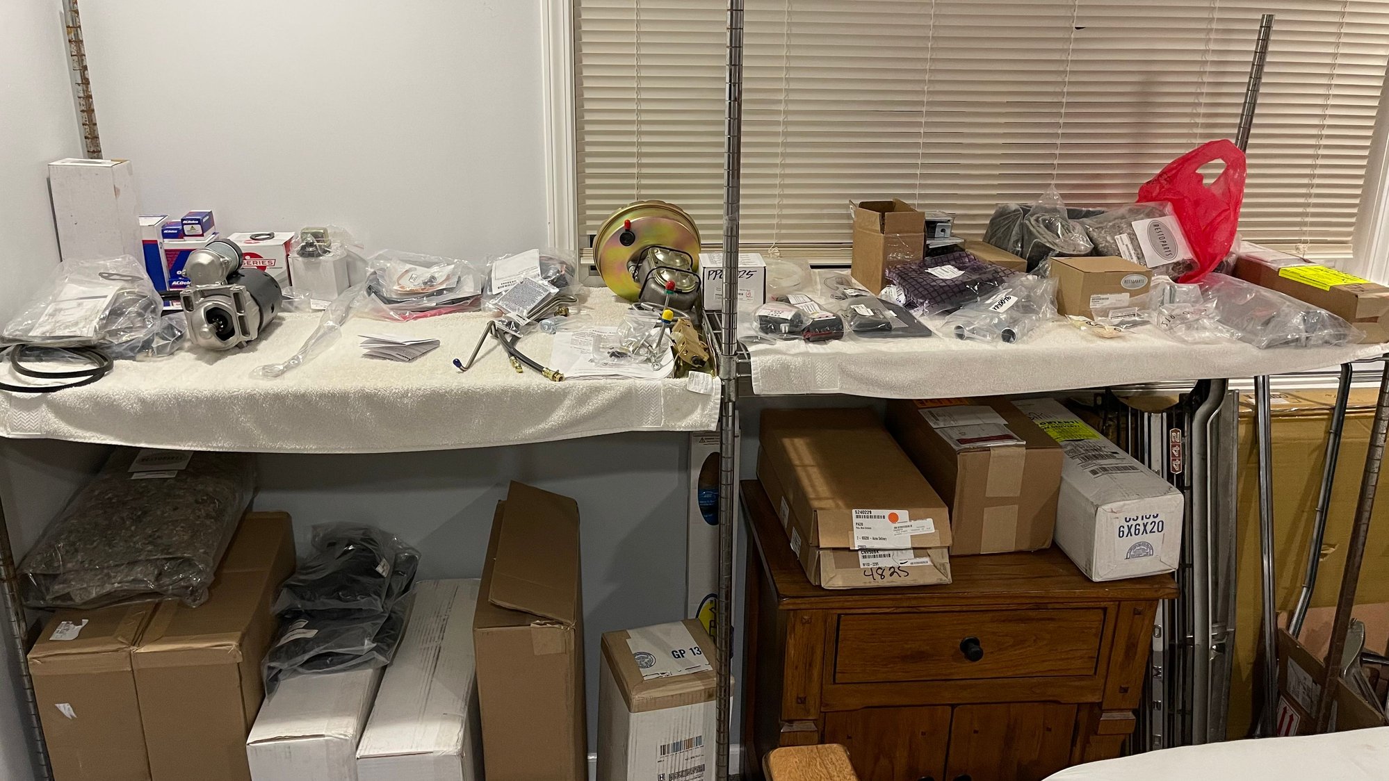

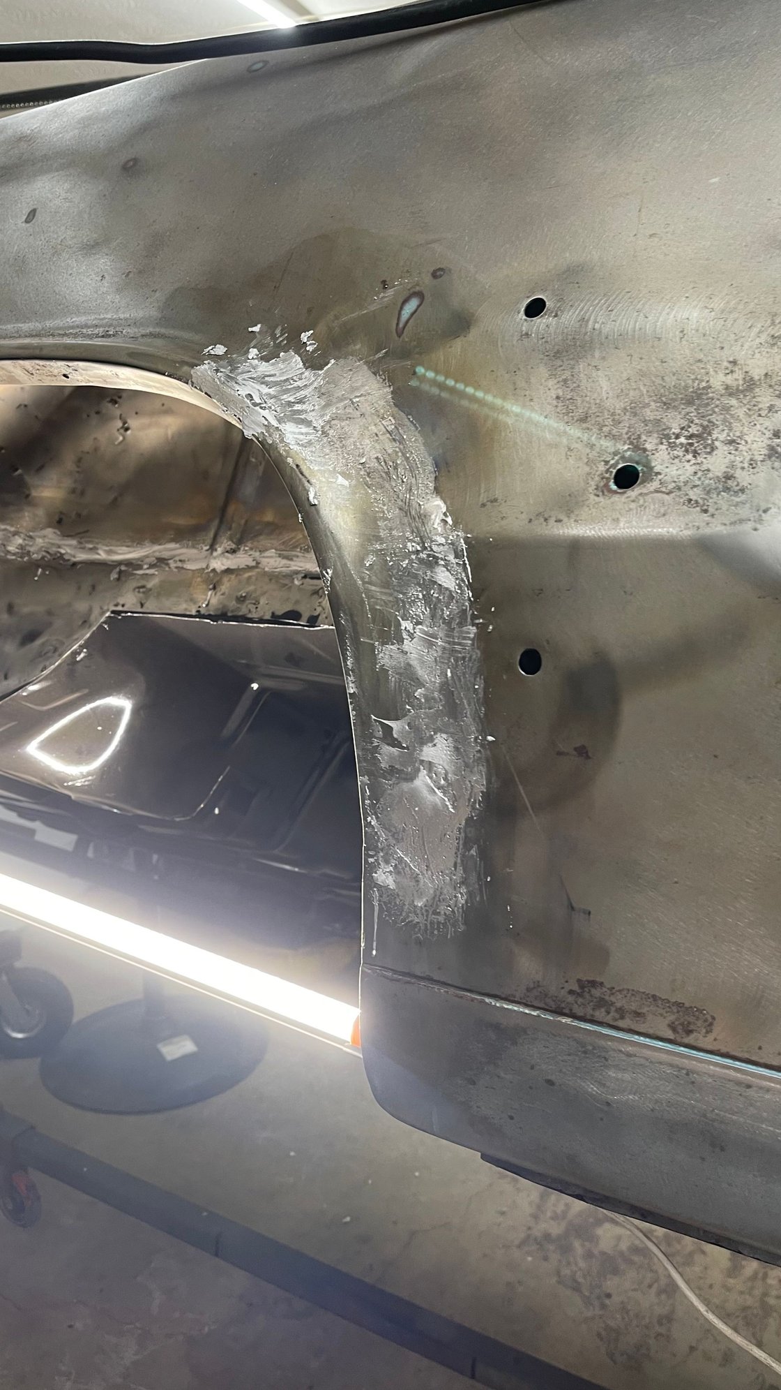

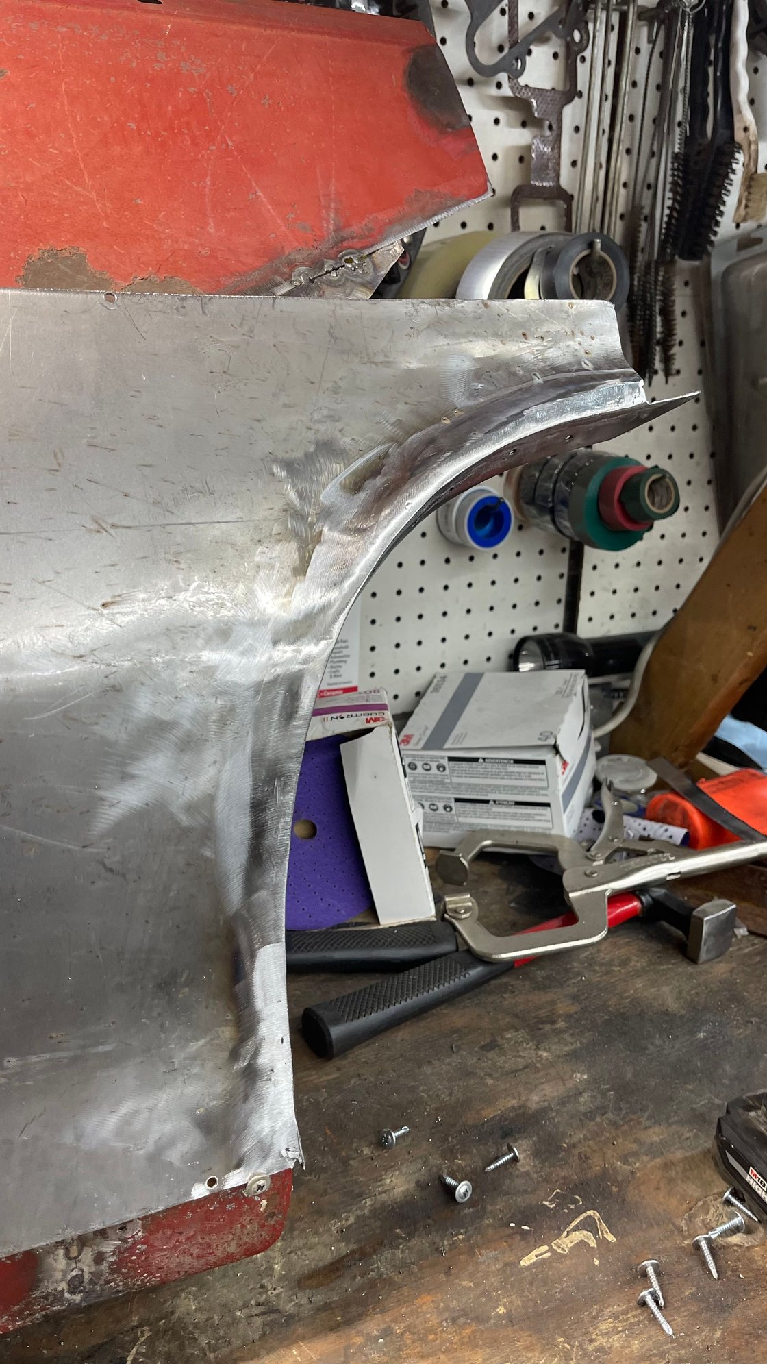

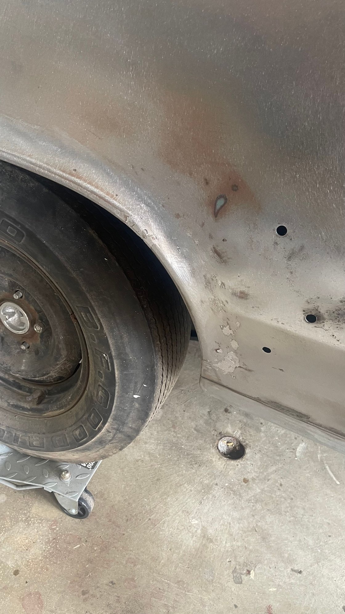

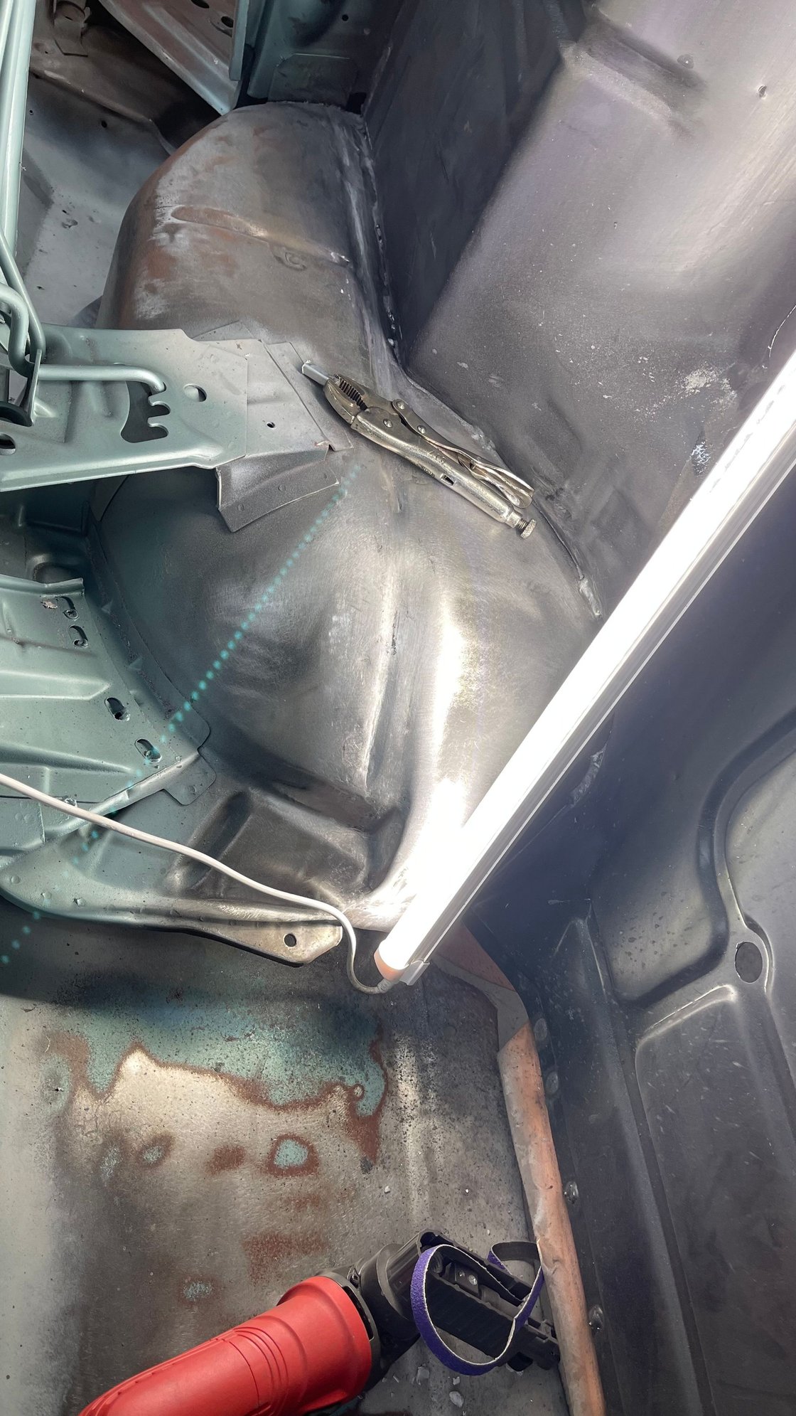

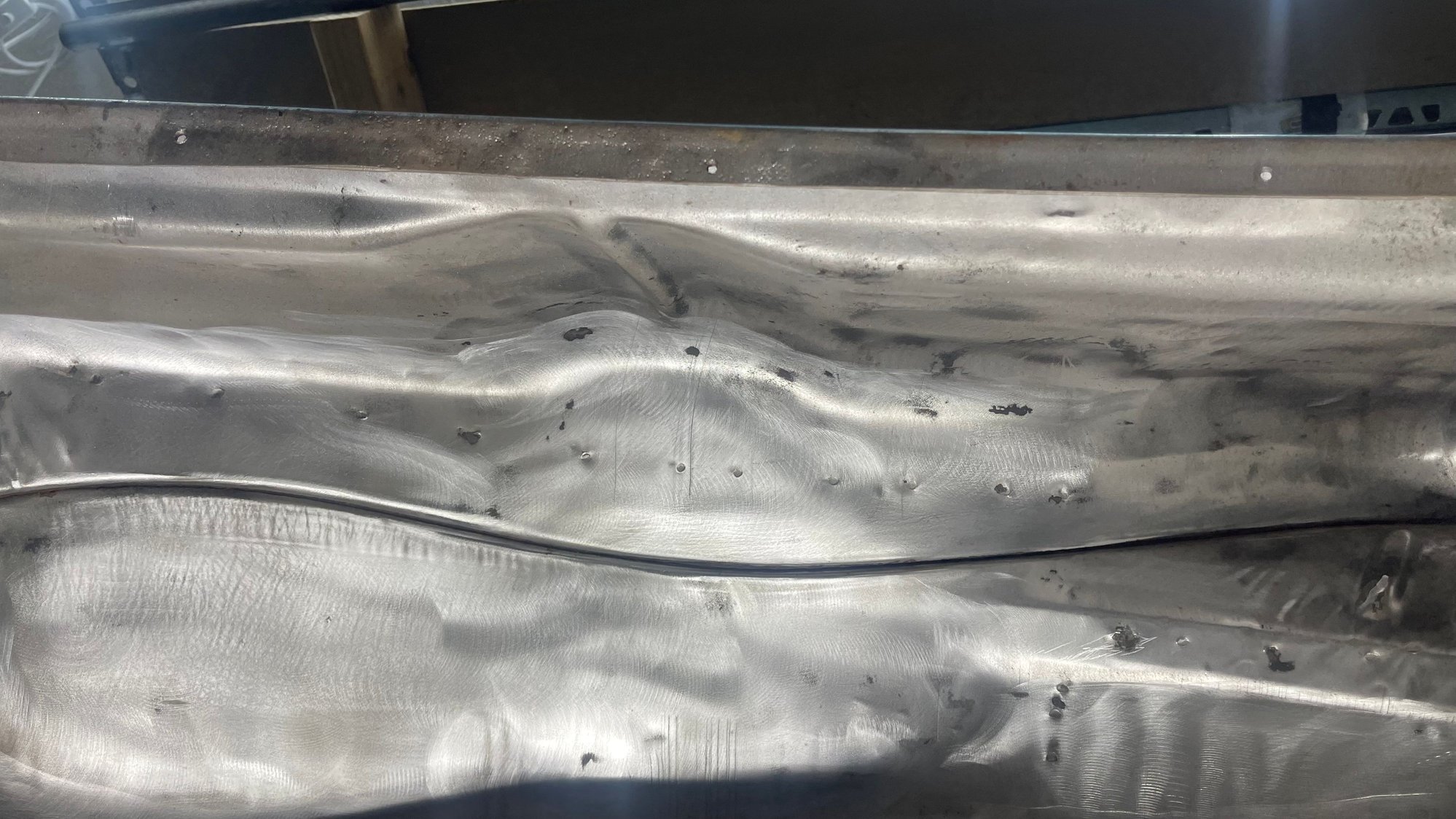

ok, been a while since i have updated anything on the build. i've been kinda slacking this year, but i am starting to get moving. i have 95% of the parts i need to get the engine started, there are still a few odd and end things that are needed. the carburetor from ken at everyday performance looks amazing, if it performs as good as it looks, i'll be good. lol i have had the original radiator recored, i have the original delco alternator rebuilt and ready to go. i am still on the fence about adding vintage air conditioning, i guess that's something i will be deciding over the next couple of weeks before the fenders get remounted. only thing left from OPG to complete the interior kit is the arm rest pads, 9 days will make one year they were ordered and paid for, still have no idea when they will get here, status shows "eta pending"
i started cleaning up grinds and welds in the wheel well area. i want to get the exterior side of the wheel wells done so that i can get the car back on the frame. the passenger side is done, i just started on the drivers side and i have all of the rot that was in the car completely cut out now. i finished cutting out the bad patch work from previous owners and the rusted skins they left underneath of the lower rear quarter patch on the drivers side. i bought a full sheet of 18ga steel and started doing some banging with my hammer and wouldn't you know, i was able to fabricate a pretty darn close quarter panel patch for the drivers side between the wheel well lip and the door jamb. i have to make panel for the rear lower quarter, part of the inner wheel well, and part of the trunk drop off, i have been on a mission once again, so i should be done with all patch work soon. the mission is to have it back on the frame soon so i can gain some space in my garage again. my 18'x22' garage has served me ok, but i'd like on car space back. lol

Old Mar 22, 2023 | 07:47 PM
  #173
65droptop's Avatar
Posts: 421
From: florence,ky

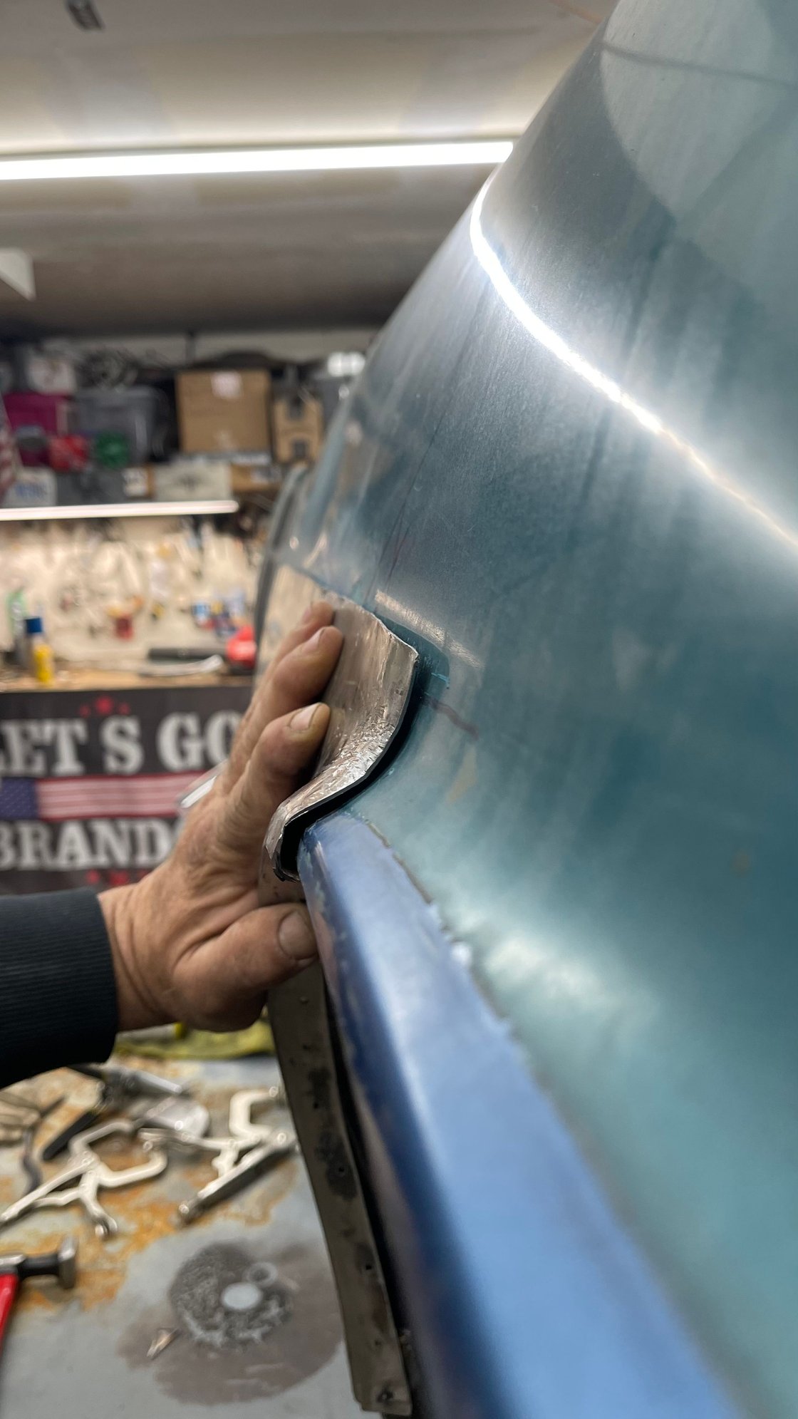

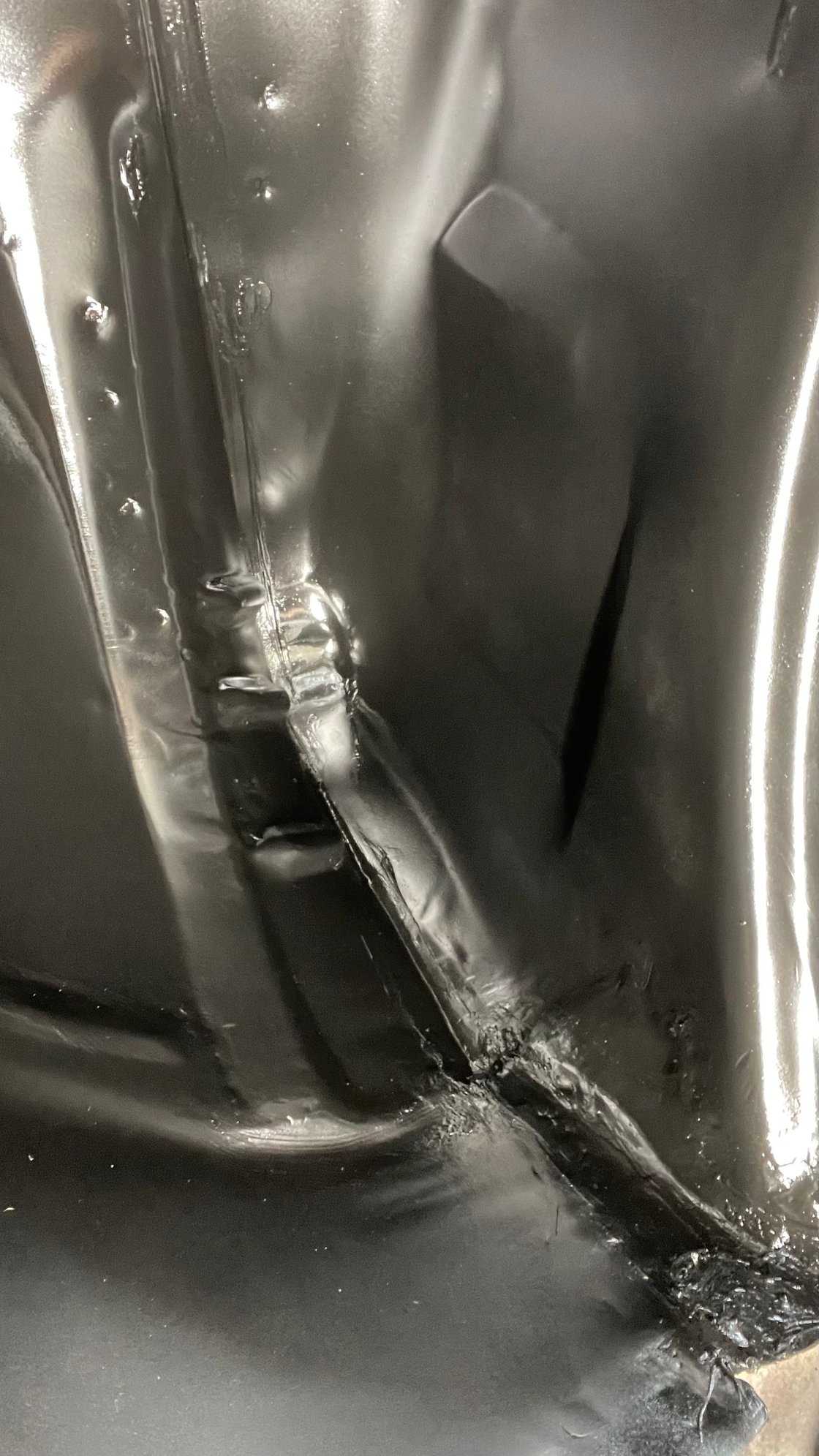

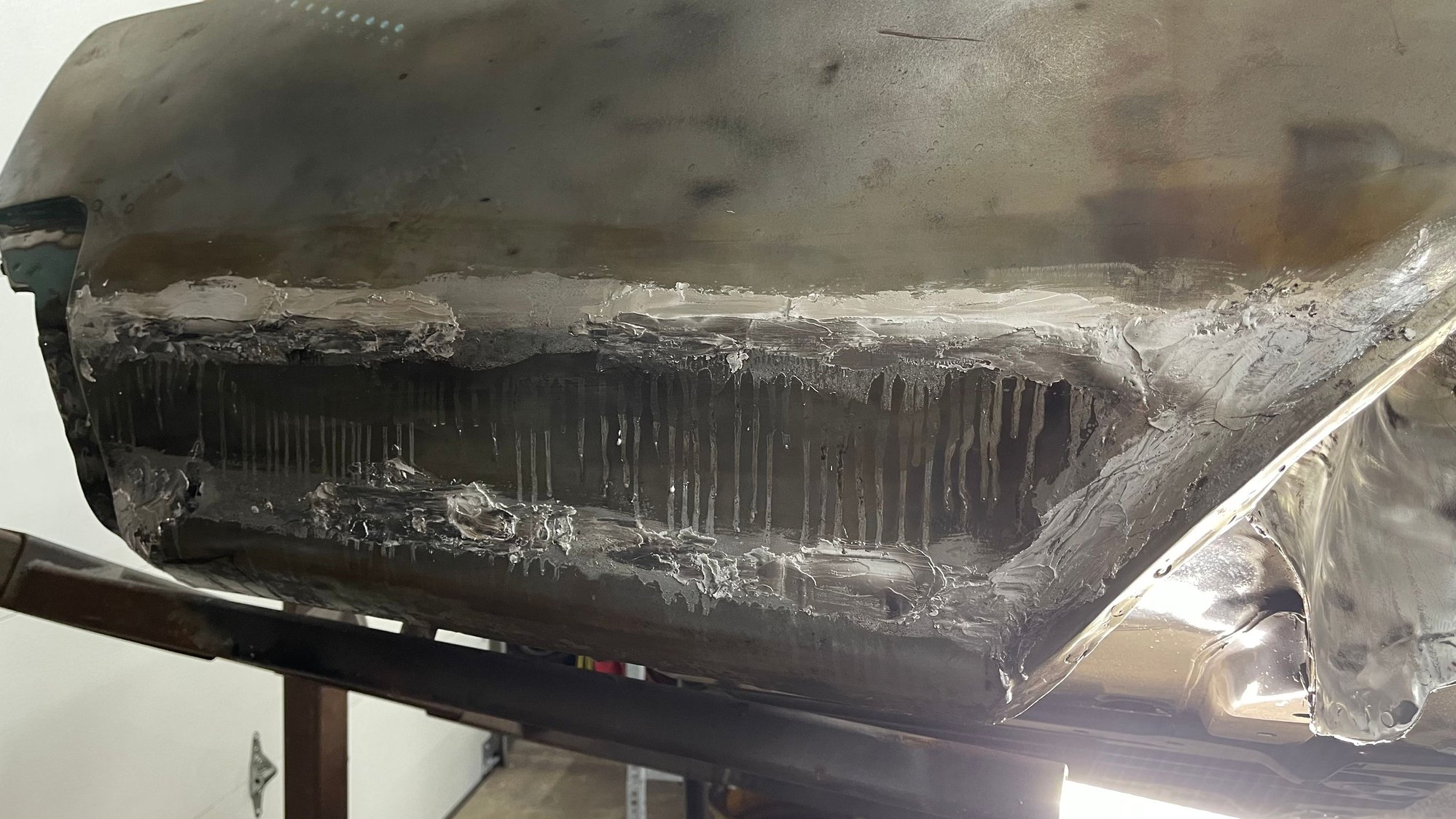

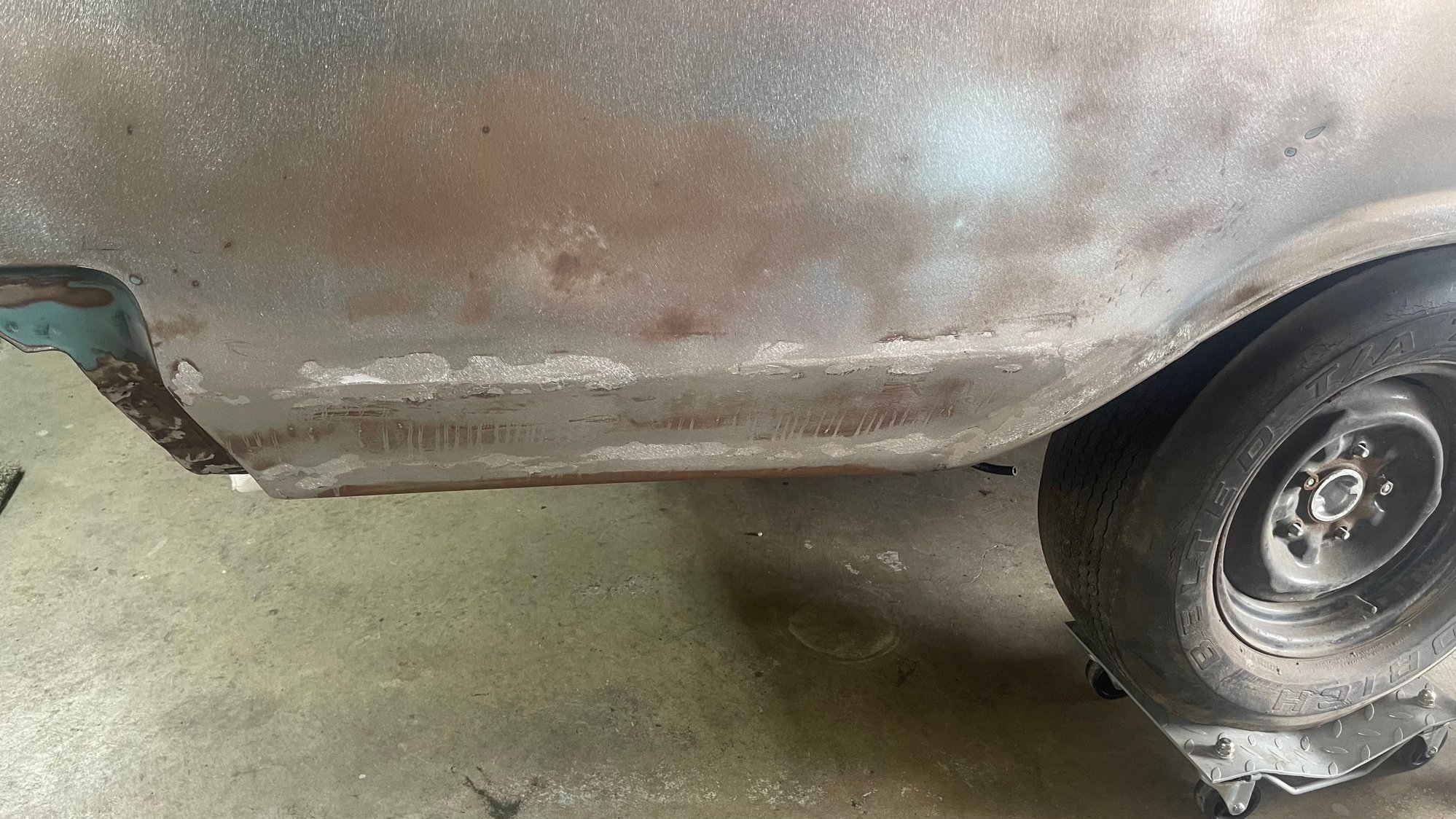

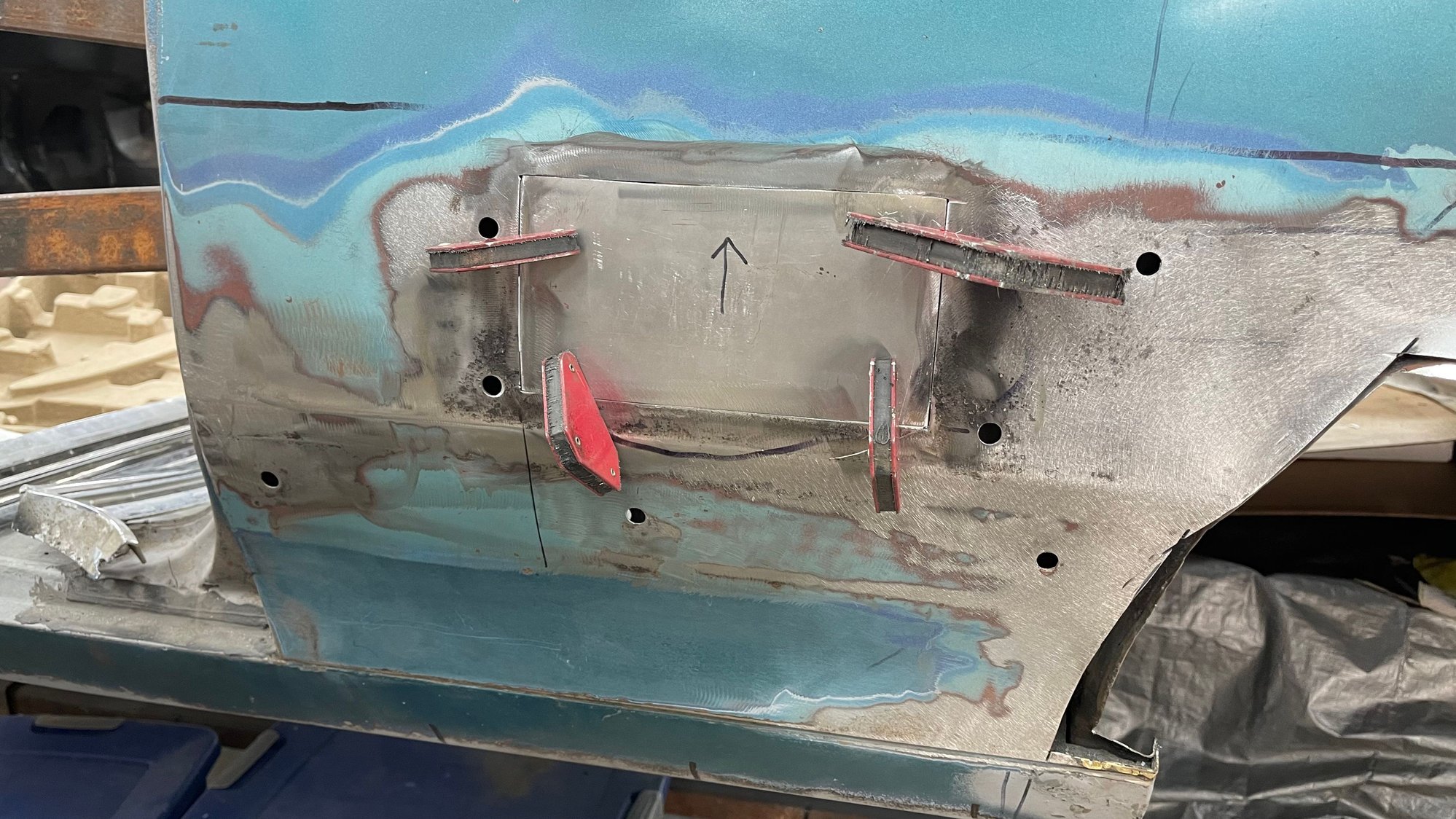

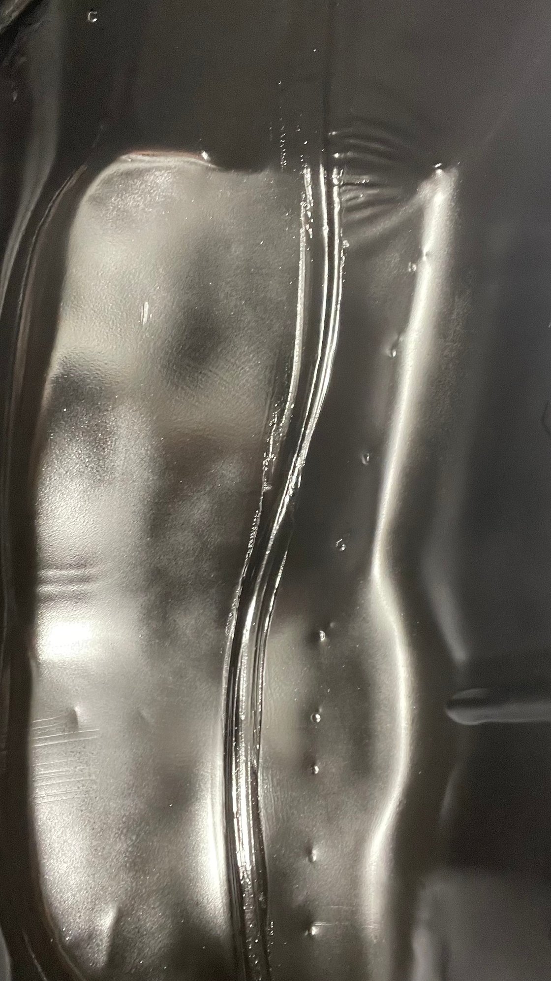

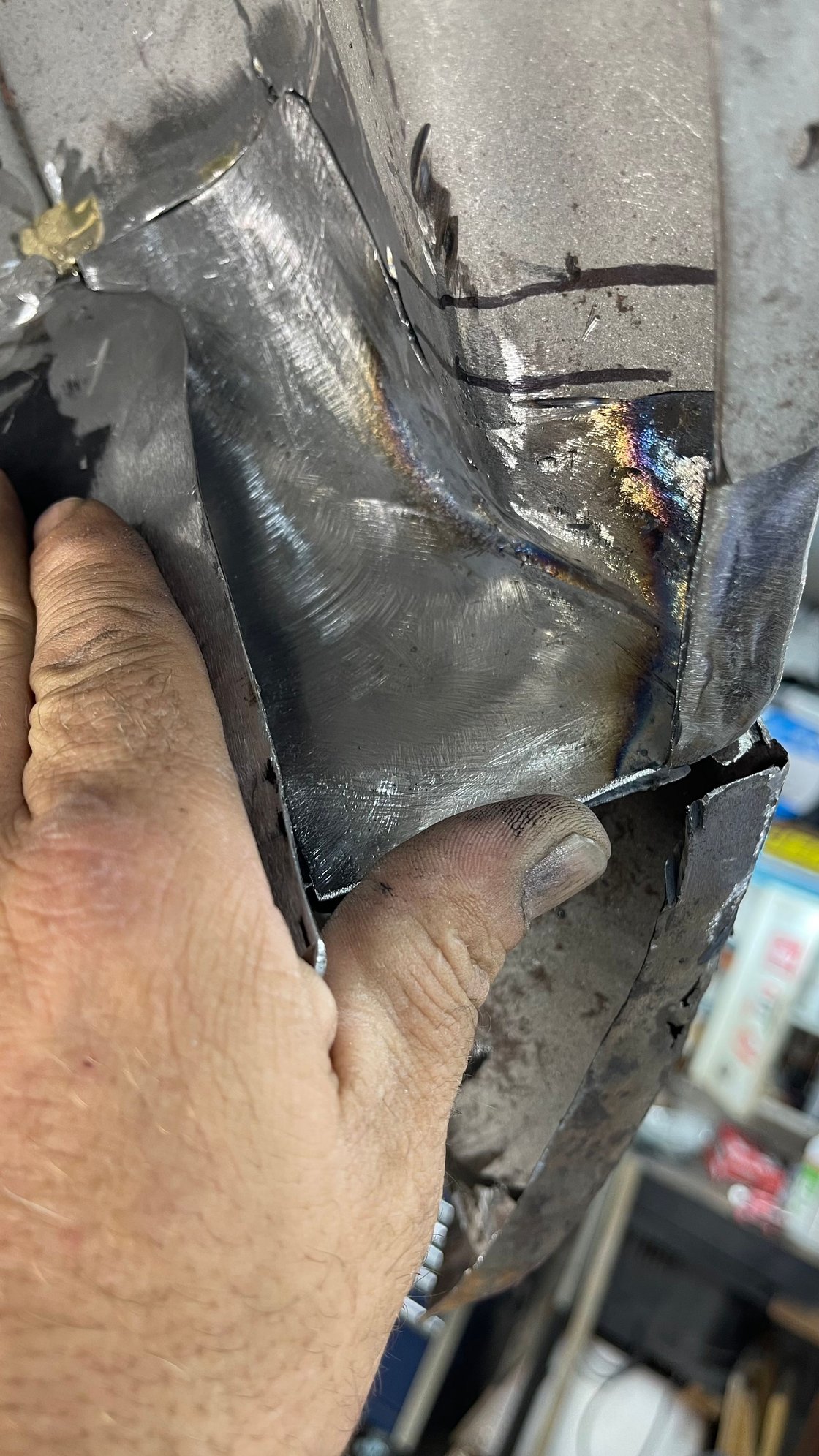

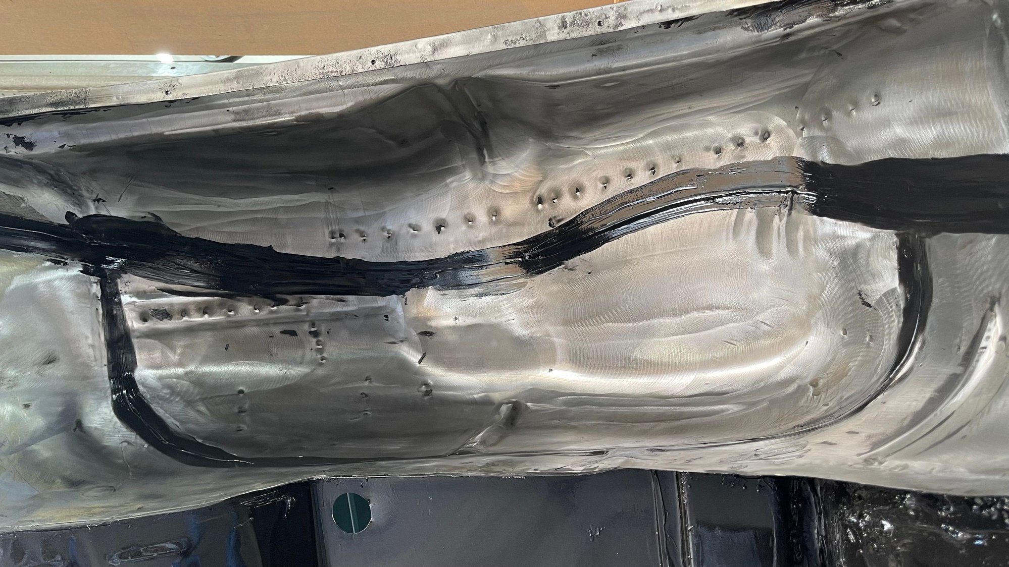

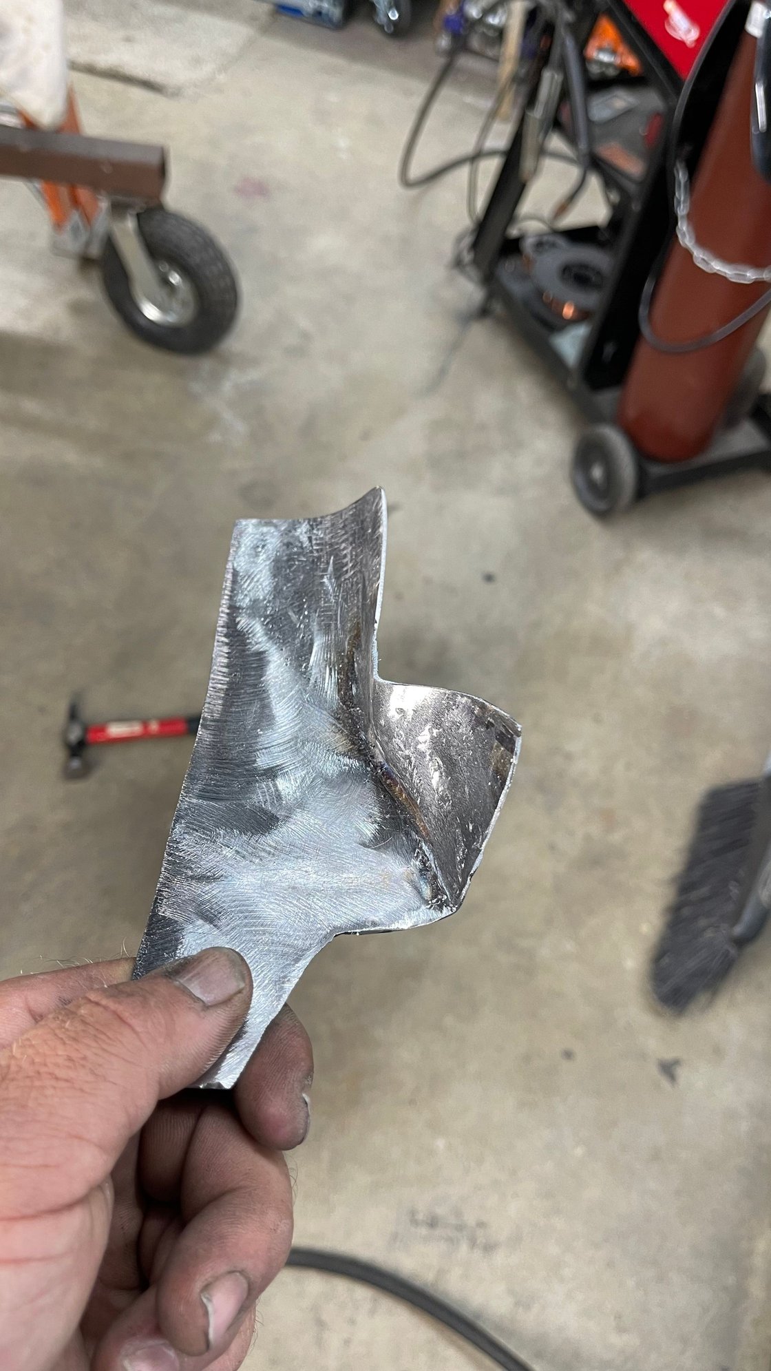

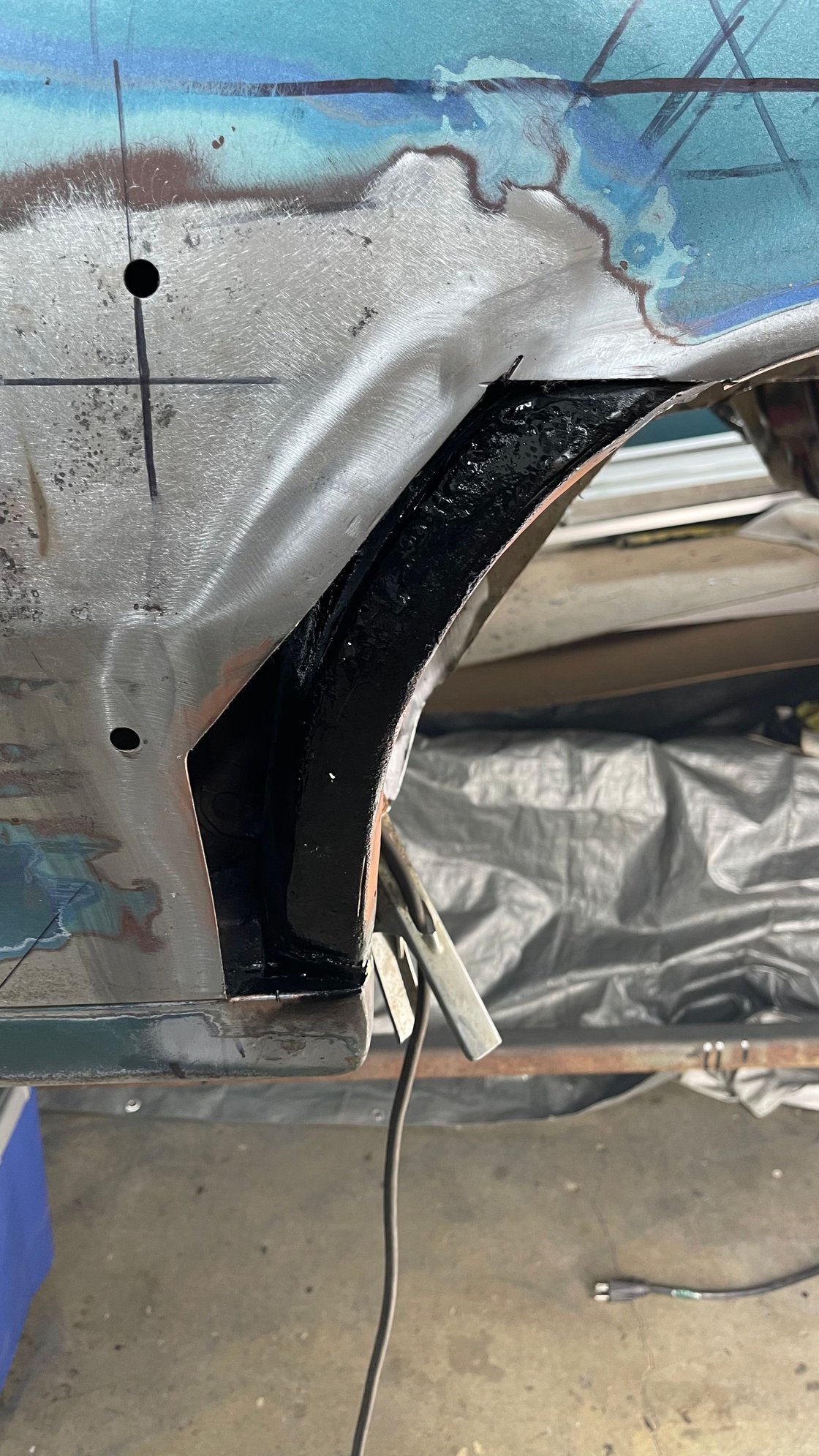

i learned how to spread some lead, i used it on the welded seams on the wheel wells, as well as the rear trunk floor where i welded the new floor to the existing floor. the trunk seam needs touched up again, but the wheel well turned out nice. not bad for a first timer.

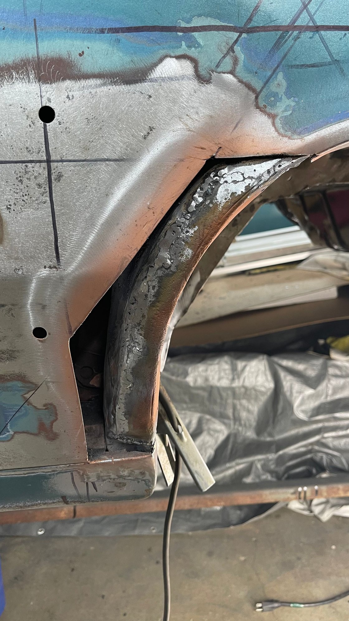

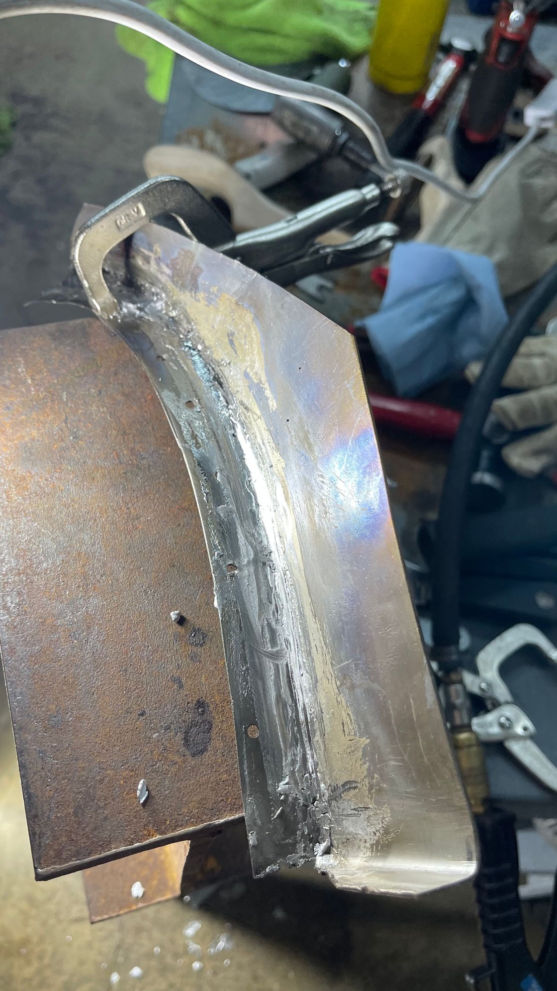

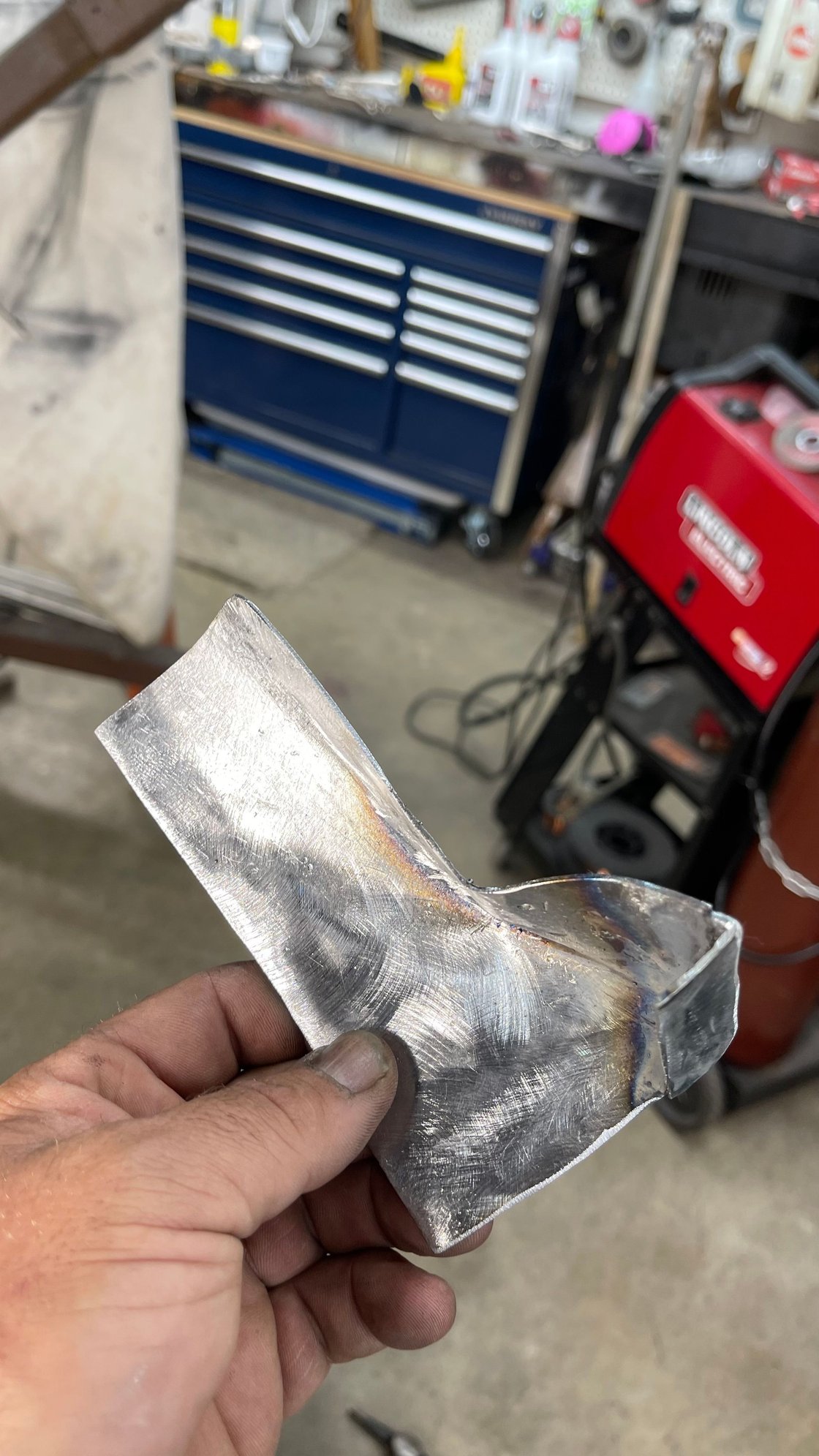

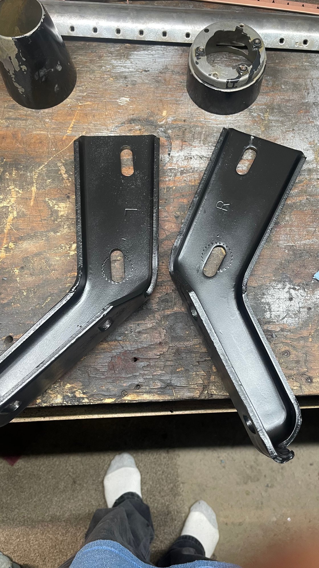

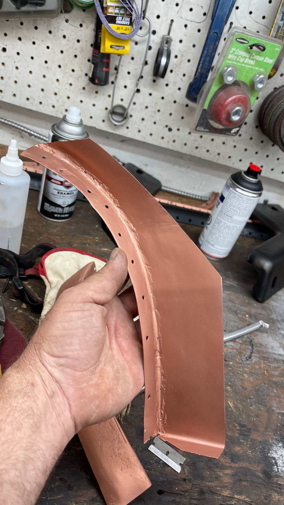

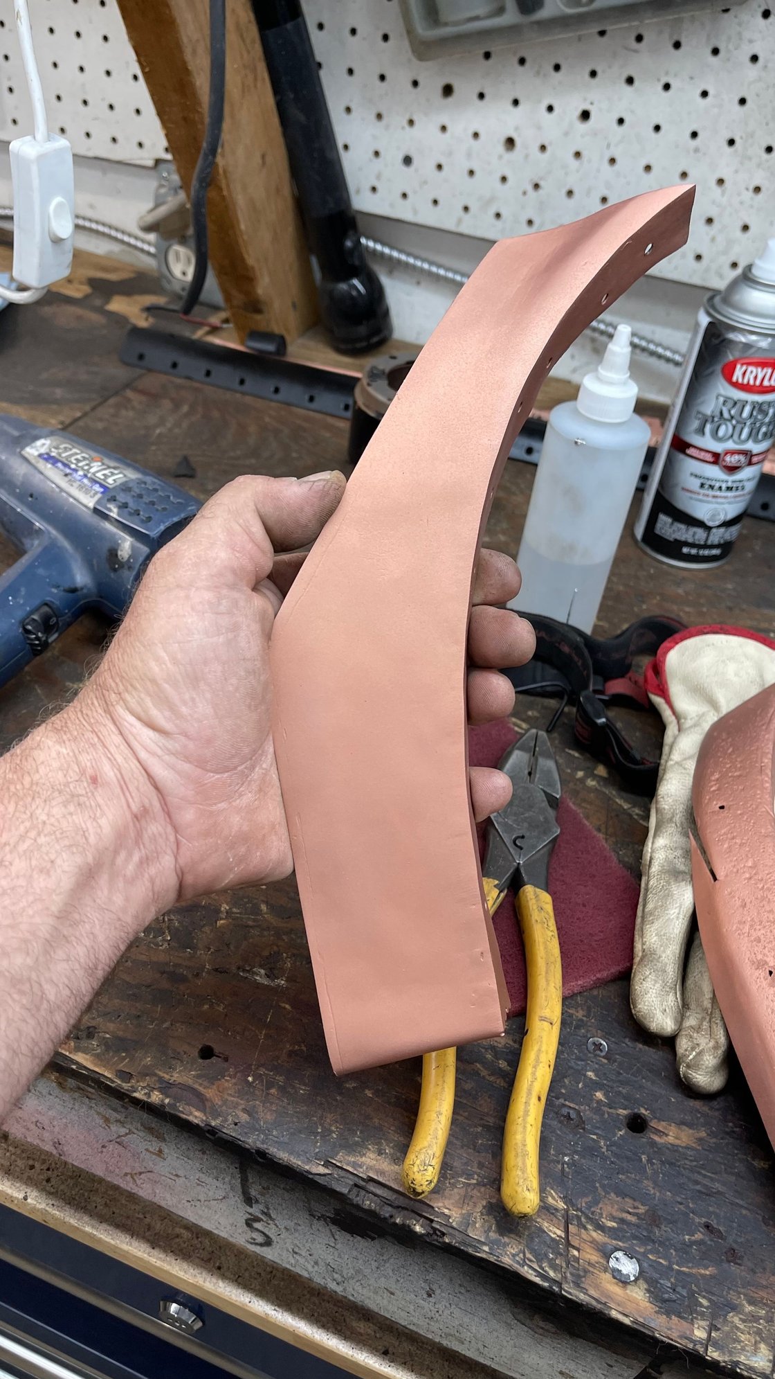

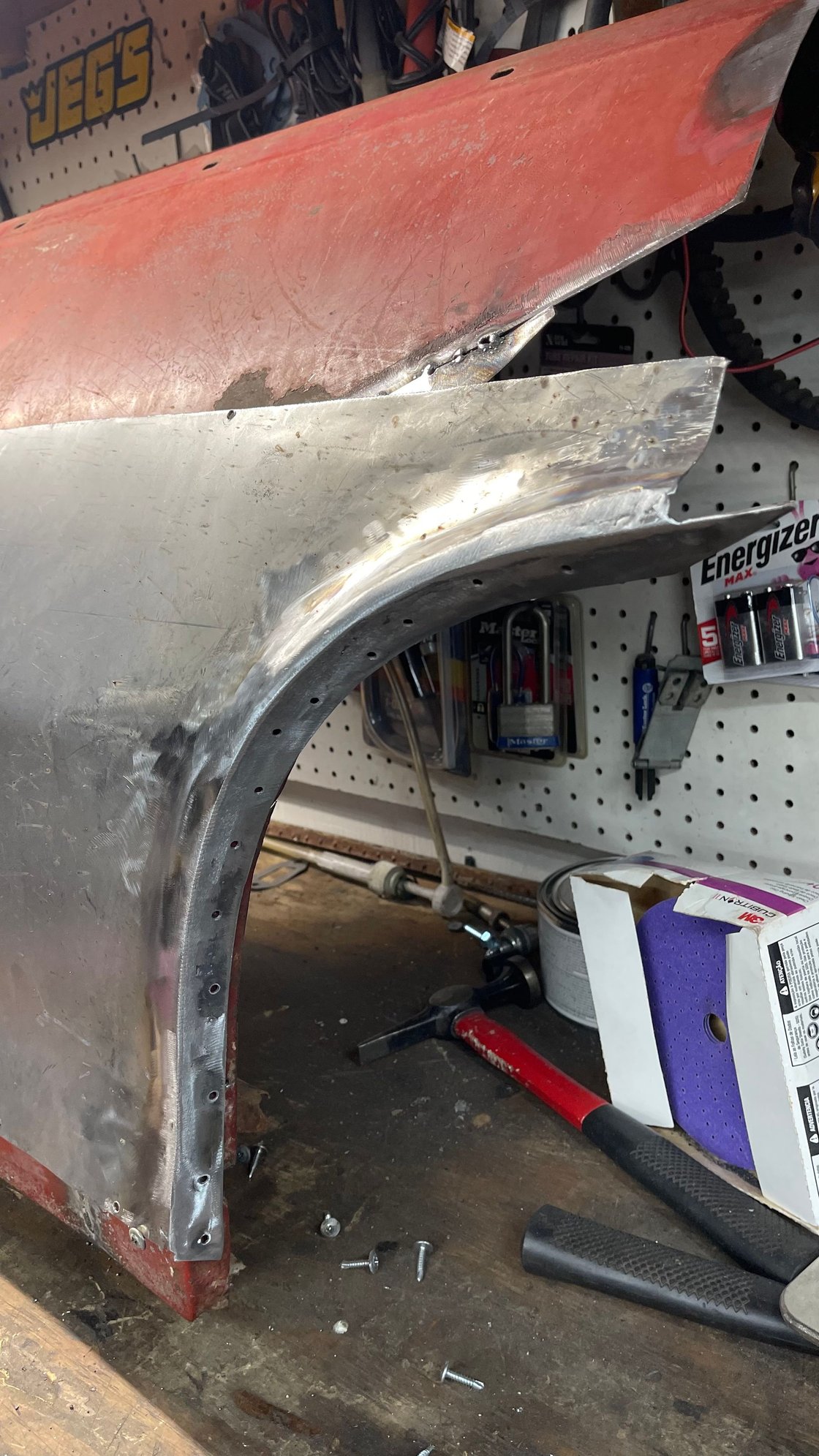

All though I spent the time to make that panel, I’m only going to use the part around the wheel lol, that way I keep my patch minimal. Low and be hold, a piece of scrap was a few passes on the grinder from being just right on the width, I just had to cut the height a little. Soon as I get done working the little dings with a hammer and dolly, I will weld that piece in to place. I was able to save the factory holes on the rear lower and should be able to keep my repair below there. The trunk drop down will also need some attention on this side. Once the sheet metal work is done, I will paint the the inner wheel wells so that I can then put the car back on the frame, one last time. Then I can put the car in epoxy primer, mount all of the body parts to get my gaps all squared away, and aligned properly before paint. Won’t be long if I stay on pace, and get out of the winter funk I’ve been sunk into.

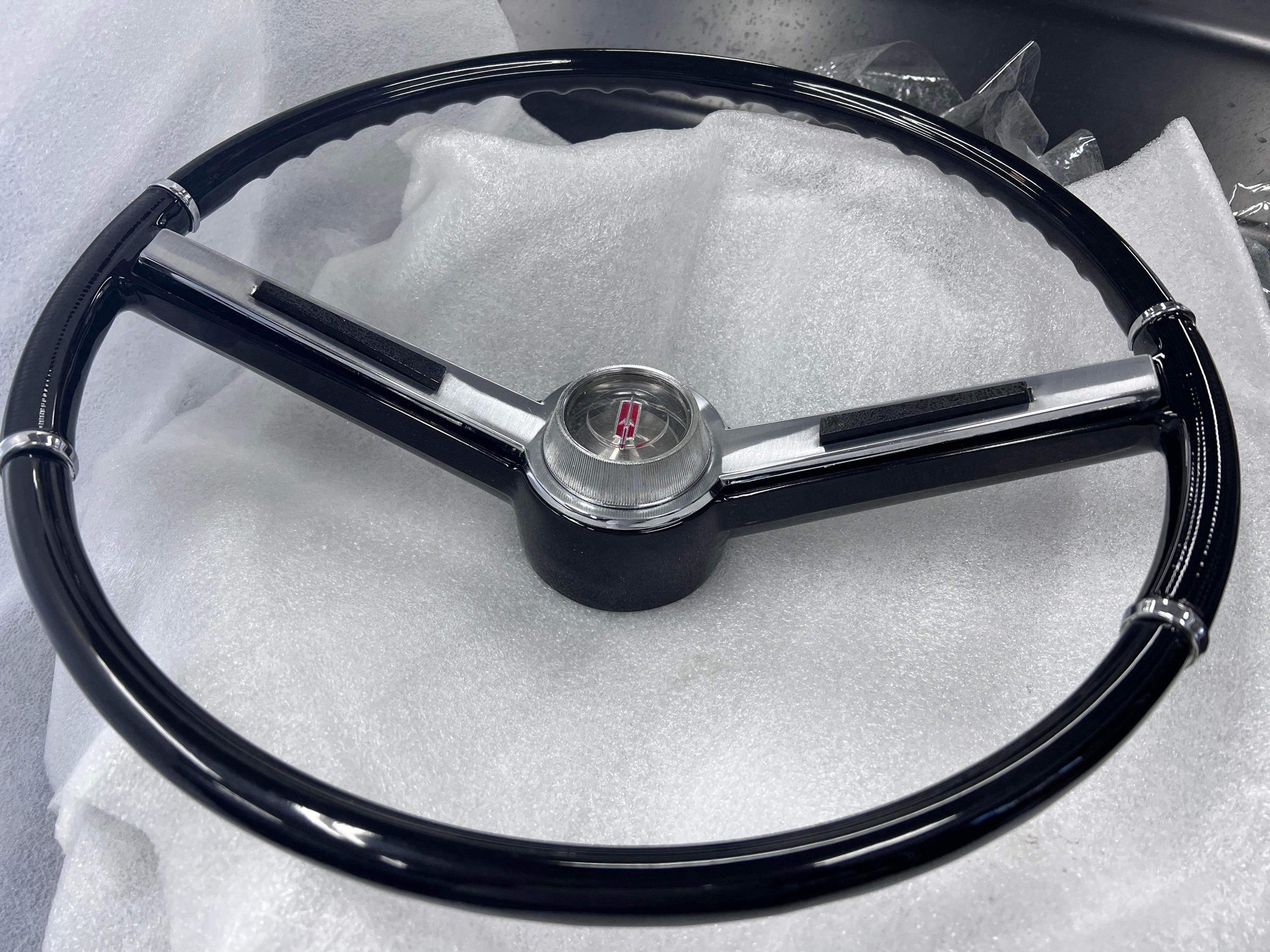

Let us not forget this amazing steering wheel I scored from Peter, this thing is purdy. Pictures don’t do it justice

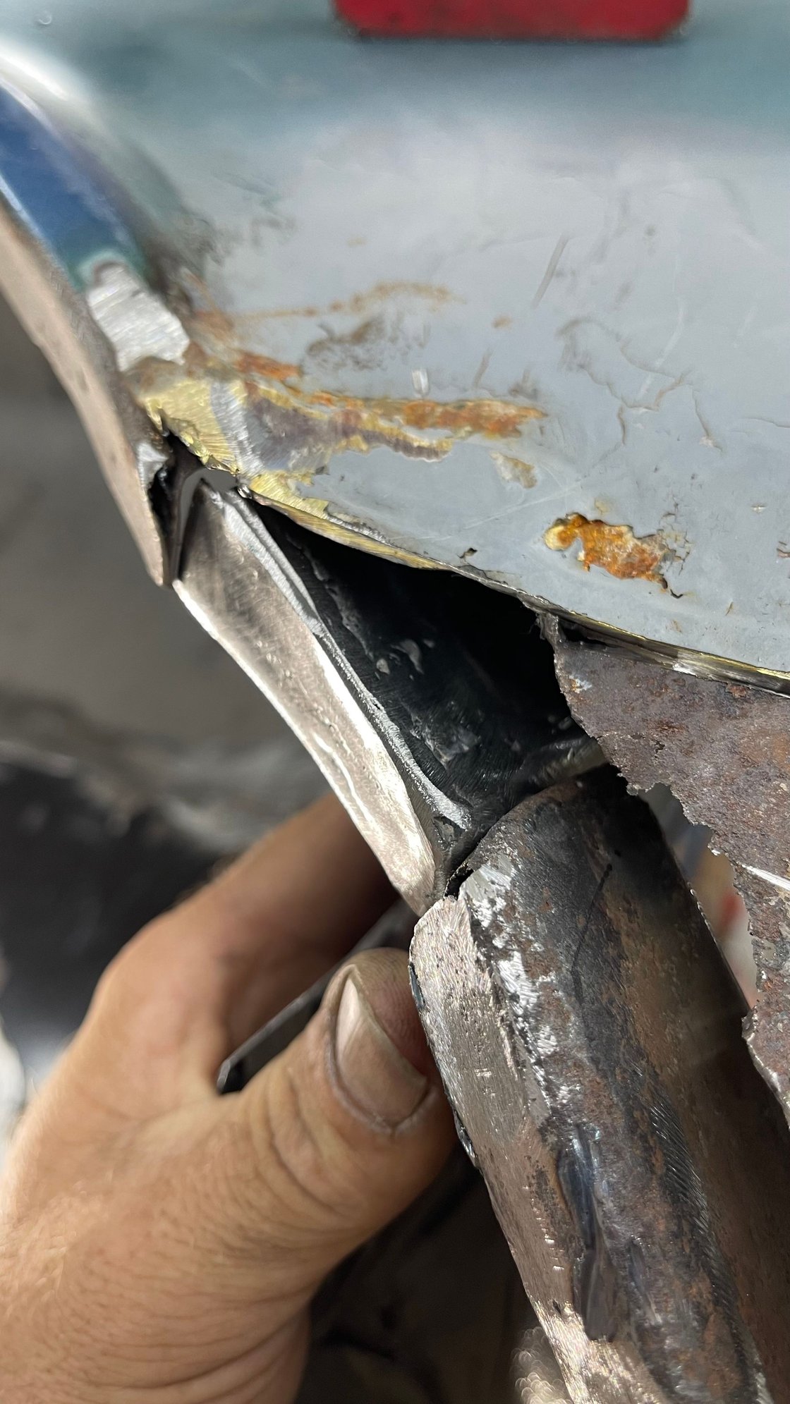

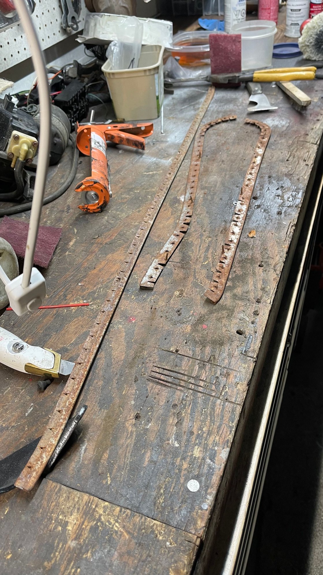

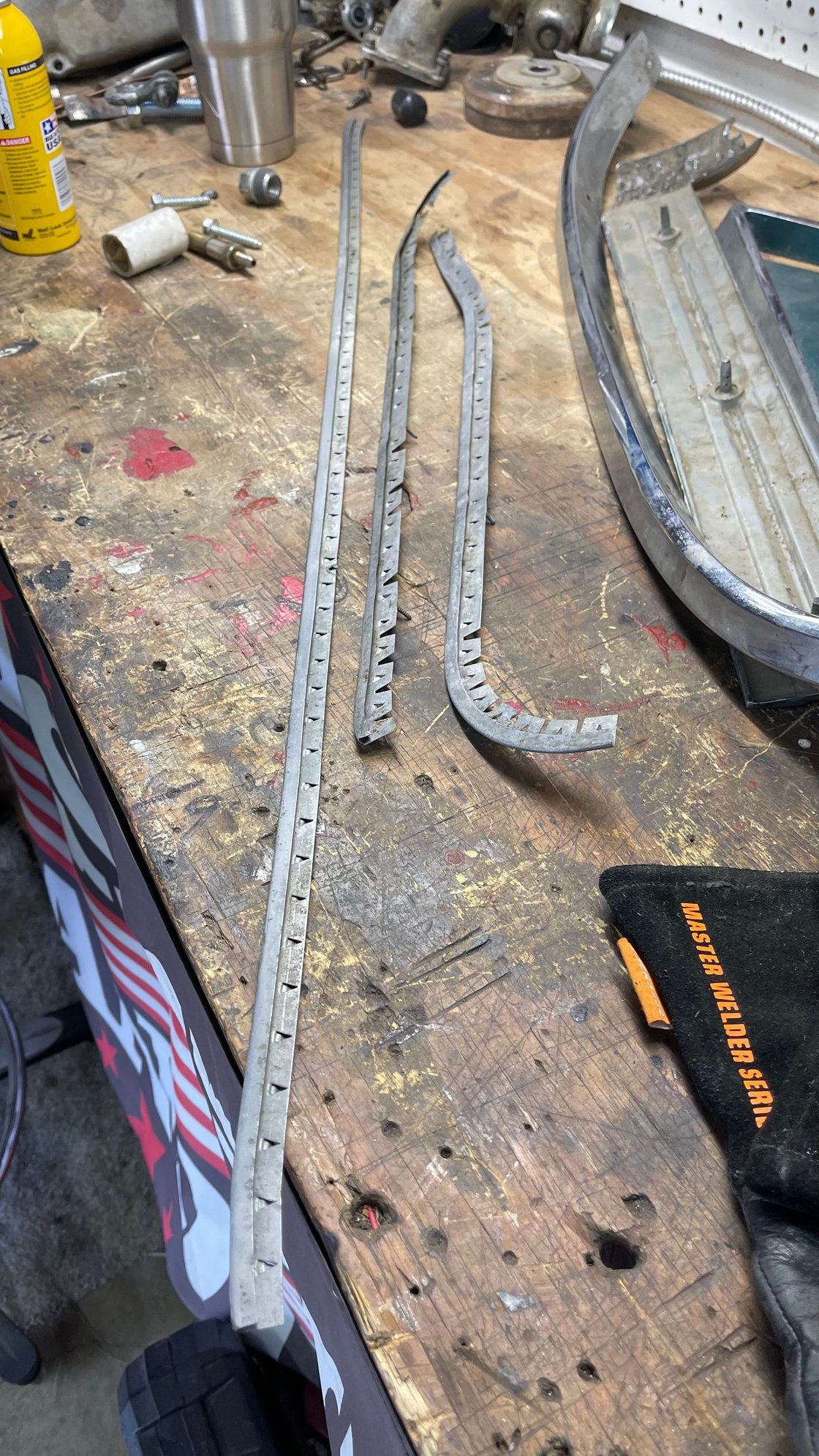

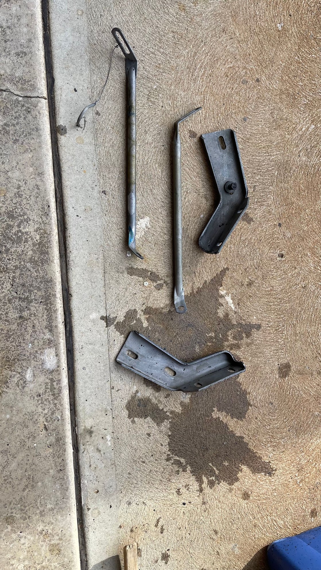

I pulled one of the door panels apart and found the tack strip at the bottom and sides that holds the vinyl, and also provides studs for mounting the door panel to the door itself. They were rather rusty and I knew sandblasting would destroy them, I searched alternatives for rust, considered electrolysis, but then saw videos on muriatic acid, it works. 1to 1 mix with water, soak in a plastic tub, walk away and forget it, go do something else. I soaked the front bumper brackets over night, they were pretty rusted and turned out great

Nice work
Very impressive metal work my friend, did you
use lead or lead free body solder? I used the lead free from Eastwood I actually like it, carb came out beautiful your moving right along !!

thanks Eddie, what ever it is that Eastwood is selling is what I used, I believe it is the lead free body solder, it was the 1/4lb sticks they’re selling. Barring any set backs, I should have the body back on the frame in a couple weeks
Old Mar 24, 2023 | 11:21 AM
  #180
65droptop's Avatar
Posts: 421
From: florence,ky
Eastwood sells both I used the stuff came in the tube there’s 4 sticks or rods , anyway if using the other be careful with dust , etc. great work just great

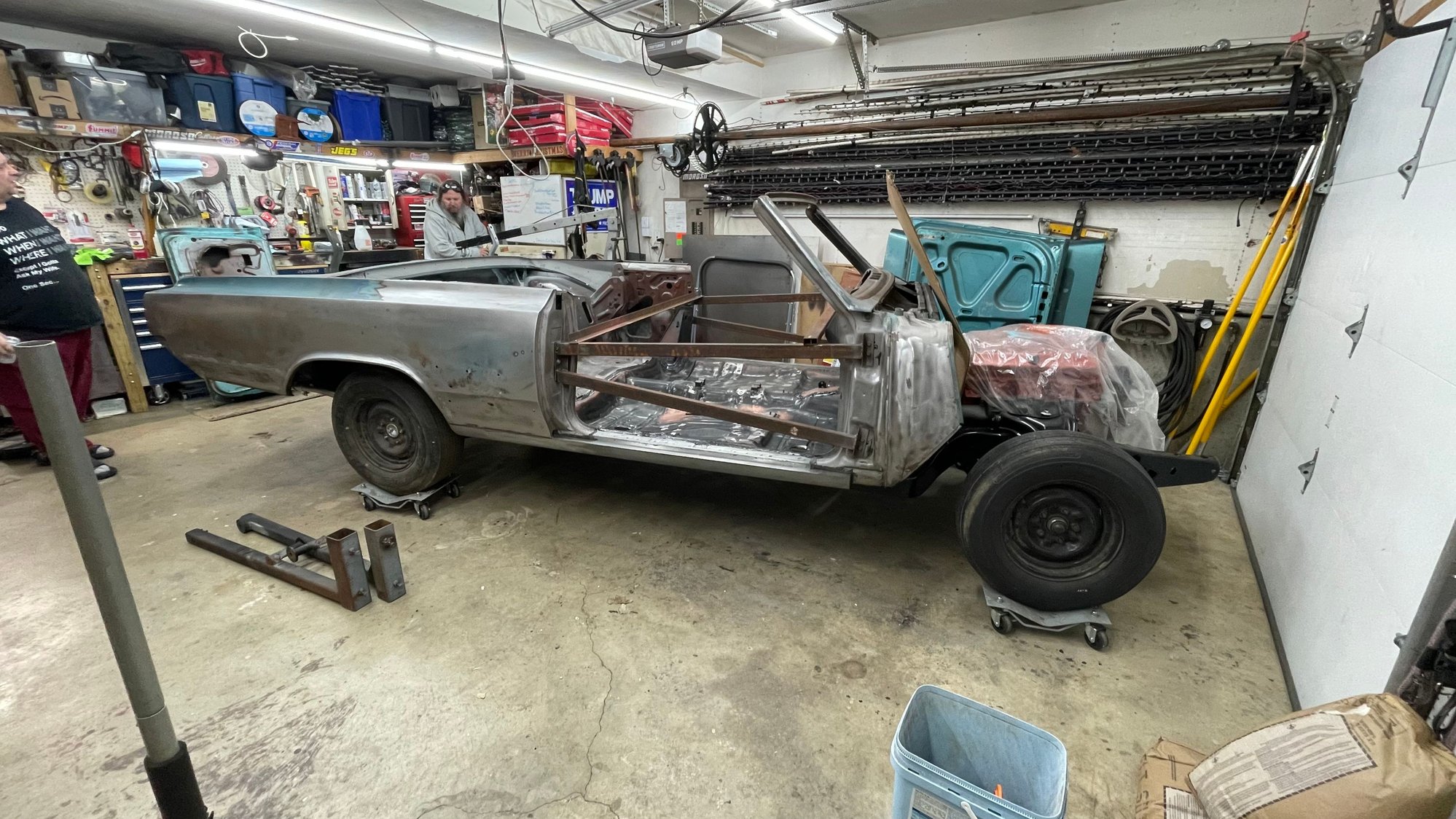

i just realized it's been a year this month i started this build, amazing how time catches up. i understand now how these things can get in to the "years" category on being complete. well, here's to year two. lol
wheel lip is welded in place, started on the patch behind the vent scoop. i am going to start banging out the rear lower quarter patch as soon as i am done typing this post. lol

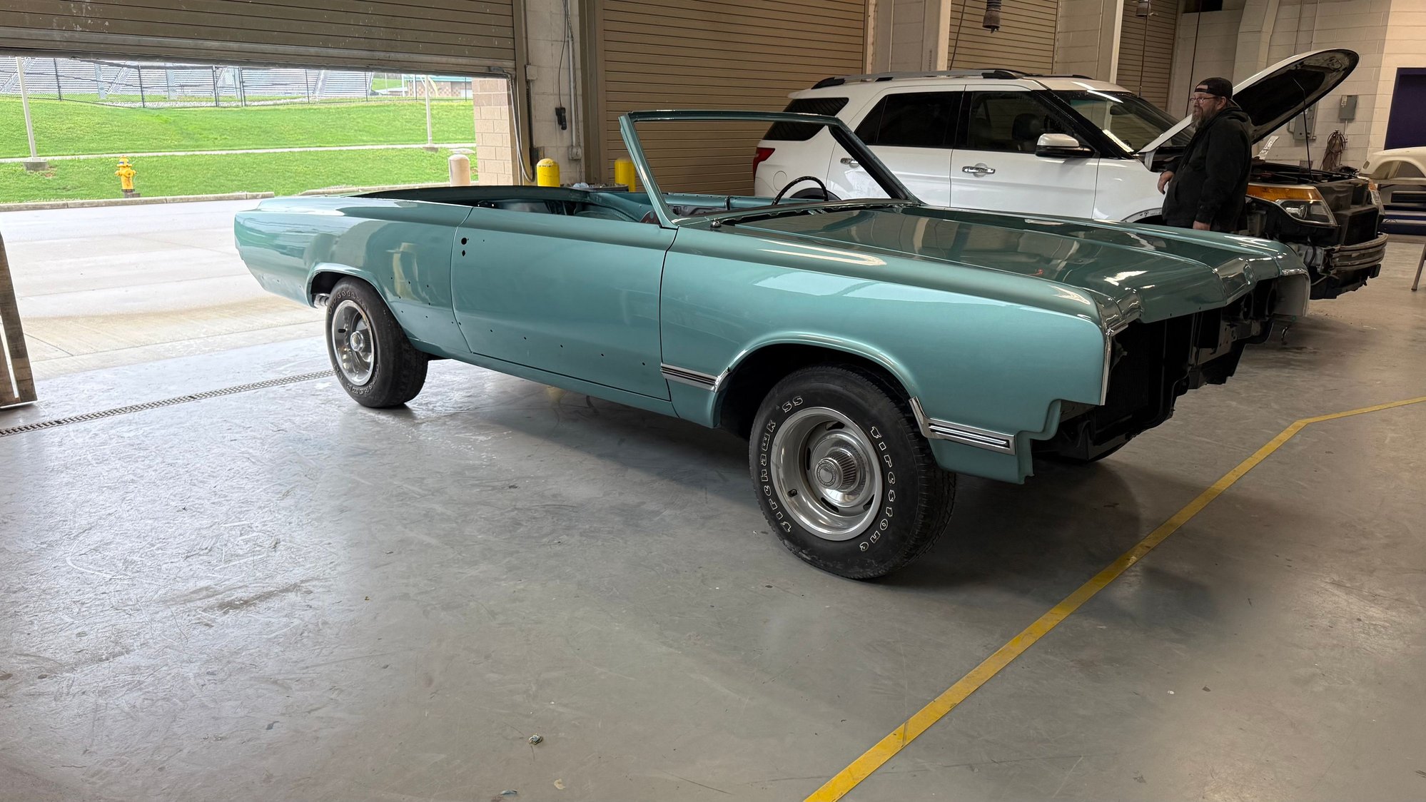

Old Apr 7, 2023 | 12:31 PM
  #185
65droptop's Avatar
Posts: 421
From: florence,ky

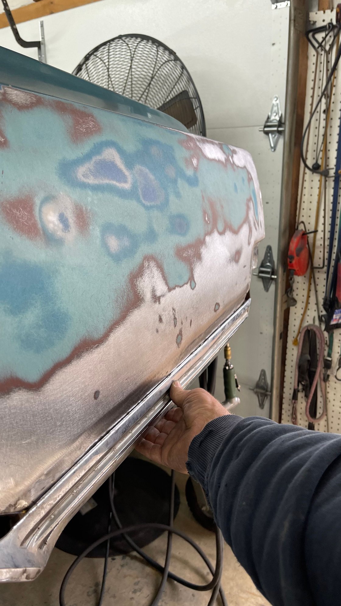

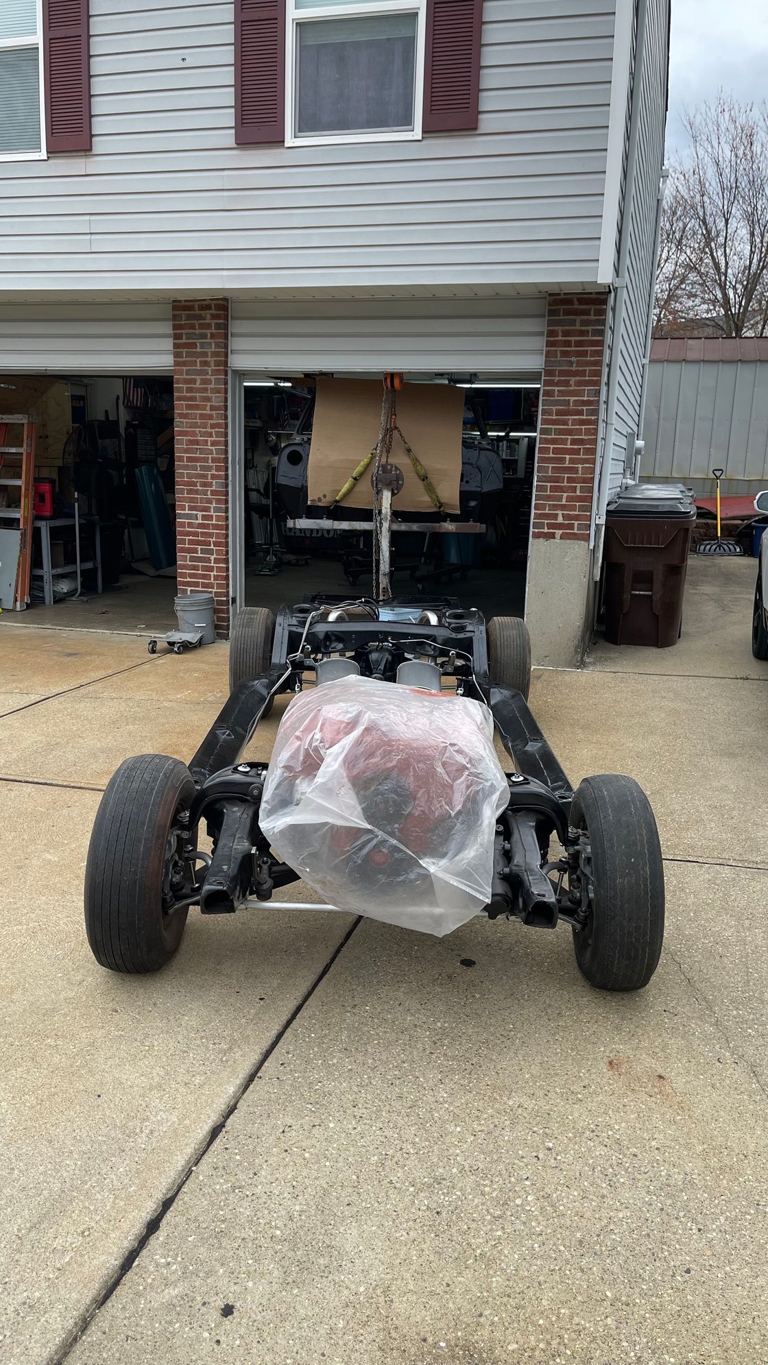

major milestone lastnight. the body is back on the frame!
All of the seams from repairing rusted metal, and adding latch panels, has been lead filled for any minor imperfections and possible pin holes. Still have to hammer and dolly some spots, but it’s getting there, and it won’t be full of plastic filler, just a basic skin coat for final paint.
Wheel wells are seam sealed and painted.After the lead work, I smear some seam sealer once again over the seam. Over doing things is my style.

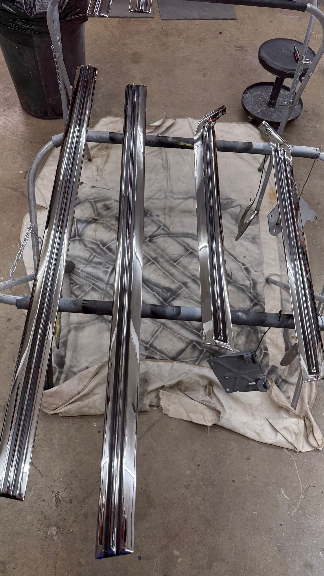

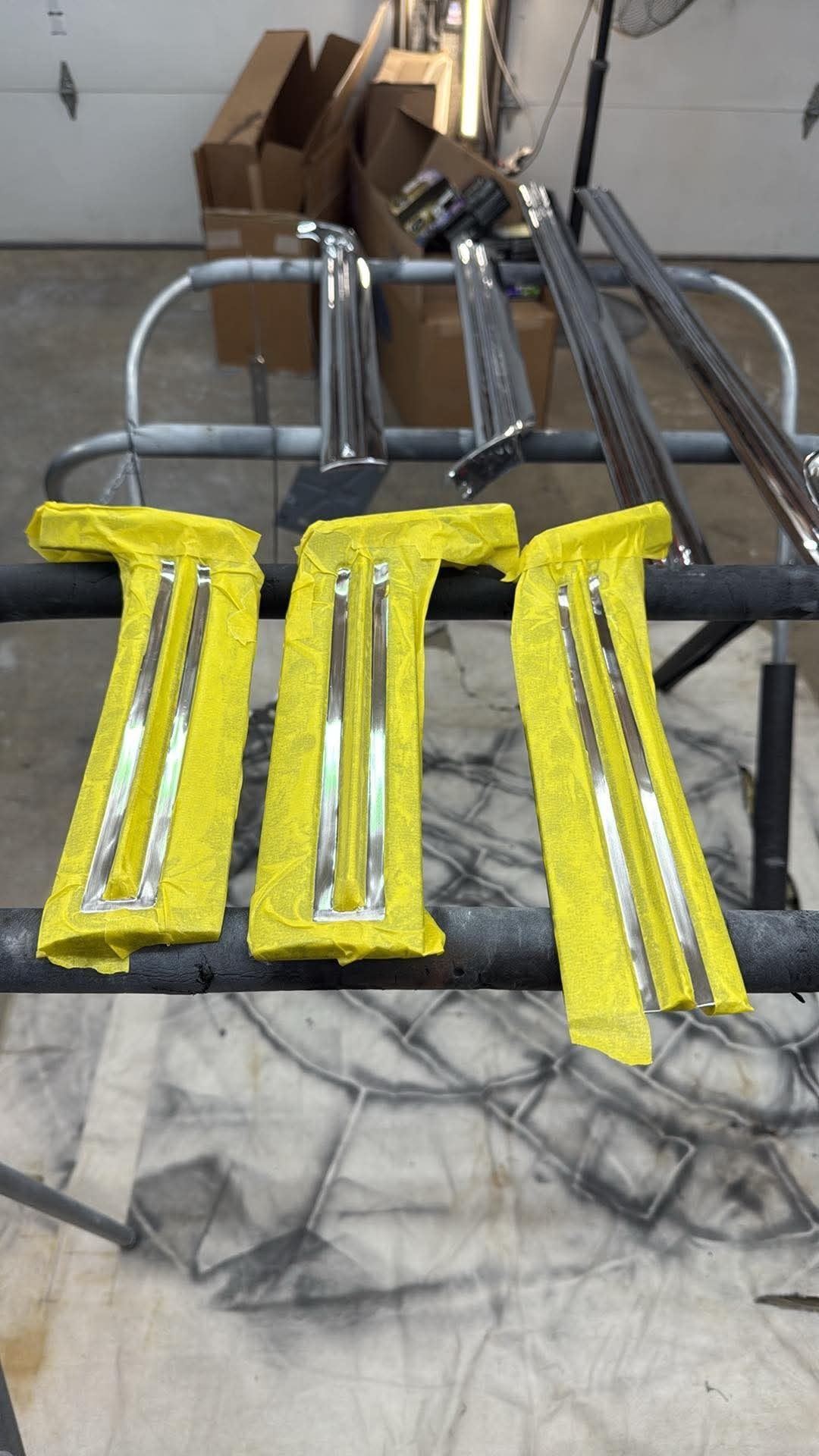

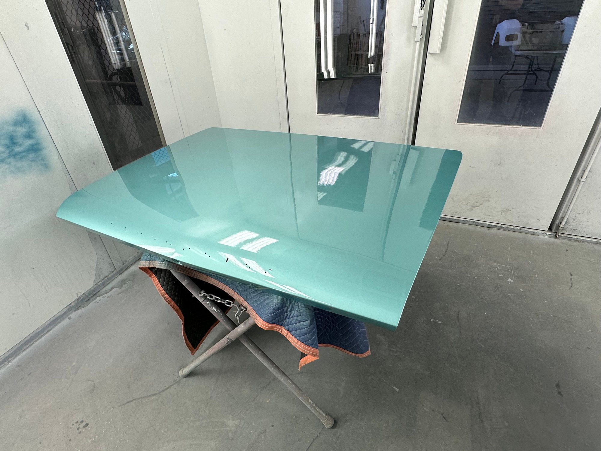

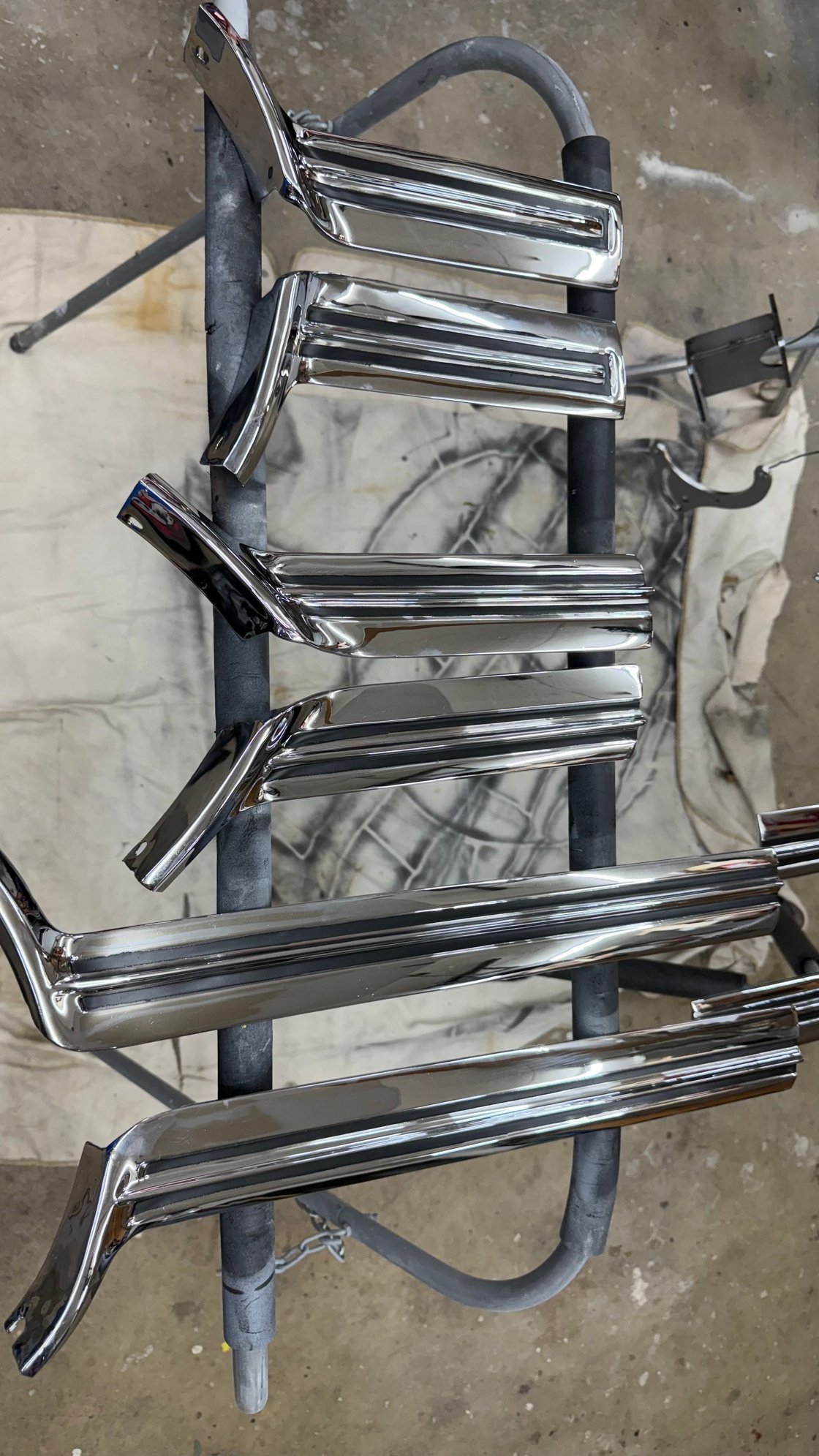

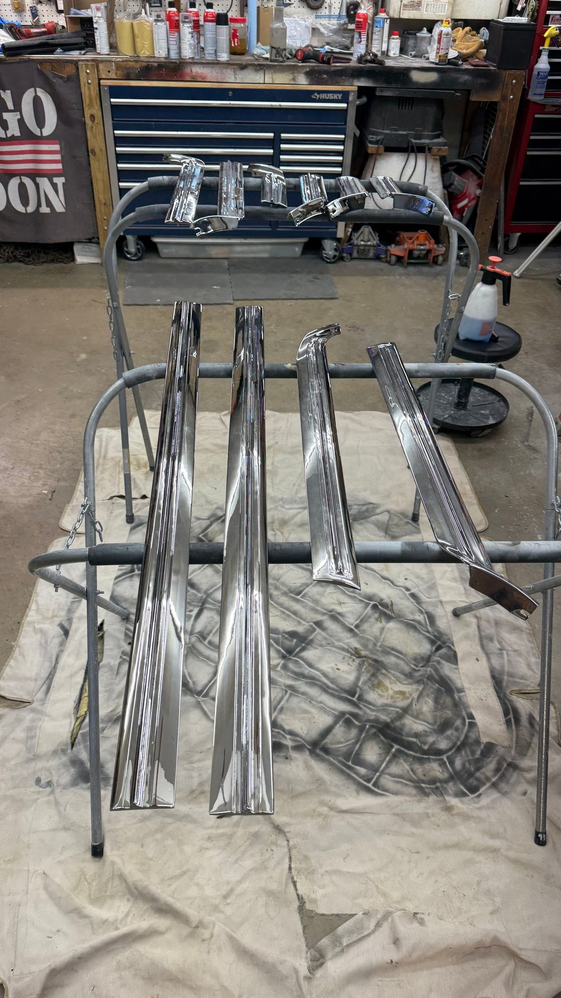

well, i got my grown mans version of diamonds, my bling came back the other day and i have to say, it looks great. Chip at tri city plating did a fantastic job, on cost, two weeks earlier than quoted. i would not hesitate to send him another. this bumper was a NOS that had been sitting with the car for who knows how long and had some pitting, it was 900 plus shipping. i am in this bumper total 1075 and i am happy with what i got. now just have to get the front core that is coming to me next week, fix the whole and send it to be done as well.

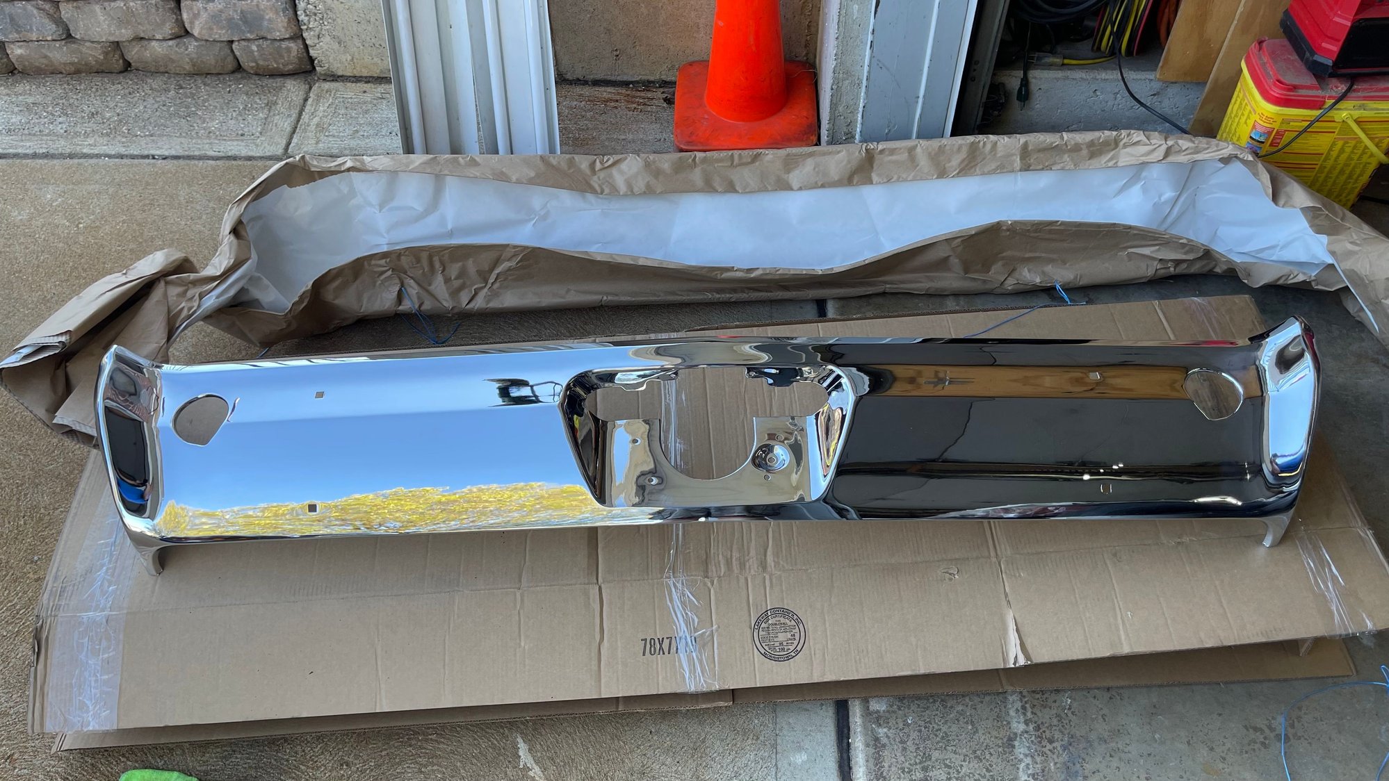

holy smokes! it's really been this long since i have made any updates? damn. sorry for those that have been following along.i have the car running, not driving it yet, but the car just completed the paint process, should be re-assembling here this week. i will post some pics soon.

Great job! Rear bumper looks great. Wish I could find that correct 442 carburetor for my 65 hardtop.

thanks. i got real lucky with that carb,a friend here locally that also has 65's just happen to have an extra one, it was also dated two months prior to the build date for my car so it worked out great. the carb and the shifter handle are the only two parts that weren't with the car when i umpacked all the boxes.

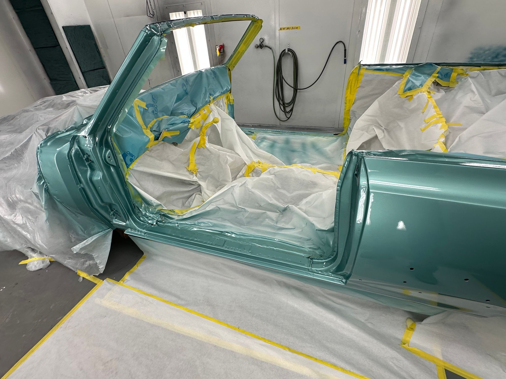

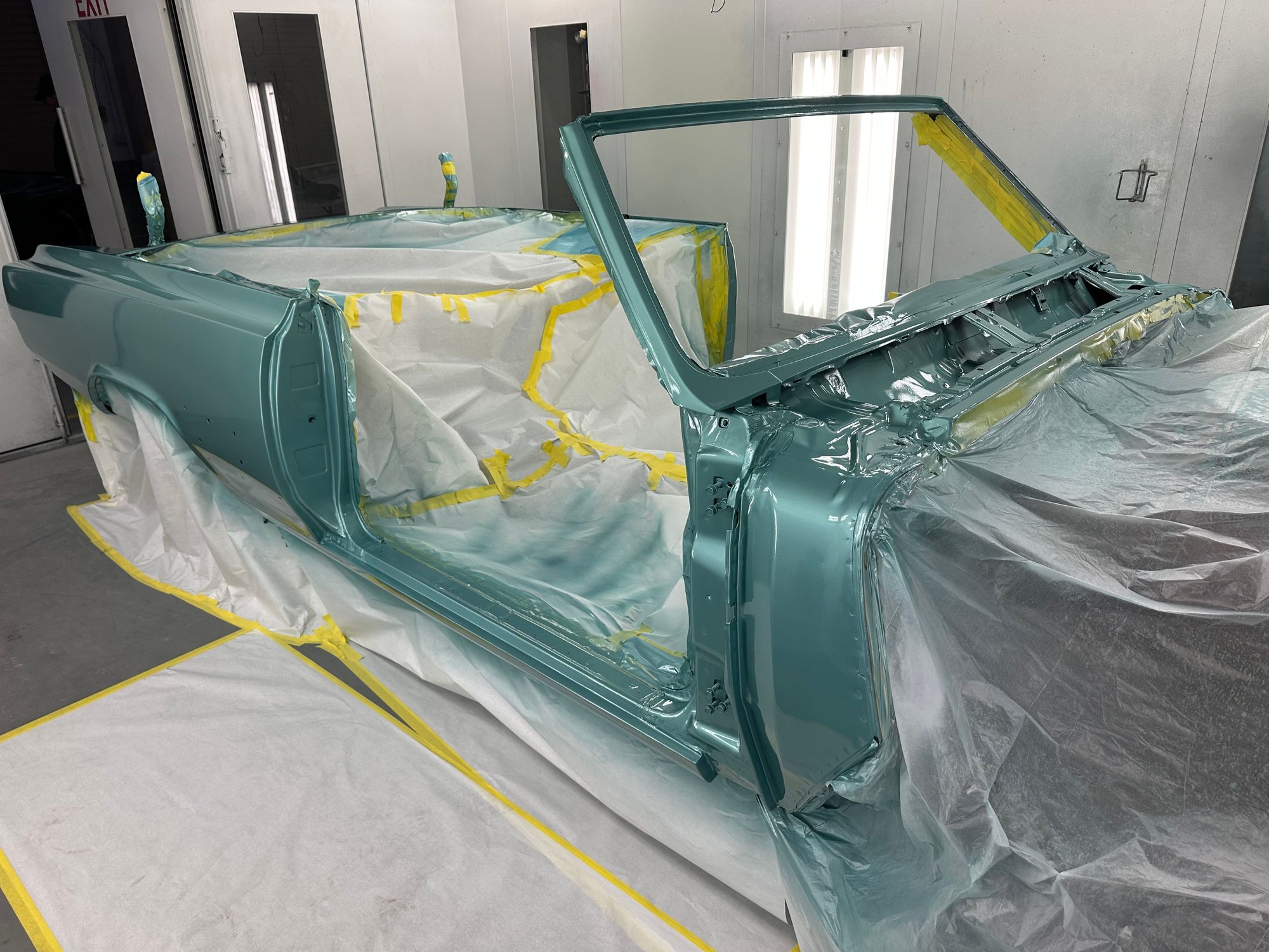

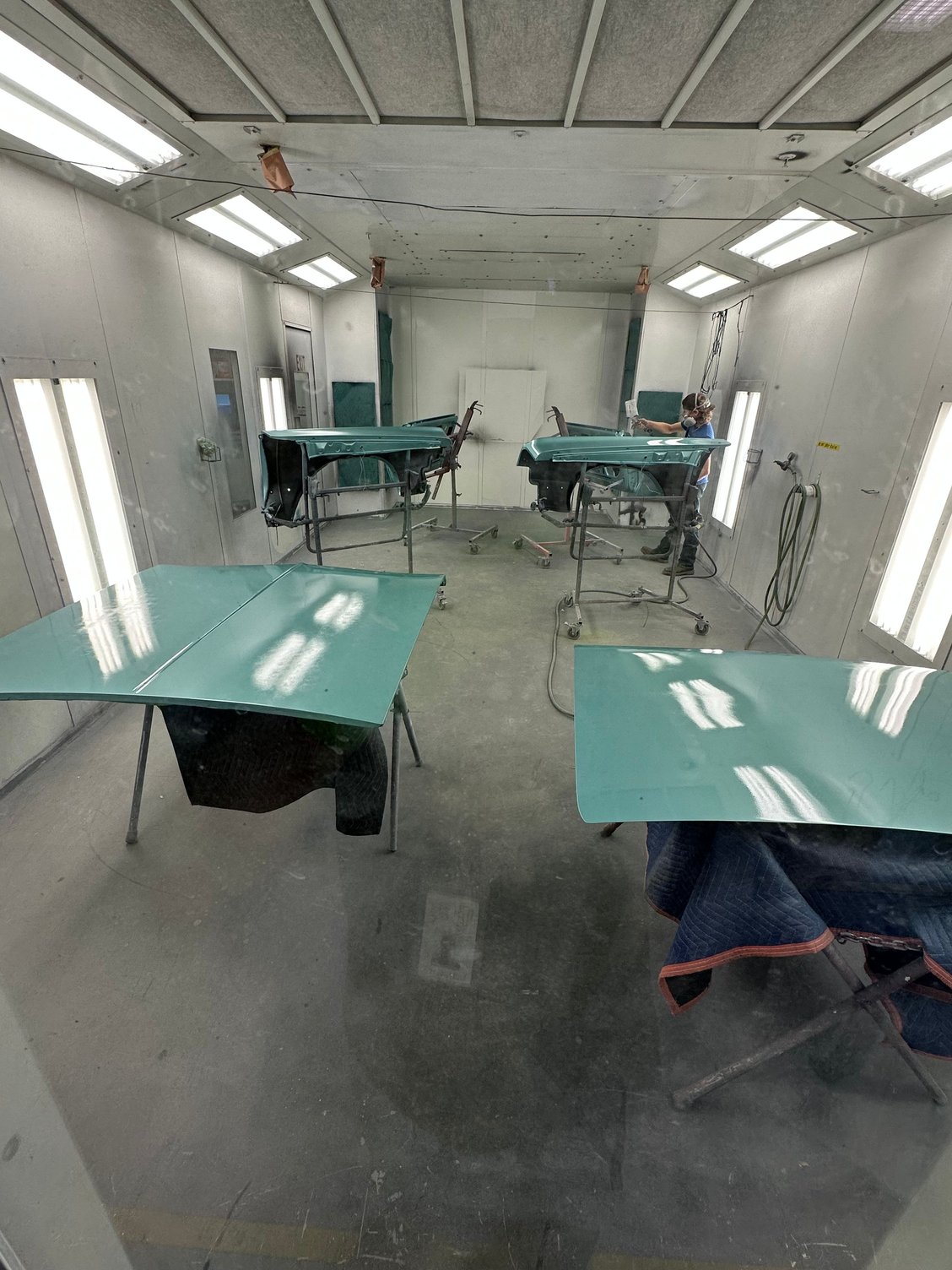

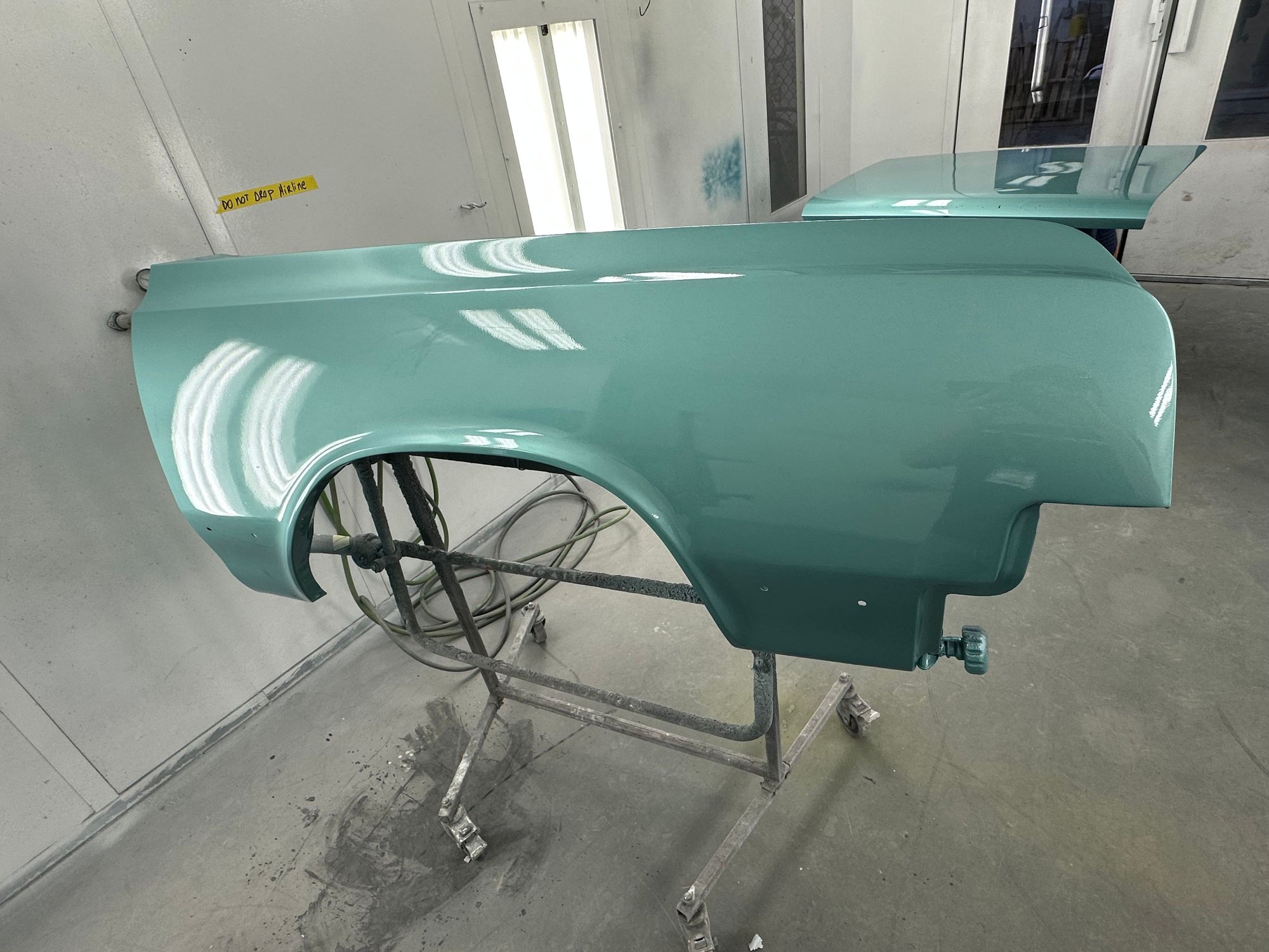

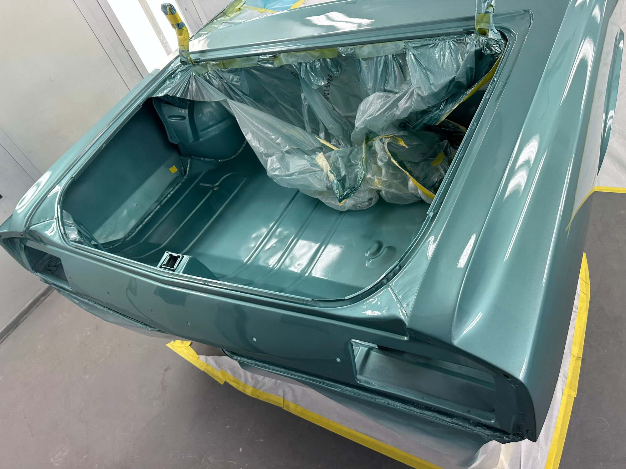

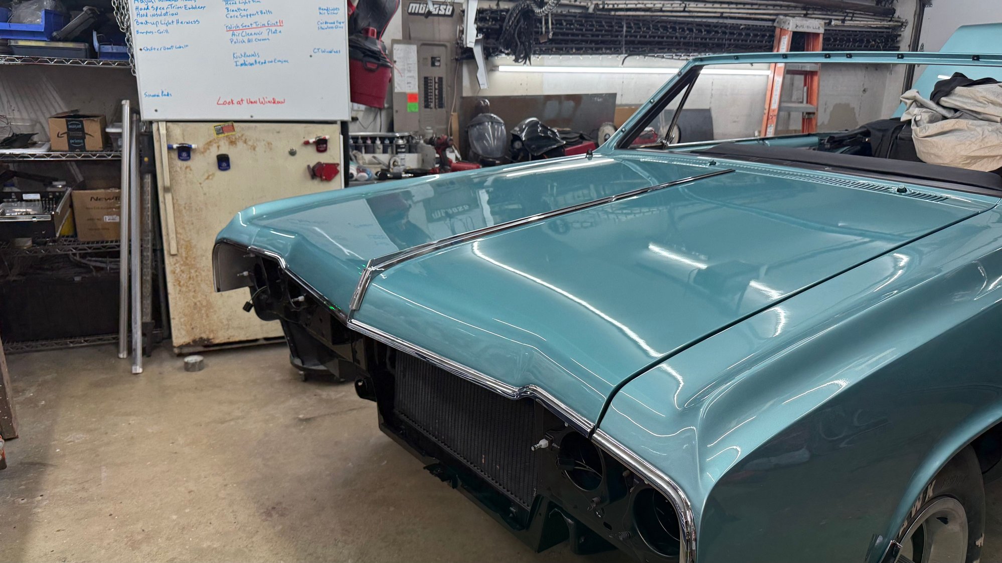

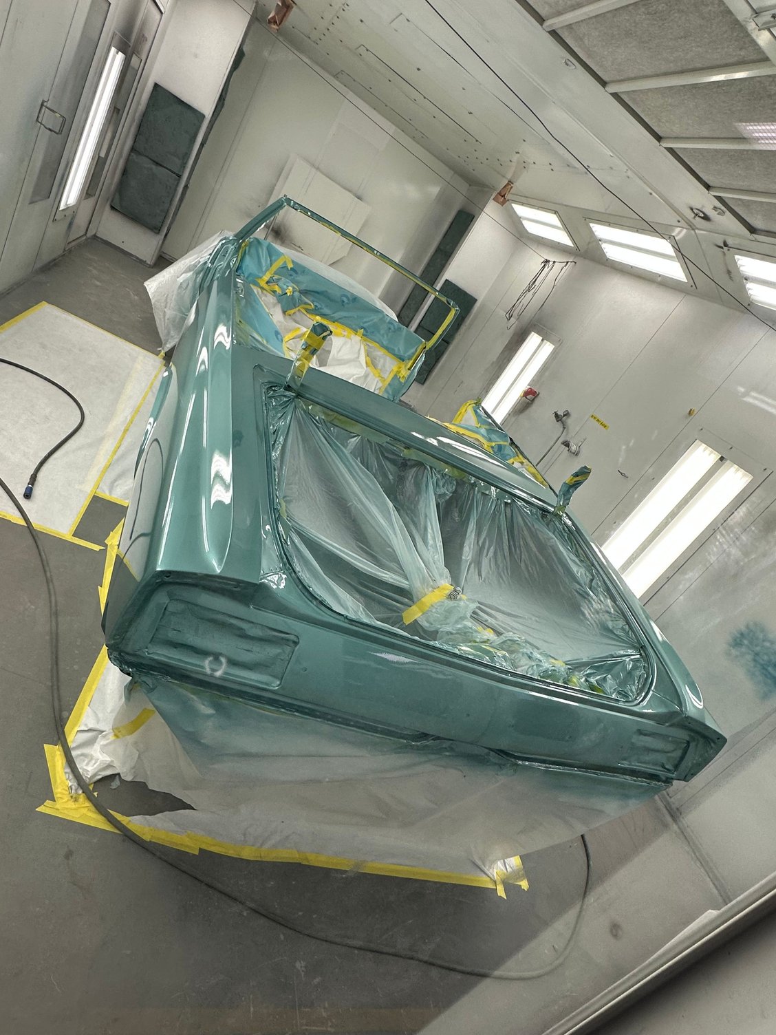

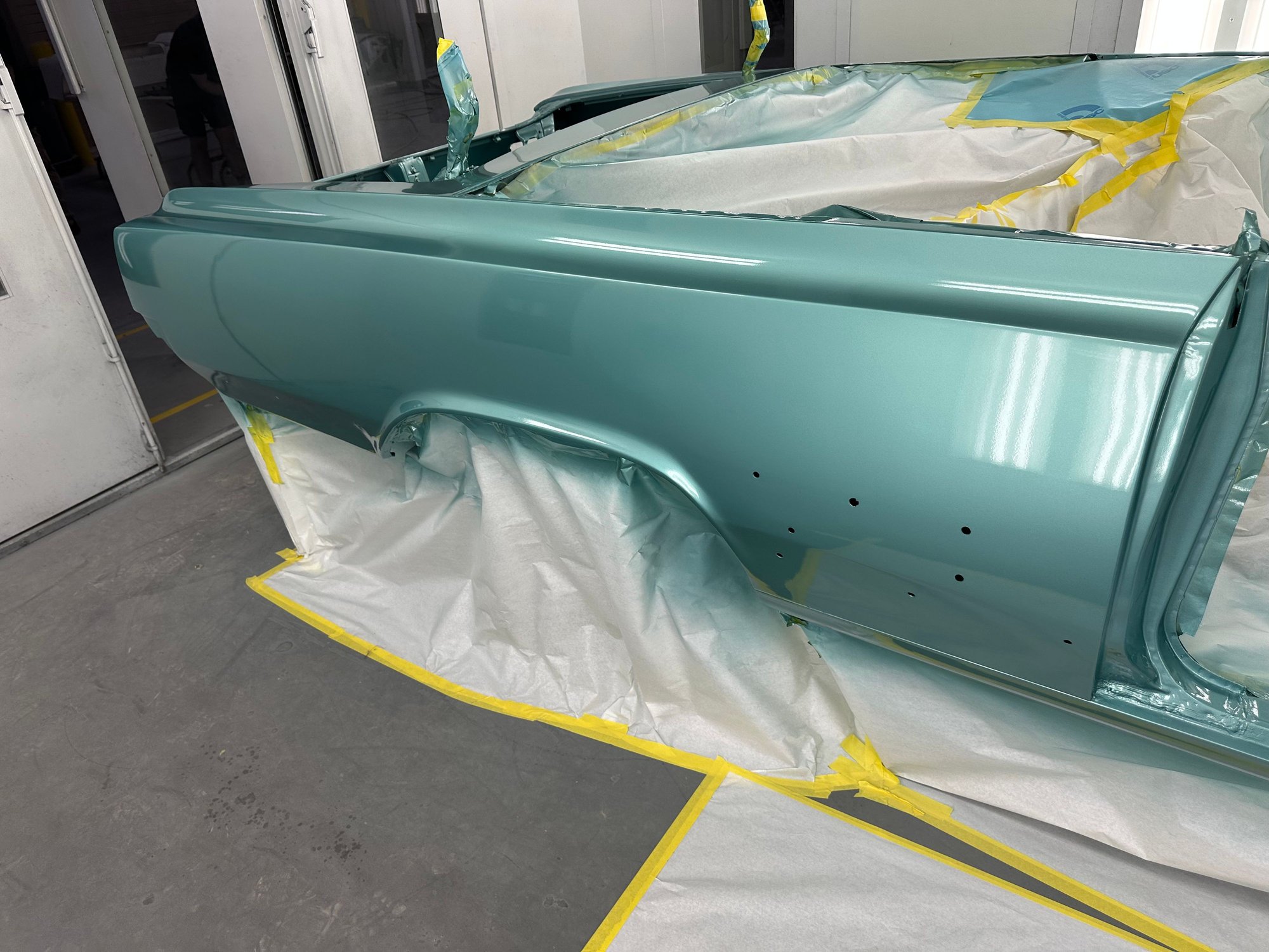

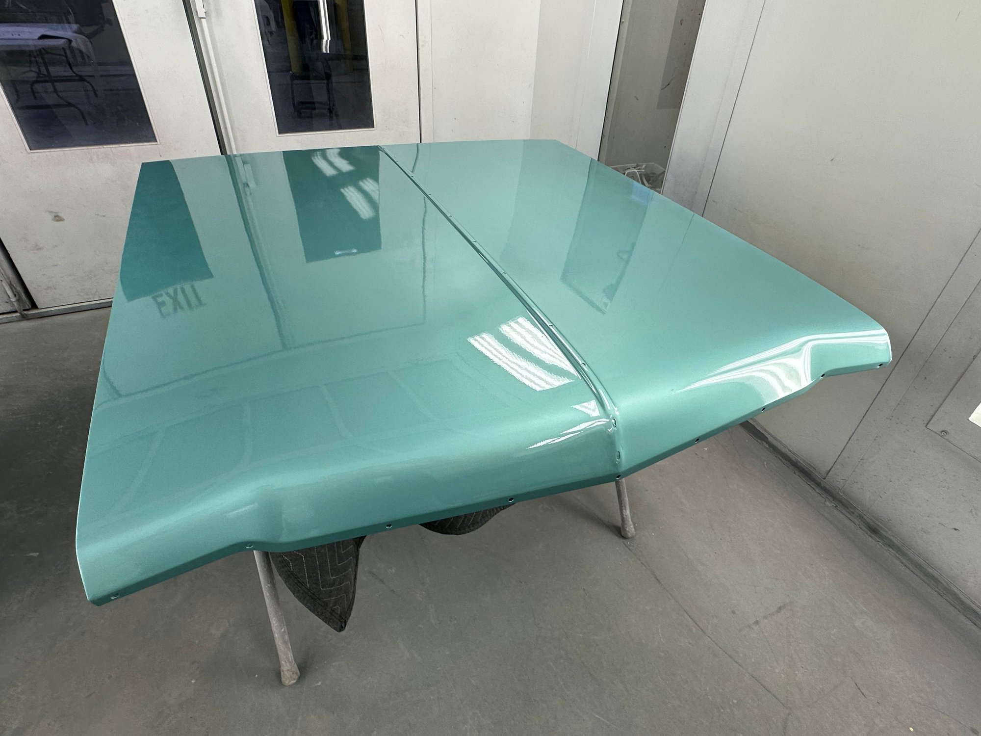

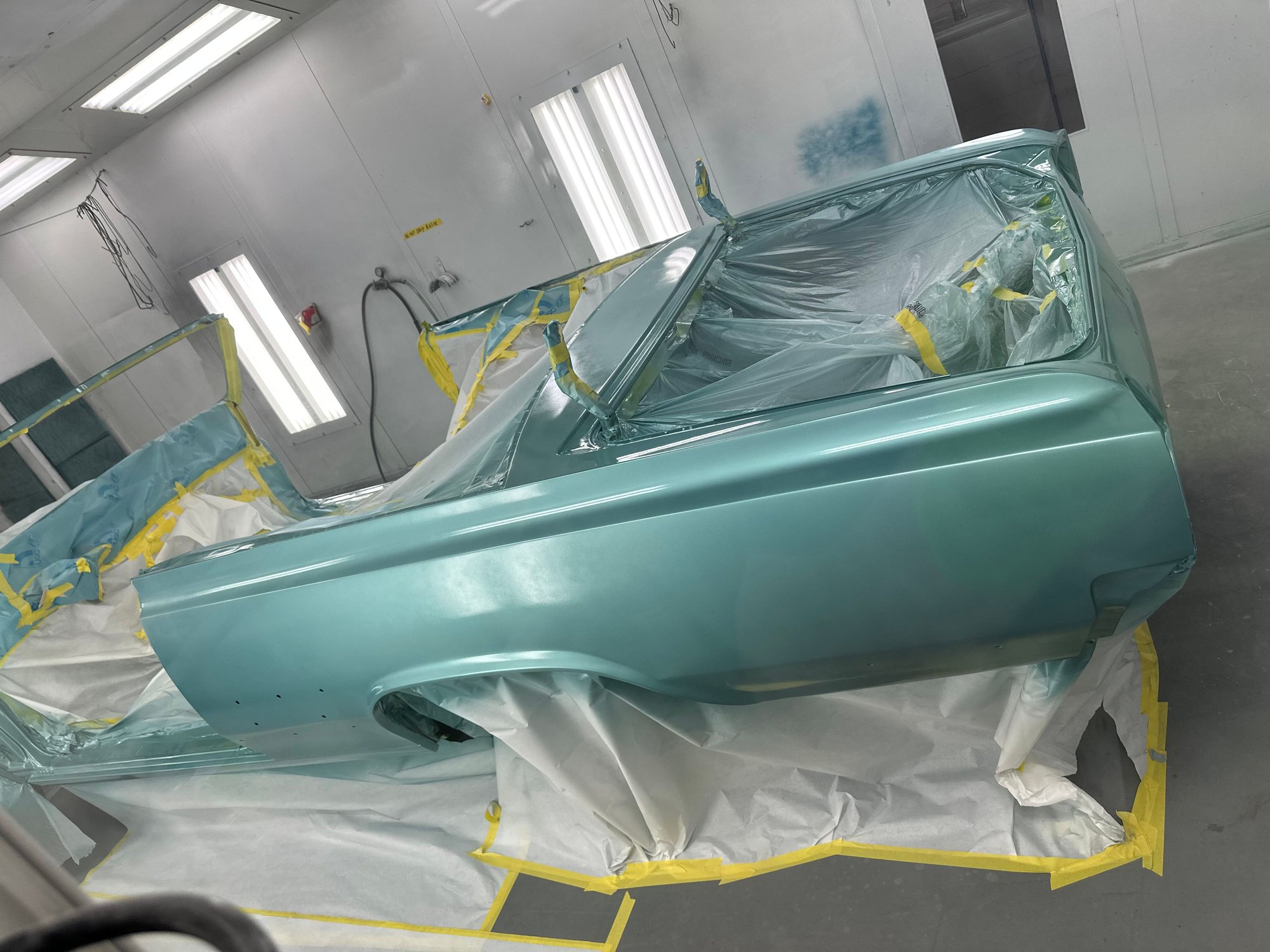

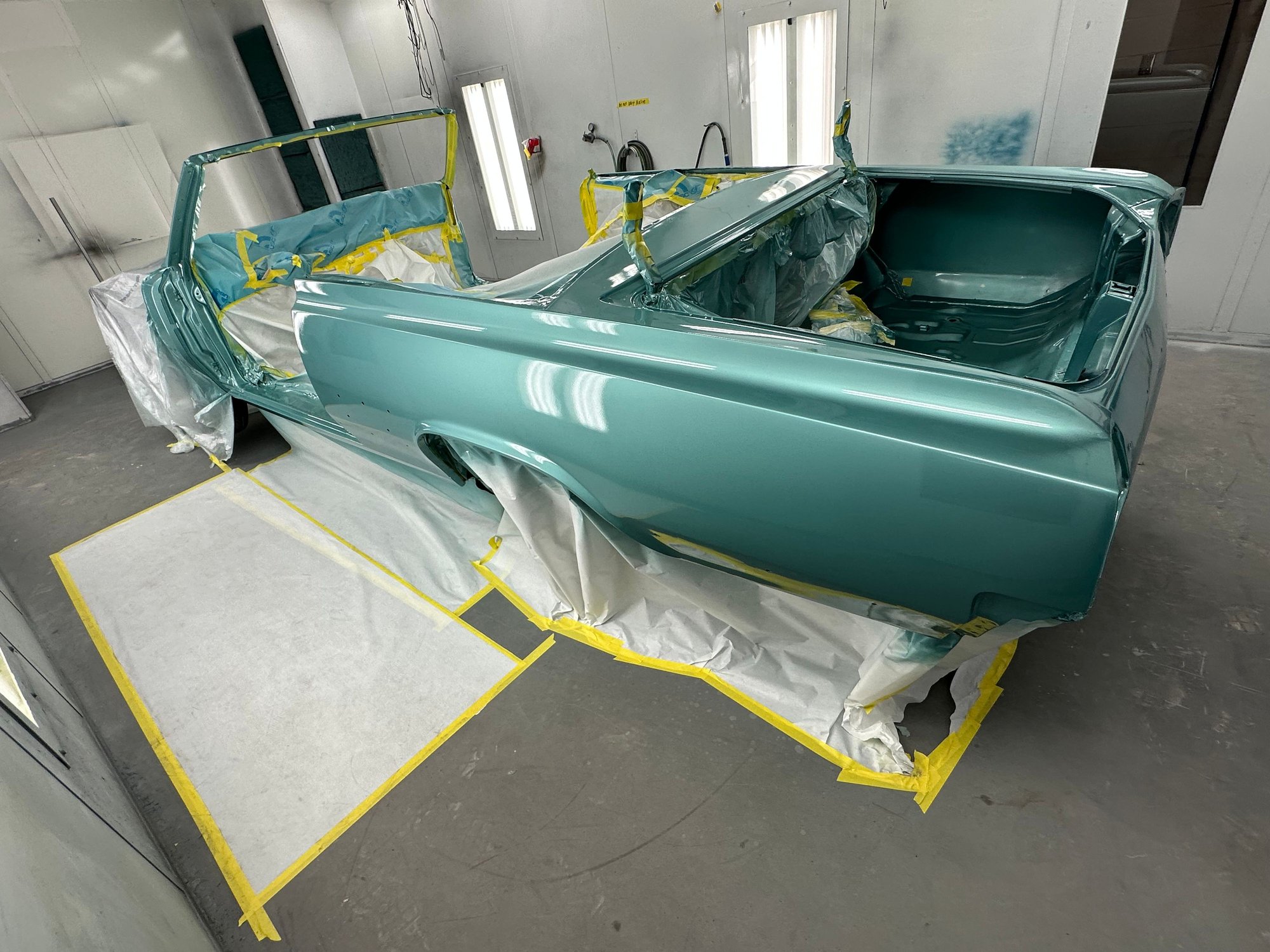

Well, after 3 years of seeing the car in pieces, she’s finally painted and back together
Old Apr 6, 2025 | 06:36 PM
  #196
scrappie's Avatar
Posts: 3,445
From: eastern MA
Awesome, looks beautiful, congrats!

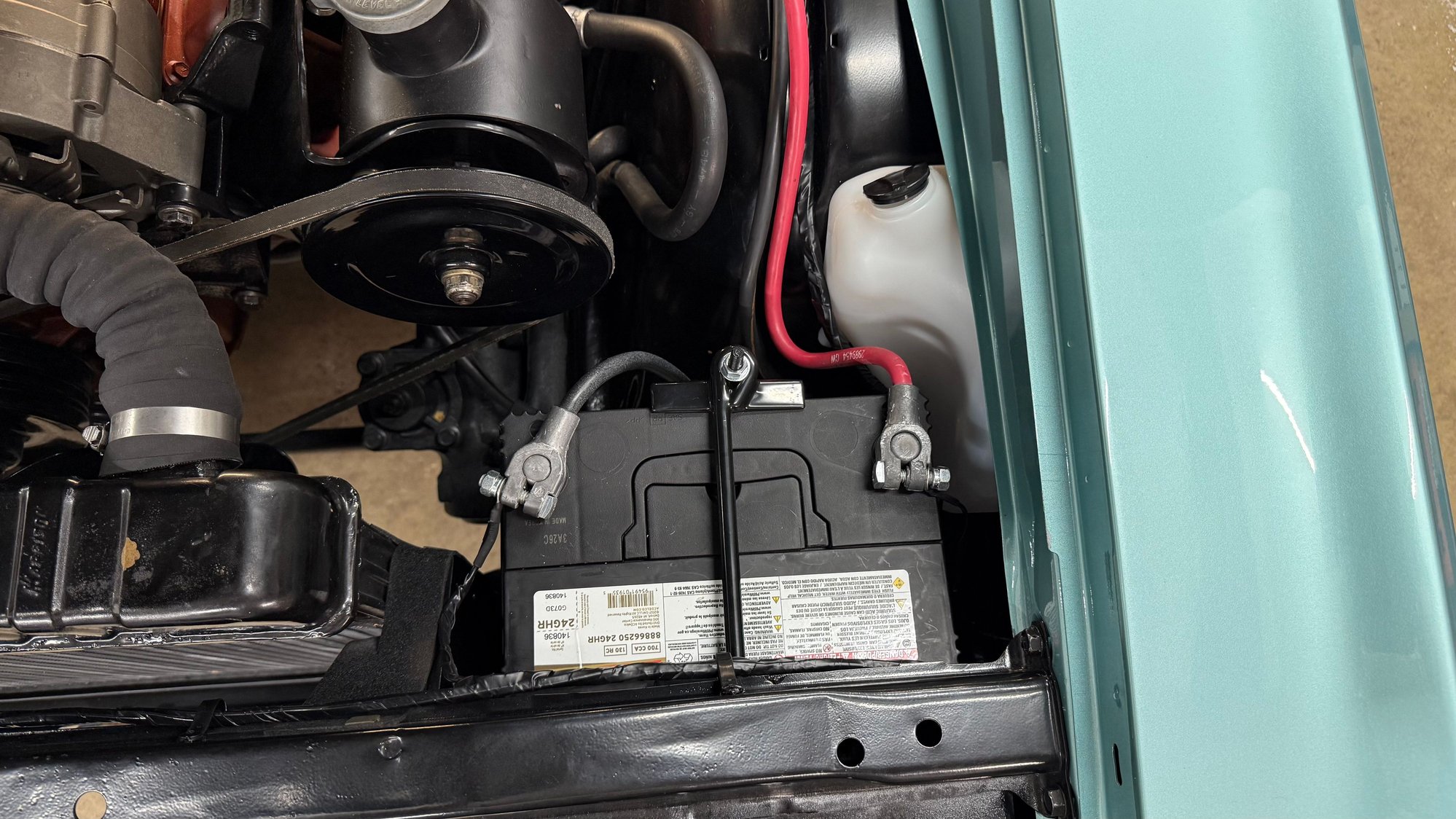

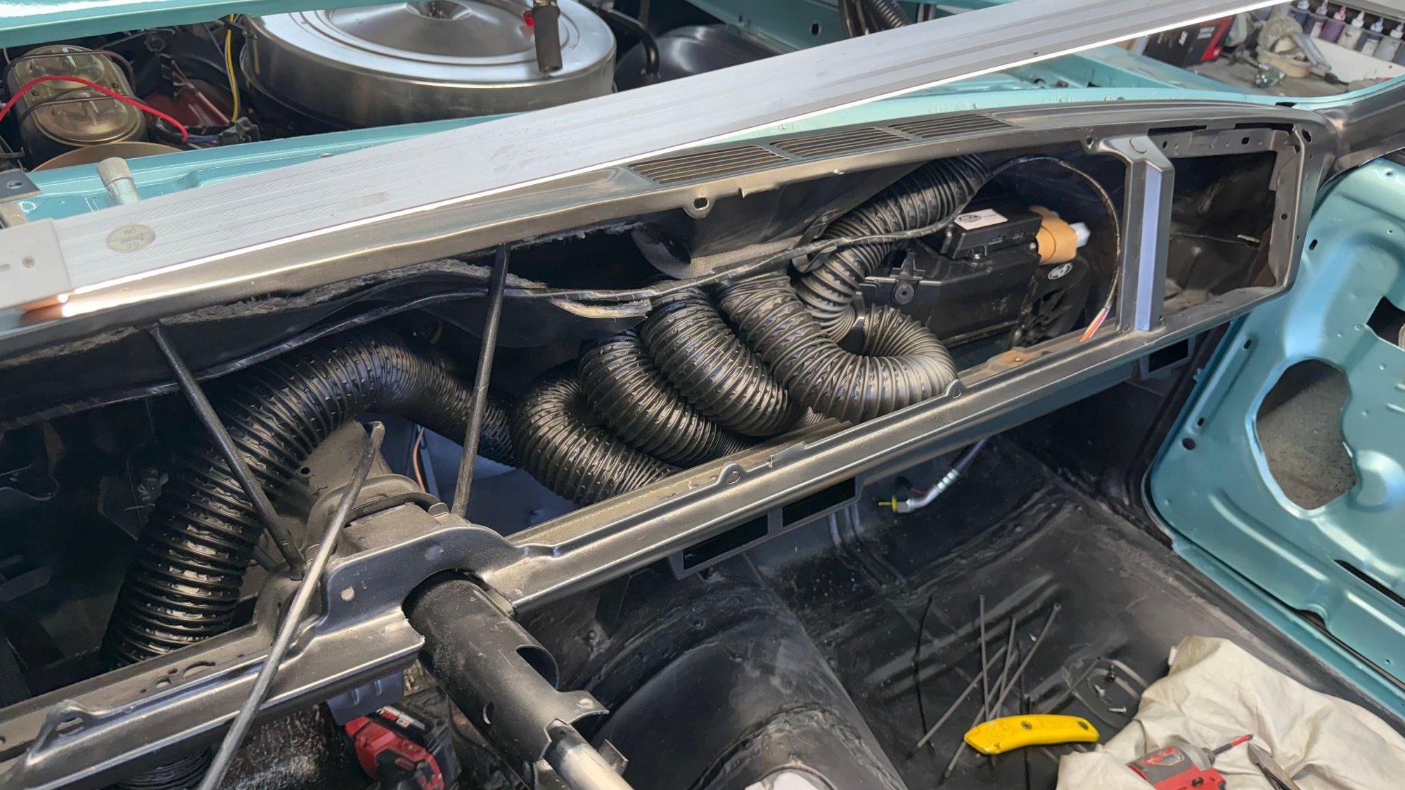

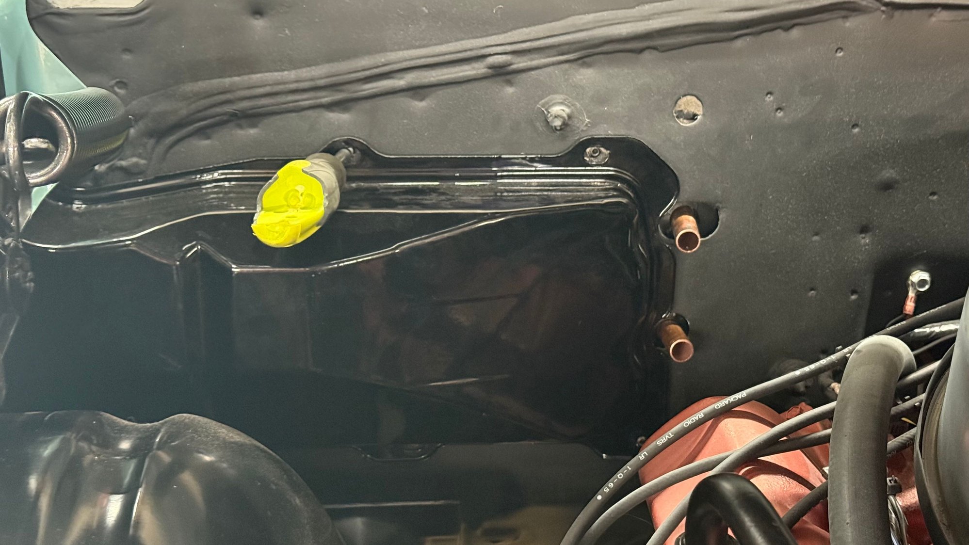

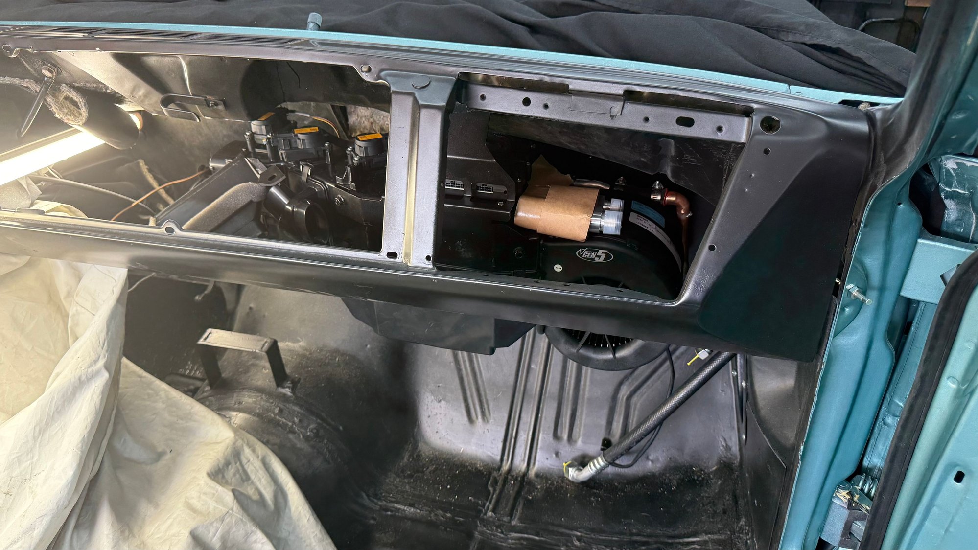

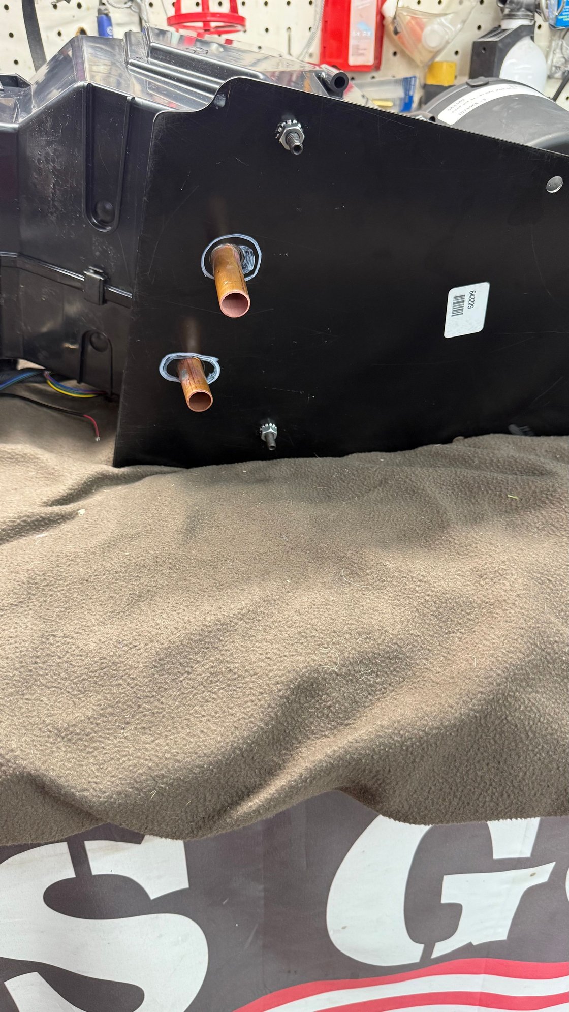

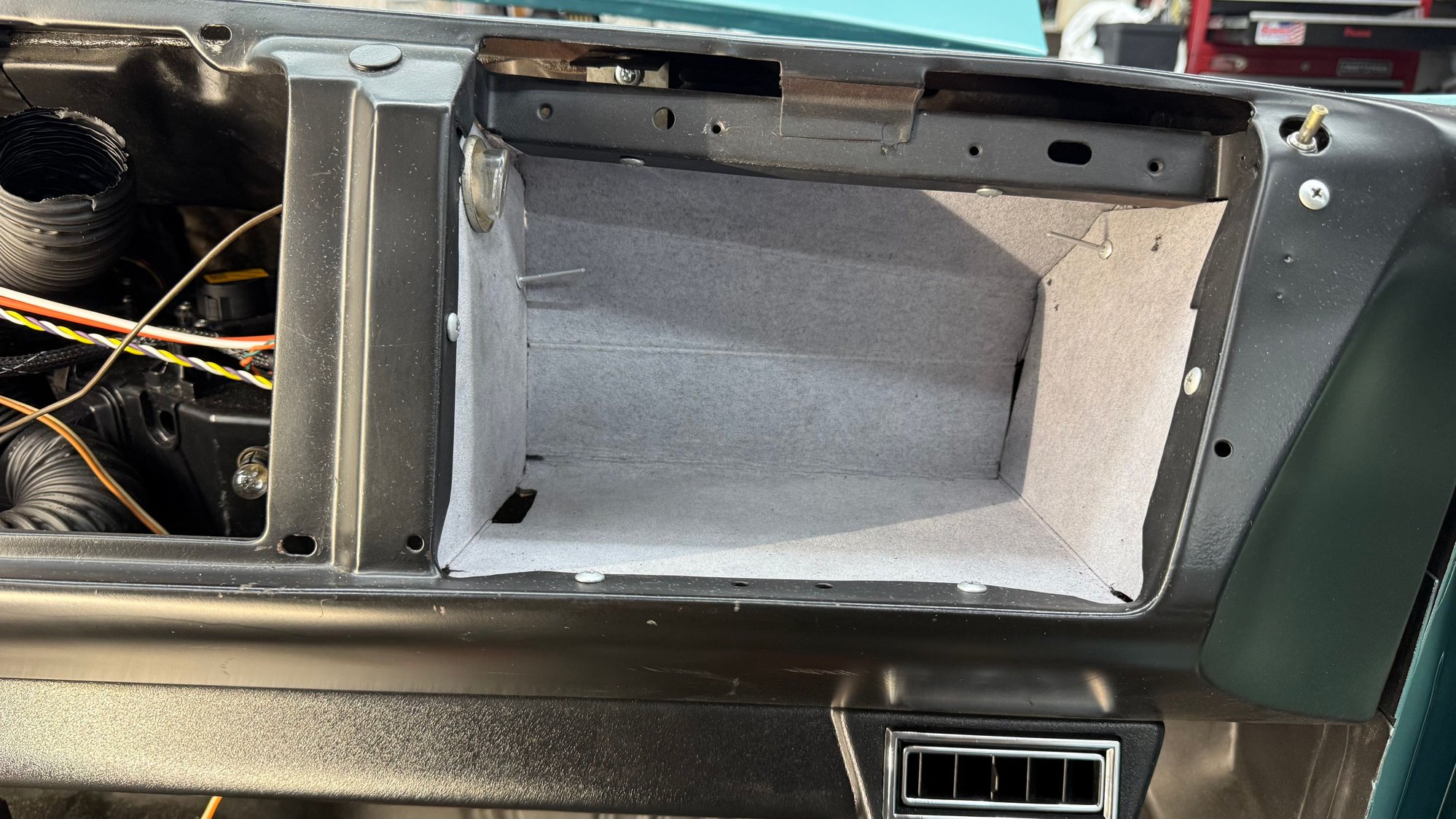

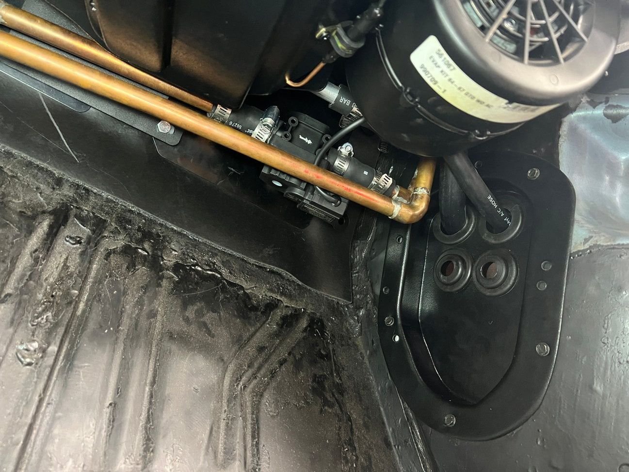

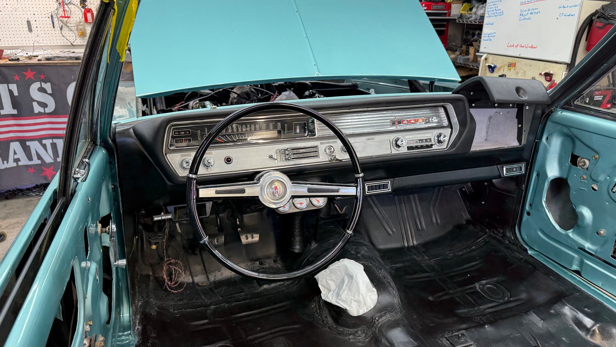

big thanks to Peter for doing all the dirty work on the vintage air install. certainly made it easy for me to follow. i added a few pics of some of my progress the last few weeks. just sent out my last batch of small parts to be chrome plated, convertible top is scheduled for install july 1st. all goes well, the car will be done end of july, if i can get it done in time, i may take it to nationals in bowling green, it's only 3 hours away.
