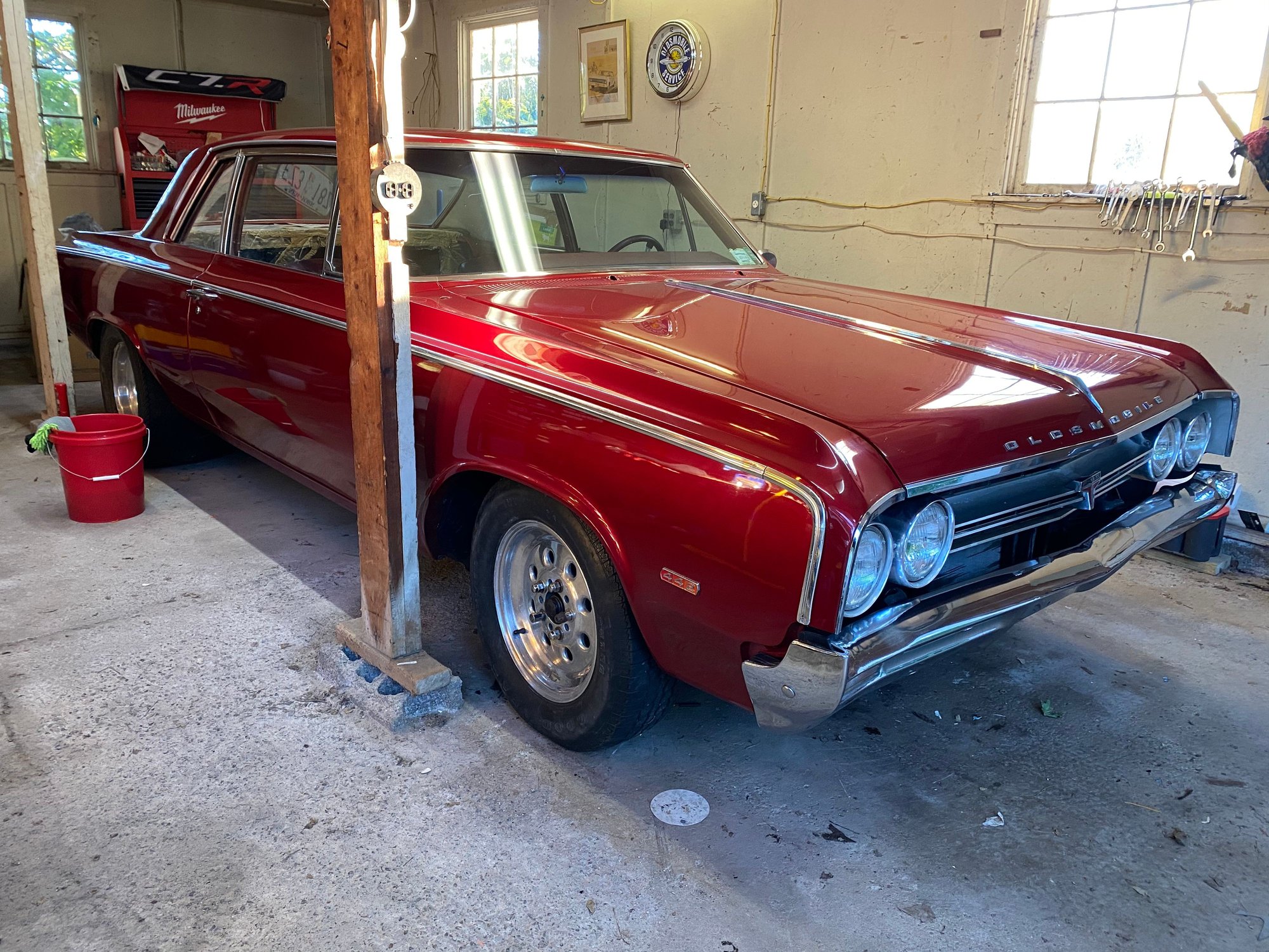

As usual, with time plans change. Kids, wife, moving, etc... The really good news is the car is actually up and running again, broke in the cam and everything seems to be going well. Outside of a disc brake conversion, I've not added any of the other suspension/chassis changes. I just want to get through winter doing some final changes and then be able to drive it in the Spring. Sick of always saying "next year". I also need to weld in some new rear inner fender wells in the trunk as those are beat up and cut apart just to get the car to not rub when it is on the road.
This is pretty much how it sits now (interior is back together, only change since this photo a little while back). The Air Intake cleaners are right now, the only way I can get the hood to close. As much as I want the car to look mild, I think it might be worth considering a 4" or less cowl hood. I'm sure the way this intake plenum is on the carb the air going across the top of the carb vs dropping in vertically isn't ideal in the long run.
