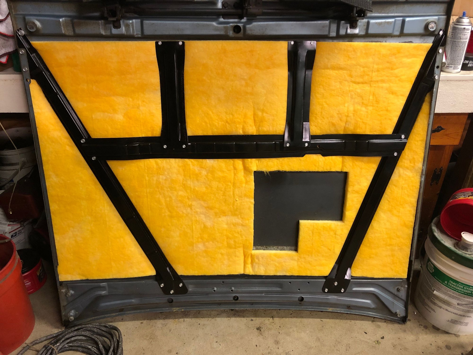

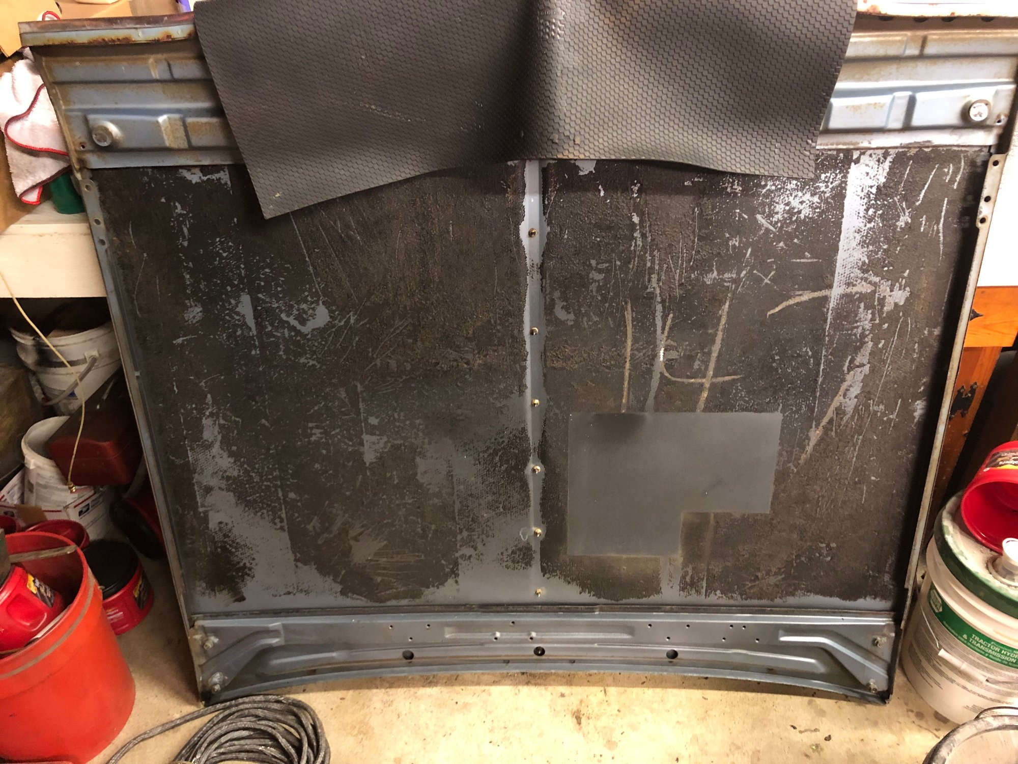

Hood insulation is done.

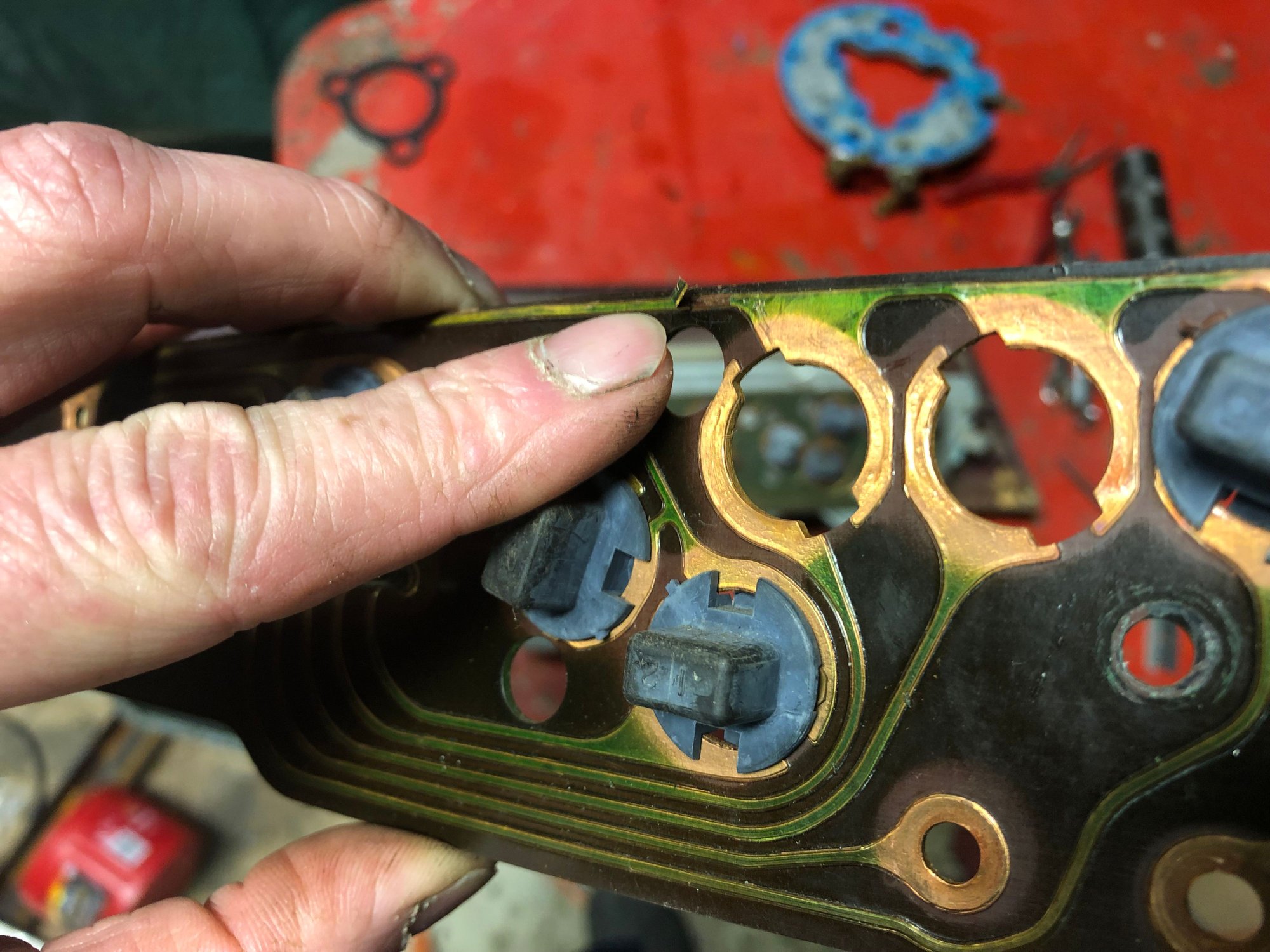

Working on some wiring bugs and found that the circuit board in the dash had a bad trace. I have extras but I may just solder a wire in this one instead of puling one out of the parts cars. ALso, the float in the fluid tank was not working and the float bulb had a hole in it. Took it apart and rebuilt it. Works good as new now.

Those printed circuit boards are so fragile. Once they get “handled” a few times the thin foil seems to break or tear. Looks in good shape though.
Old Apr 6, 2023 | 03:49 AM
  #91
Bfg's Avatar
Bfg
Posts: 2,291
I have the same problem on the printed circuit board on my 65 Cutlass, how do you successfully solder the tear in the torn foil? I have another circuit board to replace it with but it has a missing pin, wondering what would be the easier fix, any thoughts, thanks in advance
Old Apr 6, 2023 | 06:47 AM
  #92
jensenracing77's Avatar
Posts: 11,909
From: Brazil Indiana
I hear the pins are easy to fix if you know how but I have never had to do it to learn. I typically use a small wire and just solder across a cracked trace. Don't want to get it to hot, just hot enough to do the job. It is so thin it is very easy to get it to hot.. You can get the copper foil and replace it that way also.

Where can I get copper foil?
Amazon has several kinds of it.

So, is the foil tape applied by an adhesive back? If so sounds pretty simple, hardest part will be getting the speedometer cluster out to repair it
Well, yes and no. The stuff I was playing with would stick good enough to stay together but I didn't trust it for long term. I clear coated over the top and that helps hold it down also. On the ends, I still soldered the two pieces of foil when I used it. I don't know how good the contact is going through the "tape" part. It is supposed to be ok and not solder it though. I am sure there is a more professional way but I am not the expert, I can just make it work.

Some of those have a higher resistance and not really the right stuff from what I understand.

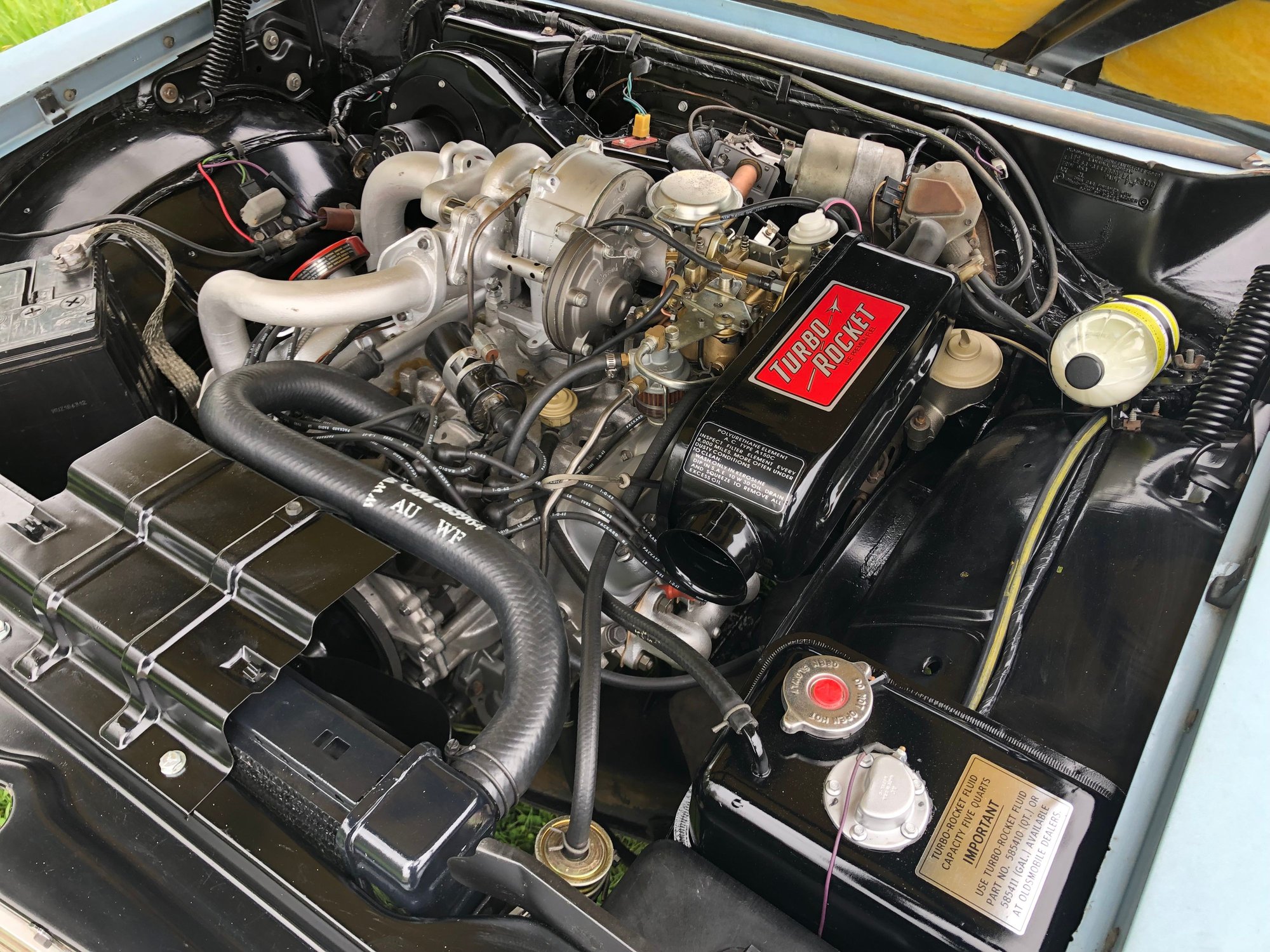

More work done. Have been pulled away from it a little lately. Also waiting on the master cylinder and seat covers to come in.

Engine compartment looks fresh!
