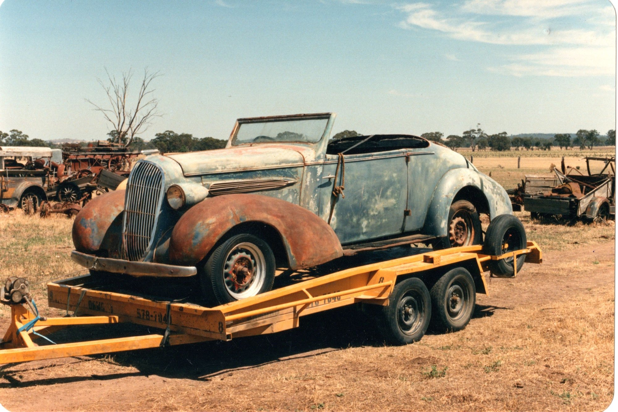

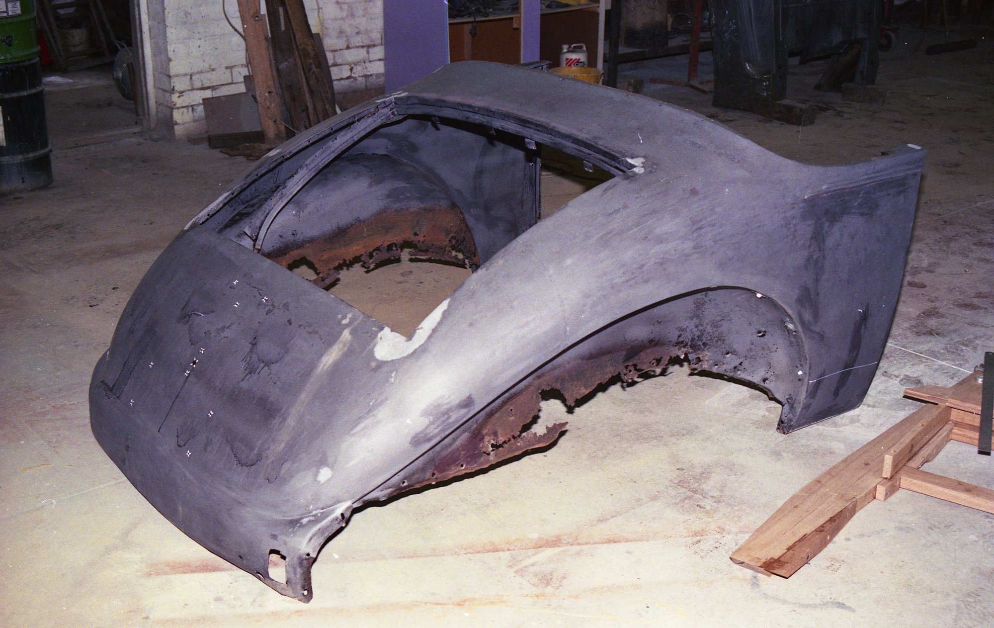

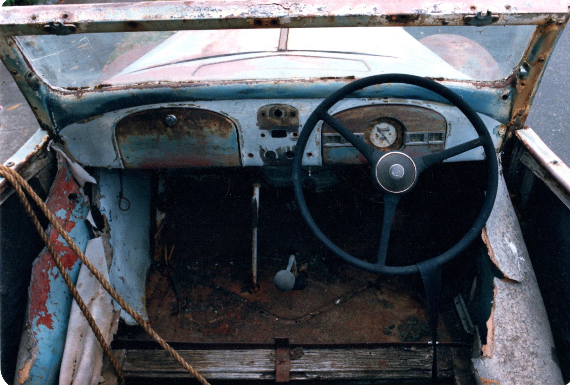

I know the vast majority of threads here are weighted toward Oldsmobile’s of the 60’s & 70’s but I thought I’d share something a bit different to the last thread I did on my ’70 442 W30 restoration over here in Australia. This thread will cover a lot of old history to start with and then work through the next couple of years as I finish what will be an almost 40 year project to return my 1935 Oldsmobile F.35 Roadster to it’s former glory.
The photos of the car as found show the steering wheel on the right side and that’s because this car is an original Australian build Right Hand Drive. RHD Oldsmobile chassis’s were shipped out from Lansing in CKD (completely knocked down) form along with front & rear fenders, hood & grille. The body from the firewall back was made here at the General Motors Holdens body plant and then fitted to the assembled chassis.
Just 29 of these F.35 (6 cylinder) Roadsters were produced and today 1 complete original, 2 others requiring significant restoration plus my car still exist. My car started life with side-mount spare wheels (6 wheel equipment) and was originally painted a maroon color. During the 50’s it had a severe front end accident so all the front panels were replaced and a grille was fabricated from stainless strip as the grille’s were almost impossible to source.
I bought the car in January 1988 where it had been sitting on a farm of a Buick collector about 100 miles from my home city of Melbourne (the south east corner of Australia). After some negotiation I secured the car and my brother & I trailered it home. In the coming week I’ll post more of it’s progress and the big barriers that stopped the restoration for almost 30 years.

Part 2 - January 1988

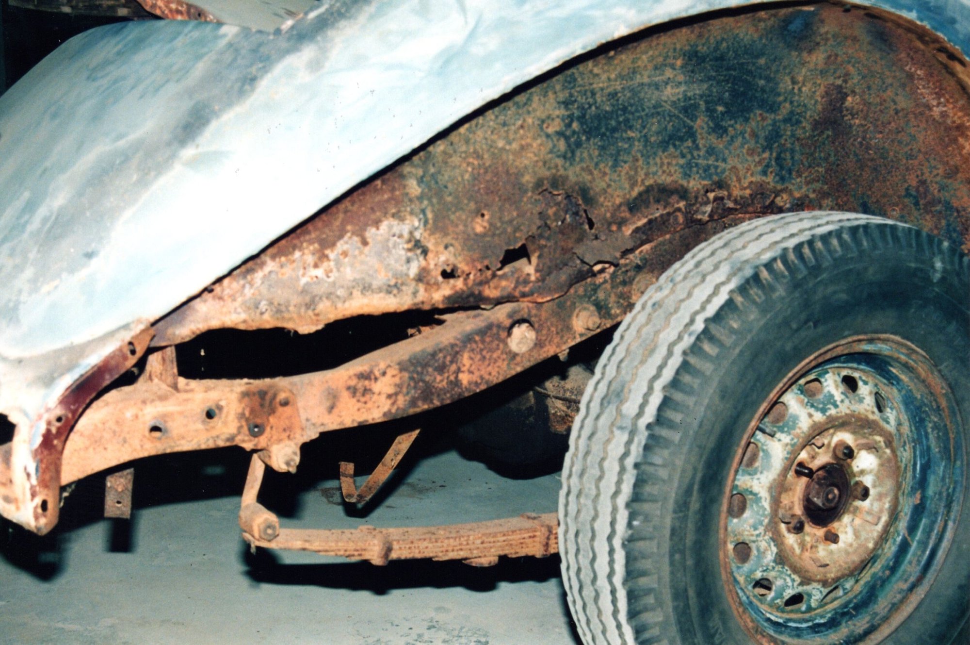

So in late January '88 the Roadster arrives home and the closer evaluation commences. We immediately see that the frame has had a real hard hit in that accident in 1950's and a donor car is going to be needed. The frame is badly bent and cracked, a '34 engine has been transplanted at some point in it's life and in the background I'm thinking where on earth am I going to find a grille as they are made from "unobtanium" - but seriously the pot metal grille is going to be a serious drama as we progress. Initially I put the car away in the family garage and started the search for parts for 3 years or so and spent all my spare cash (as I could at that time being a young single guy with no financial commitments) flying to the US for the Hershey & Carlisle Swap Meets every 2nd year looking for parts and a grille in particular. There are a few pics here that show the condition of the timber frame & the rest of the car when it arrived home.

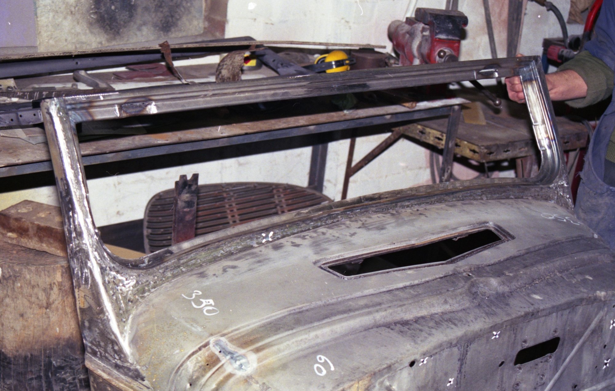

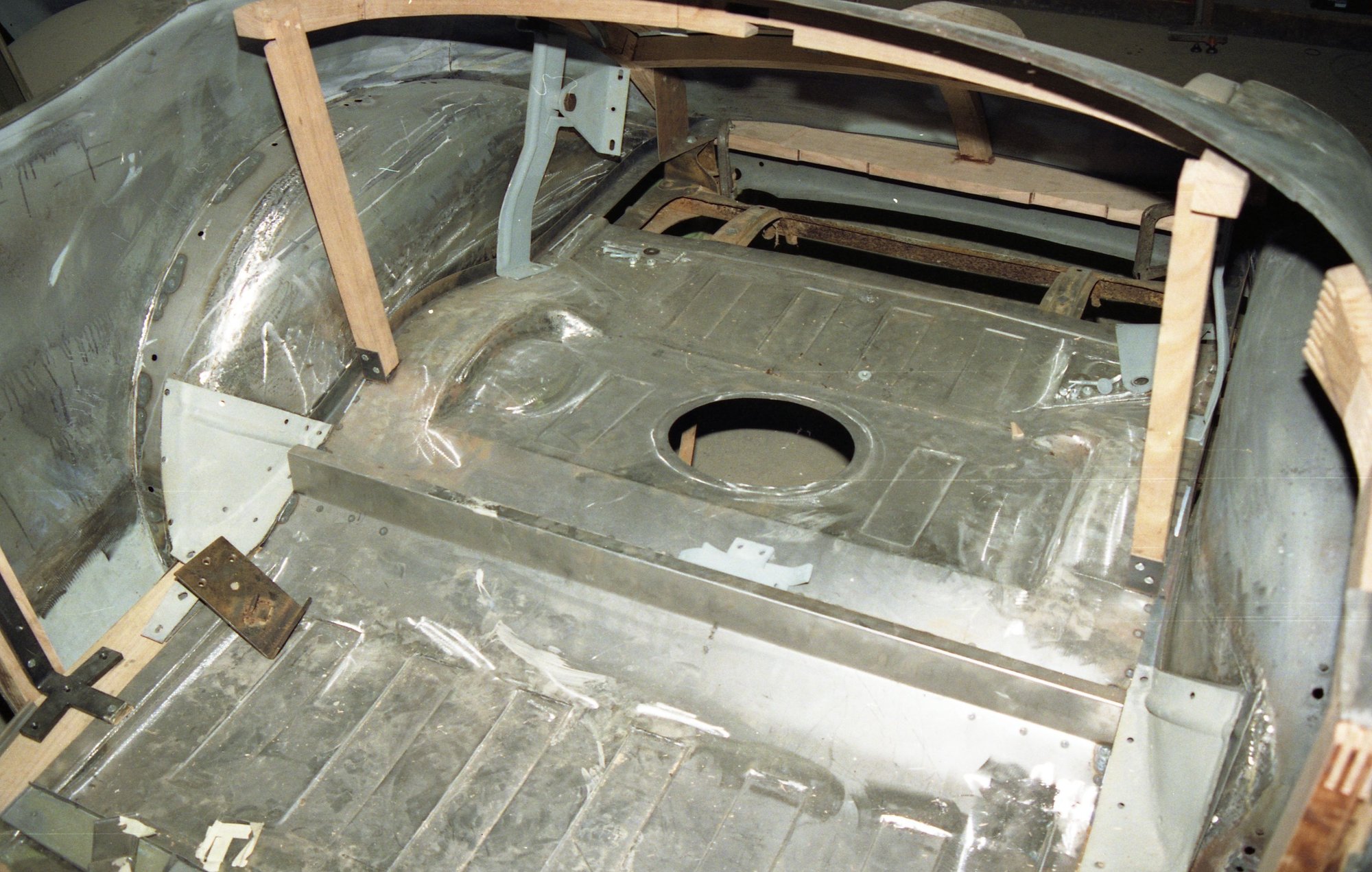

Part 3 - May 1991

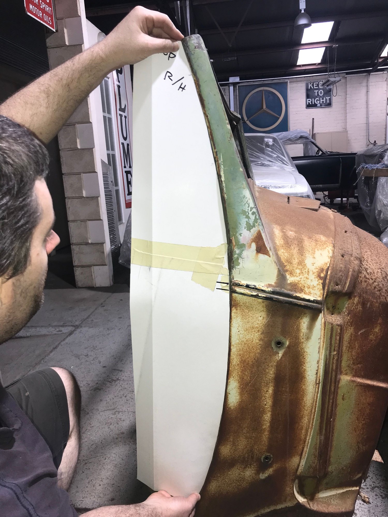

So after saving hard for a few years in May 1991 I looked around for someone capable of doing the body on the car - not straight forward when it's got a timber frame (which Olds used until 1937 when they went all steel). Given that I had no grille my aim was to get the body from the firewall back finished and set up on a good frame and then ready for the day when a grille was found and the rest could progress. A local restoration shop was selected and the car went to them to strip and commence work with my modest budget. In 1991 we had a downturn in the economy here and other projects in the shop stalled so my car had 3 people working on it full time for quite a period. With little to no floor left everything had to come apart to repair the rust in the body and remake the timber frame. With the rivets holding the floor to the rear panel-work removed this allowed the floor, panels and timber frame to be separated and progressed independently. Work on a new floor commenced whilst the rear panels were sent out for media blasting. On return the rust repairs to the inner rear fenders were started and patterns of the timber frame taken and new pieces made.
Old Aug 16, 2023 | 04:47 AM
35olds's Avatar
Joined: Apr 2014
Posts: 420

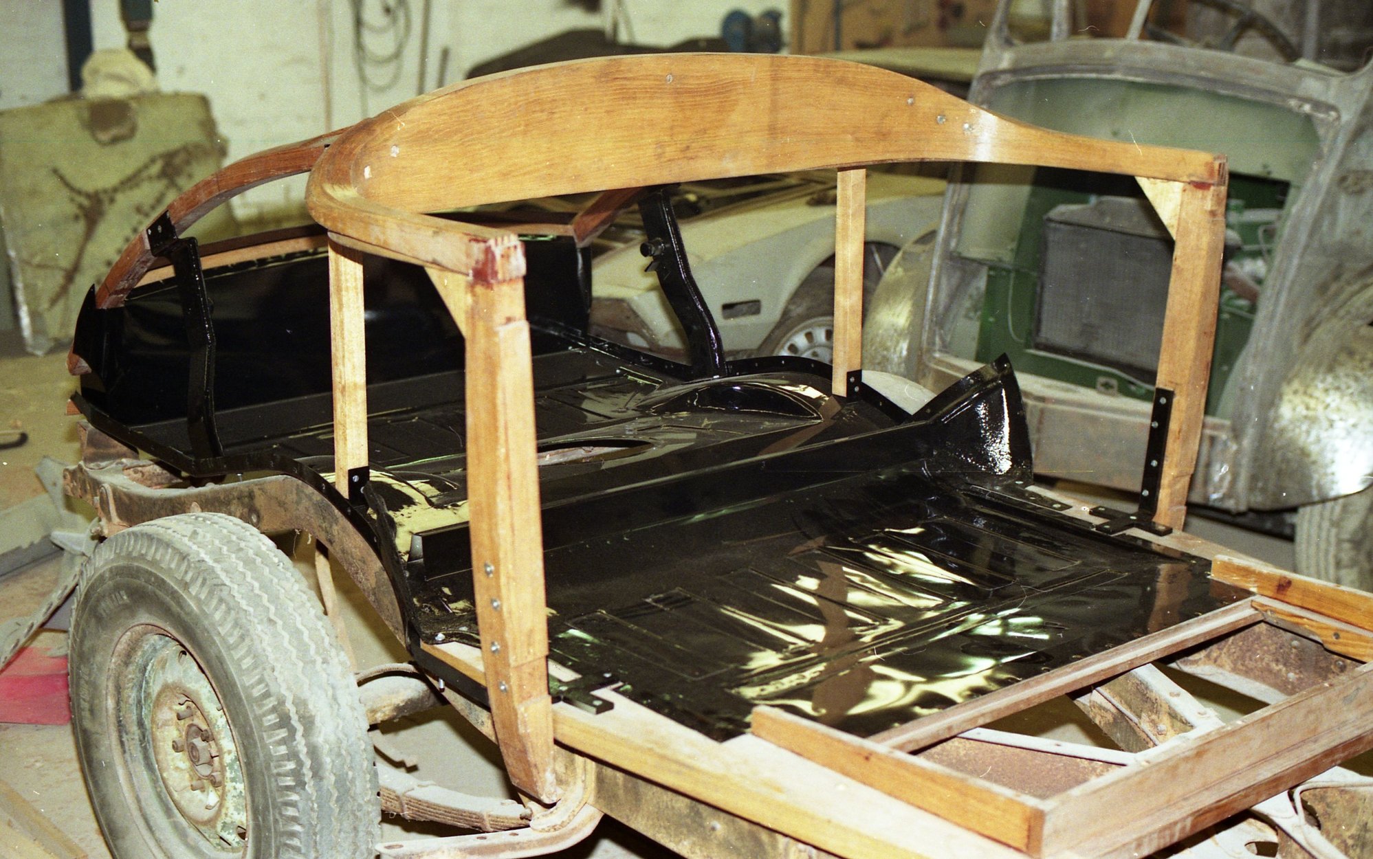

June '91

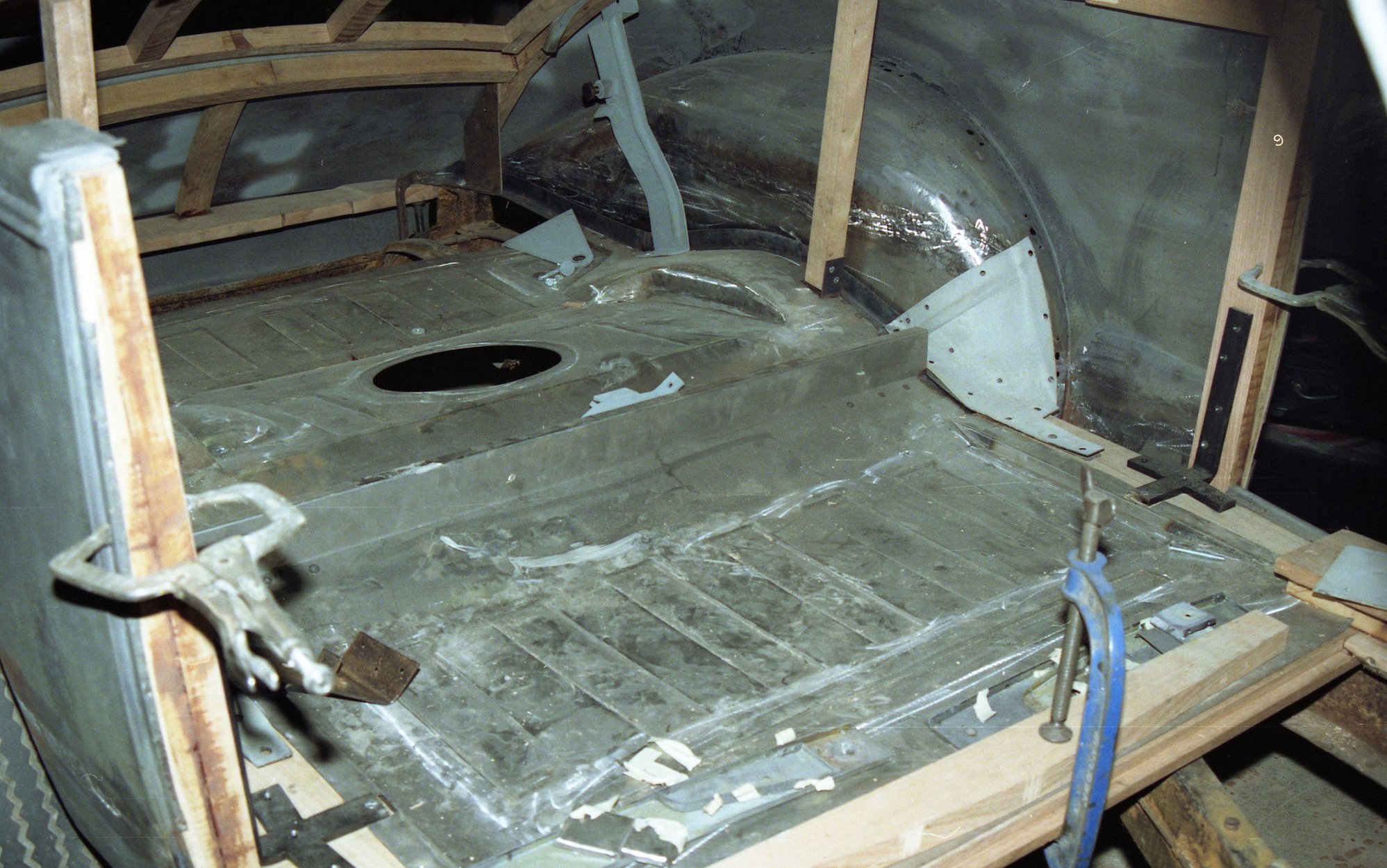

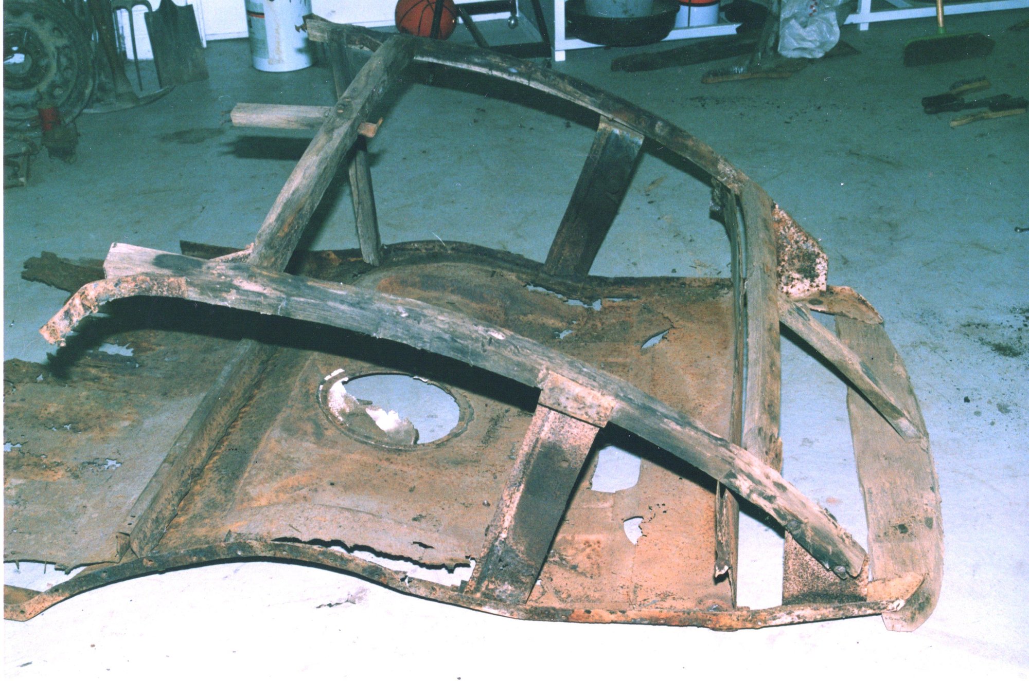

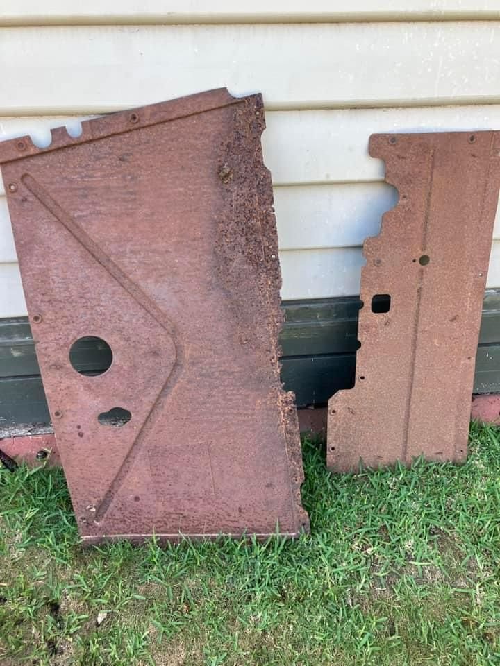

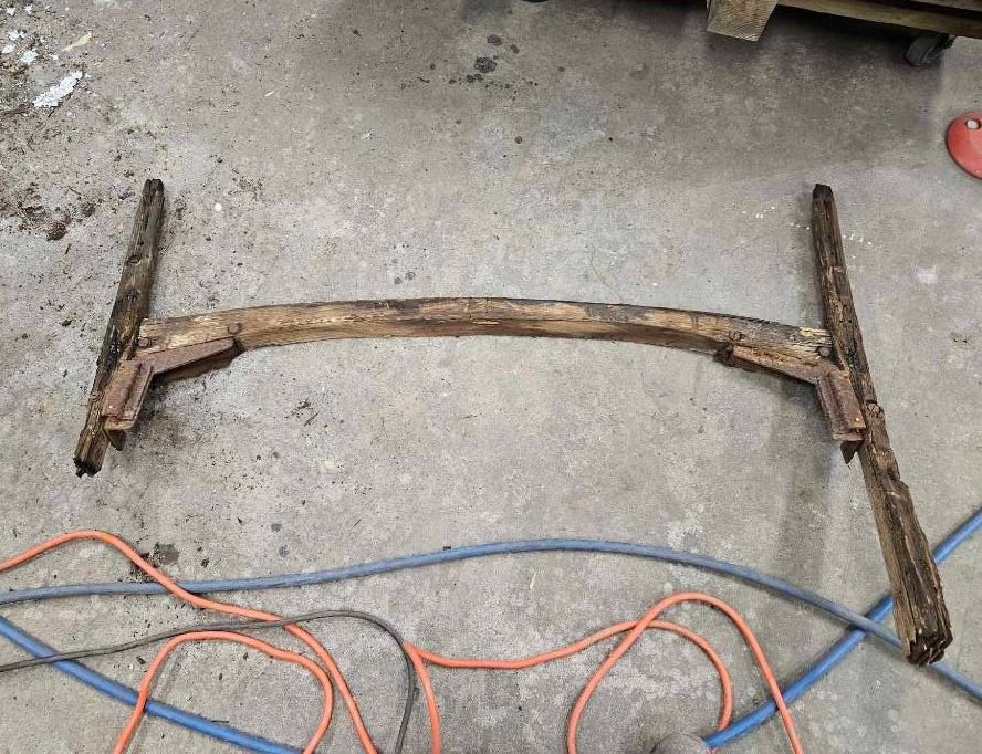

So through June '91 the new floor is made replicating the original design and that is solid riveted back into position, new timber framework also made and work on the front fenders commences. The timber frame that runs around from the left to right door pillars is steam bent by a shipwright in one single piece and profile cut to the contour of the original body. With the body off the frame we find nasty signs of the serious front end collision that the car had in the '50s when the complete front clip sheetmetal and a hand made stainless grille was fitted to the car . Close inspection reveals that a donor frame will be needed and the engine is identified as an incorrect '34 engine - so a complete donor car will ultimately be needed. As the car was originally a dual sidemount (6 wheel) car I tracked down a pair of fenders but like a lot of vehicles of this period mud build-up on the inside of the left fender had led to really serious rust. We weighed up cutting a regular fender to sink a well into it but as the fender pressings are somewhat different a decision was taken to graft a large section of a regular fender to repair the rust. Overall it came up pretty well.

Awesome! I didn't know Oldsmobiles used wooden frames before 37.
Old Aug 16, 2023 | 05:17 AM
35olds's Avatar
Joined: Apr 2014
Posts: 420
Yes, they were timber frame in both the US and Australia up to and including the 1936 model year. 1937 was the first year for all steel bodies.

Wow! The woodwork is awesome! Having a shipwright to fabricate that piece between the left and right sides is really going to be a story for the car when it is finished. Nice thread. Subscribed

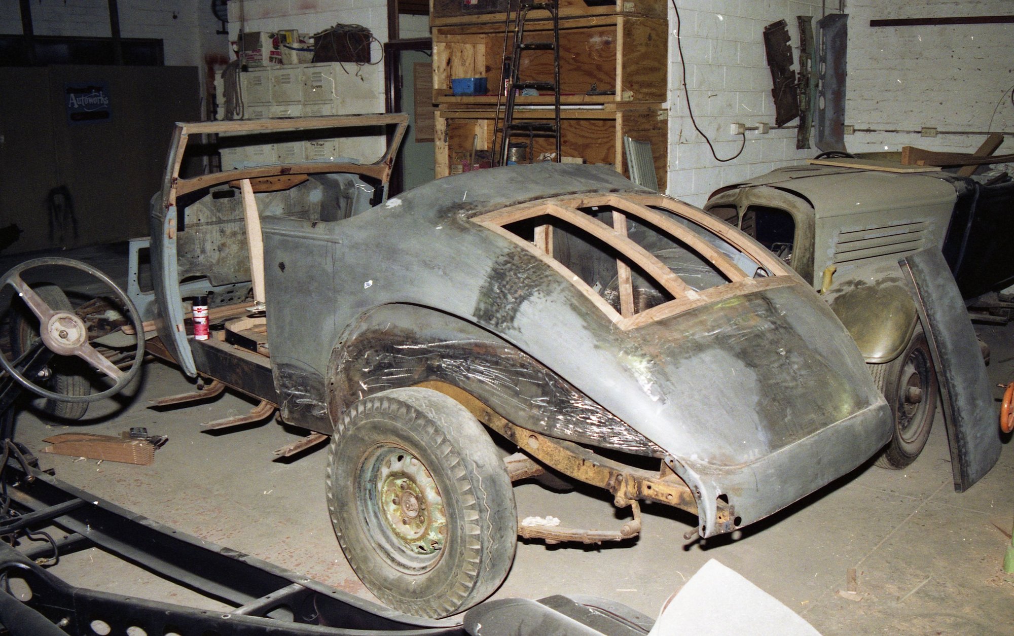

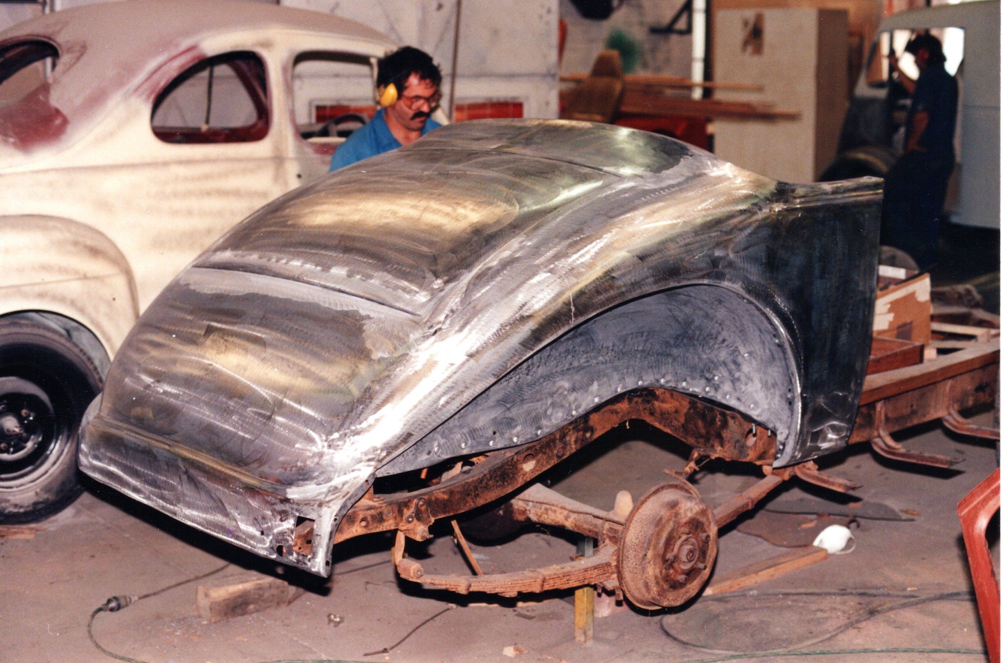

August '91

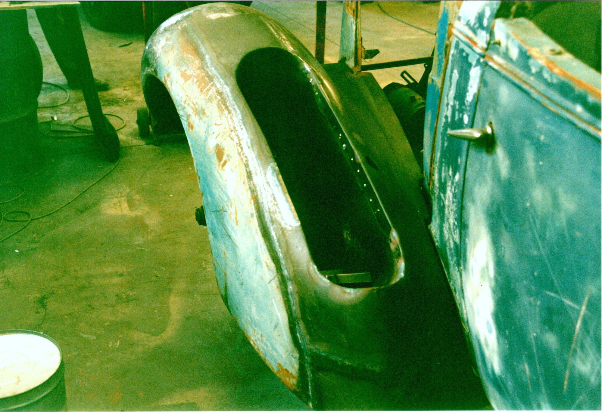

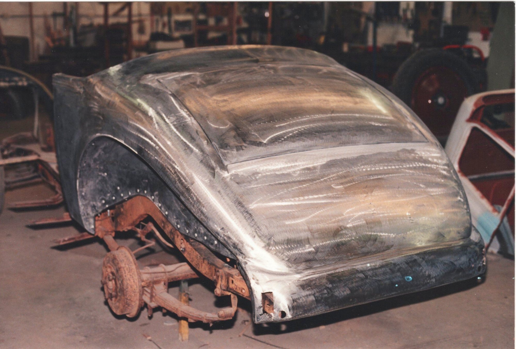

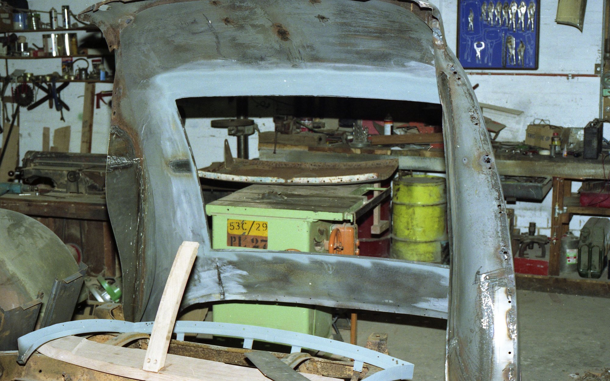

By August '91 most of the rear bodywork is now completed, timber frame for the doors is completed and work on the front cowl is underway. This is probably the trickiest parts of the restoration with the pillars and cross bar of the cowl being steel clad with timber frame and a HUGE amount of lead wiping thats been done to cover up the joins. The front windshield is a one piece foldout design (different to the US Fisher Body that has 2 fixed screens). Sadly there was a lot of rust in the lower radiused corners of the cowl where the screen sits and reproducing that correctly was challenging and I really wasn't at all happy with the result. The work done was good but to seal the windshield was going to require way more lead than I was going to be happy with. This issue along with the looming concern that I had no radiator grille for the car rapidly made me take a step back and consider pausing the project - well at least until I could find a grille and anyone with cars of the '30s will likely know that good grille's let alone the unique F.35 grille is like finding the W27 rear axle for a '70 W Machine - true Unicorns.
We kept going for a bit longer, repairing the rear fenders, making the timber frame and finishing the rumble seat lid, prepping the rear body and epoxy priming it.

Slowing Down in '91
So we are still in 1991 and I sadly decided to pull the pin on bodywork due to no grille to complete the car. The rear body & rear fenders were epoxy primed and everything else left bare hoping that this was only going to be a short pause whilst I found a grille and let the bank balance recover for a while. I went over all the bare panels with Zinc Phosphate metal prep to give them some protection for a while whilst stored away. Well that pause was to end up lasting 32 years !!!! Lots of things ended up getting in the way which most of experience through our life- marriage, house, family and to some extent loosing the motivation. Through that 32 year pause I didn't totally loose focus, in 1997 my wife & I travelled from Australia with a bunch of friends from the Oldsmobile Club of Australia for the Olds 100th Anniversary event in Lansing, the swap meet was to become a very very memorable location for me. It had rained on & off on the first morning so as we walked down an isle some covers were coming off stock on the ground and to my amazement right in front of me were 2 Unicorns, not W27 rear axles or W30 Tri carbs but both an NOS 1935 F.35 6 cylinder grille and also an NOS L.35 8 cylinder grille. The price tag back then was $500 each and that was quite a bit at the time. I walked away thinking can I afford it and how would I get it home but I didn't walk more that 25 feet when my wife said to me "go back and get it" . A lot of people around that site couldn't believe me paying that much but I knew what they didn't, and 6 months later I realised it was a cheap investment. Getting it back home was a bit of a nightmare but it travelled with us in each hire car and airplane we travelled on all the way back to Melbourne AU.

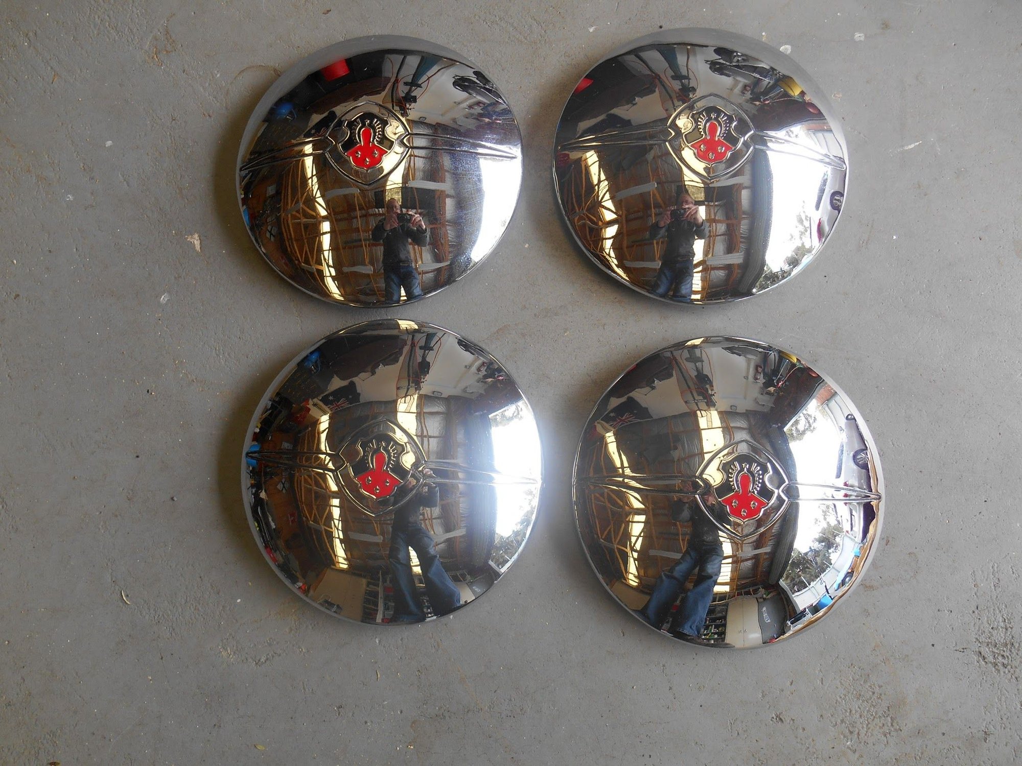

Nice hubcaps were going to be my 2nd challenge as the '34-35 hubcaps are hard to get let along NOS ones. Luckily I came on a local panel beater who decided to move into trim restoration and he took on the challenge to restore 4 hubcaps for me. I selected the best four I had which I'd consider 50/50 and he pealed the brass outer skin off them, removed all the dents and scratches , plated them and carefully rolled the outer back on to the core. They were done nearly 30 years ago and have been carefully wrapped up ever since. Till the next instalment.
The rear body epoxy primed and heading home for a pause - a very long pause

4 hubcaps are restored and waiting to go back on

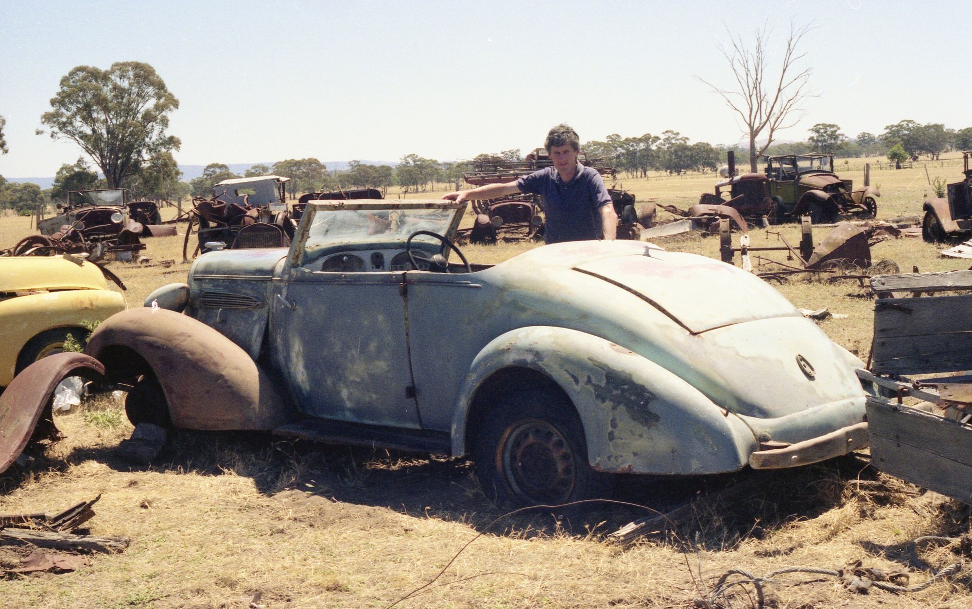

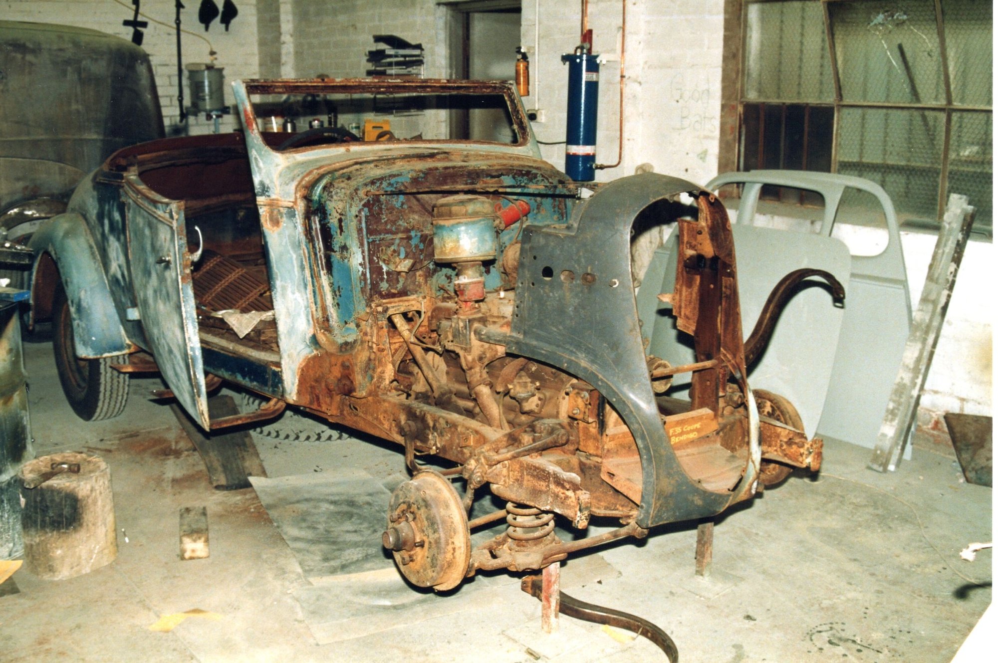

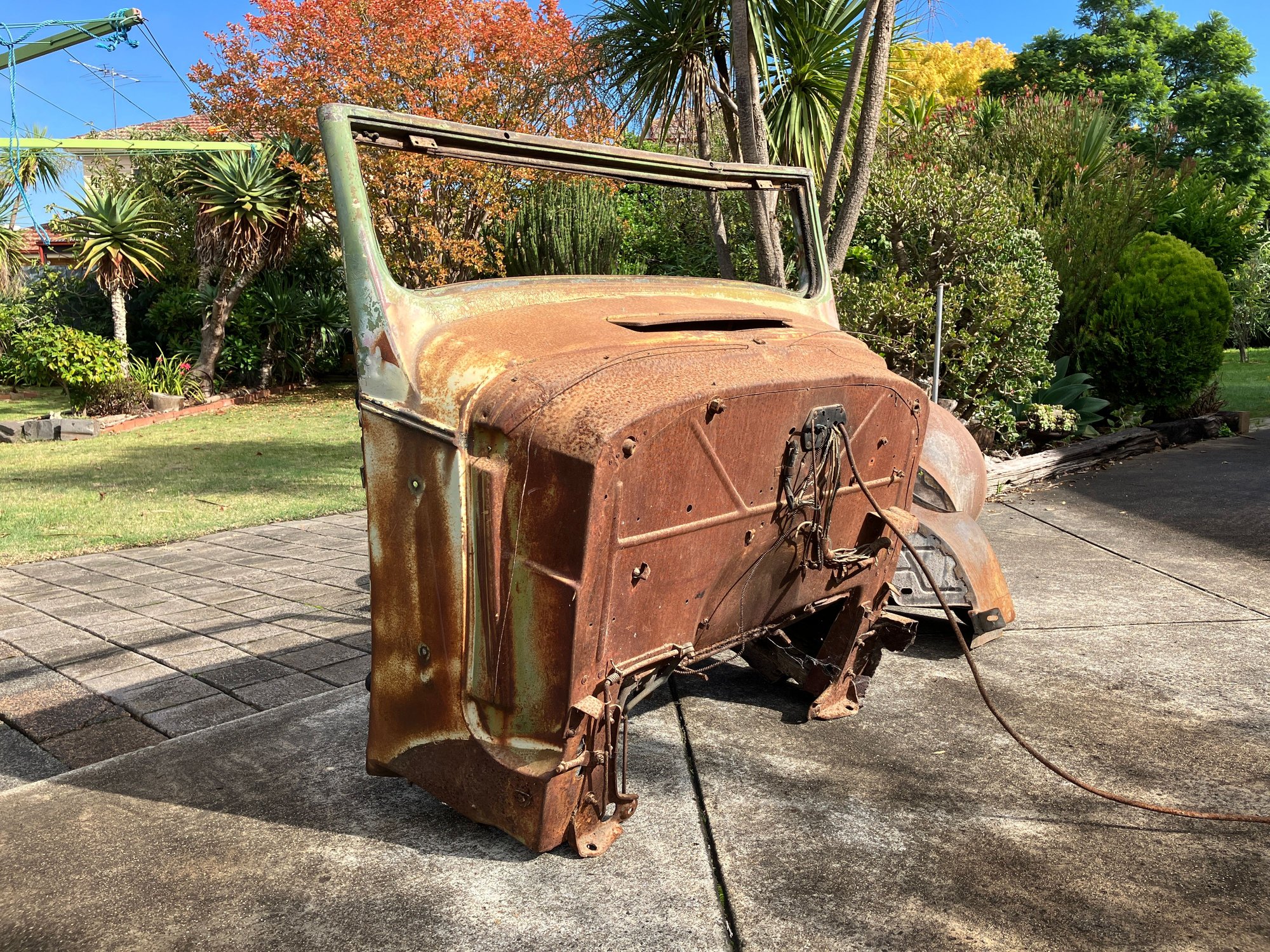

During 1992 and advertisement appeared in a classic car magazine listing another of the 29 of these F.35 Roadster's. The car was sad but had many important pieces that I was missing including the step on the fender to get into the rumble seat, trunk rack hinges (well at least 1 side that I could copy), convertible top folding hood irons and other bits and pieces. The car wasn't close by but after convincing the seller to hold it for me I coordinated with a good Olds friend to come with me on an adventure to buy the car and bring it back to Melbourne. It was a 9 hour drive to Adelaide (the capital of South Australia) and then a further 2 hour drive north to Burra. The terrain was super dry and HOT and probably the reason why it had survived very well considering it had lay abandoned in the most secluded location for probably 35 years or so.
On arrival we were confronted with a few challenges, we brought wheels with us but found there was nothing to put them on - no front or rear axle !!! Then the next challenge was how would we get the body & chassis onto a trailer. The flies on the farm were indescribable there were millions of them and they loved us it was literally impossible to open your mouth even the slightest without getting a feed of them. I was almost thinking this was a huge mistake but we pressed on. The front of the frame was cut off & a chunk of the rear fenders cut away to slide the the body on to the trailer. Once loaded we took off out of there as fast as we could leaving those damn flies behind.
We got the body back home and I transferred it to another rolling chassis so that it could be moved around and stripped down. The cowl was way better than mine, the rust was largely surface rust and the sections where my original cowl were repaired and I wasn't happy with the repairs was in great condition on this cowl - a decision was going to be coming on which cowl to use on my car.

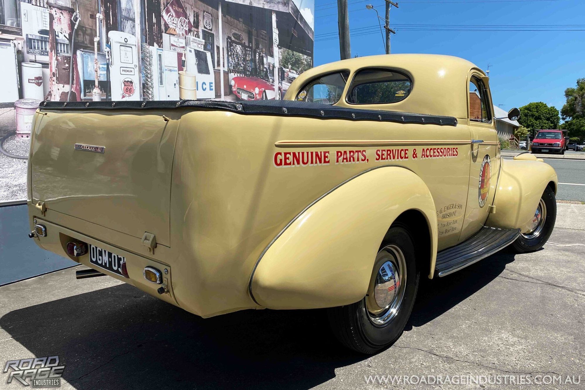

Hi ​​​@Oldsguy yes that vehicle in the background is what we call a Ute here in Australia (or the formal name "Utility"). GM built this sort of style vehicle from the 20's here in Australia but the early ones had timber sides and and tailgate. The all metal body came in from about 1937 on Chev's and a bit earlier on Ford's, unfortunately there were no Oldsmobile Ute's based on the car platform but GM Export shipped Oldsmobile Trucks here (GMC platform) and they were available with the Ute body.
Early all steel body ute - 1940 Chevrolet
1939 Oldsmobile Utility based on the Olds Truck

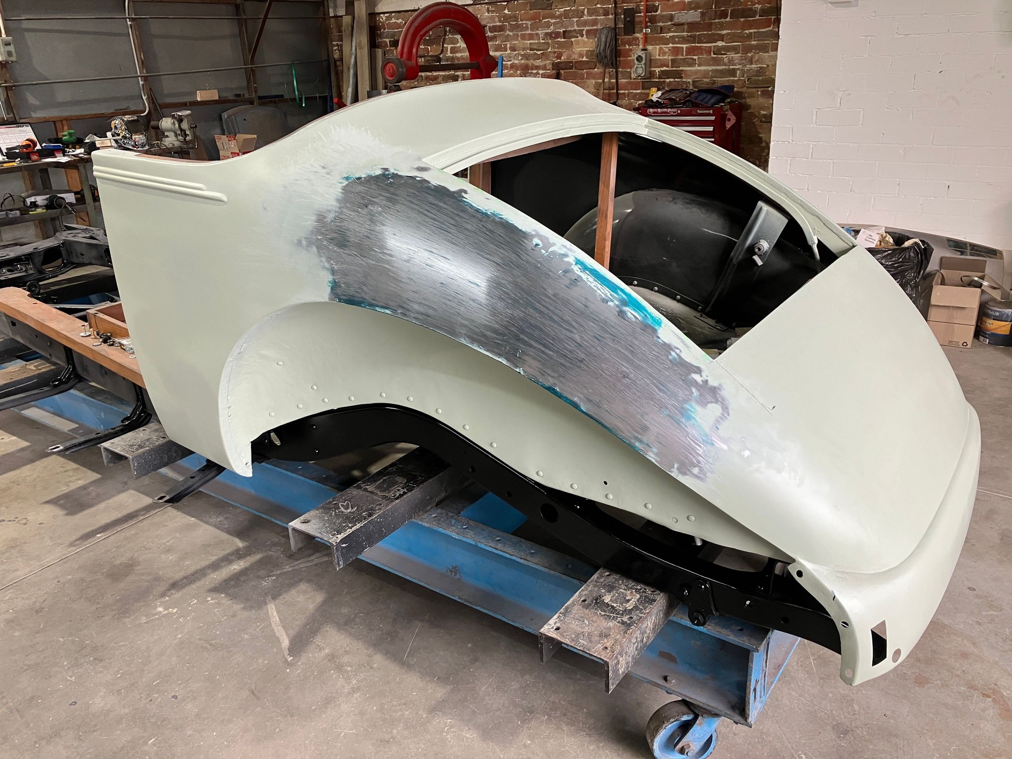

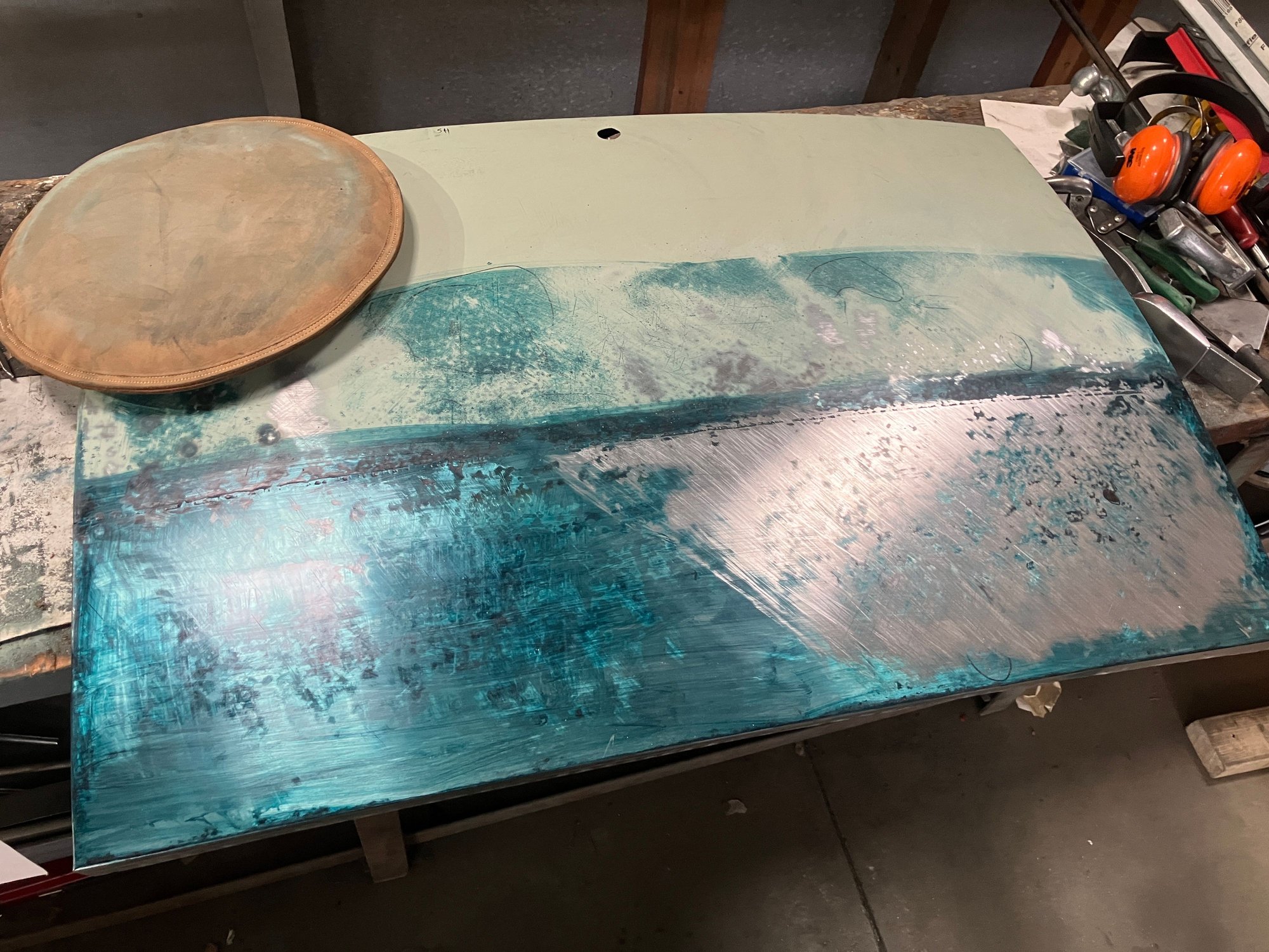

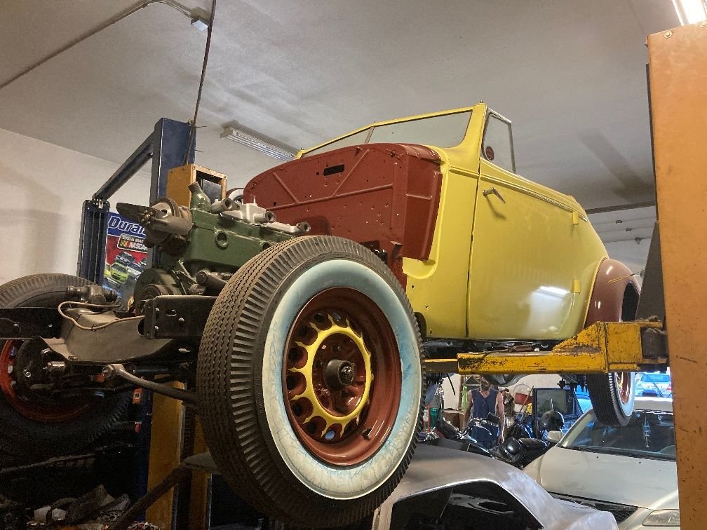

Fast forward to July 2023

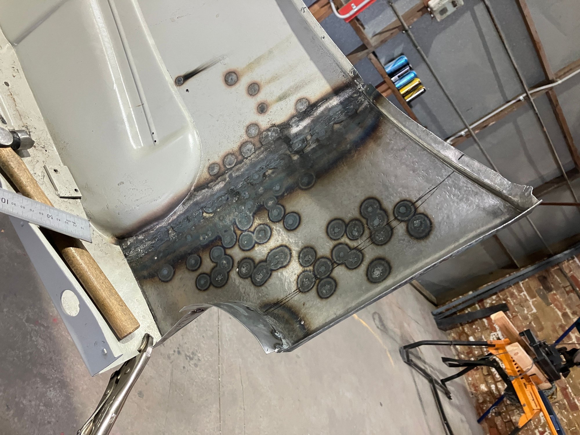

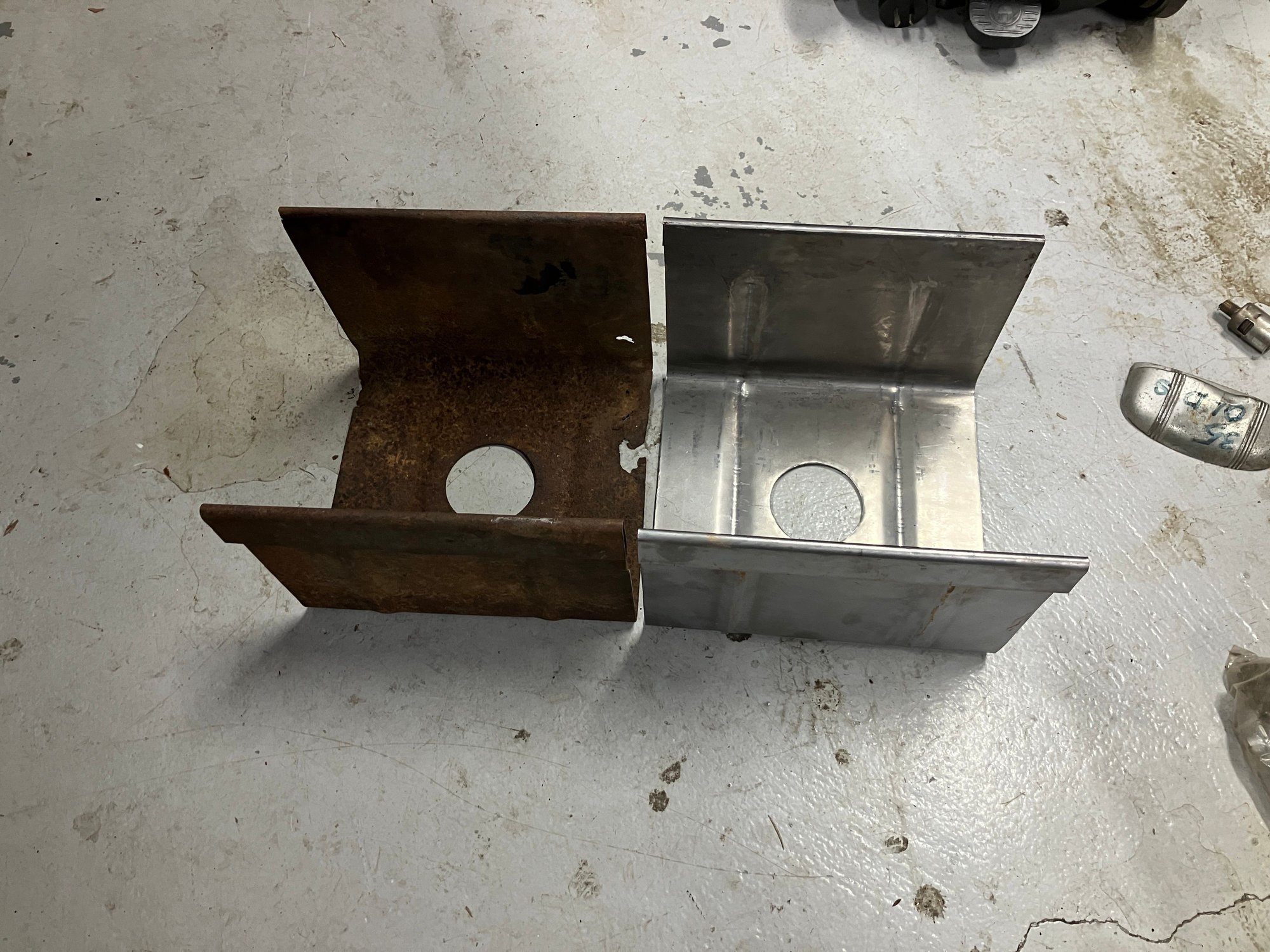

So around June 2023 I decided it's now or never to finish this project and I set a target to have it on the road in 2026 for the Oldsmobile Club of Australia 50th Anniversary National Meet. The cowl from the 2nd Roadster was to be used and whilst it was better in some ways it still needed heaps of work. We found that the LH pillar had been bent so a template was made from the right side and an initial attempt was made to straighten it before further work was started. We ended up un-picking the dash from the cowl as they were "leaded" together and once the dash was off the timber frame or what remained of it could come out. The cowl & dash were then sent out to be "dipped" (caustic soda to clean off the paint followed by phosphoric acid to remove the rust). In hindsight we should have held off epoxy priming it till the repairs were completed but you learn things along the way. The dogleg sections of the cowl where the fenders were originally bolted up to were quite thin and needed to be cut out and replaced, similarly the cross bar at the top of the windshield and most of the dash sections including pillar covers, and cross beam had to be replaced too. I'm not a metal guy but David who's doing the work is doing a terrific job. Another update coming next weekend.

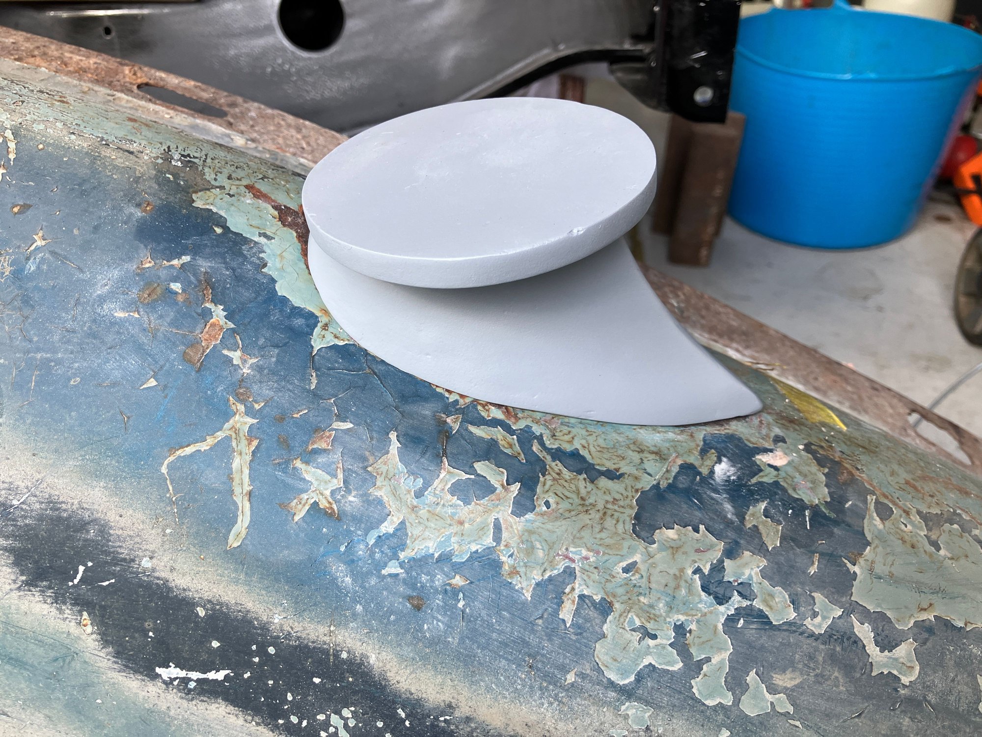

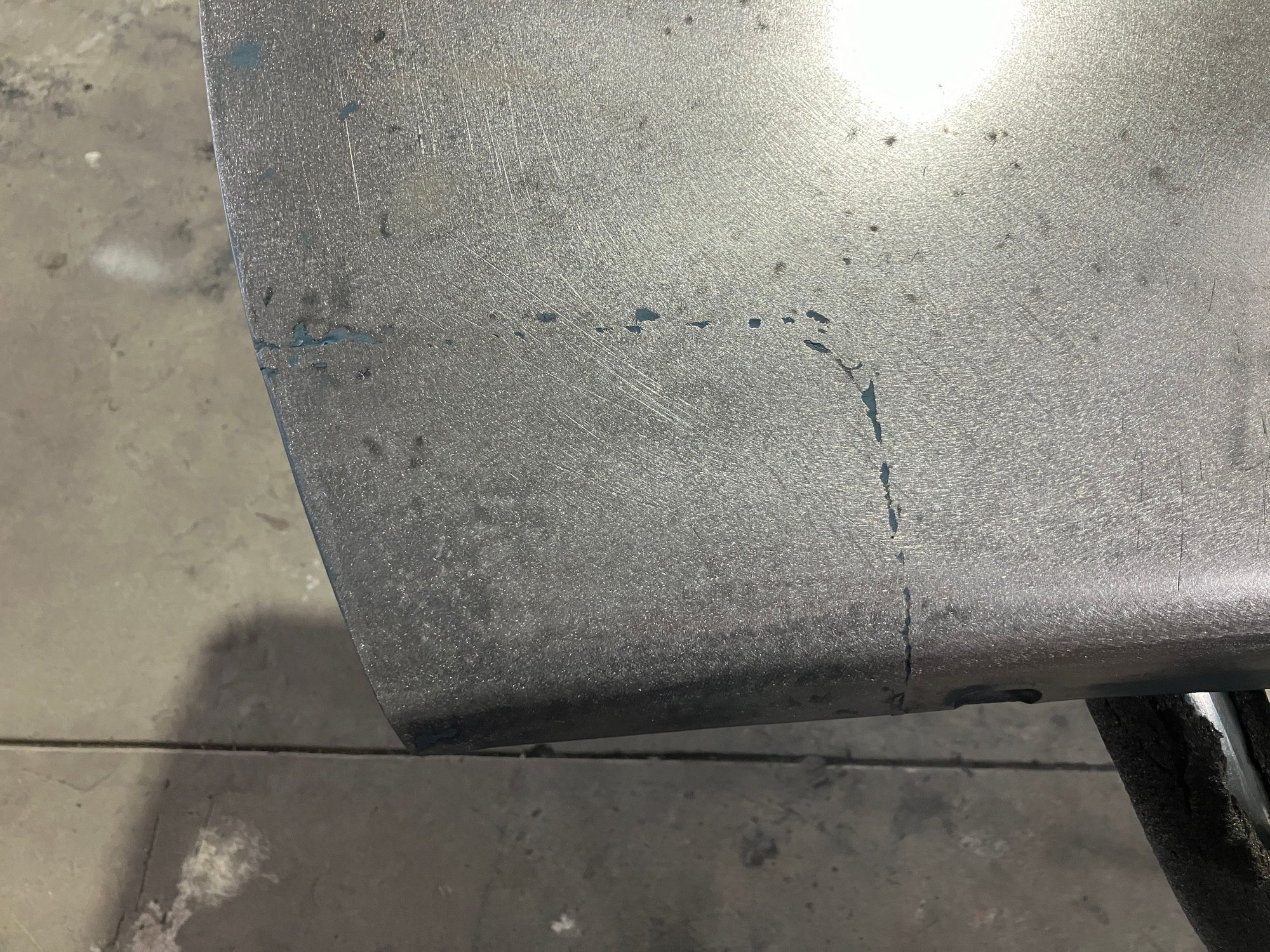

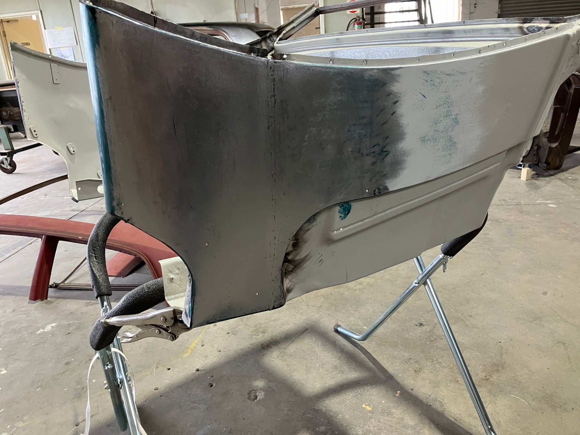

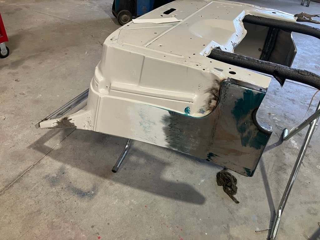

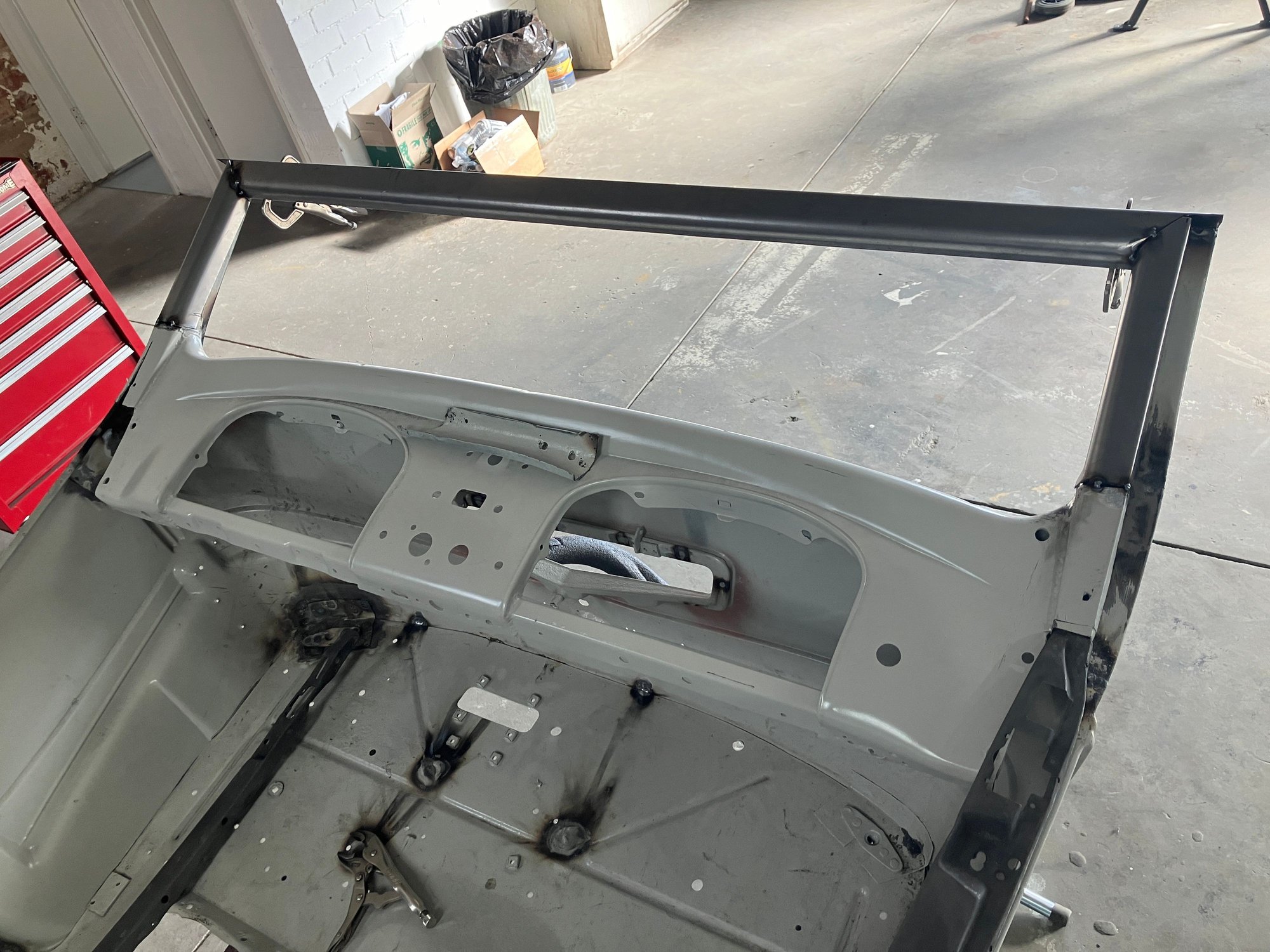

August 2024 Update

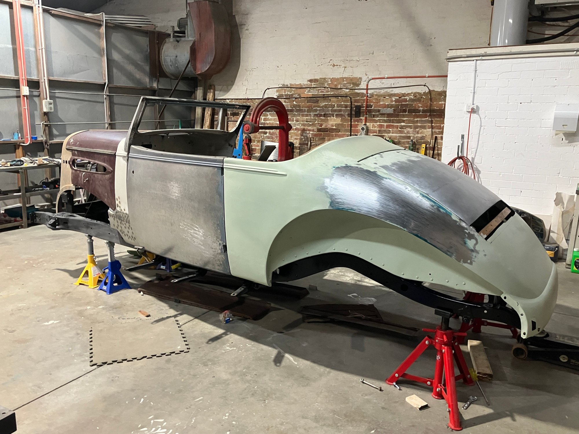

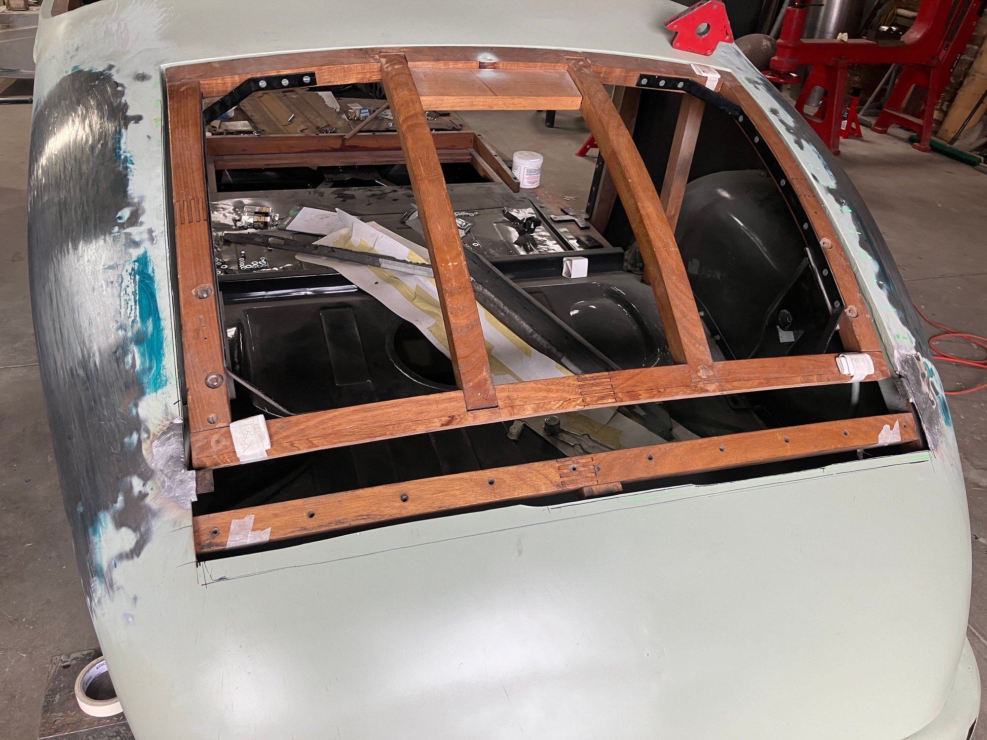

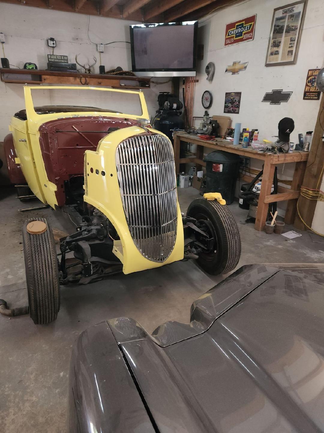

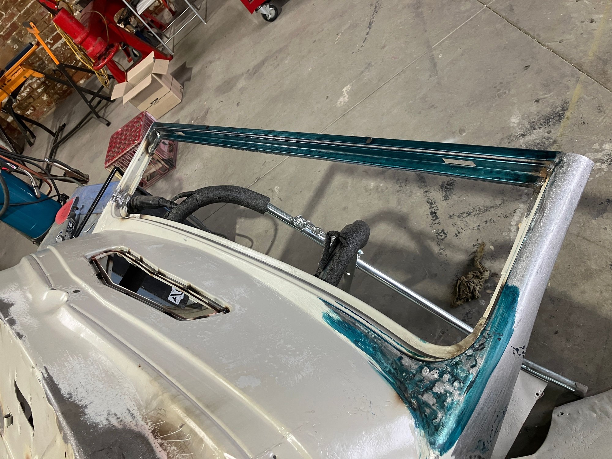

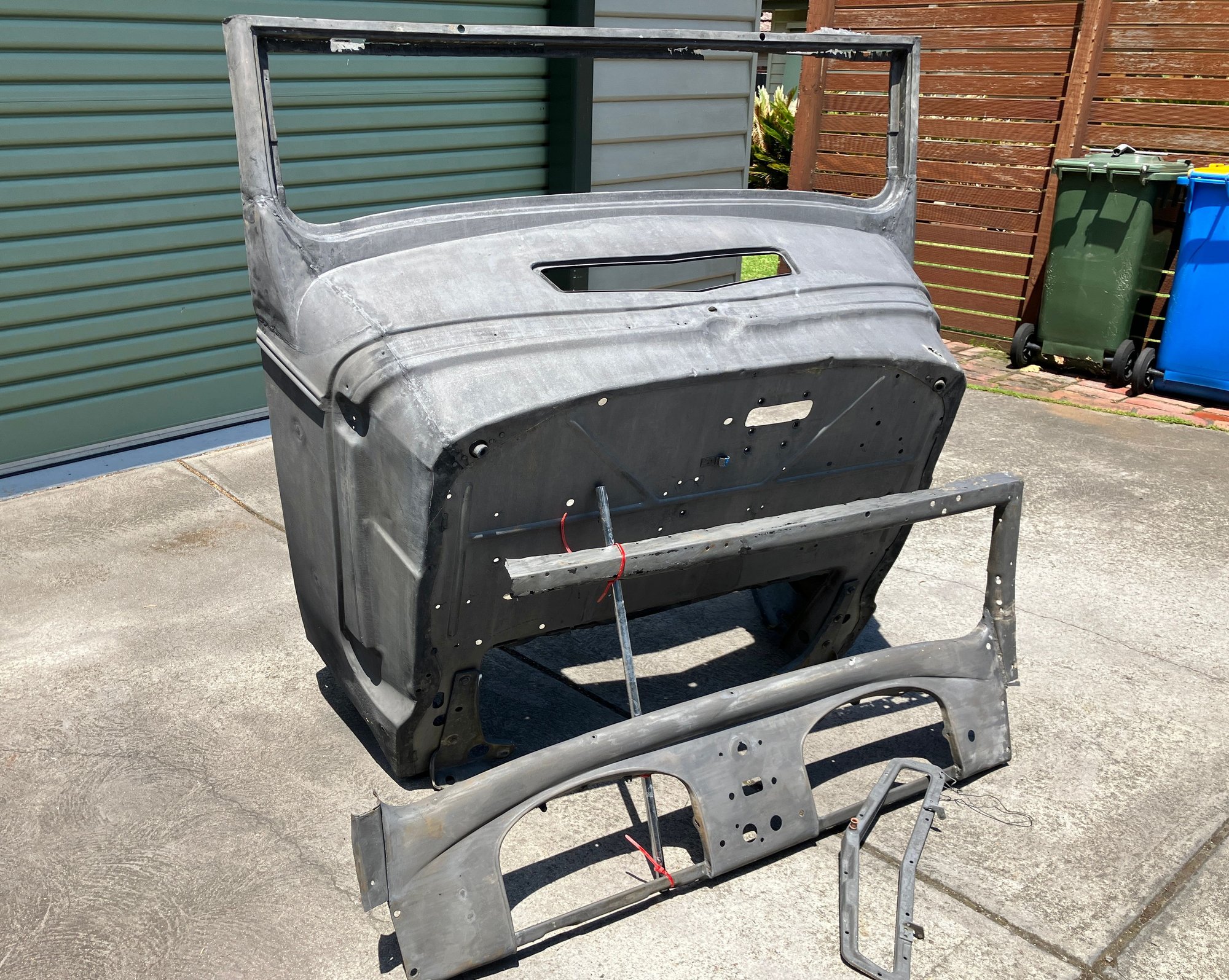

The progress continues and we have now moved the rear body on to the good frame that is straight & true. This allowed test fitting of panels and gaps and for the poor repair that was done on the back edge of the deck lid in the early 90's to cut out and the edge replaced. David my panel beater also increased the gap at the back edge so that the deck lid wouldn't hit when opened. New battery box has also been made, floor panels repaired or remade, doors have been repaired and metal finished as has the right rear fender. Unfortunately the left front fender is too rough to use and we'll end up having to convert a standard fender and turn it into a sidement fender in the next few months.

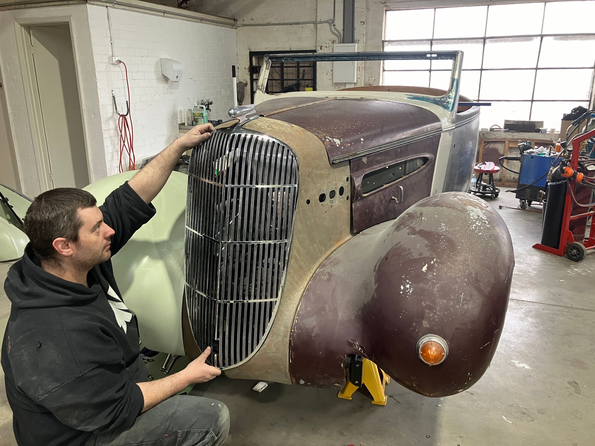

Today we decided to check how the grille would fit and the grille surround will unfortunately need a bit of massage in order to allow at the studs on the grile to nicely slide into position. The grille is a real unicorn as it's an NOS six cylinder grille and anyone with a '35 will know hard they are to find.

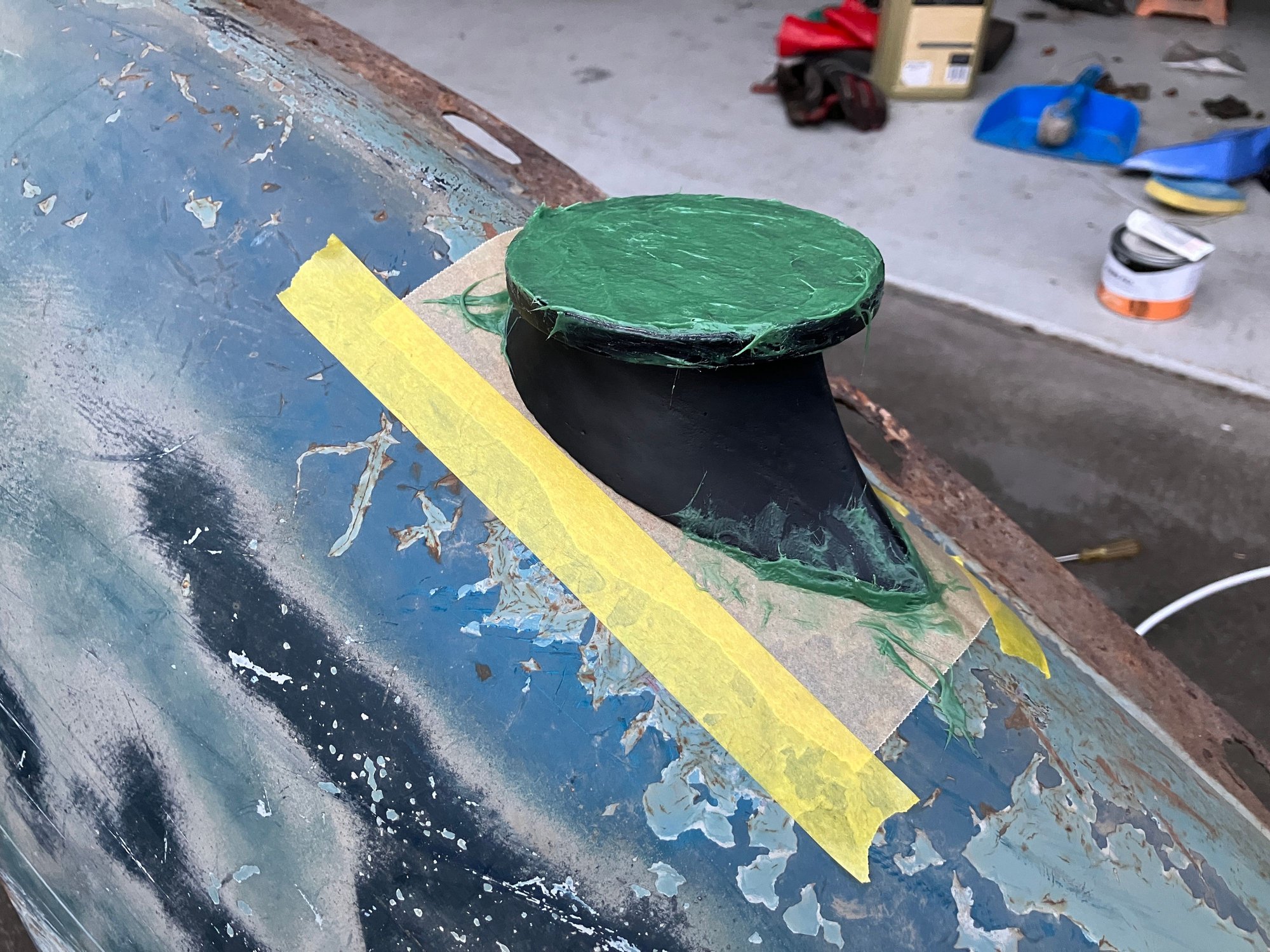

I've also cleaned up the badly corroded casting of the step on the fender for the rumble seat and used body filler to get it into decent shape so that they can be recast. With a bit of luck the new castings should be ready in a few weeks.
