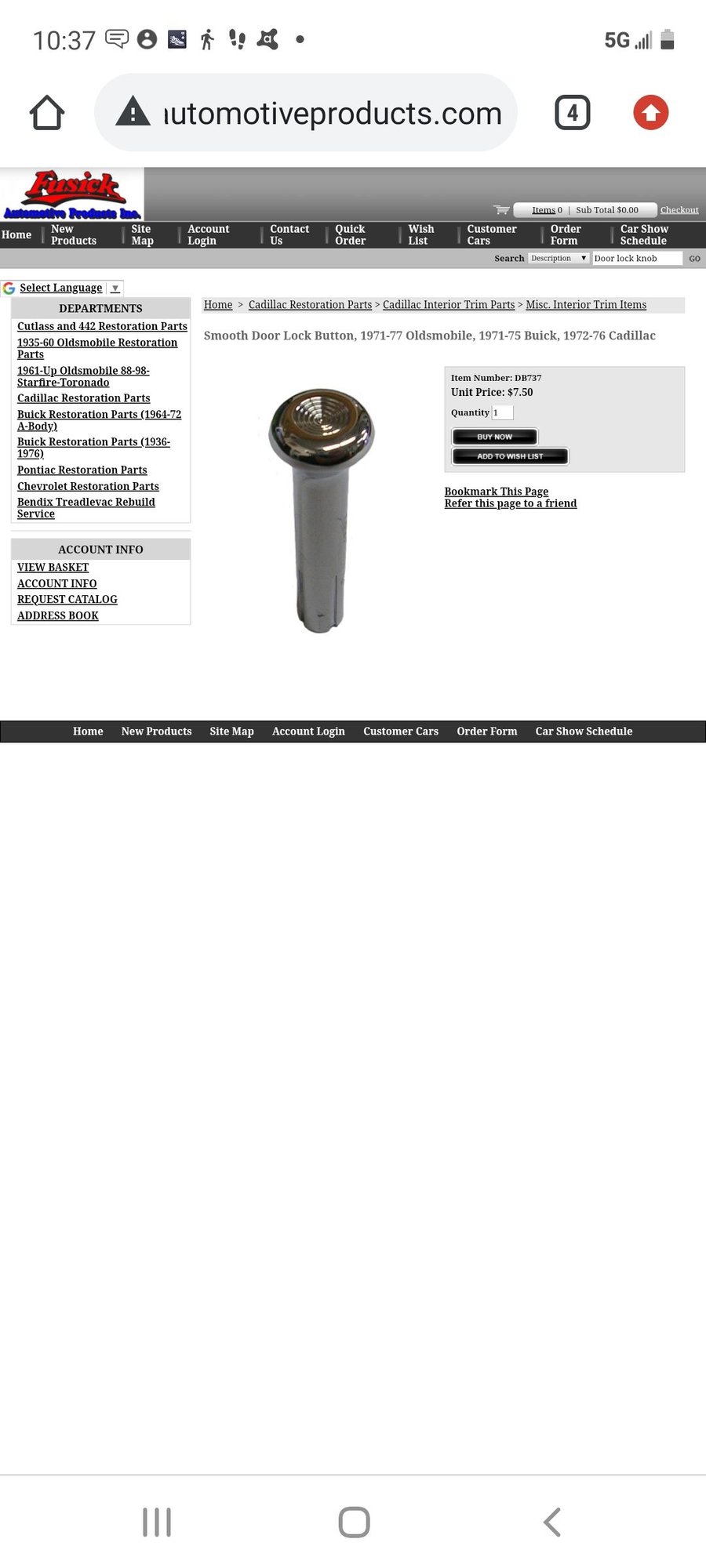

Gotcha..so if you look at these pics, splines are listed for '68-'72, and smooth are listed for '71-'77.
Was there an overlap?

Once again, don't ever assume an aftermarket supplier catalog is correct. FYI, Fusick also lists the application years for these motor mounts incorrectly.
