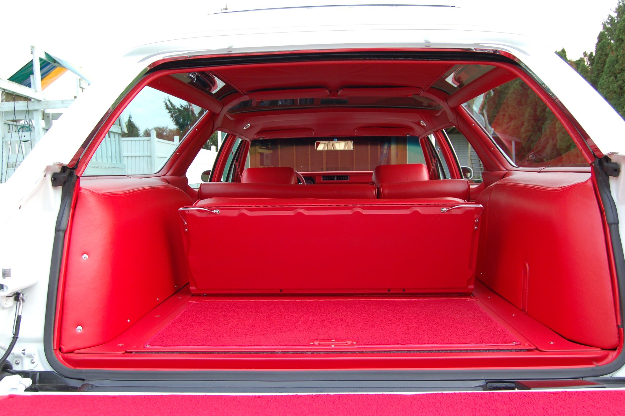

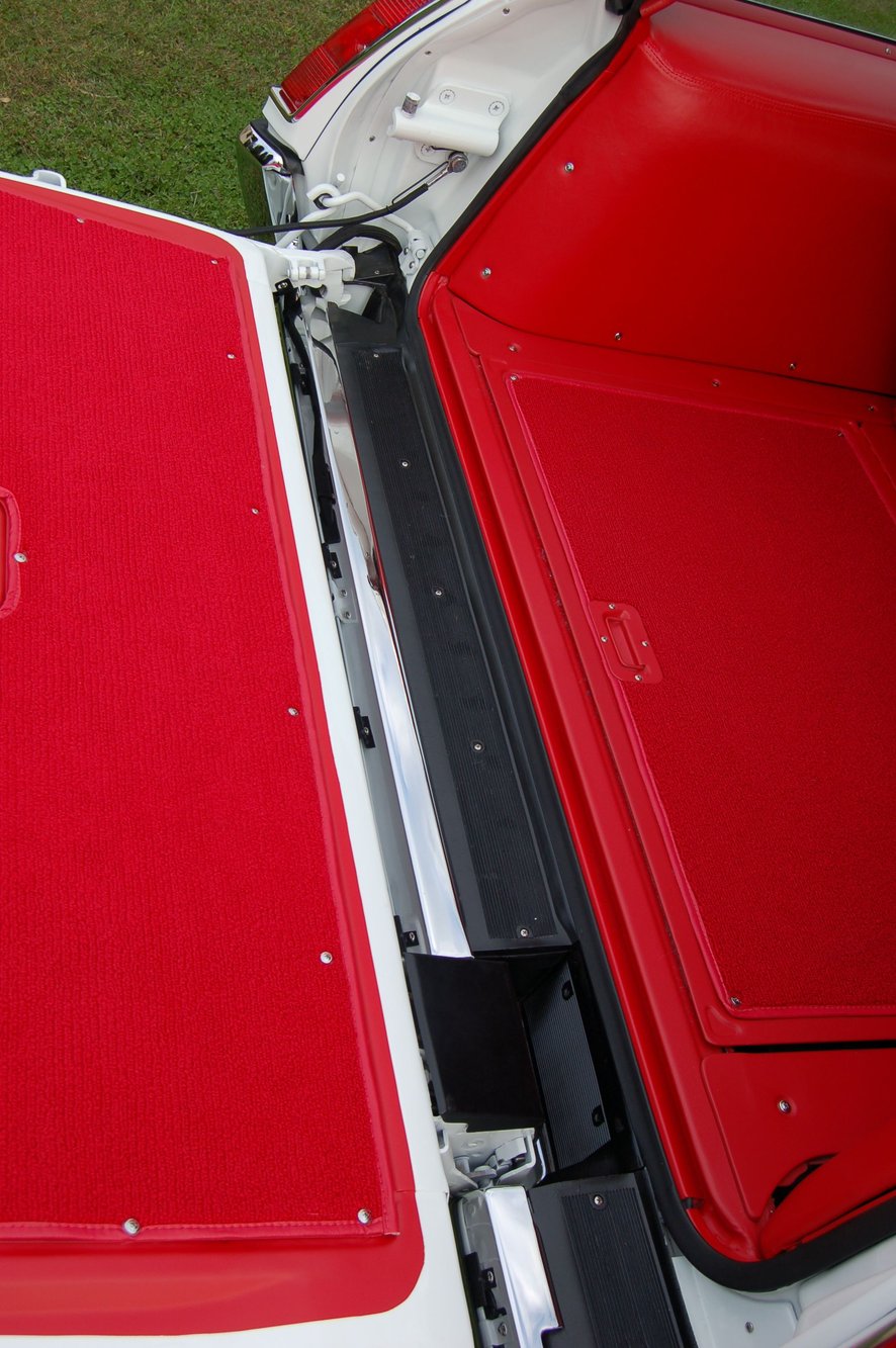

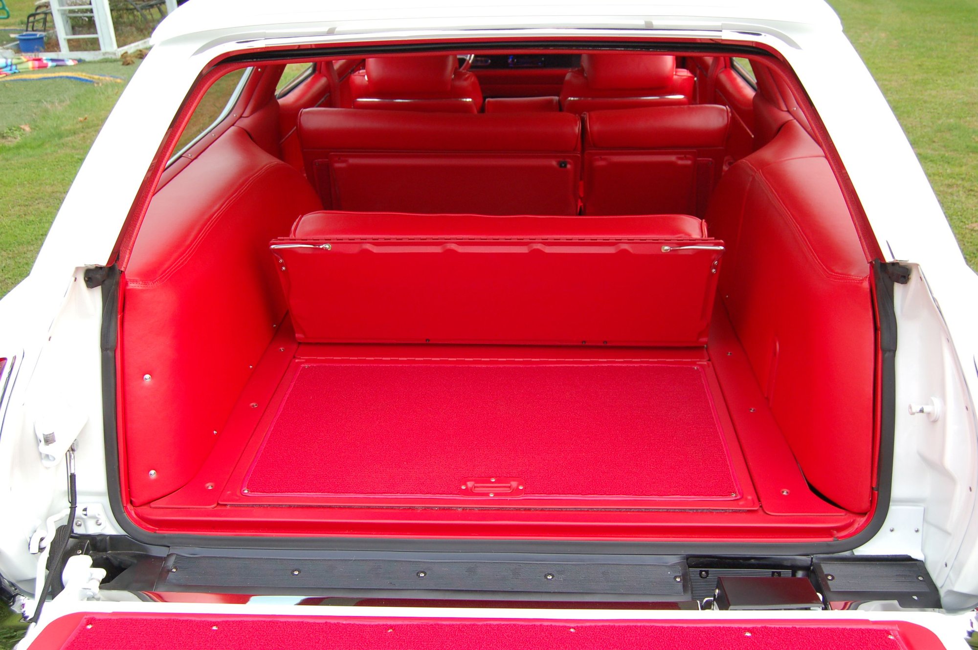

I have never heard anything negative about their quality of work. Different storry concerning their lead times and comunication. That price does not sound completely un-reasonable, but you can get correct 80-20 loop carpet for about $50 per yard in 40" length. Possibly less through a local upholsterer. I would check around locally for shops in your area that can do the work. Should be pretty straight forward for a shop to cut pieces to size and bind the edges. When I had mine done, I took all the metal panels in so he could make the peices to fit.
I realize you can only see 2 of the 8 carpeted sections in these photos but you get the idea.

I bought premade carpet for my 442, but the carpet in the front and rear sections faced in opposite directions.
So, when I needed VC carpet, I went to a local upholsterer recommended by the street rod community.
The upholsterer even carpeted under the third seat, so you couldn't see bare floor under it when the seat was in place.
As well, he sent the rear (flat) carpet sections to a local area-rug shop to have the edges serged. Serging, or overlock stitching, is narrowly-spaced thread, placed by machine, which is what the factory used.
I was very happy with how the entire job came out. And, I had a wider selection of color than the premade carpets come in.

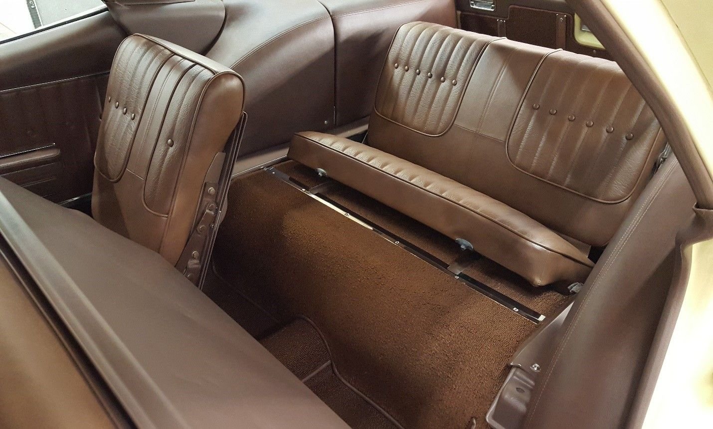

Karl, here's a picture of how he arranged the carpet under the third seat.
Gary
He also did nice work in replicating the original seat upholstery

Wow, that looks nice! What did he do for the carpet edges along the 2 channels for the 3rd seat runners? I don't see any serging or vinyl binding.

I used red vinyl over 1/8" foam in that area with 2 strips of aluminum for the plastic guides to slide on. These are the only shots I currently have of that area so it is a little hard to see.
I was still working on the interior in this shot and the carpet under the second seat was not bound yet.

I can't say with certainty, but here's what it appears to be...
  1. The carpet is accurately cut between rows of tufts, leaving a small width of intact backing at the edge so there's no fraying of the remaining tufts.
  2. The carpet is bonded to a sheet of stiff black plastic that is barely visible beyond the edge of the carpet.
  3. In turn, the plastic is bonded to the floor pan metal.
