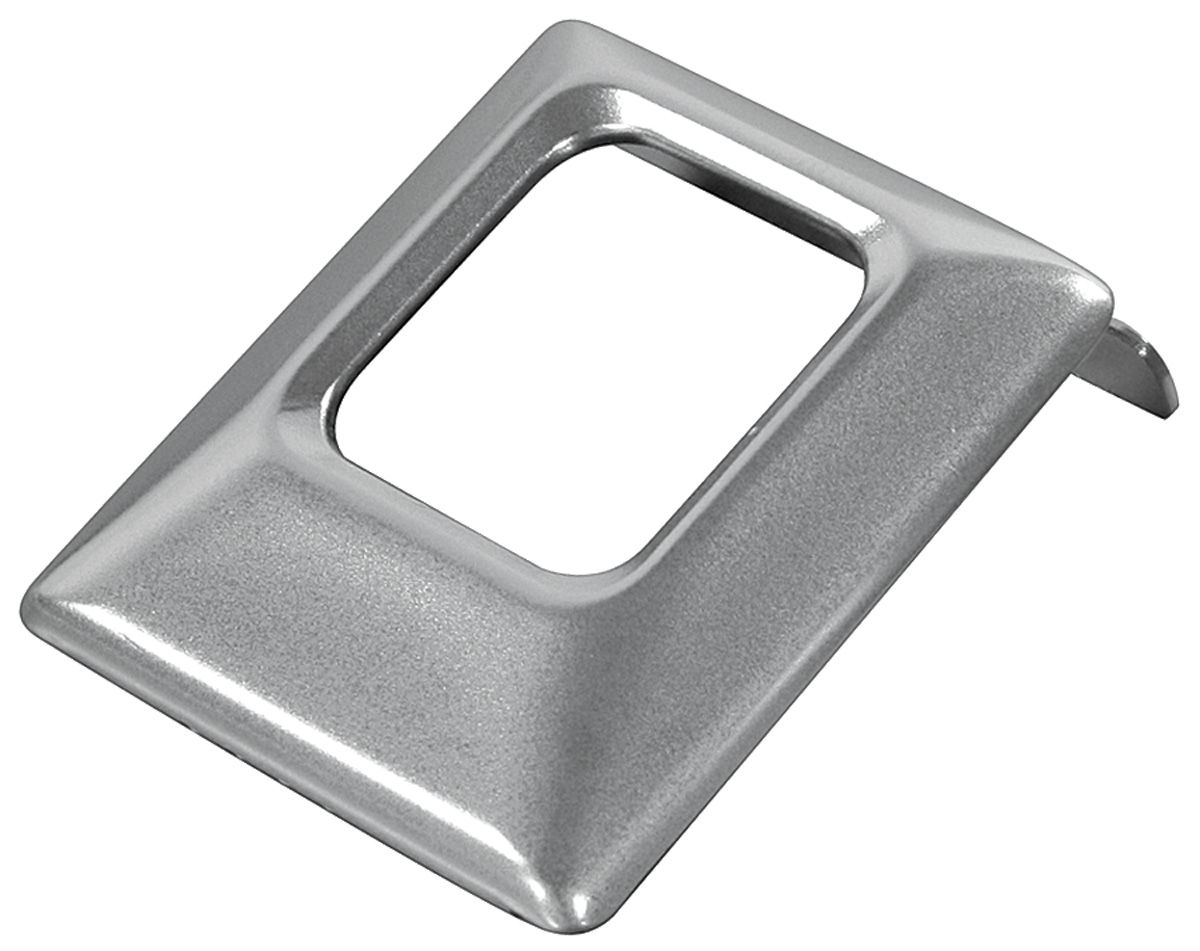

To disassemble them, pry the lower portion of tabs up on the rear of the buckle so they disengage from the lower buckle housing, then lift the cover. It will rotate forward and up to come off like a clam shell. The pic below shows the tabs. They are hard to pry so don't be afraid to use a bit of force on them.
