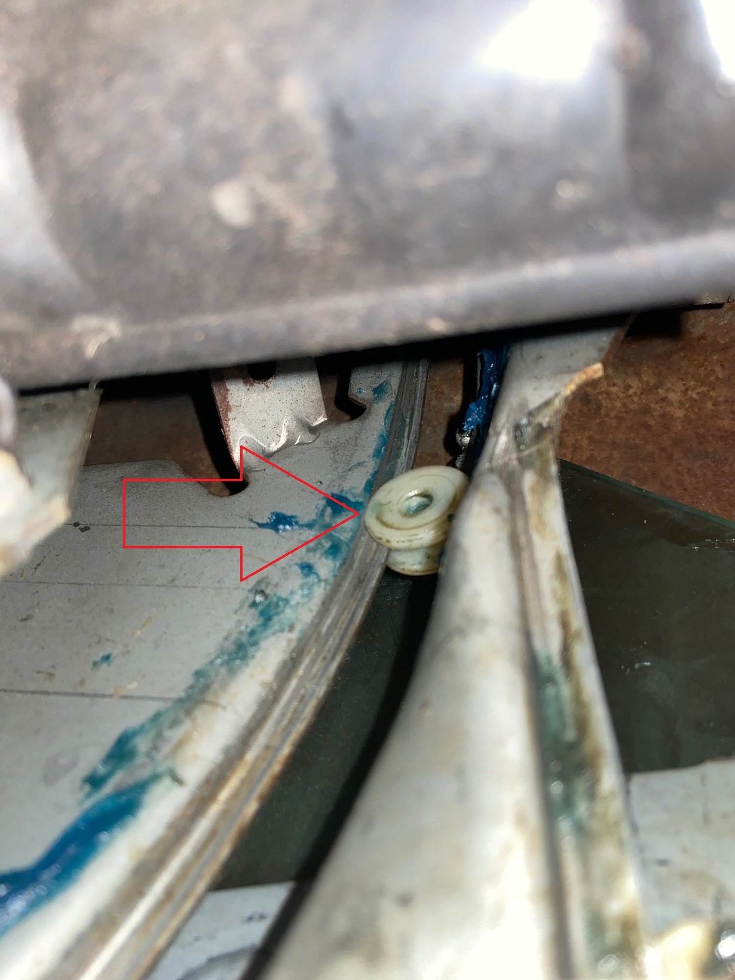

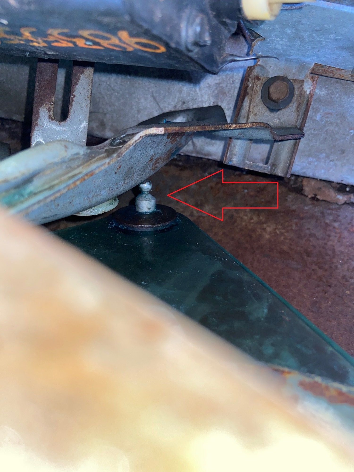

Hi. Not sure if this is the correct sub-section for a window question but...
I have a '72 98 and the drivers' rear window has popped off it's regulator/rails/lower plastic round connection a few times. Thinking I need a new ...white plastic 1" round connection point for the bottom "nipple" of the glass. Wondering if anyone else has had this happen, or purchased a new white plastic disc to solve the problem. (See pics).
Thank you. Hope that made sense.
Jay

Is it possible that the metal regulator that the nylon "washer" rides in has been bent a little or is maladjusted? It looks like the lower end of the regulator can be moved by loosening the bolt on the bottom and moving it a little one direction or the other. Replacing the nylon part would not hurt but may not be necessary.

I'll check that out. Thank you
