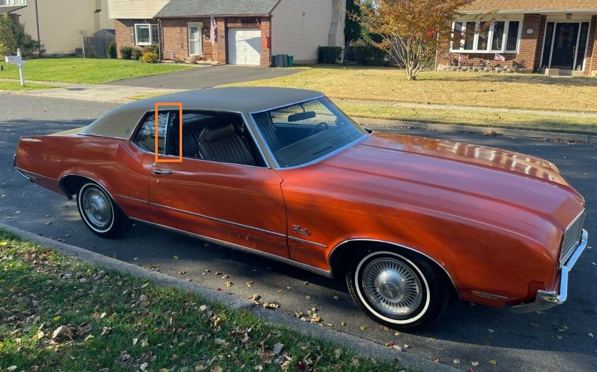

Found out my 72 uses just a little double sided tape to put the hardtop door window to quarter window seal piece on. Rolling the window down caused the rubber molding to get under it and flip it off the window. The other one is not stuck on very well either.
I am thinking 3m double sided emblem tape for most of the length. Is that correct to reattach with?

The piece in the box. Not my car.
