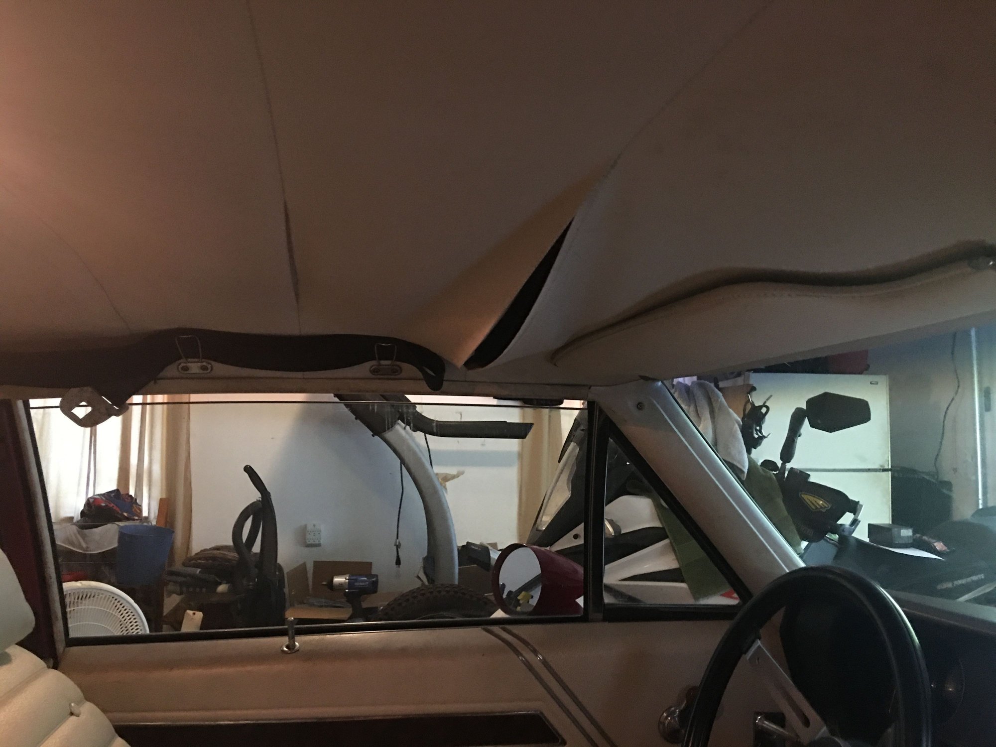

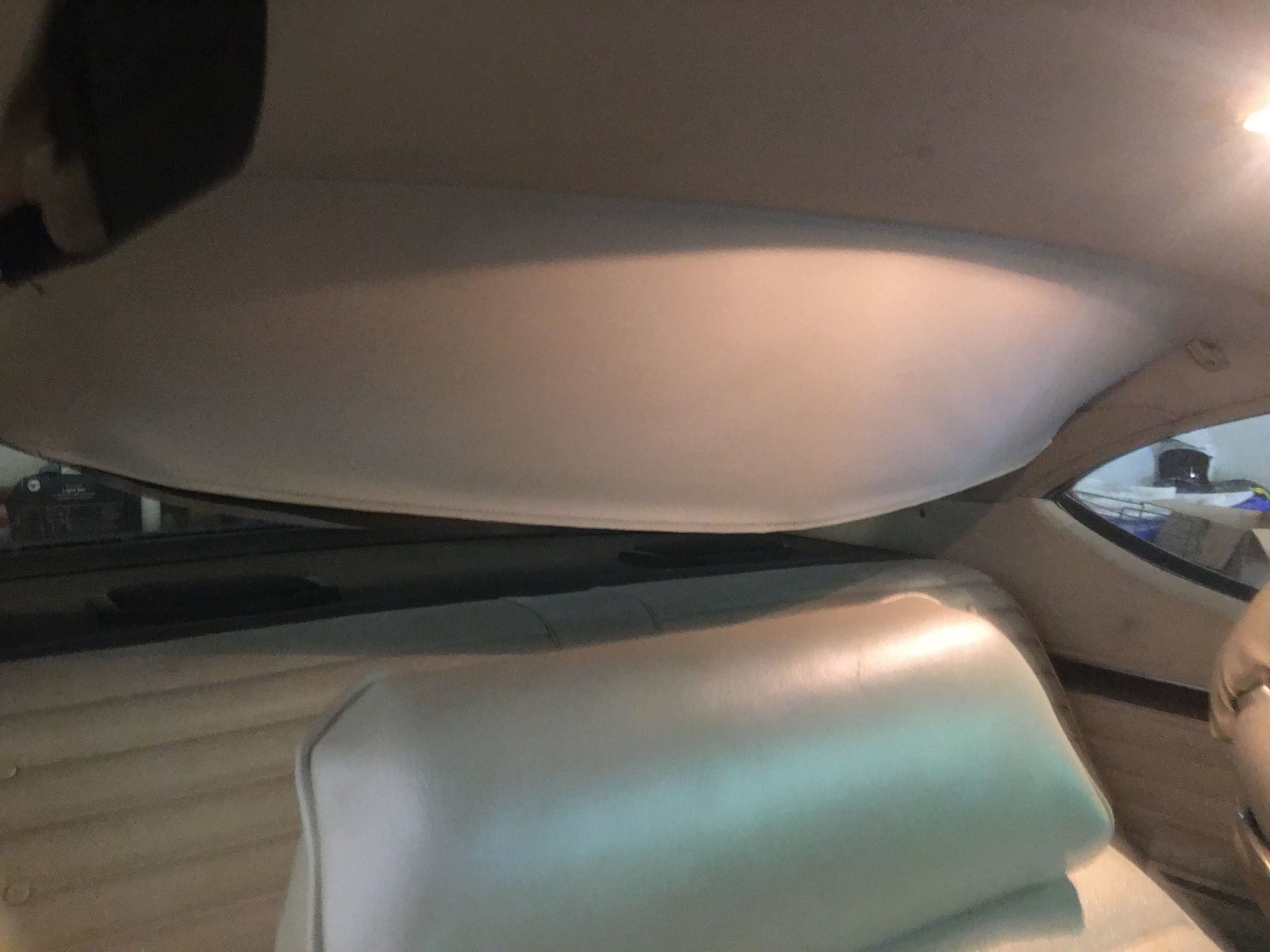

Headline Rip Rear 1
Headline Rip Front
Headline Rip Rear 2

The front one is a bit of a pain because both sides of the seam have come loose from the bow sleeve, which is what keeps it "up.
I would use a curved needle, sew the front panel to the sleeve, then pull the panel behind it up (use some binder clips to hold it) and use the curved needle to go through both the sleeve and the front panel.
It does not have to look nice, just enough to hold it up.
The middle rip is easy, same thing just use the curved needle to go round and round to close it up.
The rear rip, i can't quite tell is is the rearmost panel? did it just come loose from the rear plastic window trim, or did it rip out at the rear window? If it has ripped at the rear window, there is nothing you can do- you need that little bit of material that goes under the trim, for the trim to hold it in place... If the trim is missing and the headliner just came unglued, then use some contact cement and glue it back onto the pinch weld at the back window (the rear iwndow trim goes over the pinch weld to hold the headliner on back there.
These fixes need not be pretty to hold it up... just enough to keep it flapping around.
If this seems like pain... then maybe just cut out the entire headliner, mark and number the bows, and then plan on a new liner after your trip.
