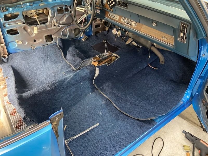

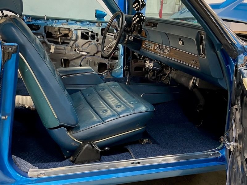

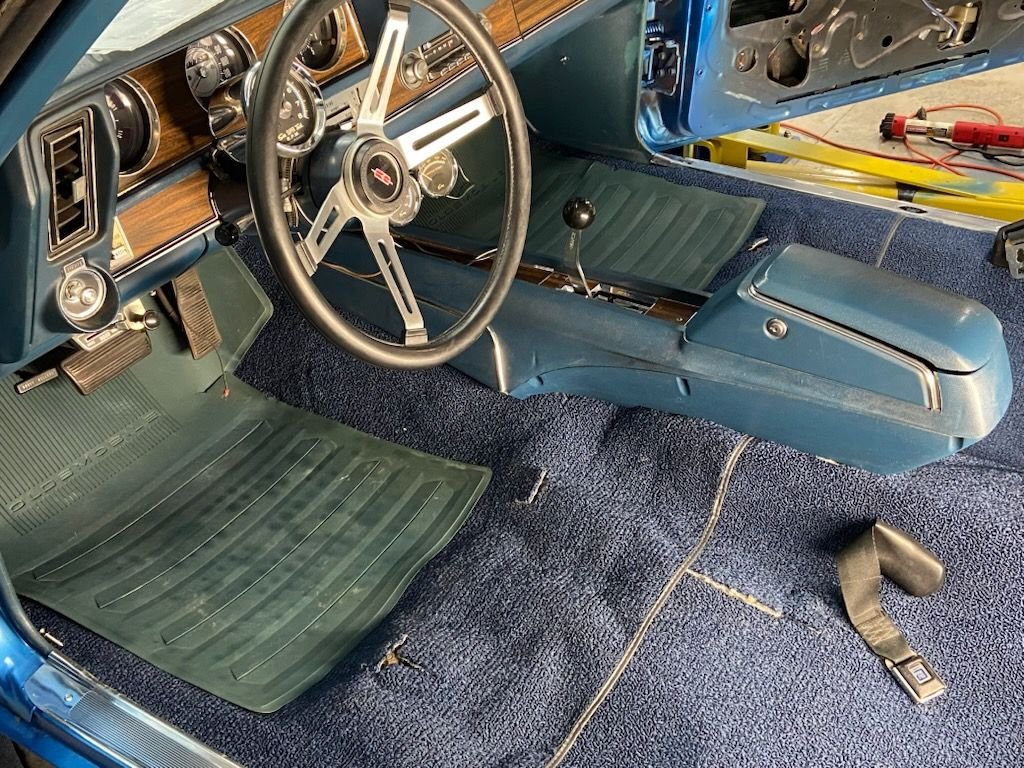

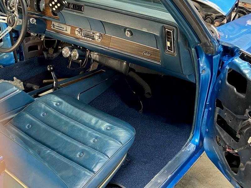

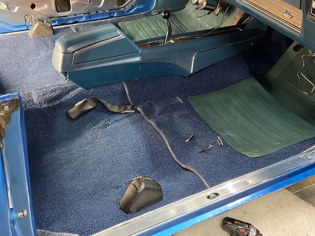

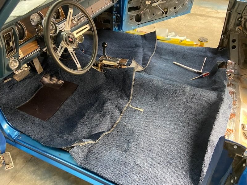

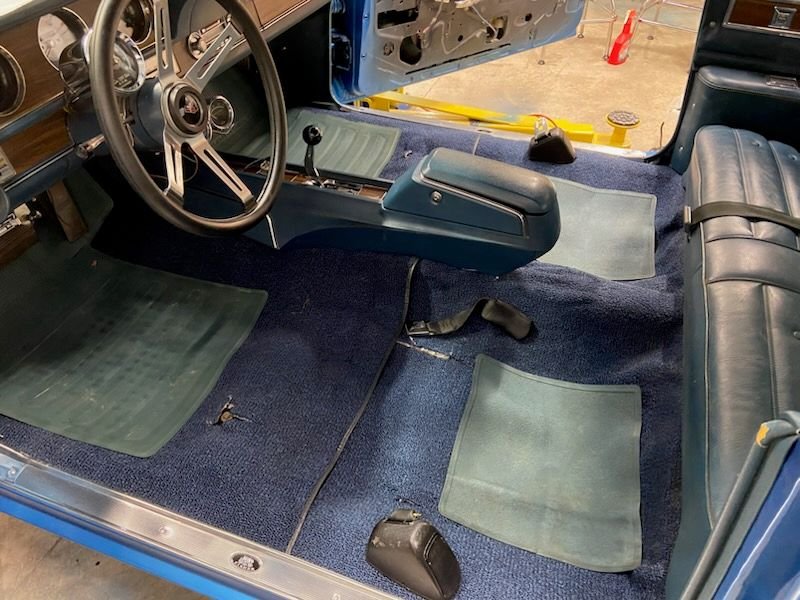

Thanks oddball for that info. See pics and comments/questions below. My 72 442 was built in Arlington down your way and was owned in & around Houston, Texas!
First, I laid the new carpet over the old original carpet and when I thought it was close, I cut the same spots on the new compared to the old console cuts. I then decided that it might not be the right way.
Well, I laid the carpet out in the back and the front just to try to center it! The holes for the console didn't quite fall where I thought they would, but I tucked it un up under the dash and moved it all around, so it looked right. I used a few 60 bags of sand to pull it down on the hump and started cutting seat belt and seat mount holes. I started with the seatbelt next to the console first.
After I got the passenger side done, I put the seat in and bolted to w=two bolts up front down. I have the Year One seat mounts that offset them about 2 inches. That kind of messed with the flaps to cover the seat rails but when I re-install the seats, I'll deal with it then.
After I got the passenger side done, I put the passenger seat in and bolted to two bolts up front down for a picture. I have the Year One seat mounts that offset them about 2 inches. That kind of messed with the flaps to cover the seat rails but when I re-install the seats, I'll deal with it then.
I'm now working on the drivers side but need to deal with the console first. There are two screws at the front of the console that screw into the mount. there are tree screws that eventually go through the Dual Gate top plate into the top of the shifter then it looks like two might go into a shallow mount into the floor and then two more at the tail end of the console into the rear mount. Per your suggestion. when I cut the last mount,I left a little over the floor mount so it will sit on carpet
I just can't remember since I took the car apart 20+ years ago! It looks like I'll have to remove the inner liner from the console to screw the last 4 rear mounting screws through the console into the mounts?? Is that correct? I'm moving slowly. I'm going to look up WTHIRTY1's project to see if his console photos give me any more clues!

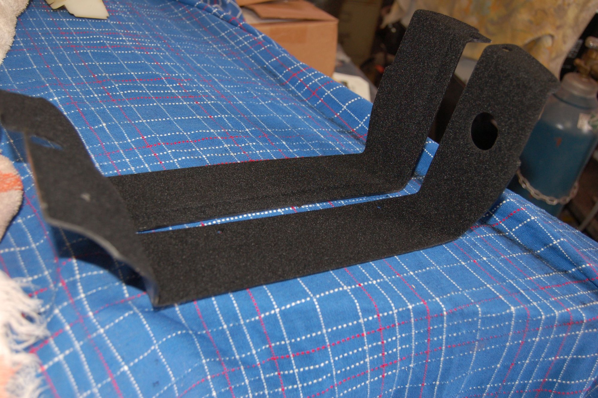

I'm working on a column-to-console conversion right now in my '72 - installing a new ACC Essex (deep pile) carpet with the heavy mass backing as part of the project. In the front carpet, I only cut a slit down part of the middle of the hump and fitted the carpet over the shifter, instead of all the way to the edge Then just trimmed as needed for final fit around the shifter mechanism so that I didn't cut too much away from the sides and accidentally leave open edges trailing below the console frame.
One thing I did do when bolting down the rear console to its floor bracket was to line the inside console mounting arm(s) with metal frame bracket sections (rectangular drilled sections which fit inside the mounting wells) so that I could run the bolts thru that for some extra support for the plastic mounts. These are just flat chrome L-brackets like you find at Walmart that I cut straight to fit inside the bottom mounting wells.

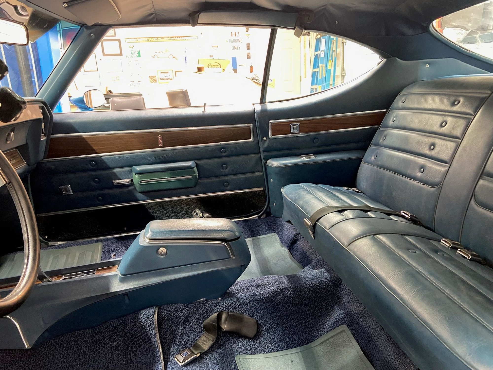

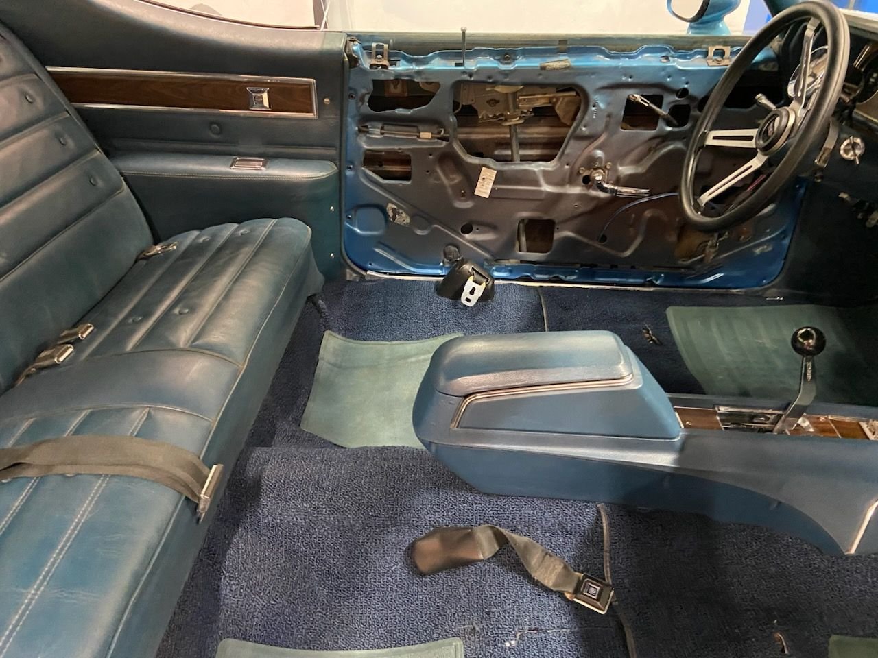

Well, I'm getting ready to clean/lubricate the back seat electric windows, install new waterproof papers, the panels and rear seat. Here's how we look as of this morning! Slowly but slowly!
A couple others:
Old Jan 13, 2025 | 06:12 PM
OLE442's Avatar
Joined: Mar 2019
Posts: 1,139
Here are a few photos of the interior rear panels, rear seats installed along with a view of the carpet, head liner and package tray installed. Waiting on the upholster to give me a quote to repair the driver's seat. I'll hang my Craig 8 track tape player on a removable mount under the dash while I'm waiting.

I used your W-31 resto thread a lot. I had the old carpet and laid it out and then laid and tried to center the new ACC carpet over it. The new was way bigger than the original. I started trying to cut the carpet for the Dual Gate and then laid it in the car. It did not look good to me. I pulled it out and put it on the old carpet and made a couple more small cuts and retried fitting it in the car again. I did not like how it was going so I made the decision to go free form since mine is no ways near better-than-factory resto you did! That thread kept me in awe for a long, long time!
Any rate it's in and looks fairly good (the original carpet on the car was the worst part of the car!) I was happy a couple weeks ago when I tossed it out in the garbage!
I have some weird cuts for the seats since I'm installing them with the Year One seat relocators offsets. It looked pretty good when I installed the passenger side loosely.

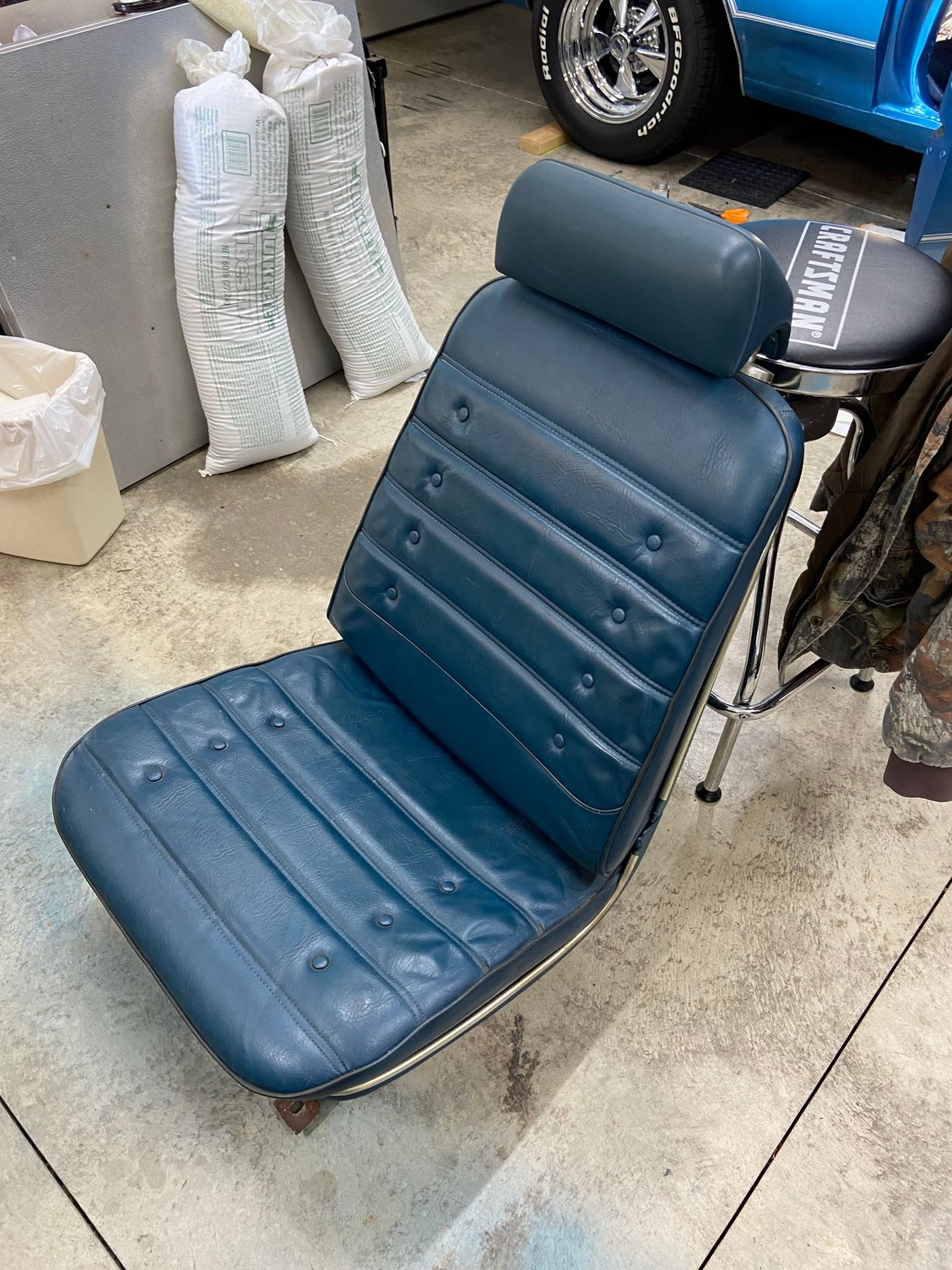

My car has almost 48,000 miles on it but it’s 53 years old so I took an account when I turned in my order to Legendary. I ordered both seat covers. I ordered brand new cushions for both seats. The felt the burlap and some other things plus a couple bags of hognoserings. I already had the hog nose, pliers, and a couple other pliers for pulling the stuff on, but I don’t think it’s gonna be that bad. I watched the video from legendary and I’ll follow that. I’ll do the crappy seat first and all that from Legendary cost me $1307. The lucky thing is is that my day door panels and other trim in the interior is all in really nice shape. They are due to arrive somewhere in April!
Old Feb 4, 2025 | 02:51 PM
OLE442's Avatar
Joined: Mar 2019
Posts: 1,139
Here’s the passenger seat. It’s really nice. When I do the seats I’m gonna try to save this one without tearing it or anything and put it up for sale on classic oldsmobile. Somebody might be able to use it to make their interior look better if they’ve got a dark blue 72 cutlass.
