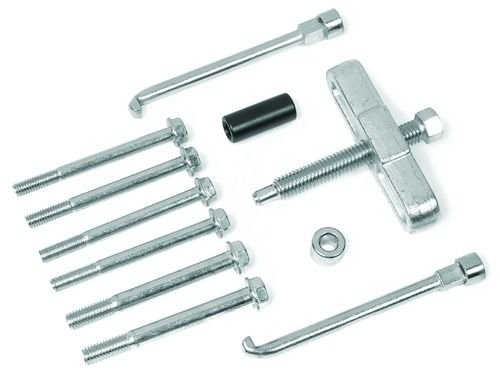

If you purchase an English steering wheel puller kit, it will most likely have everything you need to pull the wheel...
https://www.summitracing.com/parts/o...FYaIswodSAUDyw

Every wheel puller kit I've ever gotten has had an assortment of bolts in both English and metric threads. (Admittedly, the last time I bought a steering wheel puller, GM still used English fasteners in it's cars...) I'm pretty sure the Olds wheel is UNC.
