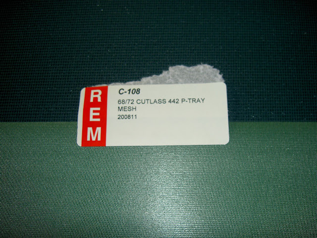

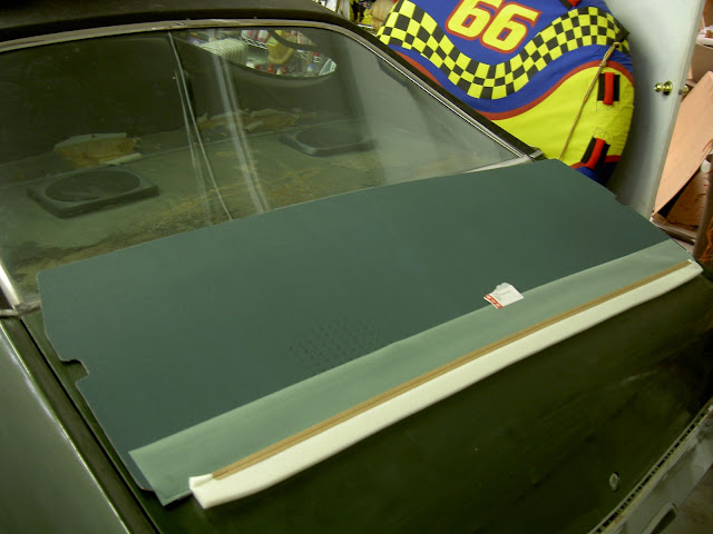

mesh package tray pic

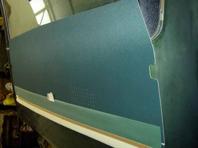

Here is a picture of the package tray I ordered.. I pulled it out of the plastic wrapper and it look pretty good.. the white strip on one side is actually a thin piece of foam, with the back side being vinyl to match my seat covers (dark green). I do have concern of the mesh while looking good may be a real dust trap..????? You can see in the picture that the tray has pre cut speaker holes that are covered with the mesh...
looking again at the picture you can't see the speaker holes, just trust me...
speaker holes show better here

From what I have seen, the mesh ones have the speaker holes punched in them and the mesh conceals those holes. The solid ones do not have the speaker holes in them and if you want rear deck speakers you need to make you own holes. I put the mesh in mine because I wanted the clean look with the speaker allowance. I not a big fan of the speaker grills you typically see covering the speakers. Mine doesn't seem to collect a lot of dust and cleans pretty easy with a brush attachment on the vacuum. Mine was the same brand you have there.

They are wider that the tray itself. The sides bend up on the sides and tuck up behind the sail panel.

The sail panel is held in place by the interior side trim. You need to take that off the window handle & undo the 3 screws that hold the side panel in place on each side, plus you're going to have to take the rear seat out to install this anyway. This should be a total of 3 screws per side. Take a look at how the old parcel shelf is secured before you bust it out. Take a picture if possible. Try to save as much of the old parcel shelf as possible for use as a template.
With the sail panel off, also remove the interior window trim pieces (closest to the trunk). Measure your parcel shelf side to side and compare this with the suggested scoring pattern. If you're happy with it, lightly score the bottom side areas of the new parcel shelf with an olfa knife (use a straight edge) just enough to make the bending a little easier. Do NOT cut it all the way through. Use a steel straight edge to make the 90 degree bend you need. When you reinstall the side trim, all the folded area will be hidden.
