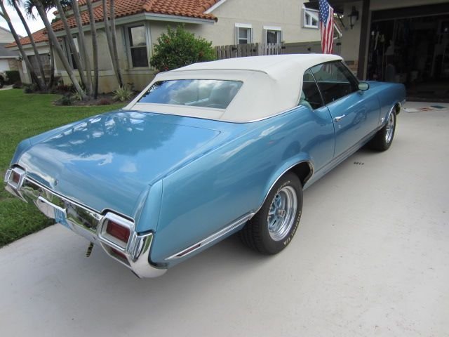

I have replaced the weather stripping in the trunk and my trunk gets crazy amount of water leaks when I wash the car. Are there any tricks or am missing weather stripping somewere? It looks installed correct from all the images I have seen..Thank you all for the help!

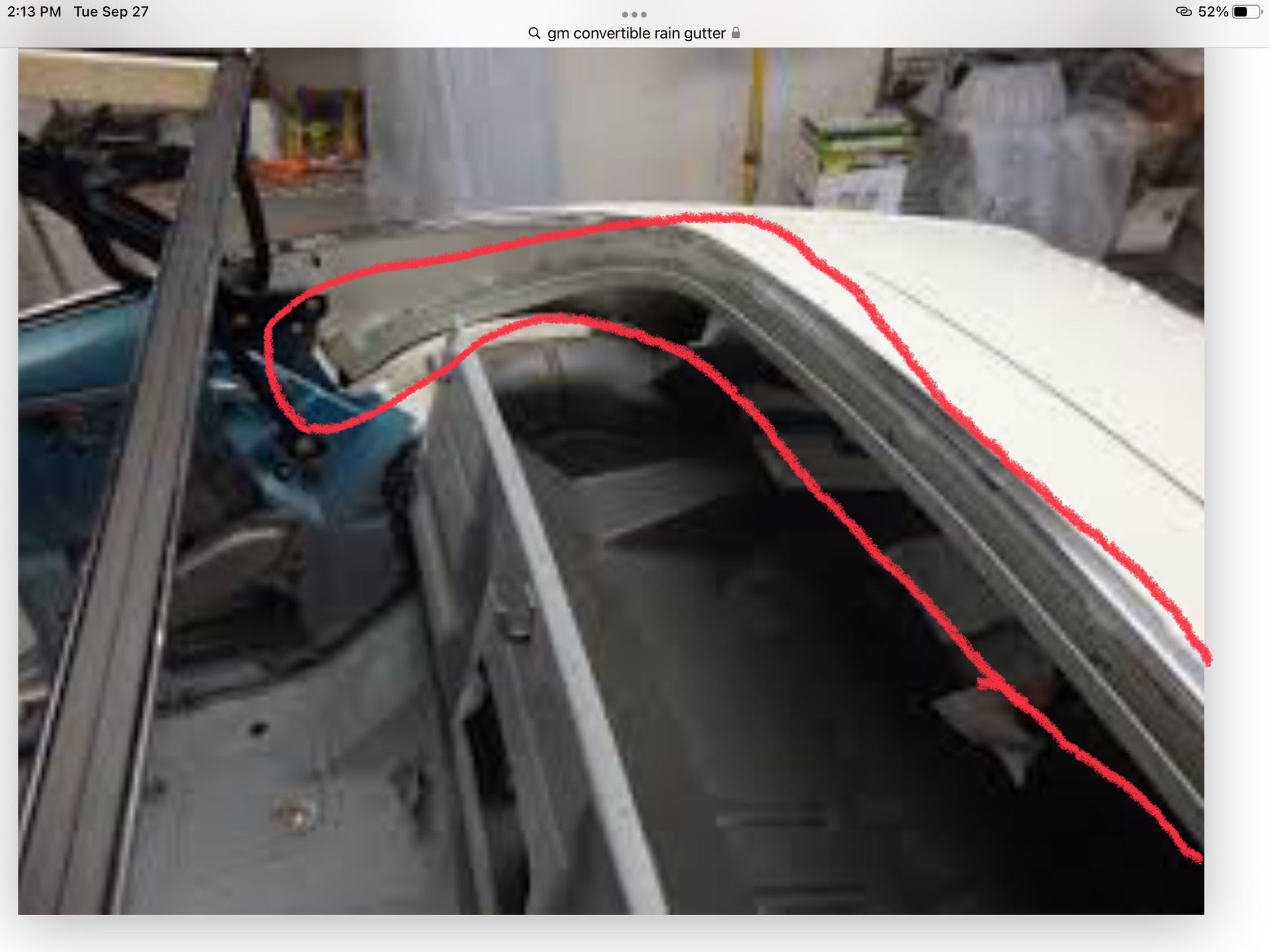

Can you tell where the water is coming into the trunk? There is a rain gutter (a plastic U shaped channel) that runs around the perimeter of the top opening, and the water is then drained to the front of the rear wheel well area. If the edges of the top material aren't hanging down properly, they can allow the water to drip outside the rain gutter. And if your rain gutter is cracked or missing, that would be a big water leak as well.

The gutter is roughly the shape of the convertible opening, catches water that runs down the roof and dumps it into the front quarter panel cavity. From there, the water drains through holes in the bottom and exits the quarter/rocker onto the ground. They can be broken around the mounting holes, otherwise dislodged, or just plain missing.

Does any one have any pics of what the top material should look like underneath above the rain gutter? Looks like the water leaks onto the top material over the gutter and does not make into the gutter, I dont want to just wack the material off. So if anyone has some pics of the underside of the gutter and were the top materials ends would be great...thanks
