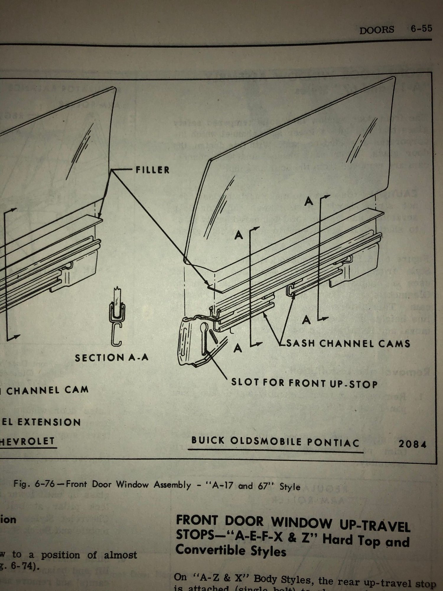

The door window is loose/not in the channel. The channel rubber is shot. In this pick from the body manual says its a “Filler”, Has anyone replaced this piece . If so what did you use?

The stuff you want is called "glass setting tape". It comes in different thicknesses. I believe 1/16" is most common.

Thanks Joe I’ll give it a try
