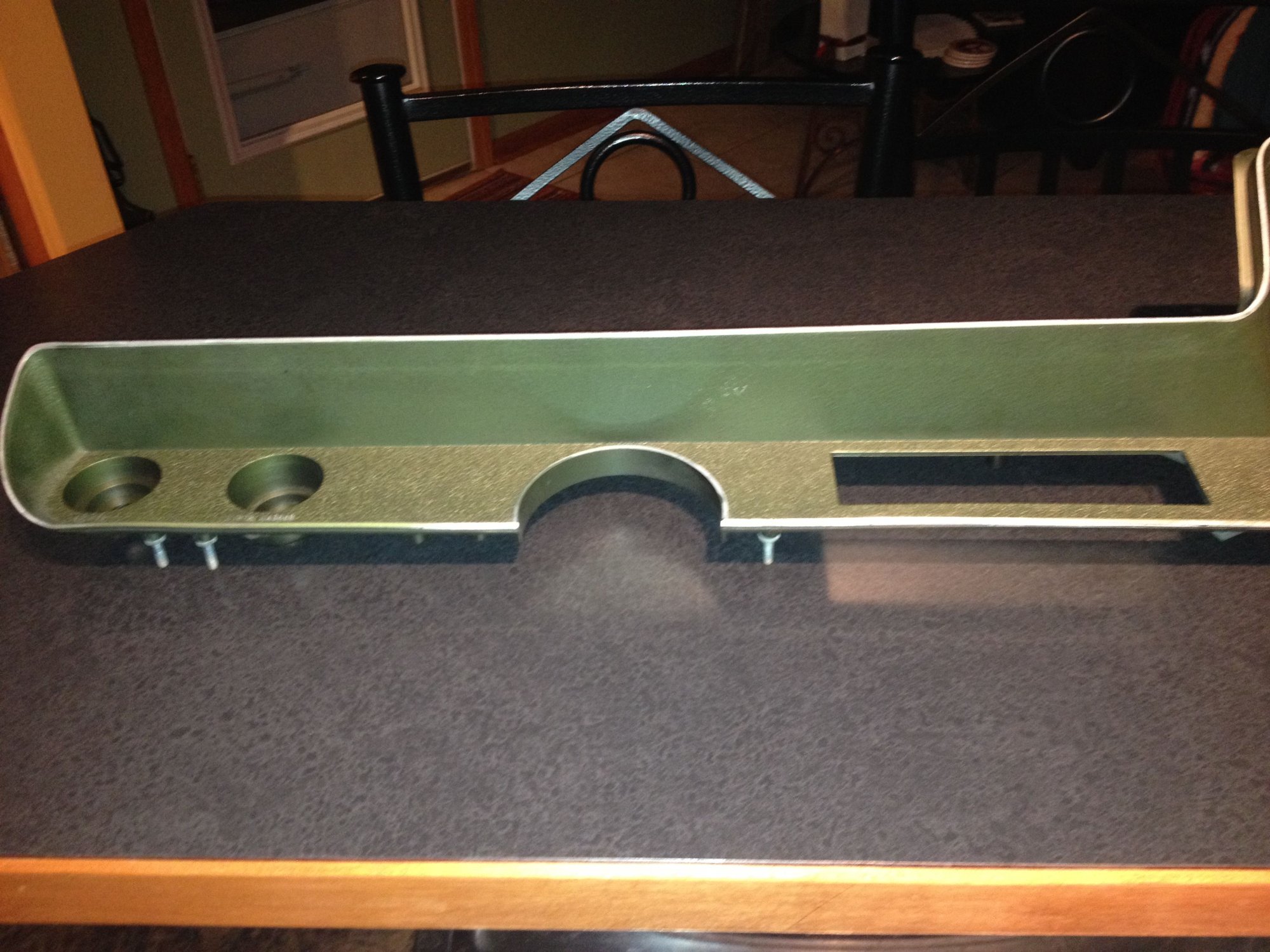

Mike and Joe here is what I am trying to match. Mike you are correct we did speak yesterday.
Thanks Joe for the info. The pic shows what I am trying to match. Not sure how to use the document you posted. I at one point thought it was M22 or M23 based on the codes I got from BAP on my door panels that are this light green. I have also tried TPP greens and they are not a match for the dash but still need better match for vinyl that I need for other vinyl parts that cant be bought in green.

Anything out of a can other than black will not work for you. You have a variety of green colors in your interior and all these different greens can be made by your local jobber. Now having said this , it requires your paint supply outfit to have a guy who can actually make colors from scratch "WITHOUT A FORMULA"
The paint i use is R-M and Glasurit and i'm fortunate not only to have direct factory access but most importantly a guy at the paint supply that can make anything from scratch. This includes those tough 70 Met. blue and Met. green and those white pearls.
Obviously you need a sample to mix from , in your example the dash piece.
The process is to mix it in a base coat and add basecoat hardener to it(Hardener made specifically for basecoat). This not only gives it durability it gives it uv protection. This can go on metal, plastic, vinyl . I hesitate on actual seat upholstery though.
You should also use an adhesion promoter on these parts.
If you have the right guy mixing your paint you can match/achieve exact results.
Disclaimer: this pertaines to the R-M Glasurit paint manufacture. Otheres may vary
