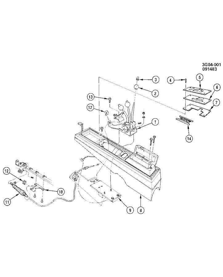

I am restoring a 1984 442 Hurst. I ordered the linkage cable and parts but cannot figure out how it all connects to the transmission. Anyone have a picture or diagram of how it connects?

This might help you.
Backdrive linkage (#6 is your shift link that bolts to the selector shaft. Here it doesn't show the tab for bolting on the link pin for the shifter cable, but the rest is the same):
