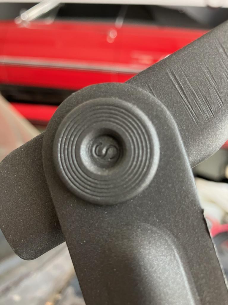

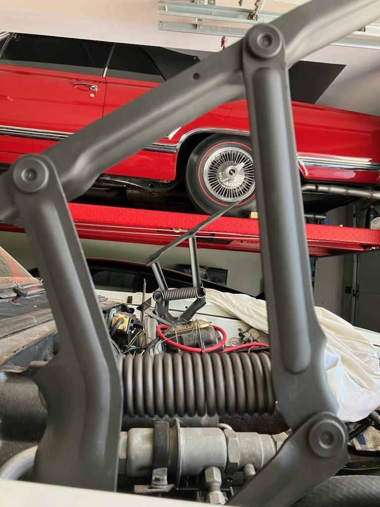

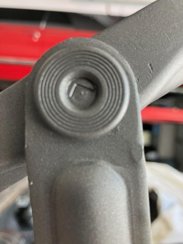

Hinge repair
Update on vendors who rebuild Hood Hinges!!! I sent a pair of hinges to a Gentleman named RowLand Hall out of Burbank CA. I just got them back and they look outstanding!!!!! He even Makes his own rivets and marks them as if they were the originals ( rings and letters) His web page is Concours quality Hood Hinge Restoration. He bead blasts the hinges after he disassembles being careful enough as to leave any stampings in the parts.When done he paints them with a phosphate paint. I took them to a restoration shop to show them and they agreed with me on the quality of the work. I would recommend him to every one!!!
Interesting, thanks for the update Guy... got any pics you can share?, thanks!
Old Aug 13, 2024 | 09:25 AM
Guy Fillinger's Avatar
Joined: May 2012
Posts: 287
You do realize I'm not real bright! The last time I tried to post pictures I had to go to someone else to do it for me. I will see what I can do

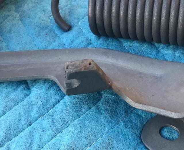

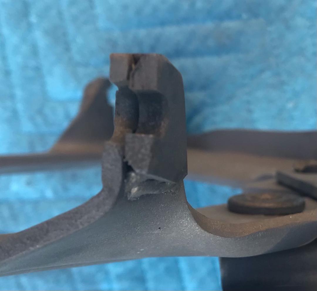

70Post's Avatar
Joined: May 2008
Posts: 3,626
From: Austin, Texas
Rowland is the guy I mentioned above that welded on the non-stock unsightly metal pieces on a pair of Buick Skylark/GS hinges. Yours look nice and no added-on metal. Below are a couple of pics of the Buick hinges he did.....
Old Aug 14, 2024 | 07:28 AM
Joined: May 2012
Posts: 287
Ouch!!! I can see what he was trying to do but that is not right! The Bracket slot looks washed out, what would have been a better way with an emphasis on keeping everything as close to original as possible. I would Tig weld the washed out areas of the slots to build back the metal and with some time, a grinder and a file, bring it back to as new. I hope that is what the owner of those Hinges has done.
