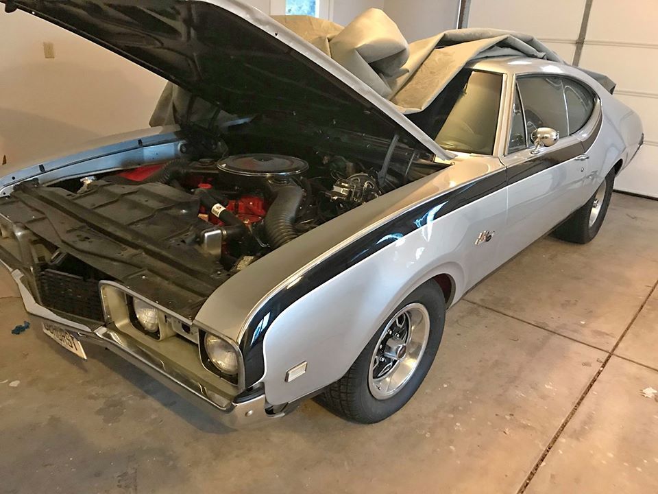

I came across this 68 Hurst for sale. I'm interested but I don't know enough to know whether it's a good deal or not, or what to look for to tell if it's authentic. I've not seen a 68 Hurst Olds up close before so was looking for some insight. The seller is asking $42K. Says its an almost complete rebuild. Motor was rebuilt before he got the car and so far I haven't gotten any information on what was done to the motor or by who. Below are some comments I got from him.
The motor was rebuilt pretty much when I bought it. It’s missing one piece of chrome on the hood and 2 turn signals in between the head lights. It still needs to be dyno tuned and the transmission needs to line up better with the Hurst shifter. I have extra parts that will make it faster but then you wouldn’t be able to close the hood. I also have new speakers that I haven’t installed yet. The radio is new and I added electronic instrument panel. Also missing 1 piece of chrome on 1 rim.

to pick it apart a little based on one picture....
it looks a little unfinished. The side stripe looks too wide, wheels are done incorrectly. Wheel well moldings are missing. I’m almost positive all the 68 H/O got heavy duty cooling and that one has a non heavy duty cooling radiator top plate. Obviously the radiator isn’t original.

The main thing on a '68 H/O is the H/O only "Z-Z" paint code on the cowl tag & of course it has to be a Lansing built car, (M in the vin, LAN on the cowl tag) But it looks like there's lots of "incorrect" things about the car. The black stripes are too wide, the H/O badges are too high, no wheel opening trim, Wrong wheels ( later ones with snap on center caps) It looks like the rad top plate is wrong also. I'd definitely look for the partial vin on the left front pad on the block & on the trans. Does it have the "D" heads??.

As others have noted, lots and lots of questions raised by one small photo. I see incorrect wheels (the originals were 14x6), aluminum radiator, aftermarket master cylinder, incorrect stripe, panel alignment issues, etc, etc. It may be a nice car, but be sure it's real and that the quality of build matches the price you pay.

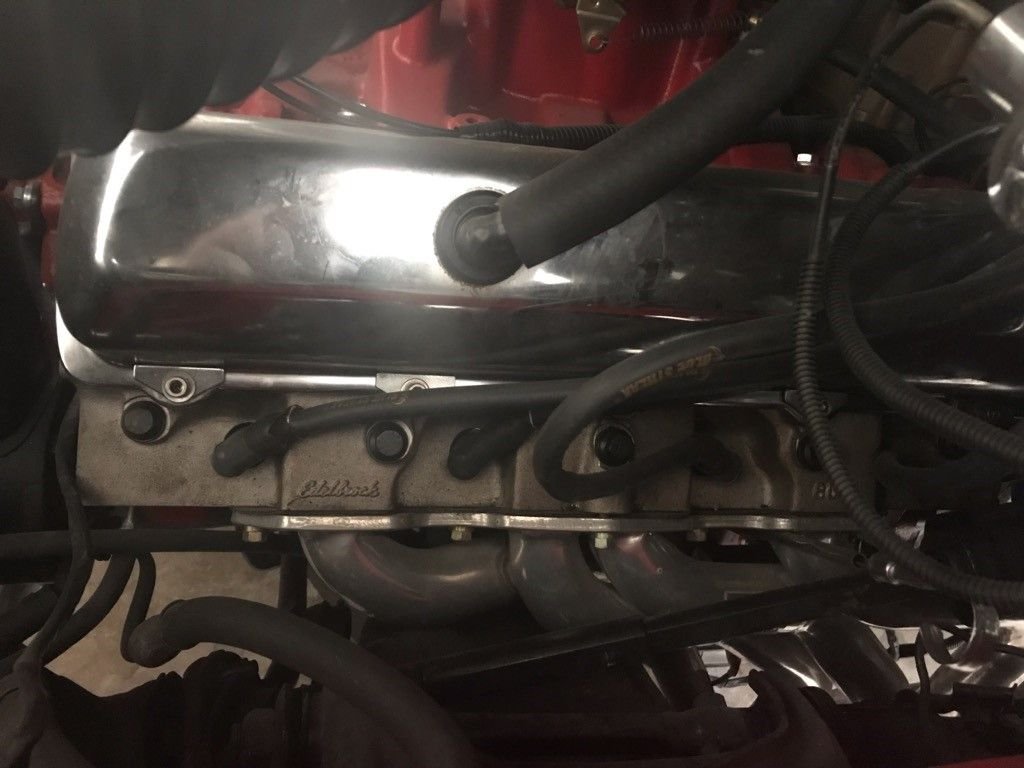

So it does seem to match up with that (conversion from 442) and is a Lansing car with a 344xxx vin. Its a G2 paint code which is presumably consistent with what he told me original paint was gold. Trim code 944. I'll try to upload the cowl tag and some of the other pictures, I asked him to get a pic of the numbers stamped on the block and he sent a pic of some numbers cast into the head right next to the headers. So even if the block is originally something desirable another pic shows that the heads are Edelbrock which he confirmed on the phone tonight, he already told me that the intake manifold is Edelbrock and it has had a couple of different carbs on it during his tenure, so I'm quickly losing interest. The dash has aftermarket gauges in the original gauge spots for oil pressure, battery, tach, etc. The dash pad was cracked up he said and he wrapped it with sometype of cover designed to cover that, but it wasn't truly restored. There is a few pics of the aluminum radiator and such and it has an electric fan mounted on the radiator. I mentioned that the stripes were too wide and he said he literally had a matchbox or hot wheels car of a Hurst Olds and took it to the paint shop and they were able to look up the paint code for the Peruvian silver and that's how it was painted to look like the toy. Scaling up from that I'm surprised they got even close as they did. Lots of issues. He said it does have the dual gate shifter but it apparently isn't hooked up right because it shifts the same in either side and he said it originally was a 4 speed car, he believes. So really more of a resto-mod than even an attempt at a H/O clone.

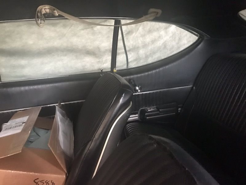

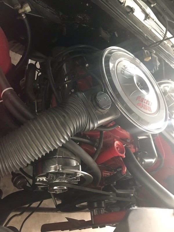

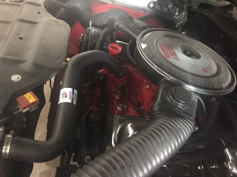

So these are the pics the seller sent me this evening on my phone. If I get a chance to see the car I'll try to get the vin numbers off the block to at least know what year motor it has for the block.
