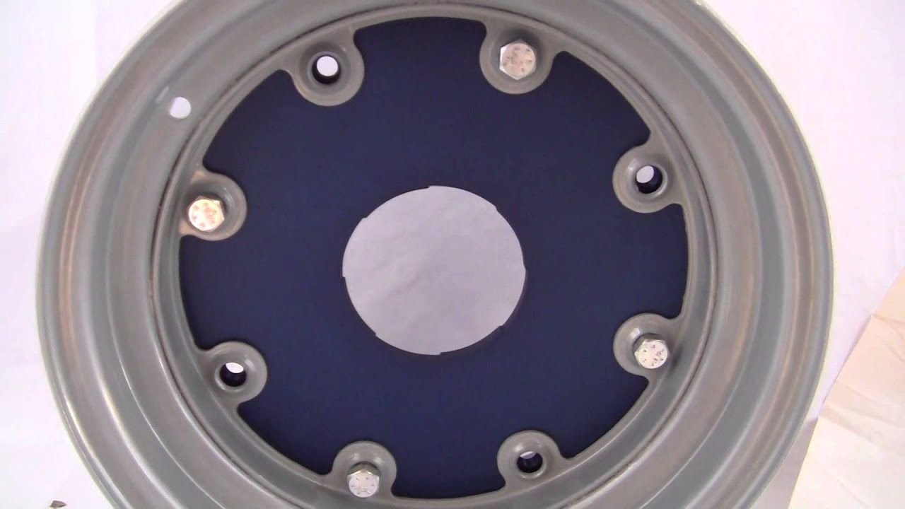

Available for all 1960-68 full-size Pontiacs and Pontiac sold plenty of them.
The 8-lug wasn't just an ornamental styled wheel. The center hub was the car's brake drum. It was cast aluminum with a steel liner in the brake shoe contact area and was probably the best drum brake available at the time. The aluminum fins dissipated brake heat better than even the Buick 45-fin aluminum drums, and those were considered state of the art when introduced in 1957. But Buick HAD to something about their brakes- big heavy cars with marginal brakes weren't going over well even in the 1950s...
Advent of disc brakes obsoleted the 8-lugs quick, but to this day they are still the most beautiful wheel ever to grace a big Pontiac.
You need this and a tire shop willing to do it to balance 8-lugs. Ames Performance, Todd Zimmerman and others in Pontiac community are making the 8-lug balancing adapter plates.
The plate was one of Pontiac's "dealer essential tools" for off-car tire service, but consider that on-car speed balancing was still common in the 60s. A Hunter "Tune-In" or strobe balancer combined with someone who knows how to use it is still the best balancing there is, because it accounts for wheel, tire and suspension.
