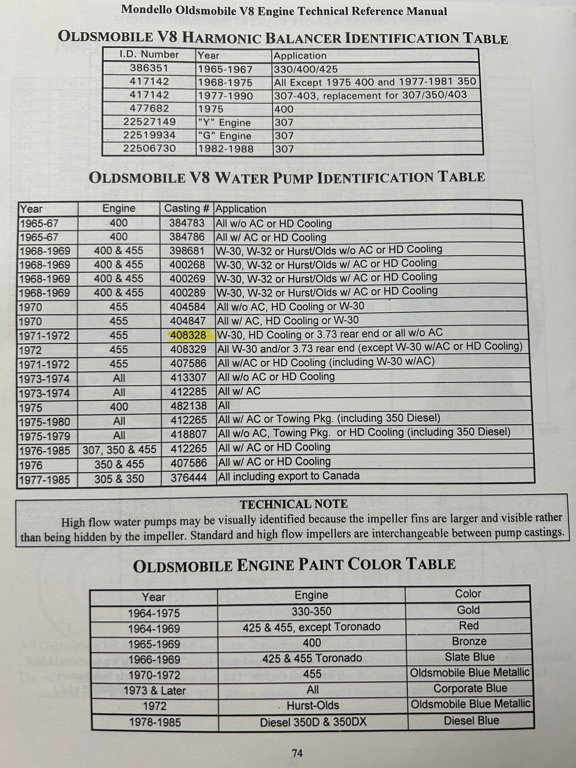

Old May 27, 2024 | 05:58 AM
Shredder's Avatar
Joined: Jun 2021
Posts: 17
Old May 27, 2024 | 10:13 AM
Posts: 50,770
Originally Posted by Shredder
Fifteen years late and the info in this chart is still incorrect.
texasred
26
