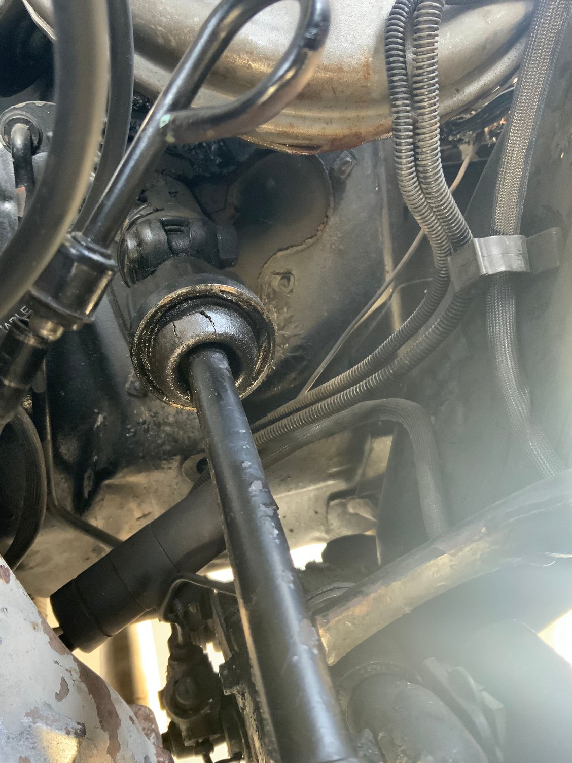

Does anybody sell the grease boot for steering shaft where it connects to steering box in the engine compartment on 70 cutlass/442?

If it is the intermediate steering shaft boot you ask about I located it at OPGI.

Inline Tube also have them.

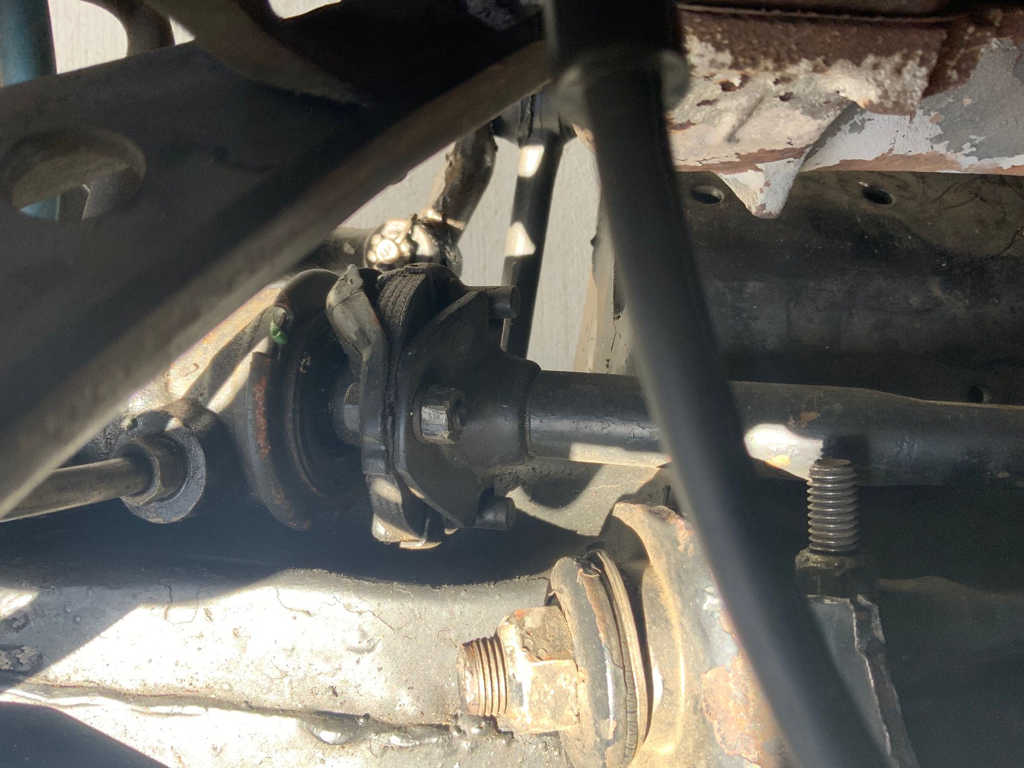

I am looking at doing this repair. Have the part on order. Any tips or tricks to pulling the column and removing the seal for replacement. ? Intermediate Mechanic skills.

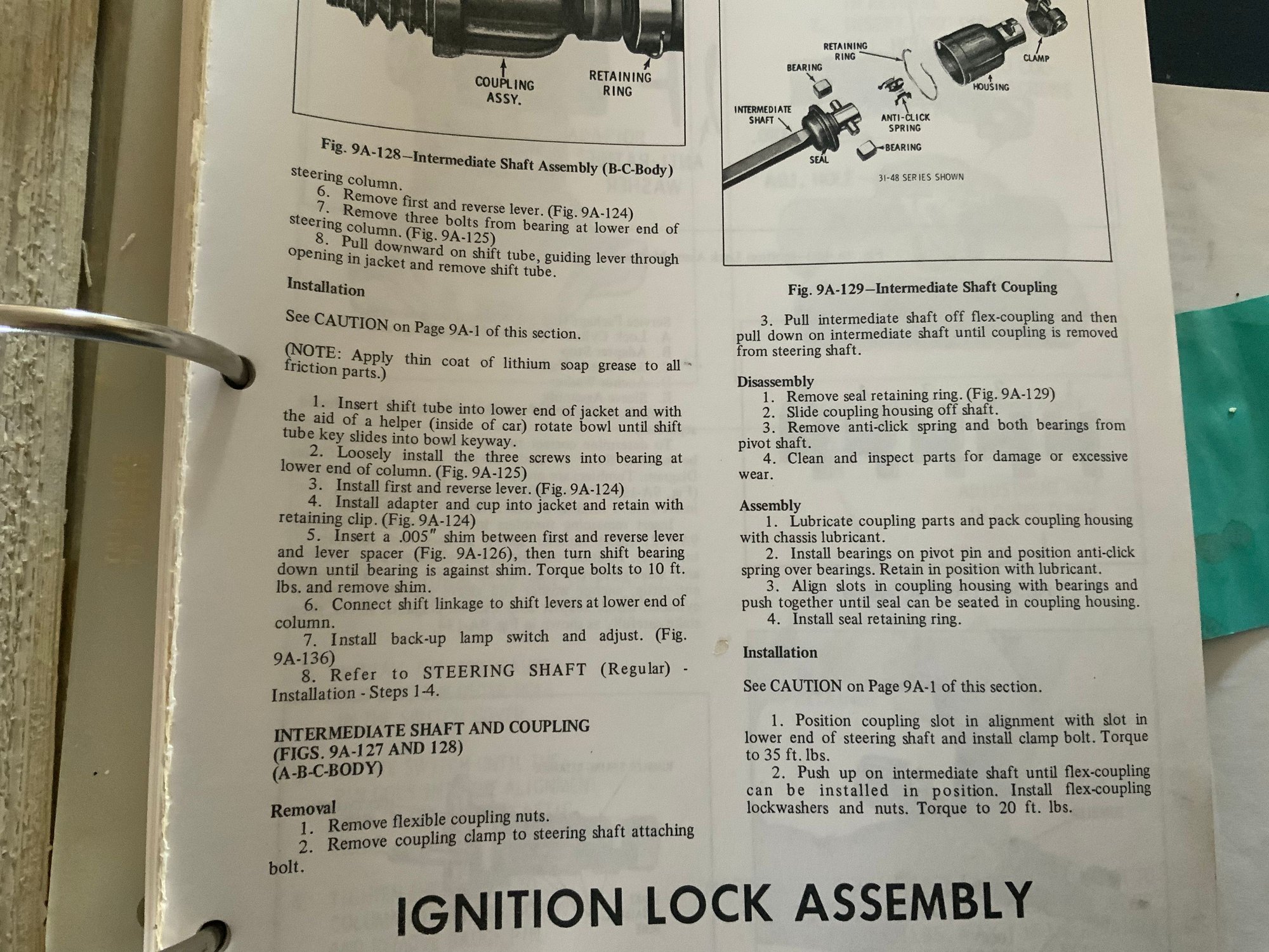

Pretty straight forward especially if you have CSM. Gotta pound or press that pin out then back in.

I do. I found the section on the shaft once it’s out of the car. Never having taken one out is there a section on how to remove from ( I guess the rag joint and where it attaches up by top) the car ? . Looks like it might just unbolt. Did you remove MC and brake booster for access? Thanks.
