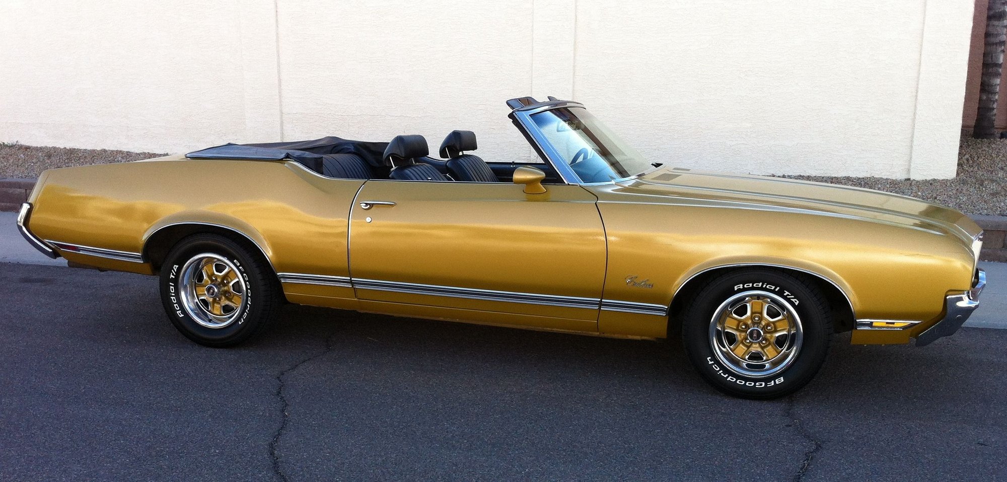

Posts: 26,056
Measurements of my '71 CS.
Tires: BFG P245/60R15 100S M+S
