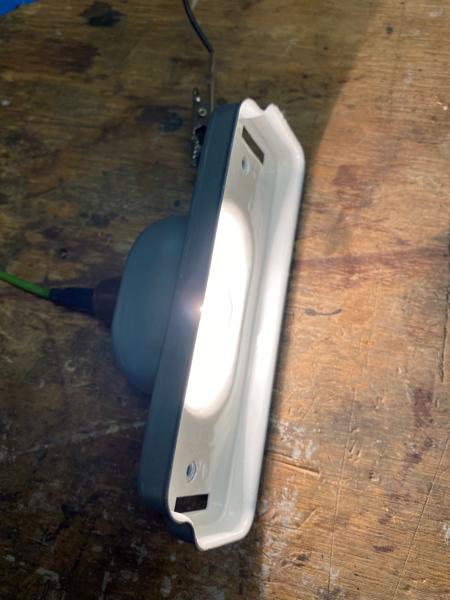

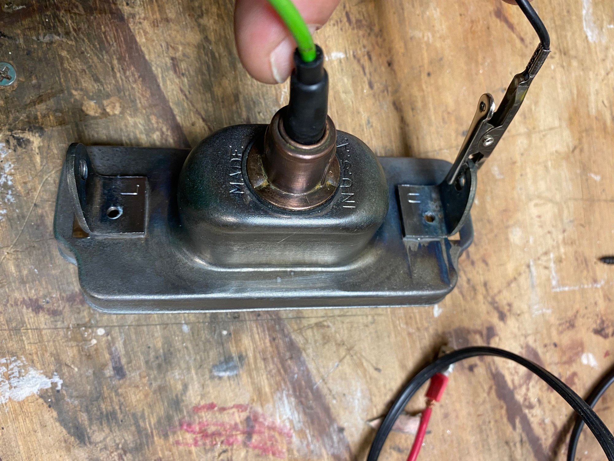

Took out the ugly piece and dropped it in Evaporust overnight. Rinsed it off this morning and got this:
Powered it up on the bench and it worked. So I scrubbed it everywhere with a brass brush, cleaned every connection point, shot it with some clear zinc and some clear acrylic, painted the inside white, and it works great. Now to install it on the car…

And they both work now
