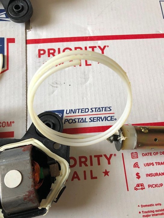

I noticed there was an old post that recommended me to repair power antenna........ that is still true but it had an old phone number.
A good number is 512-635--5132 I can also be reached at barneyeaton@gmail.com
Since that old post lots of things have changed, parts are getting harder to find and there are parts coming from China that resemble the original Delco parts but as you would expect the quality is poor.
I can repair most GM power antenna from around 1961 until around 2005 when they were last offered.
The power antenna of the '60's and '70's were made by Tenna for GM .... I can repair them if the chrome mast is in good condition... replacement mast are hard to find and expensive.
Delco started making power antenna around 1977 with their first design then around 1980 they did the Slimline and that was the final design. Slimline Delcos were used on all GM products,
The only difference was usually the way they mounted at the fender line.
I have noticed that some of the repair kits being sold on line are parts that I made for one source and they apparently went to several vendors.... I use a plastic coated steel cable to replace
the original plastic cord that breaks. One vendor sends me Chinese kits and I replace the plastic cord with steel, but the rest of the parts are still poor quality.
The attached photos show some of the things to look for on the Chinese kits..... the red background picture are all Slimline Delcos.... the grey background is a varity of the early Tenna units.
I will gladly answer questions even if you are doing the repair yourself.

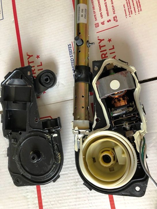

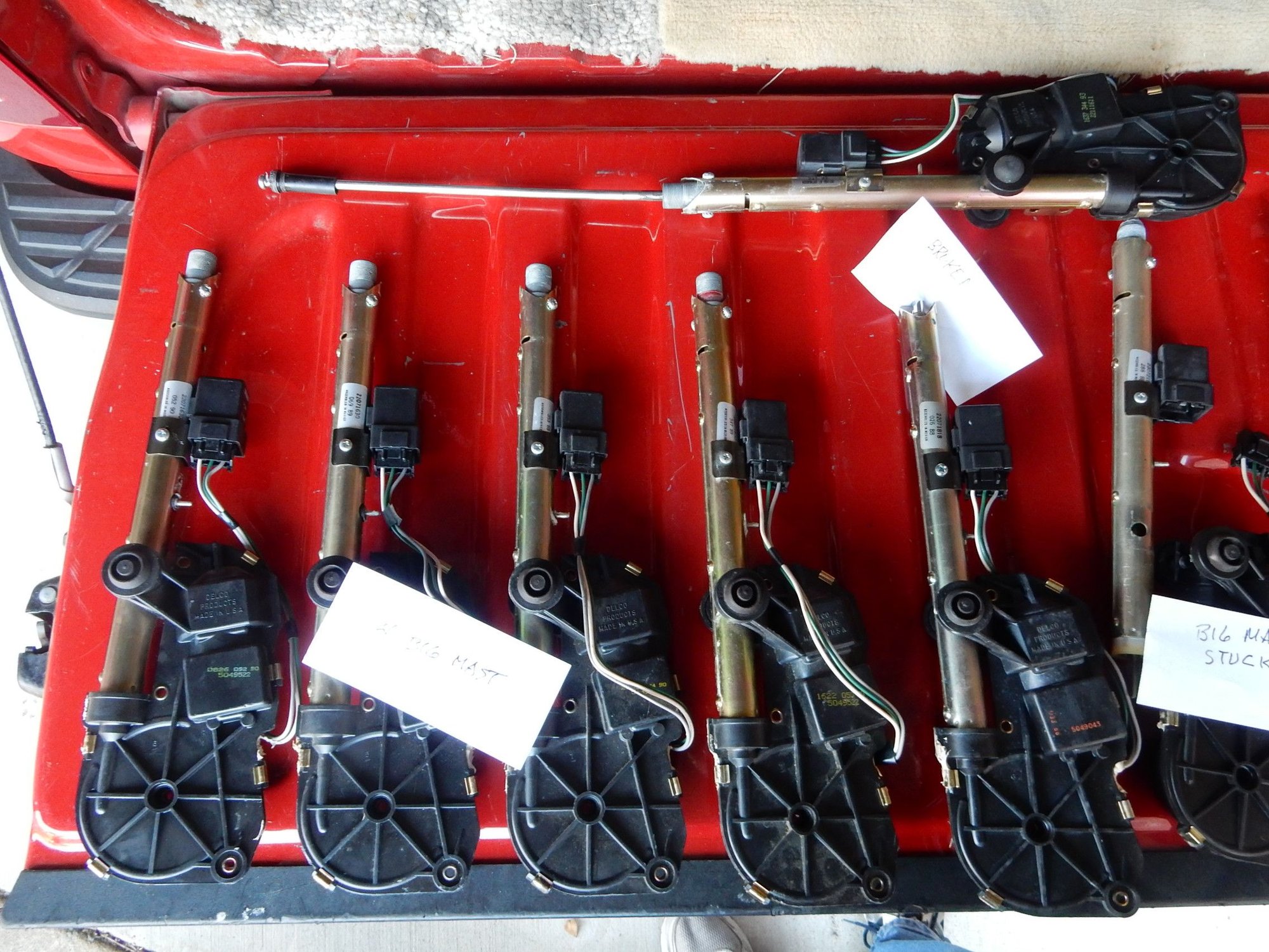

Here are some photos of the modern units coming from China. Even GM is using them, I have seen them in Delco boxes the main advantage to using a GM/Chinese replacement is they are plug n play, GM has purchased units that have the correct
connectors and fender mounting. Some of the clues to know what you have, The outer mast (under the fender) is much smaller and appears to be aluminum. The motor is exposed, sitting on top of the bottom housing.
If you take it apart, the plastic cord has "teeth"

As you can see by comparing your Town Car antenna with the Chinese example, Ford is also buying the Chinese antenna.
Let me backtrack.... they first came from Japan but I suspect China just copied the design and started making them cheaper than Japan.
Your Town Car does say made in Japan..... by looking on the internet, you will see the design has changed very little.
Look on Ebay under power antenna repair kits and you will find the parts you need and they are cheap. You can replace the cord and
mast without taking the unit out of the car.... all done outside

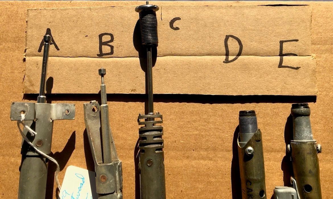

Here is some additional general information......... The photo with the "A" "B" "C" designation for the fender mount....
These are all Delco Slimline made between the late '70's and end of availabity on new cars.
"A" = early '80's Cadillac used this mount
"B" = on '80's small cars
"C" = used on lots of GM cars up to about '87 when GM changed body styles on the intermediates Cutlass, Grand National, GP etc
"D" = common mount during the late '80's & '90's
"E" = this snaps into a black plastic trim piece on the fender very common on late Cadillac design started around '95
The motor assembly was the same with only minor cost reduction changes.
Here are some examples of the cord I have purchased and tried ............I use the plastic coated steel cable on 100% of the Slimline units
I repair.

Firm believer here of NO NYLON CABLE. Depending on when it was made, when it was installed, ancient parts still laying on the shelf...you're rolling the dice using the "NOS" nylon cords. Regardless, at some point someone (maybe not you) will be dealing with a constant running power antenna when it does give out. And it will. Sooner or later.
I had some custom antenna/cables built with 2mm push/pull inner cables by 88hurstolds here. I won't ever have to worry about the plastic-covered stranded wire coming apart, which is one step up from nylon, or the nylon cable breaking ever again. If your antenna is easy to get to for a rebuild, that's one thing, but in a G-body Cutlass, you're in for a spectacular project just to get the antenna in and out.
And for those that say nylon is good enough? I had a brand new G-body complete antenna I was going to replace the nylon cable in regardless of shape as an insurance policy. Glad I did. When I opened it up, the OEM cable was already broken, and it was never used! The bare metal flexible cable works perfectly well without any extra power consumption that I can tell. Goes up and down pretty darn smooth. Take your chances if you like, you'll never convince me to go back to nylon cables again.
Factory rivets and clips removed, and at first glance it looks pretty good.
Oh, wait. Carefully lifting out the mast assembly, only some of the cable came with it.
Hmm. Broken off down in there. A bit of a PITA to get that out.
Nylon broke into 3 pieces without even moving or being touched. These antennae are pretty durable, except for the nylon cord- the weak point. Non-believers will tell you nylon's fine. It's your gamble.
