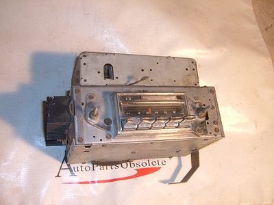

hi every1 ive been cleaning out my garage and i just found this radio im not sure what its 2 it looks like a cutlass radio but im not a 100% i have the 80's after market tape player that fits in the dash without cutting, it flips over from am 2 fm its pretty cool!! the numbers on it are service model 03bfm1 and it has 2 product number 1 on top of the other 7312393 and 7313193

That looks to be a 70 am/fm stereo. The 1970 models had another piece which was an amp I believe located near it under the dash. The 71-72 models were one piece. It seems from your pictures you have a 1970. I believe the black plug end goes to the amp. If you still have the car, the amp is probably still in it. The 70-72 look identical once installed.

03BFM1 is a '70 Olds full size radio, AM/FM stereo....

An AM/FM stereo for a Cutlass is 03AFM1 or 03AFM2; the BFM is for a full sized Olds.

Except... the face shown in the photos in the first post is for a cutlass not a full size. Here is what a full size face looks like. Notice the squared corners on the bezel, different slider, and completely different tuner face. If you look carefully at the lable in the photos, it looks like there may have been multiple lables put together and glued on so this could explain the model number.
Here is another view of what the cutlass face looks like. This is my 71-72 one piece stereo unit.
Also, here is a photo of a 70 two piece unit. This shows a good size comparison between the amp and radio.

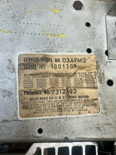

My 68 Toronado has a 2 piece stereo unit. When I had it out I remember seeing labels on the amp and stereo that said they were a matched pair and should only be used with eachother. Not sure what will happen if you add a different amp to your radio without having it gone through by a radio repair shop. Here is a link to a 70 stereo unit on ebay. it has no bids at $299 and ends tomorrow so it may be worth a gamble.
https://www.ebay.com/itm/27518541118...cAAOSwBUViGreC
You can see the same message on the lables on those units as well "THIS IS PART OF A MATCHED UNIT. KEEP TOGETHER."

The radio you have is a '70 A body radio, the heat sink is on the left side (as you're looking at it from the front of the radio). B body radios in '70 had the heat sink on the other side and the fins were longer. And as mentioned above, you're missing the multiplex /amp box. Yes they should be kept together but others will generally work fine, as long its from a same style radio. What I mean is that Delco made these boxes for all the divisions, but some had different pinouts on the connector.
