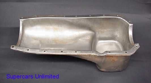

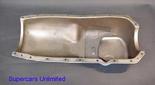

Yes, but...
The BBO pans have two bulges just in front of the sump. The SBO pans do not. The bulges are there to accommodate an internal baffle that is not used on the SBO pans. Top photo is an SBO, bottom is a BBO.
