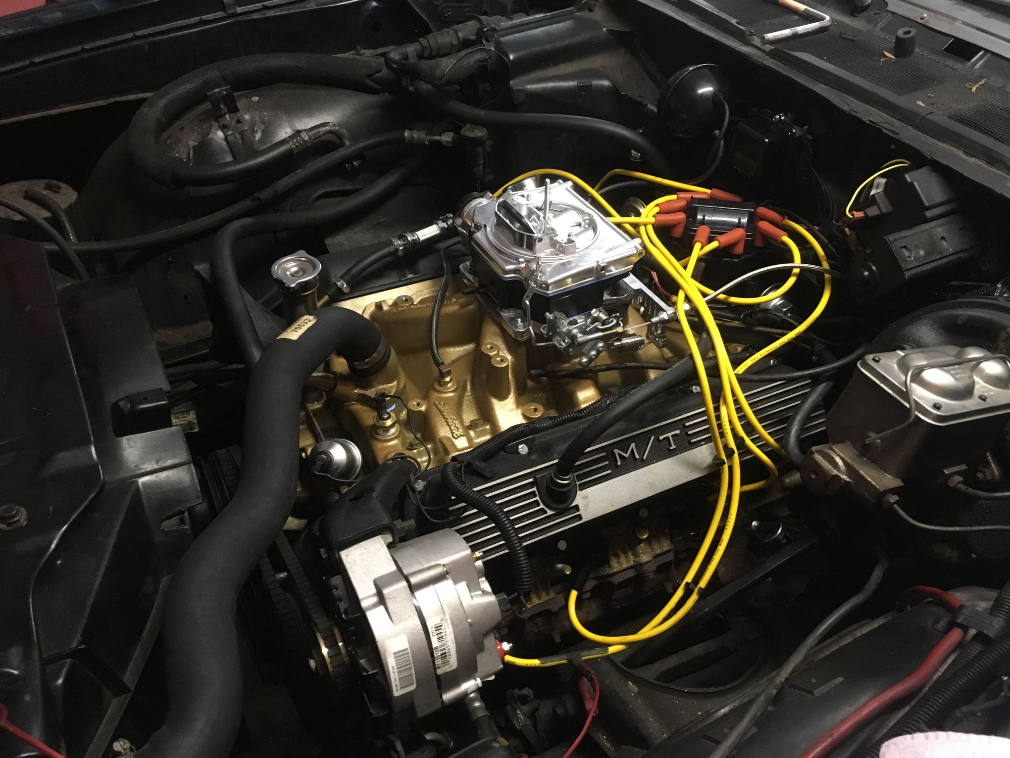

Just about wrapped up with a huge project on my 71 olds cutlass. Had it’s numbers matching 350 rocket rebuilt, bored .030 over, 30 degree backcut valves, mondello flat top pistons, custom cam with lots of duration but not much lift, Holley street demon carb on Edelbrock 7111 intake, plus some more. Had TH350 rebuilt and 2300 stall torque converter installed. New motor mounts, new driveshaft and u joints made by a local power train shop. Replaced rear control arms with tubular arms and polyurethane bushings (libricated well, torque applied with axle weighted to ensure control arms are seated well).
First time I went to drive it, had a crazy knocking sound from the trans tunnel area and could feel the floor shaking under braking and acceleration. Also, the fan hits the bottom of the shroud which it did not do before the rebuild. I’m wondering if I need a trans mount or if I’m looking in the wrong place? I bought an 18” flex fan temporarily to clear the fan shroud as the five blade 19” fan would not rotate in the shroud without dragging on the bottom of it.
I’m sure this has been asked and answered but I would appreciate any help you can provide me, I miss driving the cutlass it’s been almost a year since the project started.

Got the car on stands this morning and got underneath it. There is a clear and fresh gouge across the underside of the floor pan about where the front u-joint is located on the driveshaft. All the bolts are in place and torqued that hold the trans to the mount and the mount to the crossmember. The trans mount seems to be sitting higher on the driver’s side and lower on the passenger side. I’m going to order new motor mounts and transmission mount and replace them to see if it helps with my knocking issue. My running theory is that the trans mount is torn somewhere I cannot see and allowing the trans to bounce when loads are applied. Will post back again once some progress is made, most likely next weekend after parts have arrived.
And again, thank you guys so much for the links this forum has been a godsend for me. Between this and the chassis service manual I ordered (at this forums direction I might add) this project might actually complete successfully.

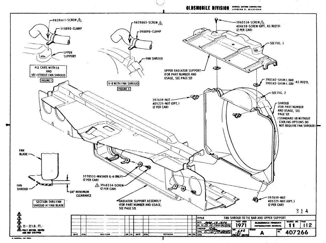

1971 Cutlass/442 Assembly Manual
I do not see any differentiation between a 455 and a 350 stated anywhere; therefore, I assume the diagram is correct for both. If you need diagrams of the radiator supports, etc. I can get those to you if you do not have the Assembly Manual.
Old Jun 8, 2020 | 02:28 PM
  #34
Except for that note "Shroud (for part number and usage see page 52)". Of course, the fan is in exactly the same location relative to the radiator for both BBO and SBO, so there shouldn't be any substantial differences, other than radiator thickness.

Another thing to consider is how much the fan is contacting the shroud. Note in the Assembly Manual diagram there are shims that go between the shroud and the upper radiator support. If those shims are missing, tightening the bolts can draw the shroud up enough so the fan contacts the bottom center of the shroud. I had that happen on my car and the fan would graze the bottom of the shroud and make a lot of noise. I finally realized the shims were missing and adding the shims corrected the issue.
