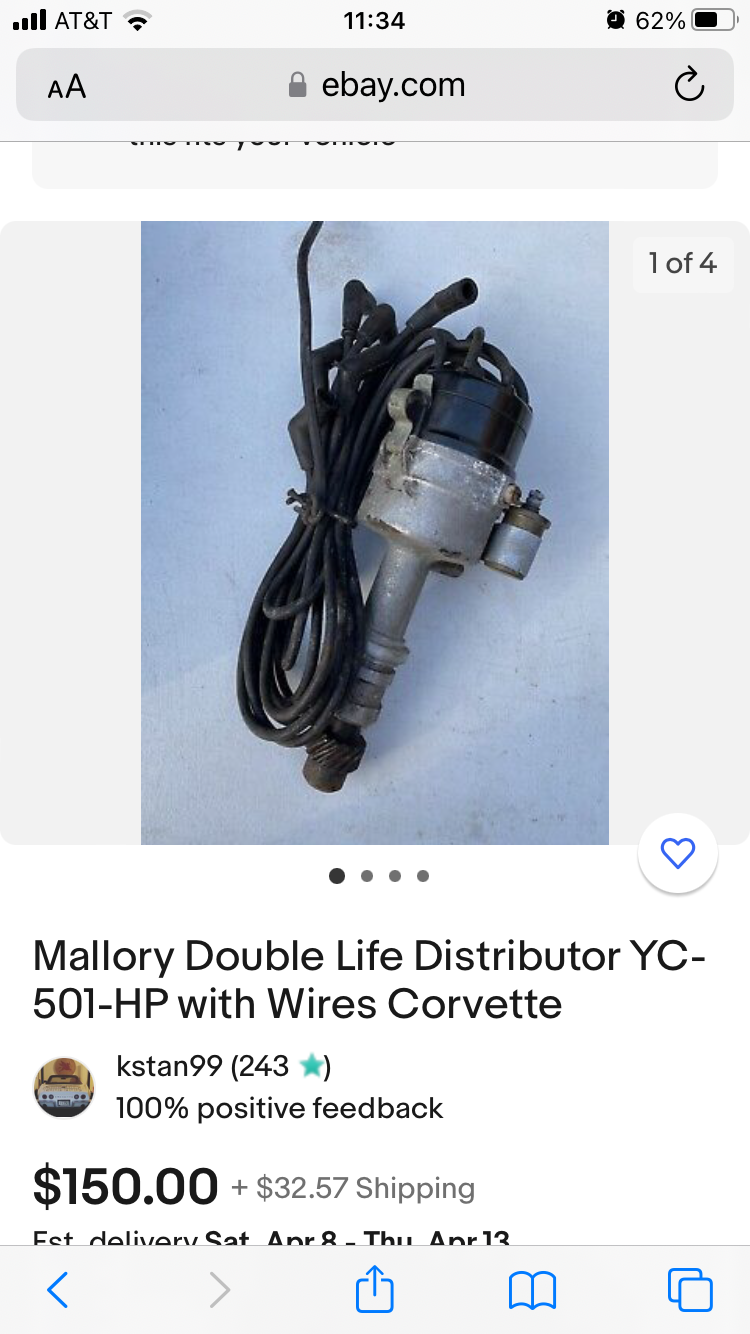

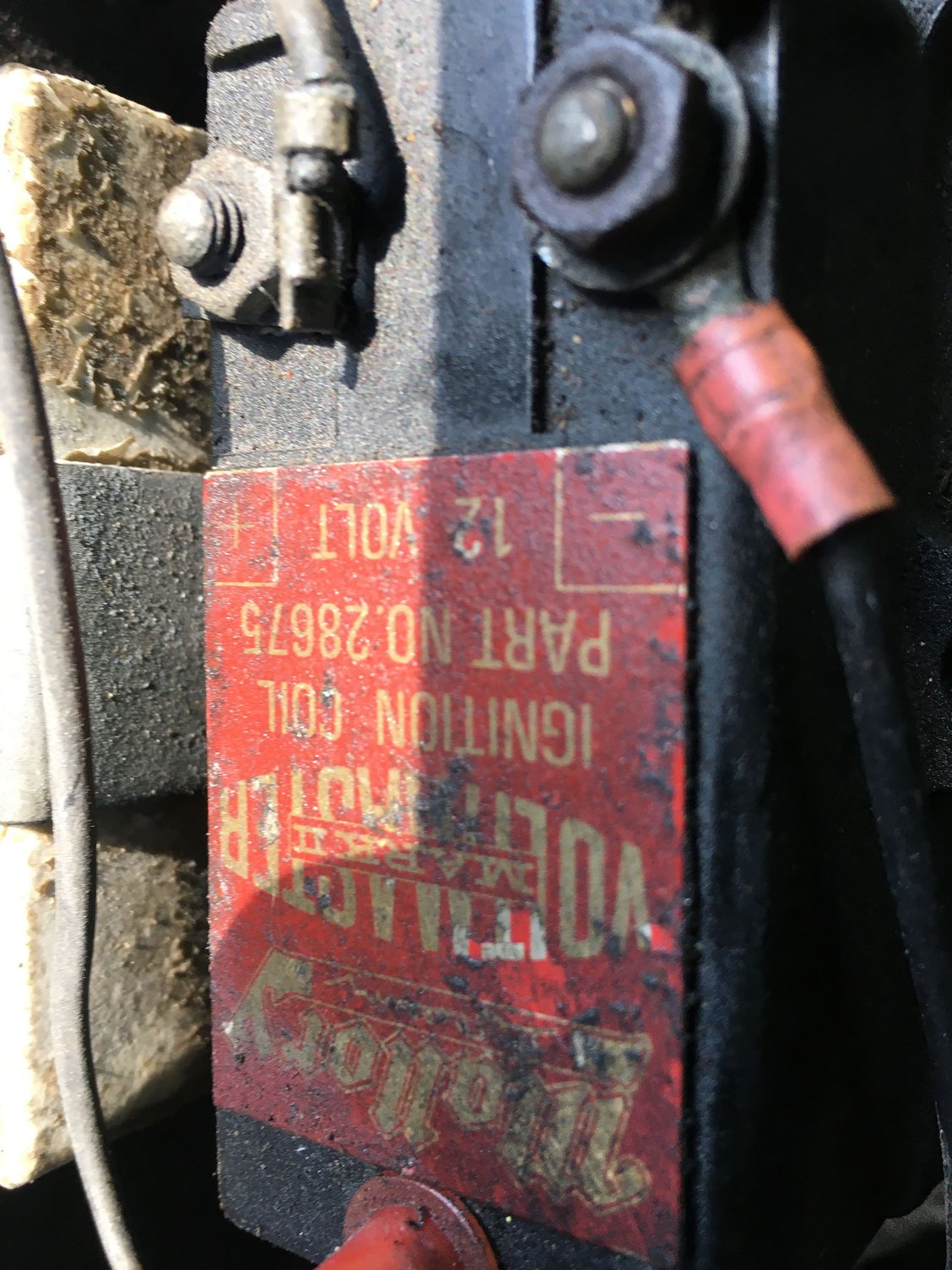

Good day everyone, can someone tell me what coil is compatible with Mallory duel point distributors YC 501-HP?
I I originally had a Mallory coil 28675 I’ll attach pictures Thanks in advance

You can use any stock or hp coil with it, you'll need to use the resistance wire or a ballast resistor.

Thanks to you both for your input, it turns out however that the coil was fine. I wasn’t getting secondary resistance probably due to me pulling the wire. It wasn’t until I bench tested it that I realized it was good.
I’ll leave an update soon, thanks again for the information, it may be helpful whether or not it helps to resolve my current problem.
