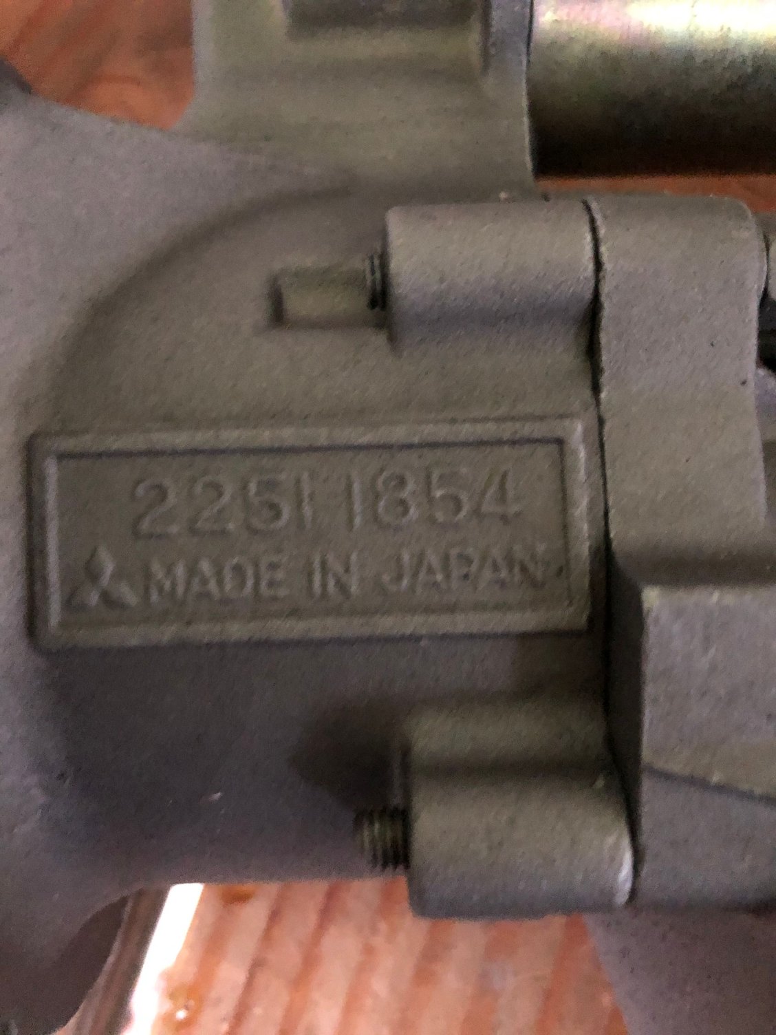

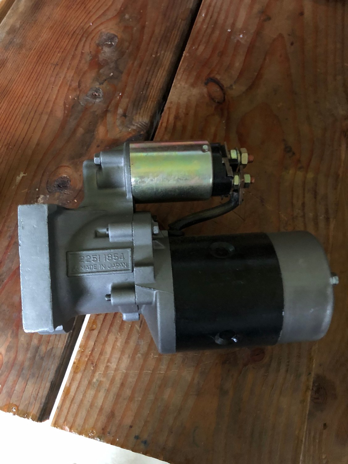

I found a diesel starter in my parts hoard,made in japan 22511854,looks to be pretty heavy duty. question is,can I use it on a gas 455 with a manual transmission?

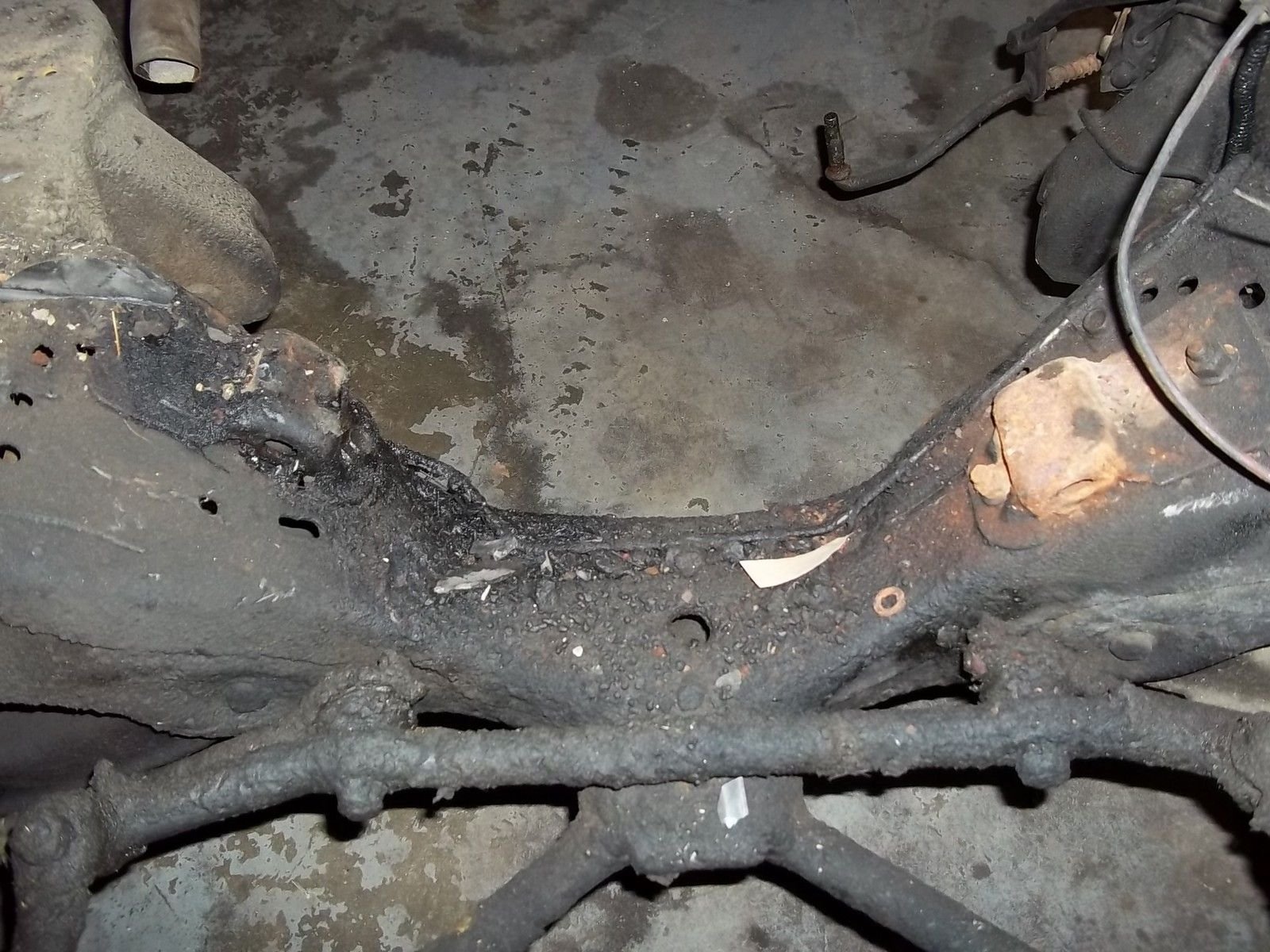

Yes, the diesel starter bolts to any Olds block. The problem is that due to the larger and longer size of that starter, it won't clear stock engine mounts in an A-body. The diesel cars used an offset mount on the driver's side to clear the starter. The frame pad on that side was moved forward from the gas engine location (see photo) and an adapter plate was used on the block to mount the motor mount halfway between the rear and front location. There's no easy way to do this on a pre-1977 car without fabrication work.

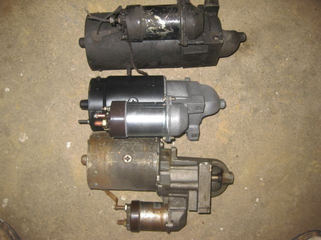

Diesel starters. The off set starter is what he has. would that make a difference?
It would be useful to throw a gas engine starter into that photo.
Old Apr 22, 2020 | 12:22 PM
stellar's Avatar
stellar
Posts: 1,362
From: Pittsburgh Pa.
Hey Joe, you act like I don't have anything better to do. Geez. You act like I'm under stay at home orders. Actually I am. Doing some kitchen remod and the wife won't let me out.This Buick is all I have handy at the moment. The mount holes are the same distance front to back as the Olds. Other starters are in storage about a mile away. Wifey is afraid I may catch the virus because 3 doctors told her if i catch it she better get out the butter because if I catch it I'm toast. Off set starter is about 5/8 inch longer than 10MT. End of offset starter case is the same as the 10MT is including the bushing protrusion. The offset bushing is about 5'8 past the 10MT.
Old Apr 22, 2020 | 12:31 PM
Posts: 50,802
Excellent, thanks. That shows you exactly why the driver side motor mount was offset.

We both did and I led you on a wild goose chase. I reread the 1st post. He has the Japan Mitsubishi starter which was later superseded to the delco 15MT that I showed. They look very similar but they are a horse of a different color. The units are interchangeable but not the parts. His has an open front housing with the pinion fully exposed. The drive pinion is removable from the drive clutch shaft. There may be a pinion that would work but it probably isn't worth the effort to find one. There are too many easier alternatives to use like an OE style starter or an aftermarket. Sorry Joe.
