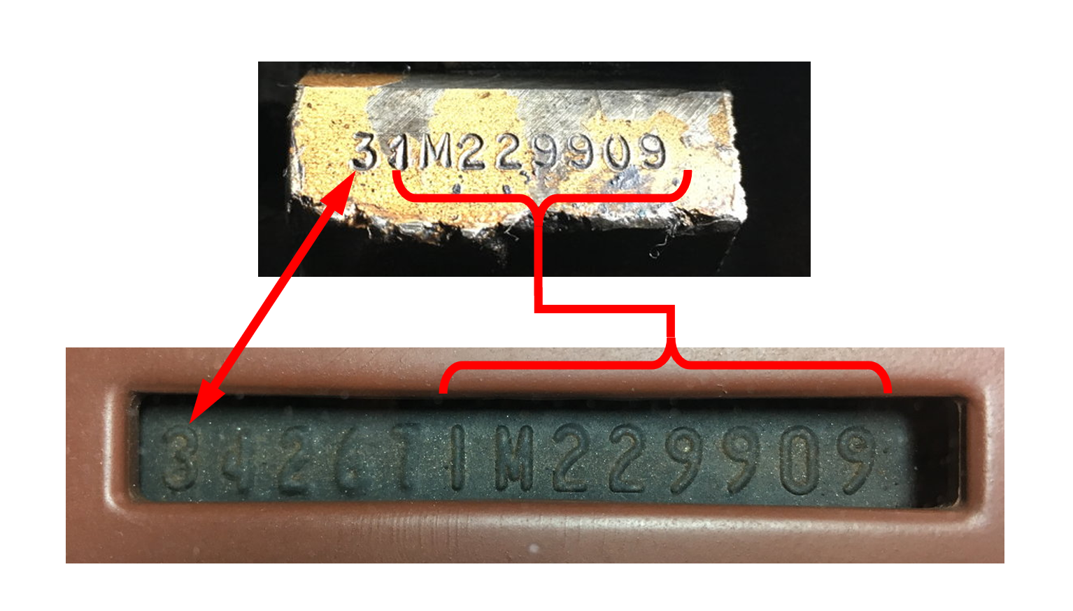

Joe, wasn't there speculation at one point that the first of the last six digits might align with body style, at least loosely? I heard that 7XXXXX were likely Toronados,4,5, and 6 could have been B-Bodies. I have a 455 bought off Craigslist. The seller said it came out of a '68 Toro. It has the low intake manifold, and the VIN derivative begins with 38M7xxxxx. Just curios if there might be a kernel of truth hidden somewhere in the tribal knowledge.
Old Aug 10, 2023 | 08:20 PM
Posts: 50,815
Depending on the model year, Olds set aside blocks of numbers at the Lansing plant for certain model lines. For example, in the 1972 model year, Olds assigned A-body cars the sequence numbers 100001-400000. B/C-body cars got 400001-700000, and E-body cars got 700001-up. These blocks of assigned sequence numbers varied by year. Note the "Starting Serial Number" column on this 1972 VIN chart.
