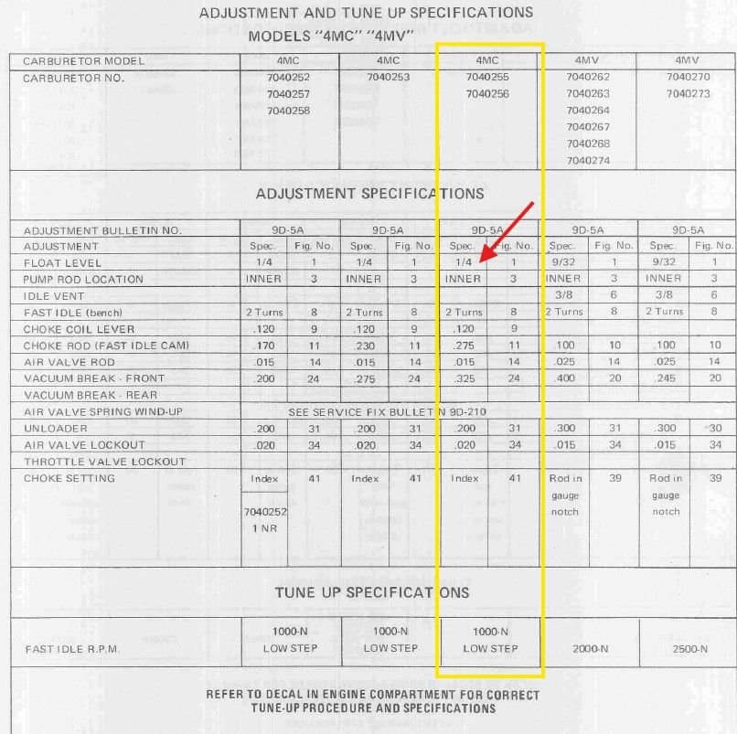

What is the recommended carburetor float adjustment height for a Rochester Quadrajet 7040256 ? I am rebuilding the carb and it will be back on my stock engine ‘70 W30 4 speed.
From bulletin 9D-5S, dated April 1979 page 17
Float level = 1/4"
