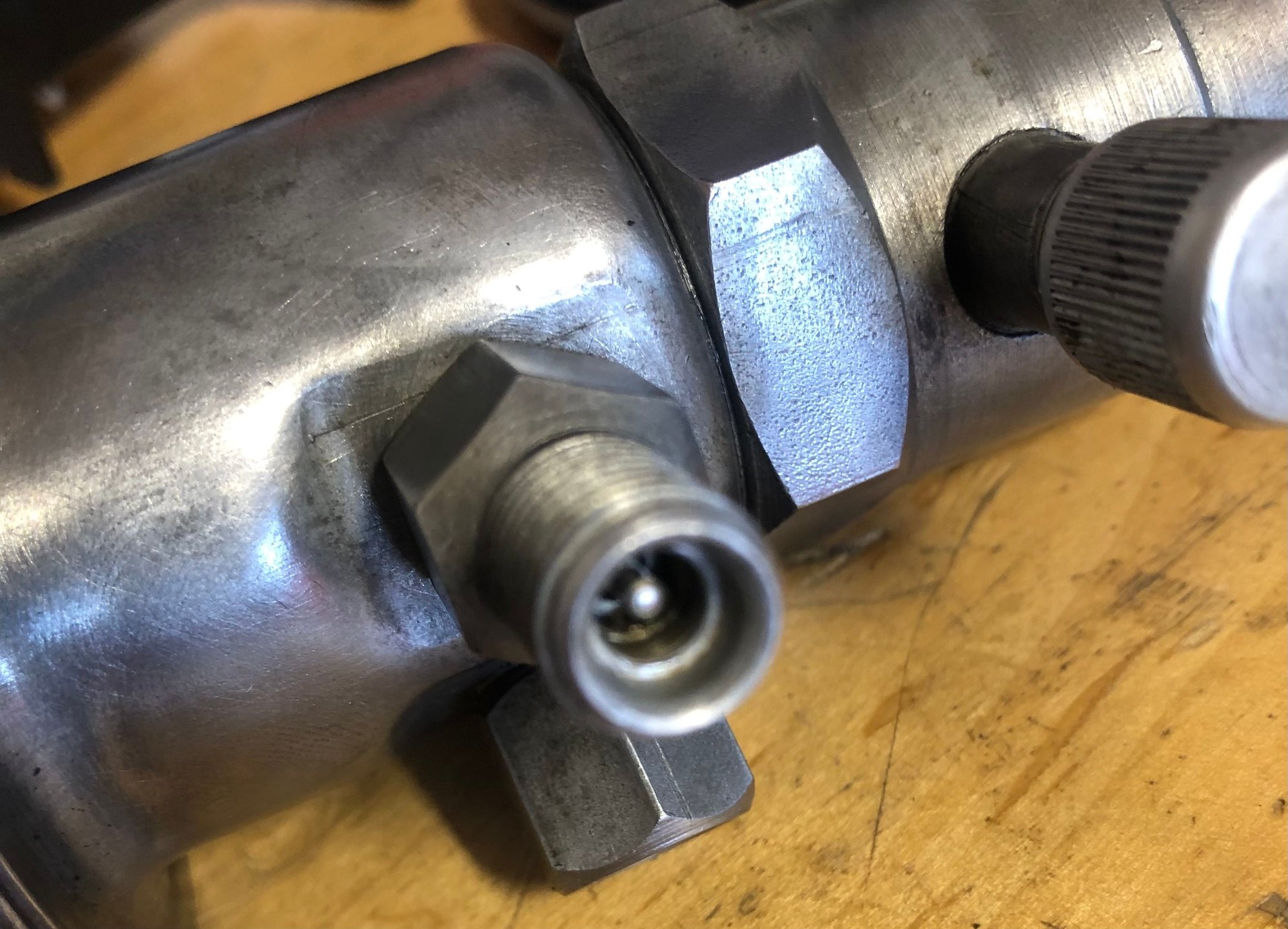

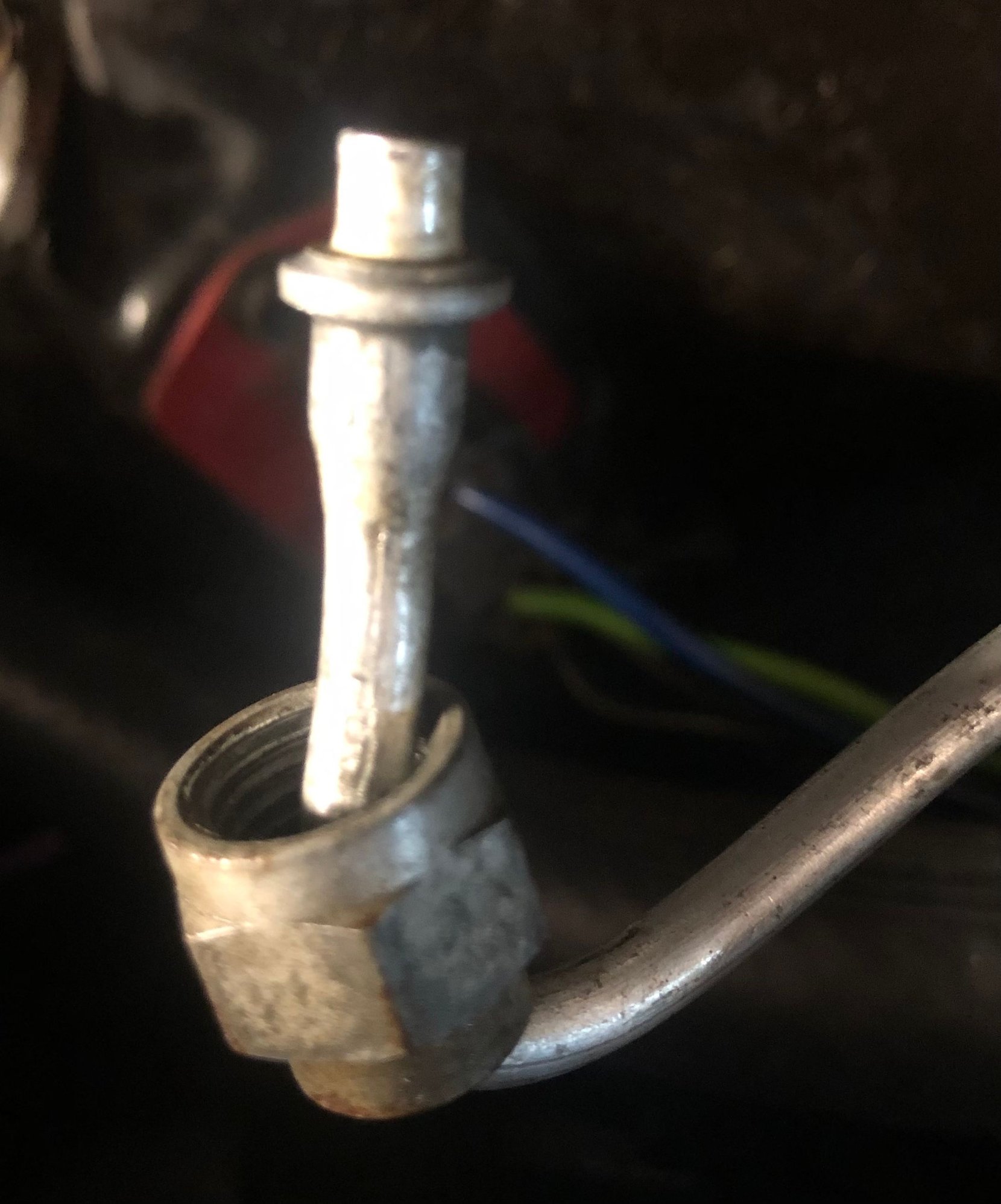

Is an O-ring used at the POA-to-oil return line connection ?
The end of the oil return line appears to have a slight flare or shoulder shape.

Yes, it gets a small o-ring.

And if you are converting from R12 to 134A, use a green O ring.
