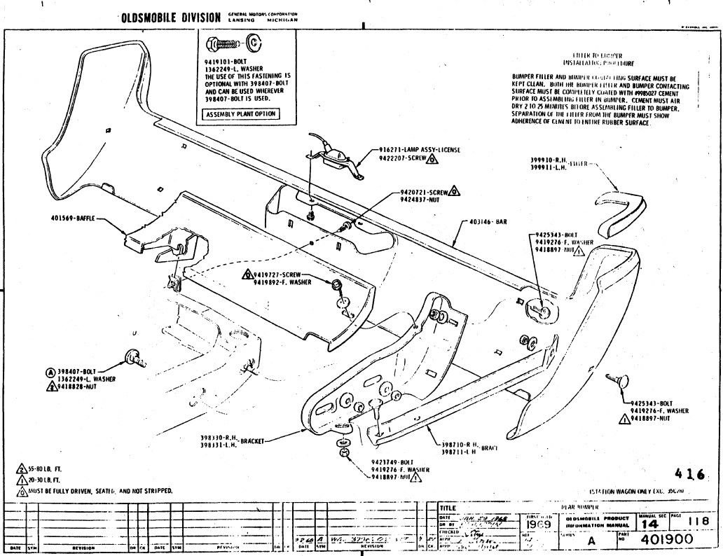

does any one have a 69 cutlass assembly manual or parts diagram ? I am trying to determine if a 69 442 ,rear bumper brackets, have braces or not . Thanks in advance Jim

Thanks Chief!!!
