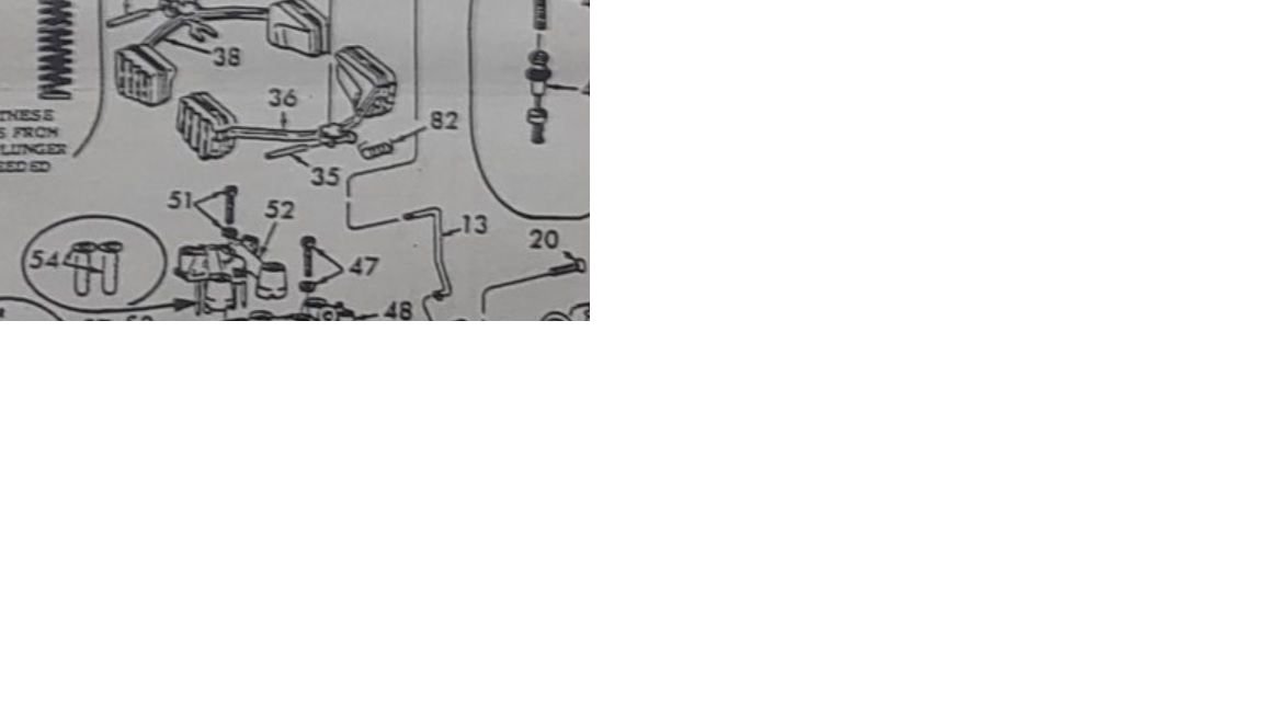

Iīve done the rebuild now for a couple of times. I did a really stupid, amateur mistake.
At some point when taking it apart and putting it back together again, I somehow lost track of the original fuel bowl gasket that sat in there.
As you all know these kits come with a huge variety of those gaskets and Iīve now been experimenting with a few.
Maybe thatīs my problem, does anyone have a picture or something to help me putting the correct one in?
Iīm also missing the small spring on the secondary float "arm". Number 82 on pic I believe.
Nowhere to be found a special spring like that.
Ville
