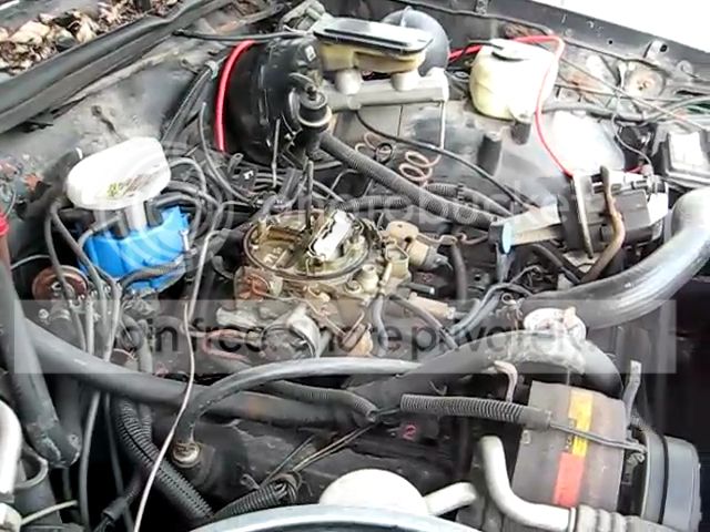

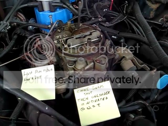

See if this video works
http://vid19.photobucket.com/albums/...ps3gbb7pnn.mp4
yeah, shows coil snapping choke 100% shut
then unloader as WOT is employed.
How about the first start after 5 months' inactivity:
http://vid19.photobucket.com/albums/...psnqnqmat1.mp4
The pulloff at the right front corner of the carb is pointed out.
Note how it pulls off the choke as soon as the engine starts.
