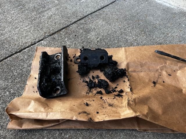

The old trans mount was beyond deteriorated for comparison. Could it be possible that the new trans mount pushed it up too far?
Very good points to check out, Thank you

I checked the specs on the new trans mount; 1.68" high. Don't know what the original was. See picture below
