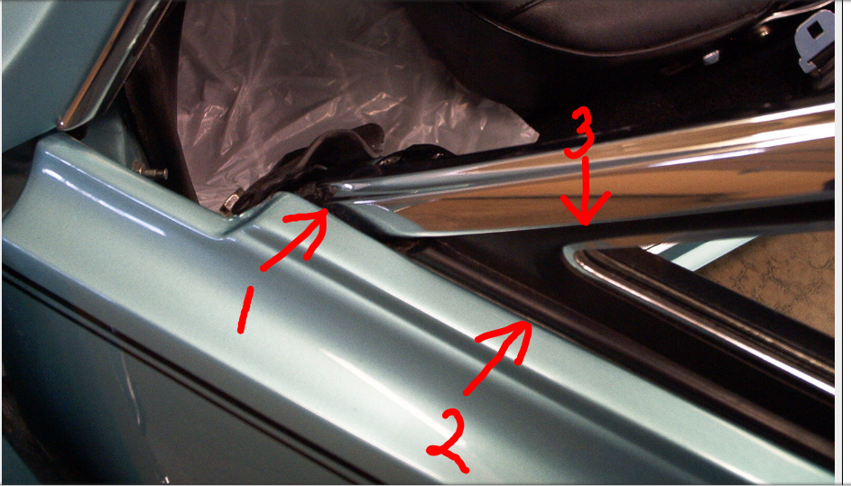

I've reinstalled the wingvent frames into the doors of my '67 after repaint. I don't know what sealer the factory used. It looked like some form of putty. What are you restoration guys using?

Do you have a snip & sketch app uploaded on your computer? If not upload a good one.
Which location would best describe the location you found the old goo?
I know 68-9 didn't use anything between the chrome frame & door frame.

The gap at #1 originally had a filler material that was black and remained soft for 55yrs.
