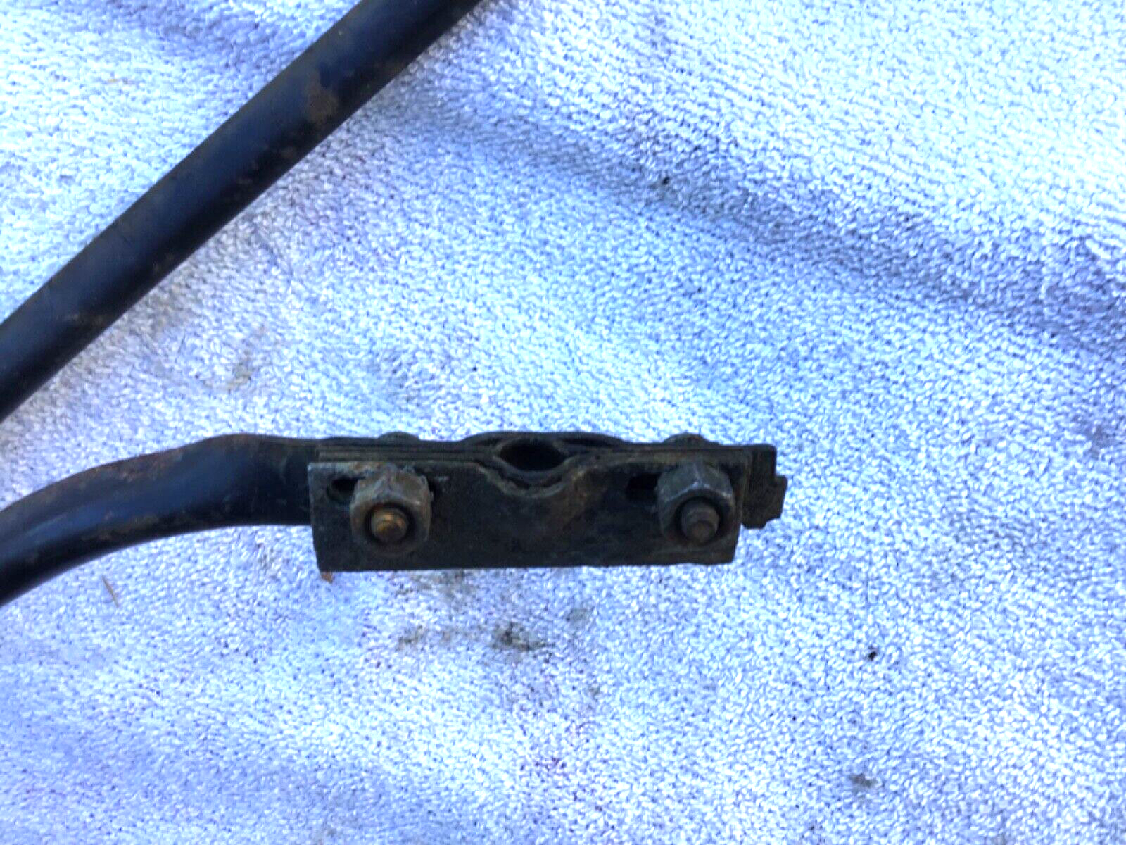

You should not have to re-clock the arms on the spindles if they are installed correctly. The adjustment is at the end of the linkage that attaches to the crank arm on the motor. There are two fasteners with slotted holes. Loosen the nuts and slide the linkage one way or the other relative to the motor crank arm until they are parked correctly.

I’ll stand down. My ‘66’s linkages are not adjustable to the best of my knowledge.
If you get into the linkage, a good cleaning & greasing may help them move more easily after all these years on the car. Consider going over the ball to clean it, then nudge a glob of grease (like greasing wheel bearings) into the spherical void on the arm Joe shows. Consider oiling/greasing other rotational points to keep the job on the electric motor easy.

Actually, they are, Chris, but it isn't easy. On the 65-70 full size cars, the linkage has the same adjustment provision as the one I showed, but to access it, you have to pull the driver side front fender and pop off the plastic access cover on the cowl to reach the adjustment fitting. This is shown in the wiper section of the 1966 CSM.
