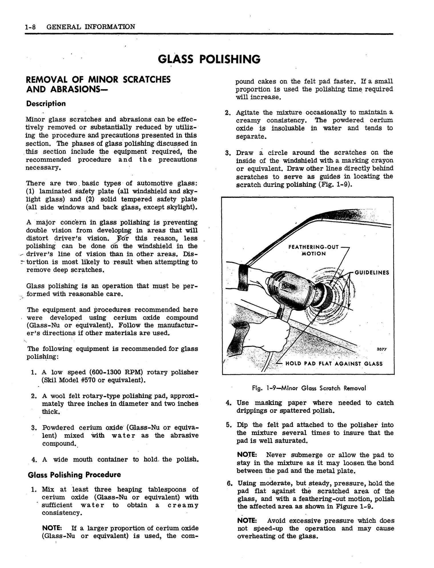

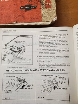

The Fisher Body Manual describes how to polish out minor scratches.
Old Mar 9, 2021 | 12:37 PM
Posts: 50,806

Here I go again. Back when I was installing stereos, another guy mounted a speaker too deep in the door of a newer Volvo and put some major scratches in the window. We had a local glass shop (the boss new the owner) come over and they were able to polish the scratches out. No idea what something like that would cost now days but it certainly couldn't hurt to find out. Look for a local shop that does bathrooms and such. Let them know you can come to them. If you can, that is.

If the scratches are minor, you can polish them out. I would definitely attempt it before spending the money on new glass.
You could probably polish out pretty deep scratches, the problem is the distortion caused by changing the shape of the glass. It’s a question of how deep the scratches are, and where the scratches are in the glass.

Run your fingernail across the scratch. If you can feel it, you're wasting your time trying to polish it out.

This is exactly what I've always heard is the test for being able to polish it out.
