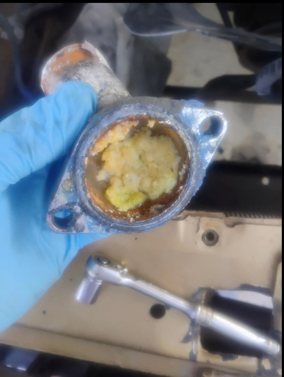

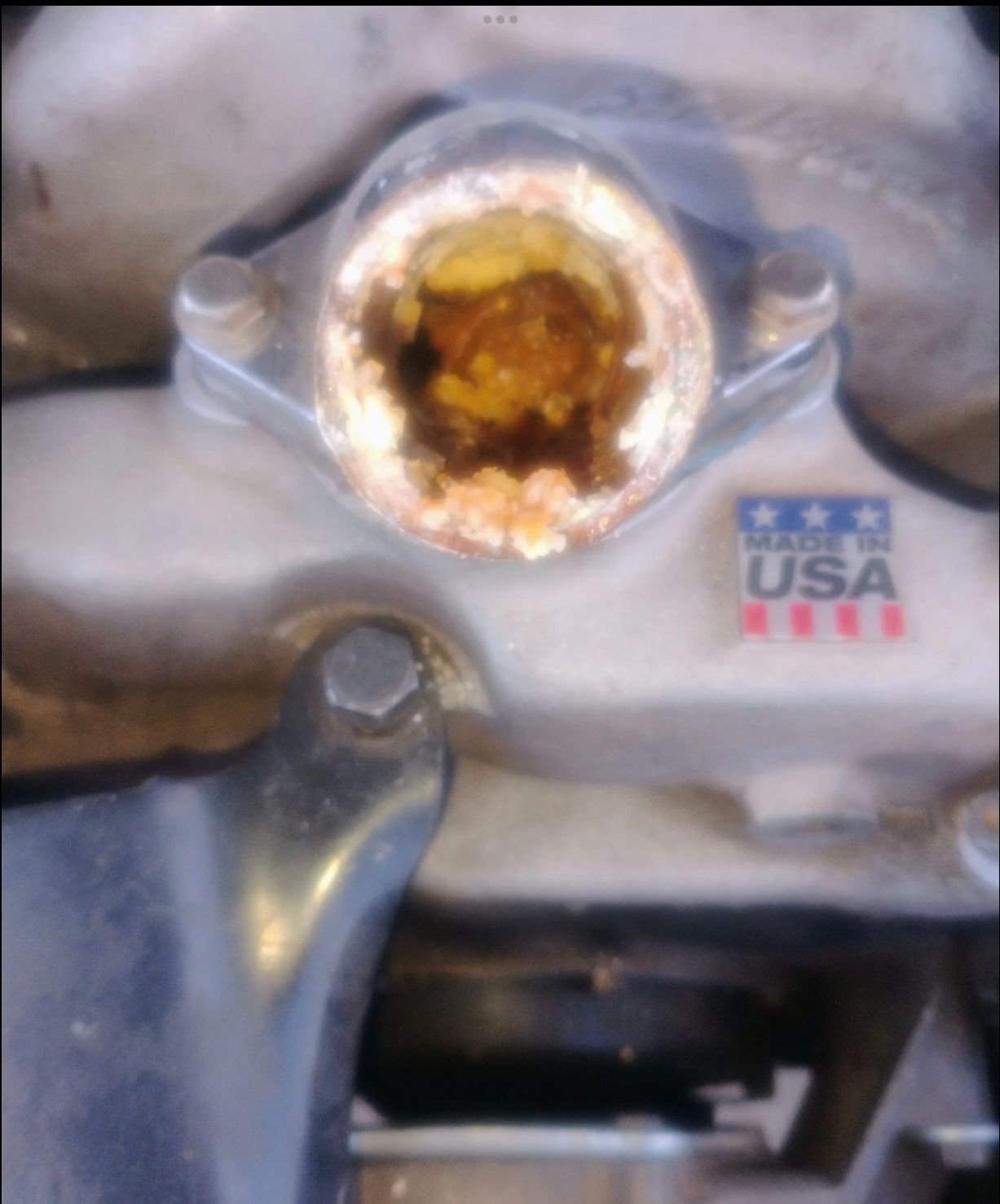

I recently swapped O4B intakes with a friend to help him out. The intake he had developed a leak. When I got it you could look at the areas where coolant touched and it was super, super coroded. It wasn't cracked, it was perforated due to something in the coolant. I didn't get a picture but it's still sitting on the table up in MI and I'll get my nephew to snap a pic next time he is at the shop and post it. Another nephew did a great job of welding it up. So, I suspect that coolant type does matter....
