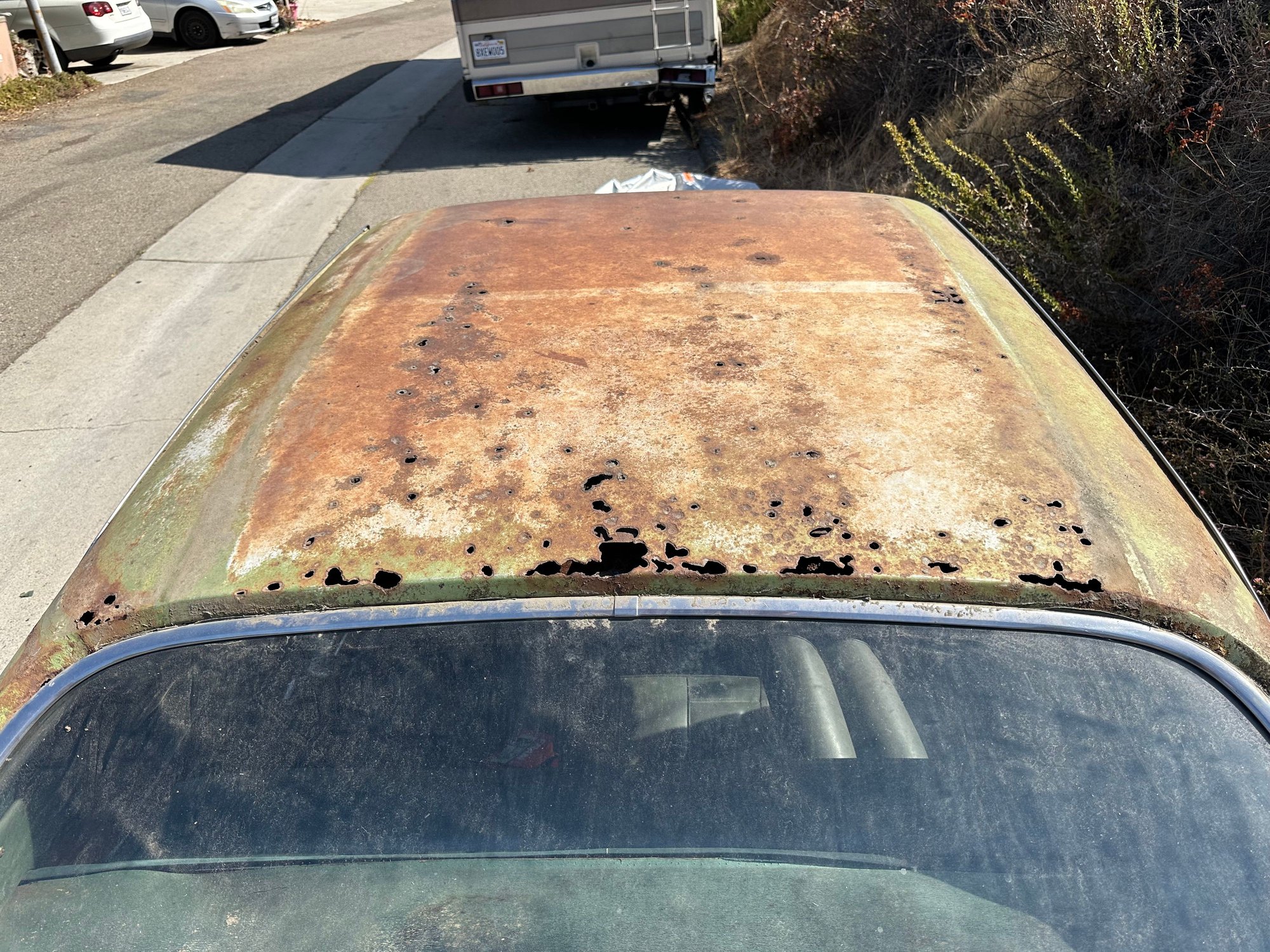

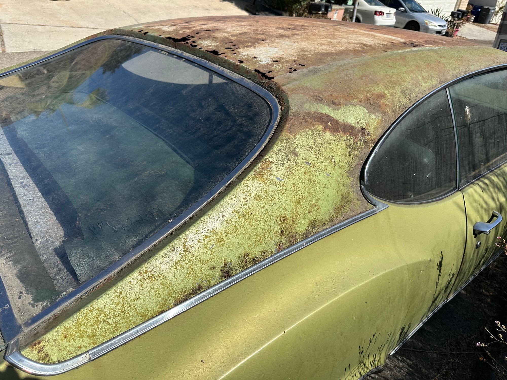

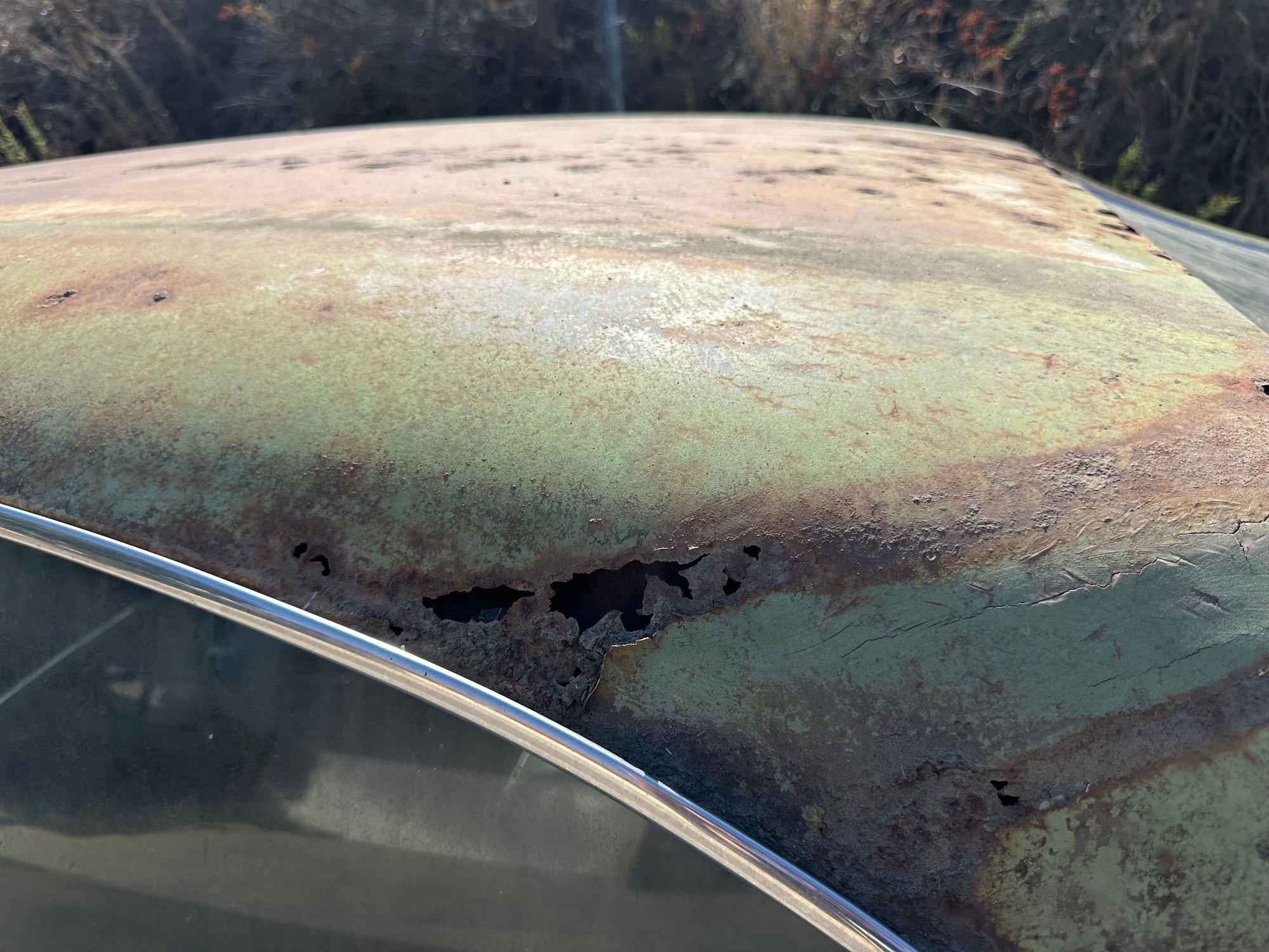

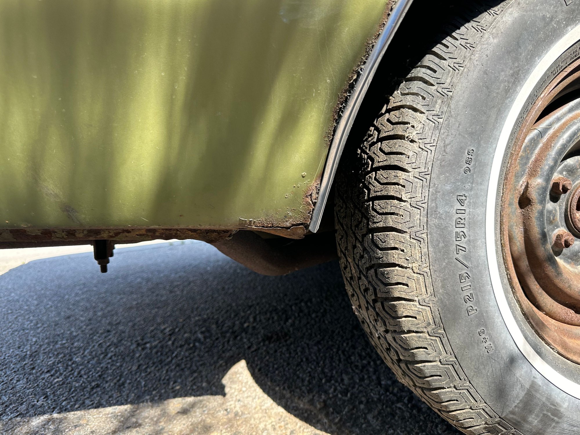

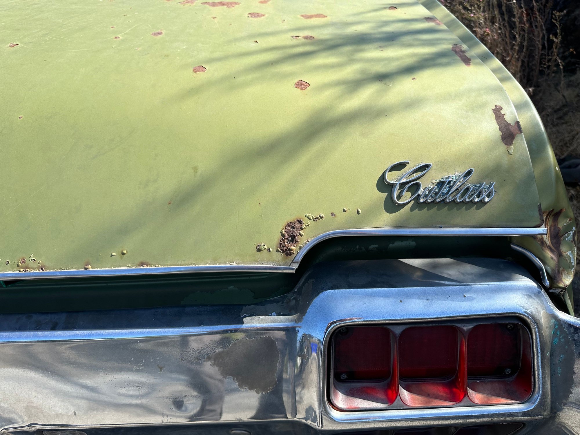

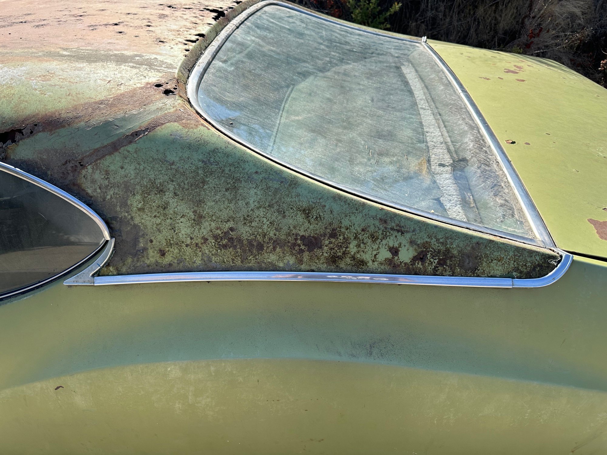

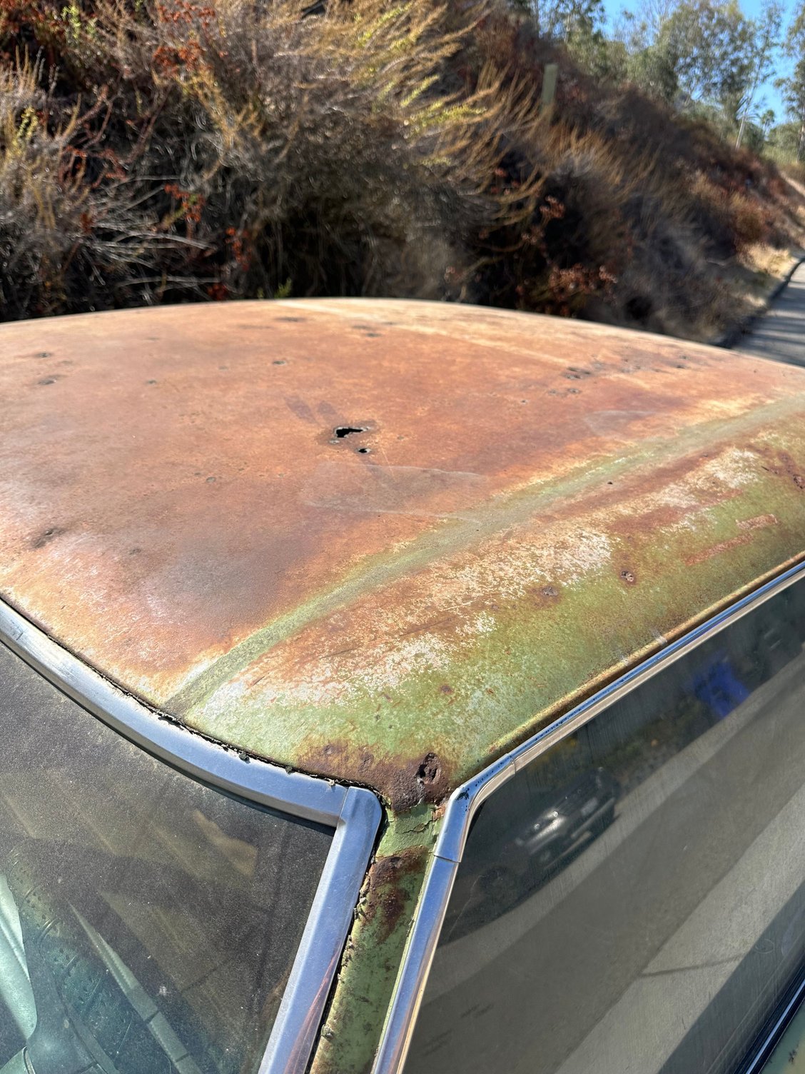

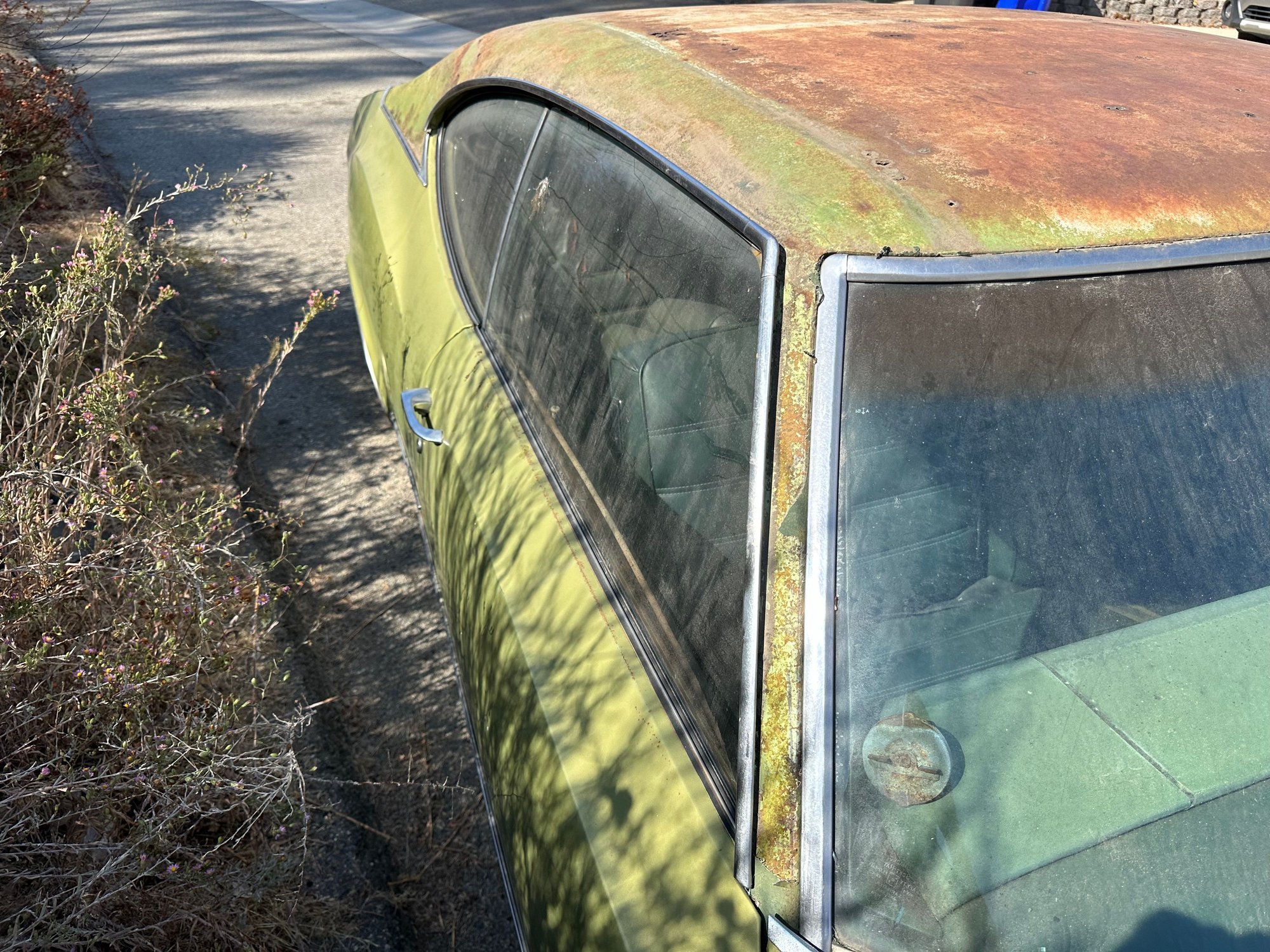

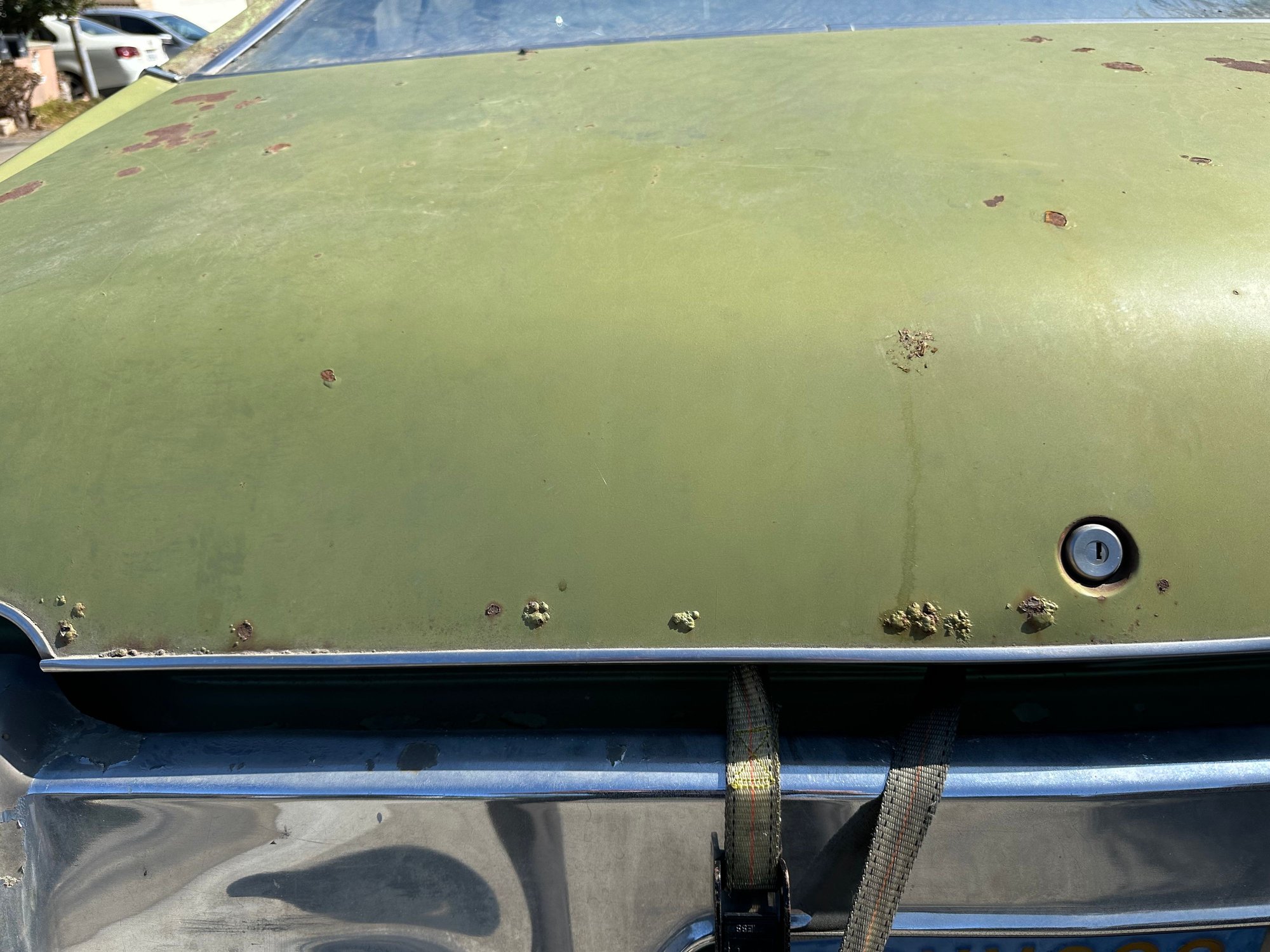

As per an earlier request, here are some “rust shots”. This is everything I can see when I open the hood, doors and trunk. The frame seems to be solid from an initial peek underneath when it got loaded up for its tow home.
Car is currently covered with a good cover whilst I await the takeover of the garage (which my wife finally relented to!!)
This Swiss cheese is toast

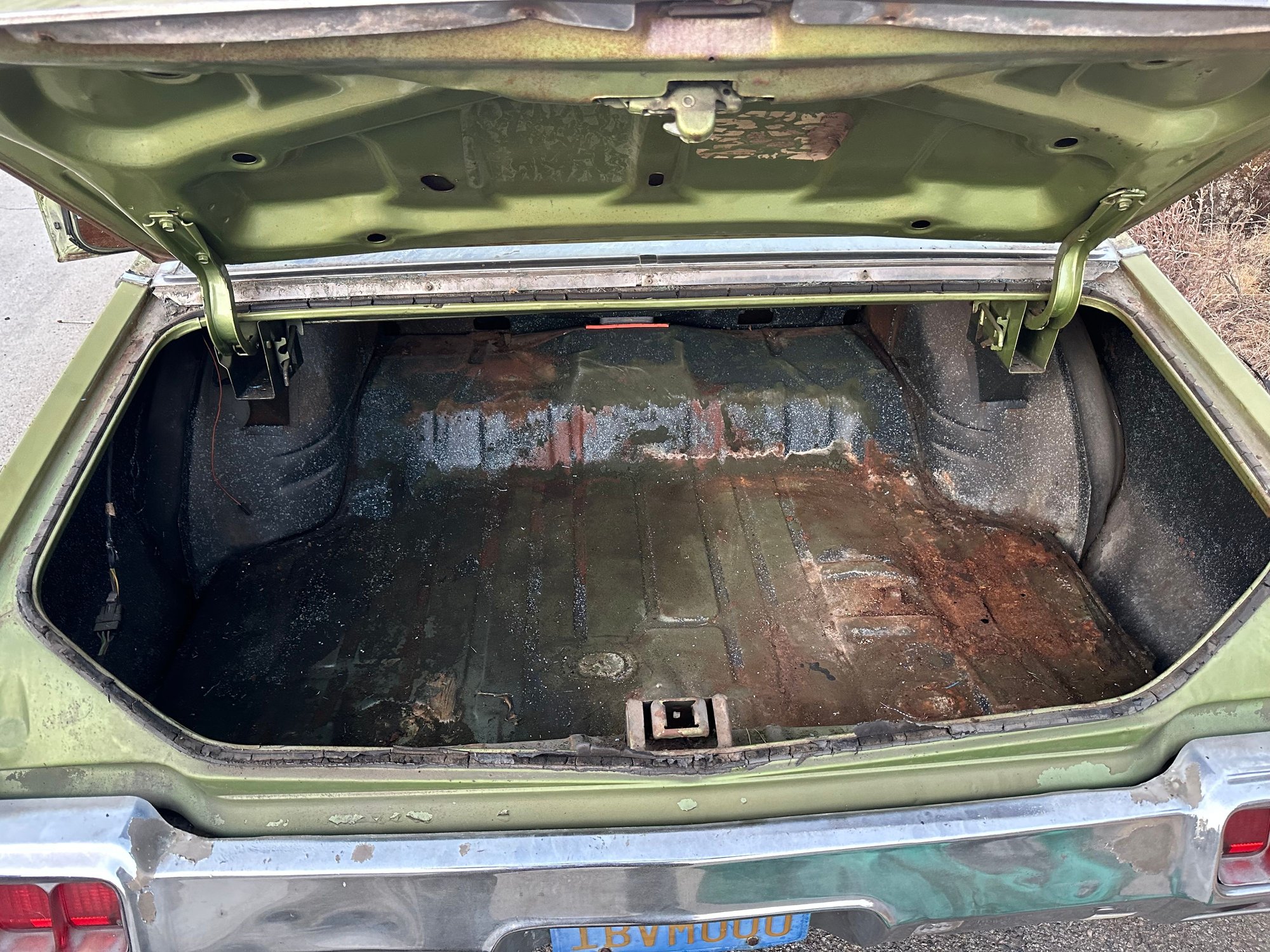

Tiny bubbles (and not the good kind) like this along the bottom of the trunk deck lid
Driver front
Passenger rear
Old Sep 2, 2024 | 11:57 AM

Take an ice pick and probe around in those quarter panel areas and pull the carpet out in front and rear floor boards also check trunk pan. Get under car and and probe up, undercoating hides a lot.
with the looks of the top I would wonder about the cars time in a garage.

If the car does not have a strong sentimental value, get another one in better shape. You'll be way ahead.
That's the visible rust. Imagine how much there is out of sight.

I’m in the “get another car” crowd. If that thing was a semi or fully valuable “W” car, maybe worth the deep dive. If you have $30k to throw in the pot, you can buy a really presentable, nice car that you can drive RIGHT NOW and enjoy. You are looking at some serious hurt, financially and emotionally marrying that poor car. I see MINIMUM $60k into it IF the engine & drivetrain are good and that is not any sort of higher end resto, just driver quality, with some interior and basic mechanicals, ie brakes, suspension, steering.
Do yourself a favor, get out of that car and look at classifieds on this sight & elsewhere.

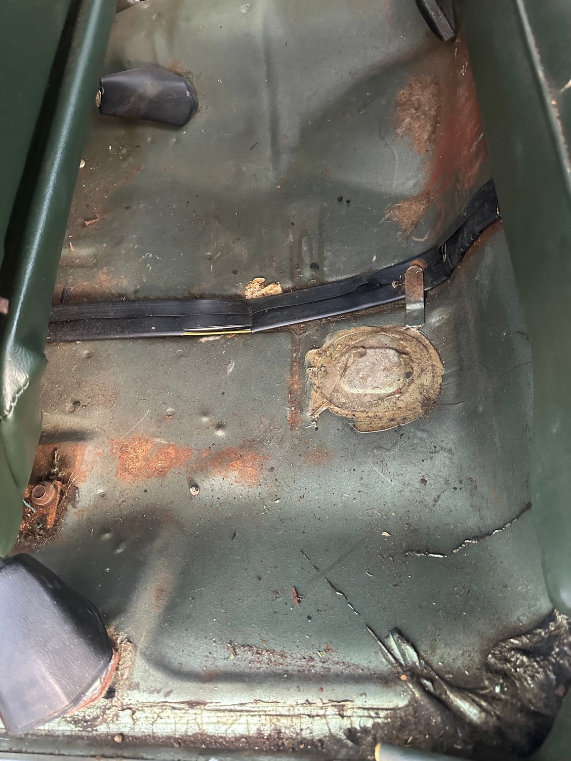

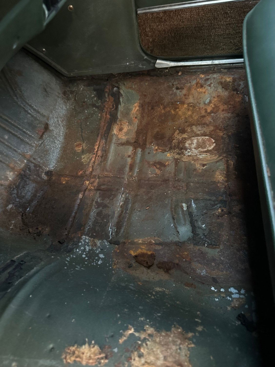

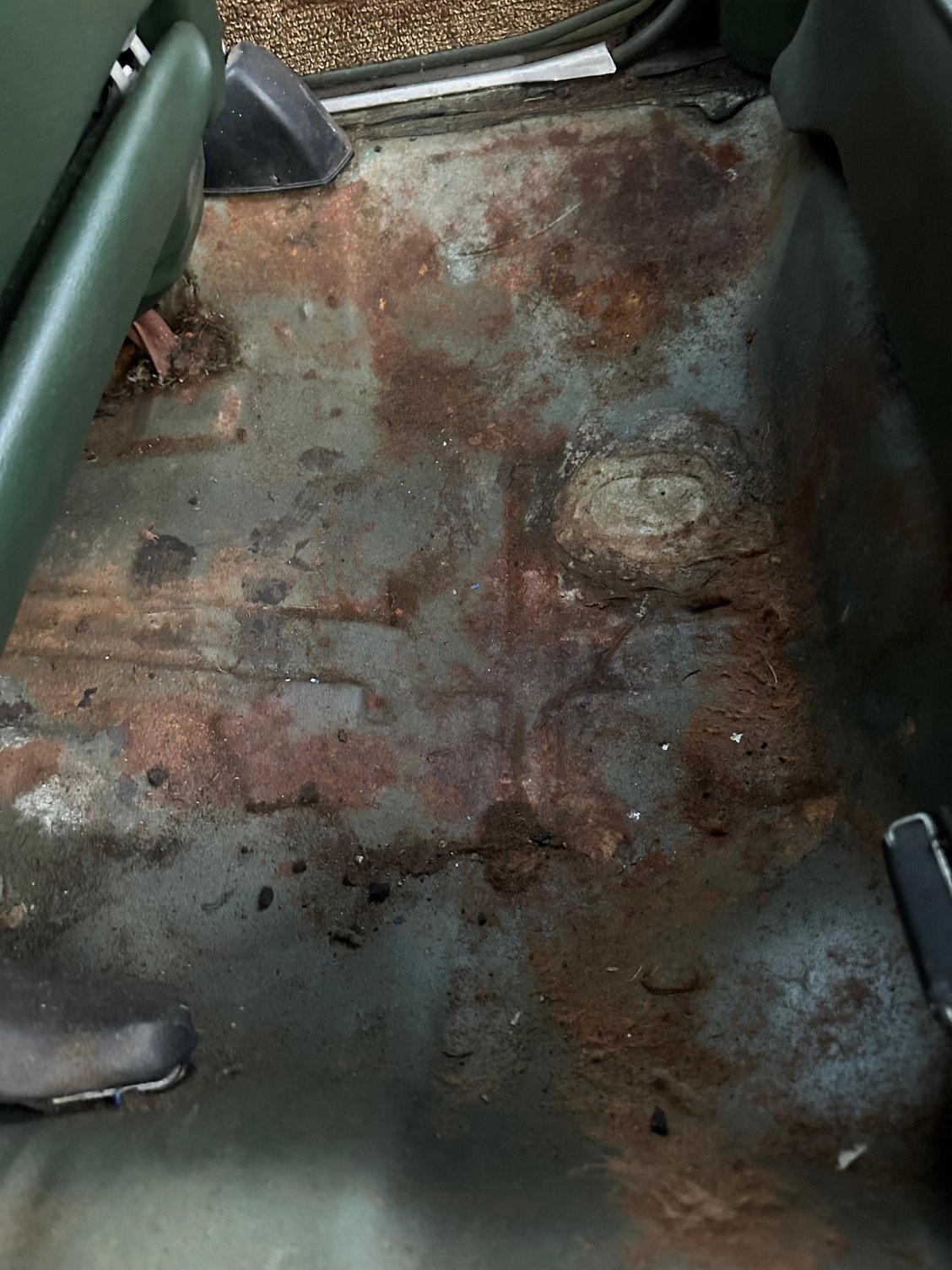

Taking @dennis_30281 advice, I pulled out the carpet and liners and went to town with an ice pick this afternoon.
The floorpan in the cab is solid. Surface rust is present in the front interior (spills over the years?) and a tad bit in the back, but nothing a wire brush and some grit won’t clear right up inside.
The trunk pan, however, has a bad spot on the passenger side and a patch would absolutely need to be welded in. This was the only unexpected thing my novice approach could find.
As predicted there is also cancer beneath the rear window (driver side.)
The outer visible rust on the rocker proved local by the ice pick test.
I spent about an hour poking and prodding, most of it from underneath because the undercoating preventing visually “zeroing in” anywhere. And also because I didn’t pull the seats out so I spent a lot of time aiming for those areas from underneath.
In my unprofessional and inexperienced mind a new roof assembly could be procured and welded on, along with a few small patch panels….not an overwhelming job? I still think it’s worth having a pro do a more thorough work up of what it would take.
Looks bad, but feels strong. I’m certain this would grind right off.
This spot in the trunk would need a patch

Inspect the inside of the rockers, that pinch weld under the doors, door seams, back half above the rear wheel wells under the dutchman panel, inner wheel house structure, firewall... dash and cowl structures, window channels, trunk drop offs etc.
Pull the chrome from under the wipers and the trim around the rear window. Rotted?
If all that is solid and you have the ability to MIG/TIG weld and work with metal and car bodies go for it. Skin metal is one thing. Inner structure rot is another.
If the condition is ROTTED run Forest run.
I'm from the rot belt. You southern/western guys don't know what that means. Unless its a super special super rare car and you have metal skills run. They do make solid derby cars or winter cars if too far gone.

Actually not a bad as I thought it would be, although you really need to get it on a lift for a good look-see. Regardless, you can do a lot better. Why start with the distinct handicap of knowing you'll need to do significant rust repair just to bring it up to the same level another car might already be at? Think of what else you can spend that money on!
