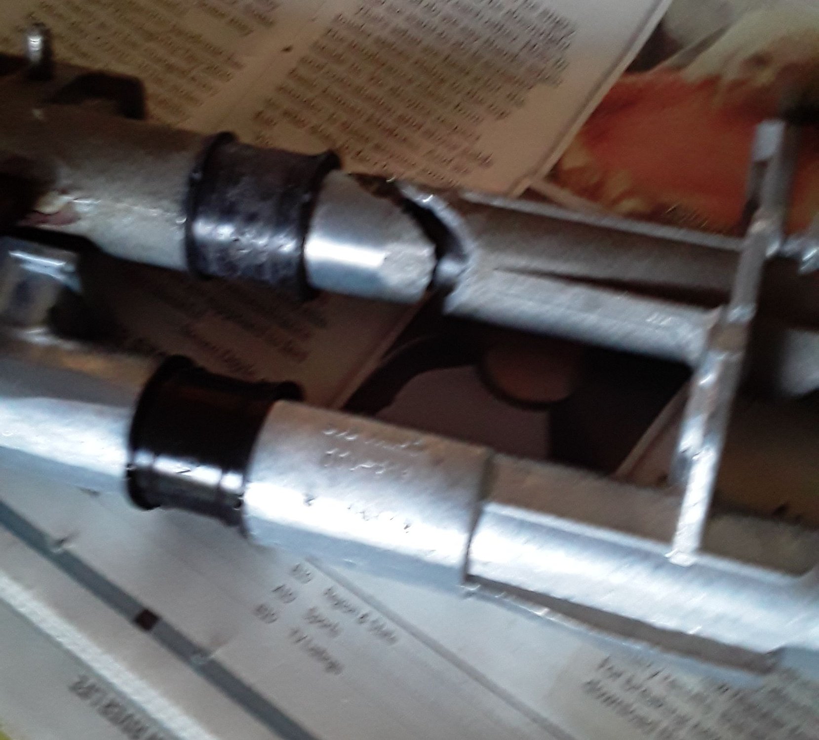

This is the shifter tube on my 93 F150. Apparently this failure is common enough the aftermarket supports it.
Broke Monday night and had to be towed home. You'd think after nearly 60 years Ford would realise shift tubes/collars and potmetal don't geehaw.
Every pic I've seen online the thing broke in almost exactly the same place.

Wrapped this job up today and wasn't as bad as you'd think. Snapping the shift cable back onto it was the worst b/c you're on your back trying to see up behind the dash. Pretty open back there but tough to see even with the column dropped and the shrouds off.
The Dorman aftermarket tube is reinforced where the breaks occur. It's a good 1/8" thicker in that area than the OE part.
Best part is it works again!
I'm curious. Do you know whether a Ford (Motorcraft) genuine replacement has been upgraded and reinforced, as well? Ford is generally pretty good about redesigned upgrades for parts w/ known issues.

I didn't check the Ford part as my buddy at Advance had the Dorman part on the shelf and figured would have had to order it at the dealer.
Traffic from a few years back on a couple of F150 forums mentioned Ford had redesigned the shift tube due to so many failures.
I reused the inner shaft as it is steel. Dorman part was aluminum.

Top broken part is OE Ford. Bottom is Dorman. Notice reinforcement in area of break. Every pic I found online the Ford part was broken the same way and same area.
