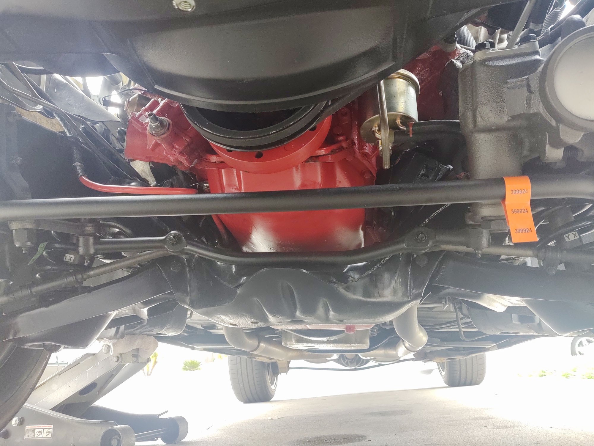

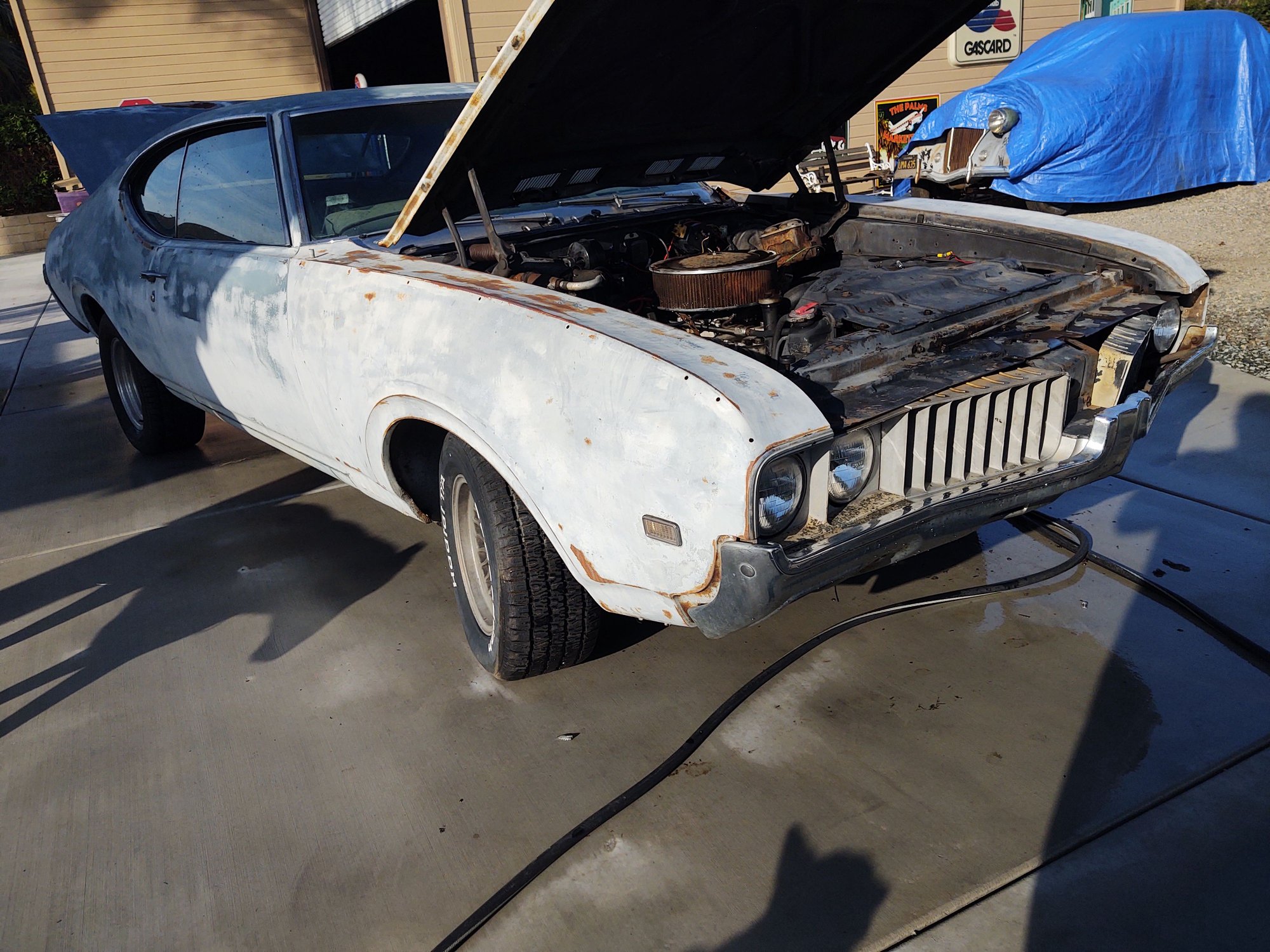

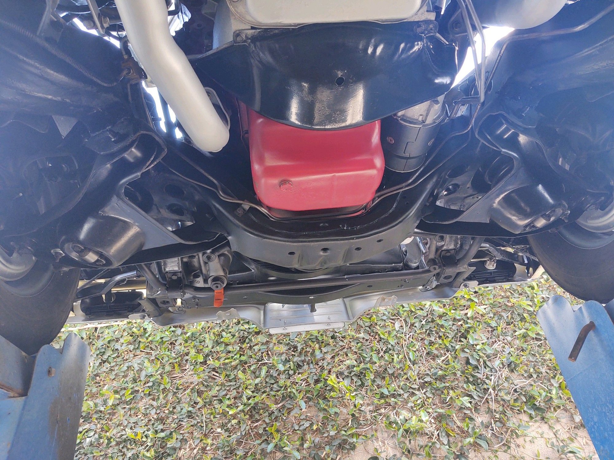

Car has had the gas tank replaced
all seats and interior have been removed tooBefore and after pictures

You're one fan blade nick on that rubber fuel hose on the pressure side away from a car fire.
Old Mar 20, 2023 | 03:51 AM
Posts: 26,095
John - You mention a valid point; however, it appears the fuel line has been re-routed (or shortened) based upon the 1st image in Post #12 (note location of fuel filter). I believe the 1st image is the 'after' image; the 3rd image is the 'before' image.
Thanks most of the car isn't really squared away
I'll take a look at that and fix
Many small things to do all the way around this thing
Most items are finger tightDoes anyone have pics of correct core support bushings all that's on here is a bolt n washer loose so front end isn't lined up at all

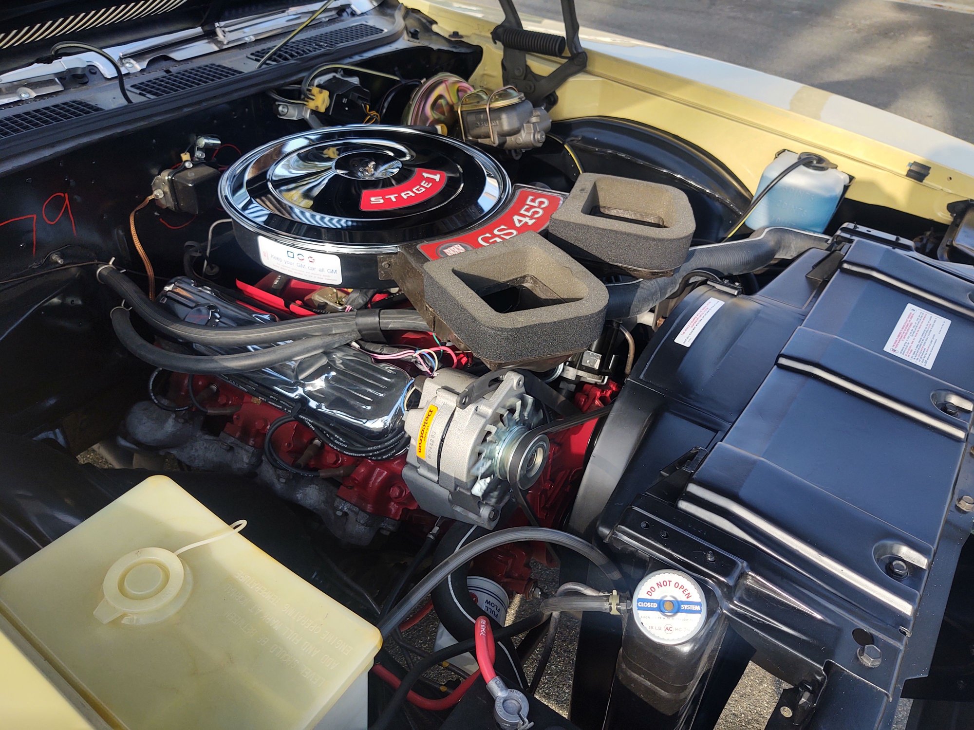

Here's an observation: The water supply to the heater core requires a restrictor fitting to avoid high pressure that will blow out the core. Check to be sure the hose adapter from the half-inch galvanized street el has that restriction. If not, keep the engine revs low until you fix that.
If you don't know what the restrictor fitting looks like, see item HHF640 at the top of page 54 in the Fusick catalog, https://www.fusickautomotiveproducts...alog%2056C.pdf.

Awesome thank you
This fitting goes straight to the intake manifold right
Yes, this is the way the factory did it.
However, the fitting is half-inch. Your aftermarket intake manifold has a 3/4-inch opening, so a bushing is needed between the fitting and manifold.
If you put it in the manifold without an elbow, you will need to use the factory-style molded hose to avoid kinking.
The factory-style hose from Fusick is on page 53 in the catalog. You will have to call them to find out which to use because they list two hoses for your car, 400548 and 400888.

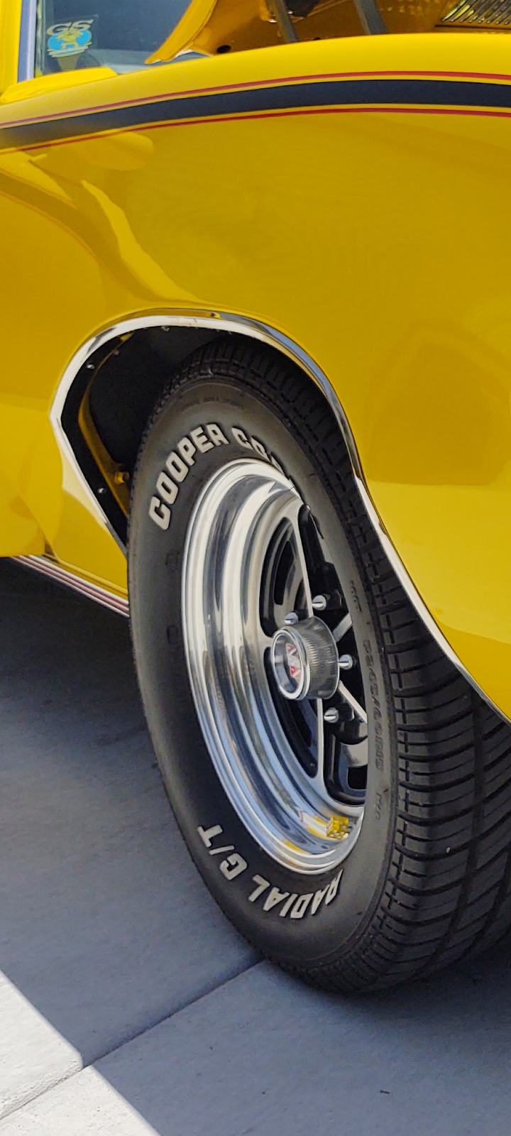

What wheels are on that GSX? They look close to the Buick rally's but just different enough to be noticeable. I'm a sucker for '70 GS cars but your uncle made a good decision on his '69!
Old Mar 20, 2023 | 11:39 AM
Ohc joe's Avatar
69 Cutlass and I'm lost
Joined: Feb 2022
Posts: 62
From: So cal
Thanks man there custom billet wheels from a place in northern California can't think of the name of the top of my head but yeah there awesome looking the bamboo cream GS is for sale

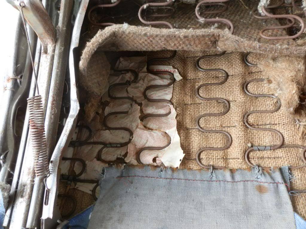

What I found was 1968-72. I did find a build sheet in a 1964 that was under the springs of the passenger side seat.
Well, that didn't work! Here's a link to the thread showing the photo from the underside of the seat. 1964 Olds 442 data plate - ClassicOldsmobile.com
Old Mar 20, 2023 | 07:43 PM
Posts: 26,095
Here you go, John.

More info on the Stage 1.
Stick?
Asking $$?
Old Mar 21, 2023 | 05:50 AM
  #32
Ohc joe's Avatar
Joined: Feb 2022
Posts: 62
From: So cal
Stick?
Asking $$?
not a stage I added emblems complete matching number car two owner bunch of docs special ordered car power windows power seats disc posi tilt AM FM everything redone 68k
