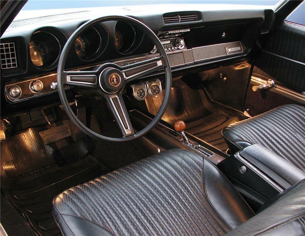

Just out of curiosity would this from Barret Jackson be a clone then since it had AC. I would have thought they would do the research
https://www.barrett-jackson.com/Even...AY-COUPE-79202

BJ do research?? Ha Ha Ha. That's a good one.
So to the W-31 people out there. Is there really any way to verify a W-31? They were all built in Lansing right? Where they all within certain months etc?

From the 1969 W-machine brochure
I know this will be a shock to some people, but that car at BJ is not an original W31. The fact that the block VIN derivative matches does not mean that it is a W31 motor, since the only way to tell would be to tear it down and check the cam and valves, and even then, those can be added to any Olds 350 motor. Sorry, yet another BS BJ car.
(And before someone points it out, yeah, I realize the 1969 W32 wasn't rated at 360 HP)
Also, note that the 1969 "W31" at BJ has a 1970-72 console with a Pontiac dual gate mechanism. It probably wasn't even a floor shift car before it became a "W31".
