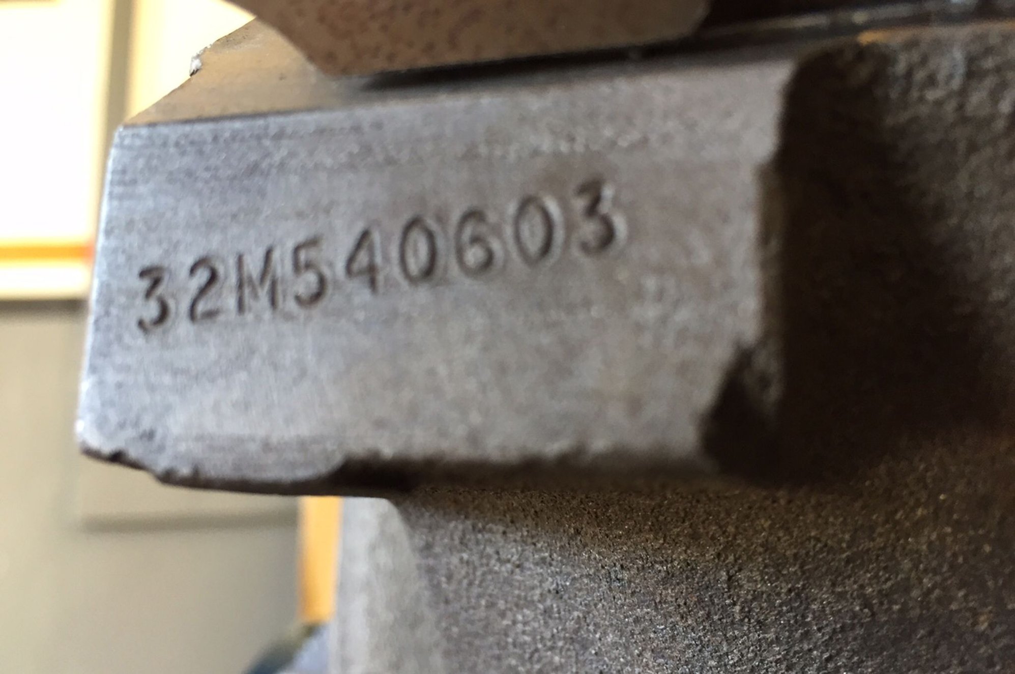

VIN Derivative Question
Here is the engine stamp pad in question.

Posts: 50,815
The factory VIN derivative stamp would have been nine characters, and the first would have been a "3" for Oldsmobile division. I have to say that while I have seen VIN derivative stamps with misaligned characters, that is unusual. The factory used a gang stamp like this to control spacing and alignment.
Also, while it's difficult to tell for sure from your photo, it appears that the VIN derivative stamp location may have been milled once, as evidenced by the line below the stamp area. Olds typically just faces off that entire boss on the block, like these. And yes, I specifically added that last one as an example of cases where I have seen misaligned numbers from the factory.

Old Aug 31, 2025 | 05:28 PM
dsp52's Avatar
Joined: Feb 2022
Posts: 93
OK, I think we can put this one to bed. It's a replacement 455 for the original 400 engine, we don't know who replaced it or when, and the VIN derivative was not stamped by the factory. Thanks for everyone's comments and contributions.

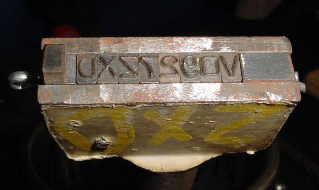

Posts: 12,847
Somewhat related side note. What is the prevailing wisdom on vin derivative stamps that are not ganged? Preferably, we want to see a ganged stamp of that same font, all even, no milling cuts on the pad. How acceptable is non-ganged vin stamps if the pad looks ok and it is correct engine?

Old Aug 31, 2025 | 06:32 PM
Posts: 15,432

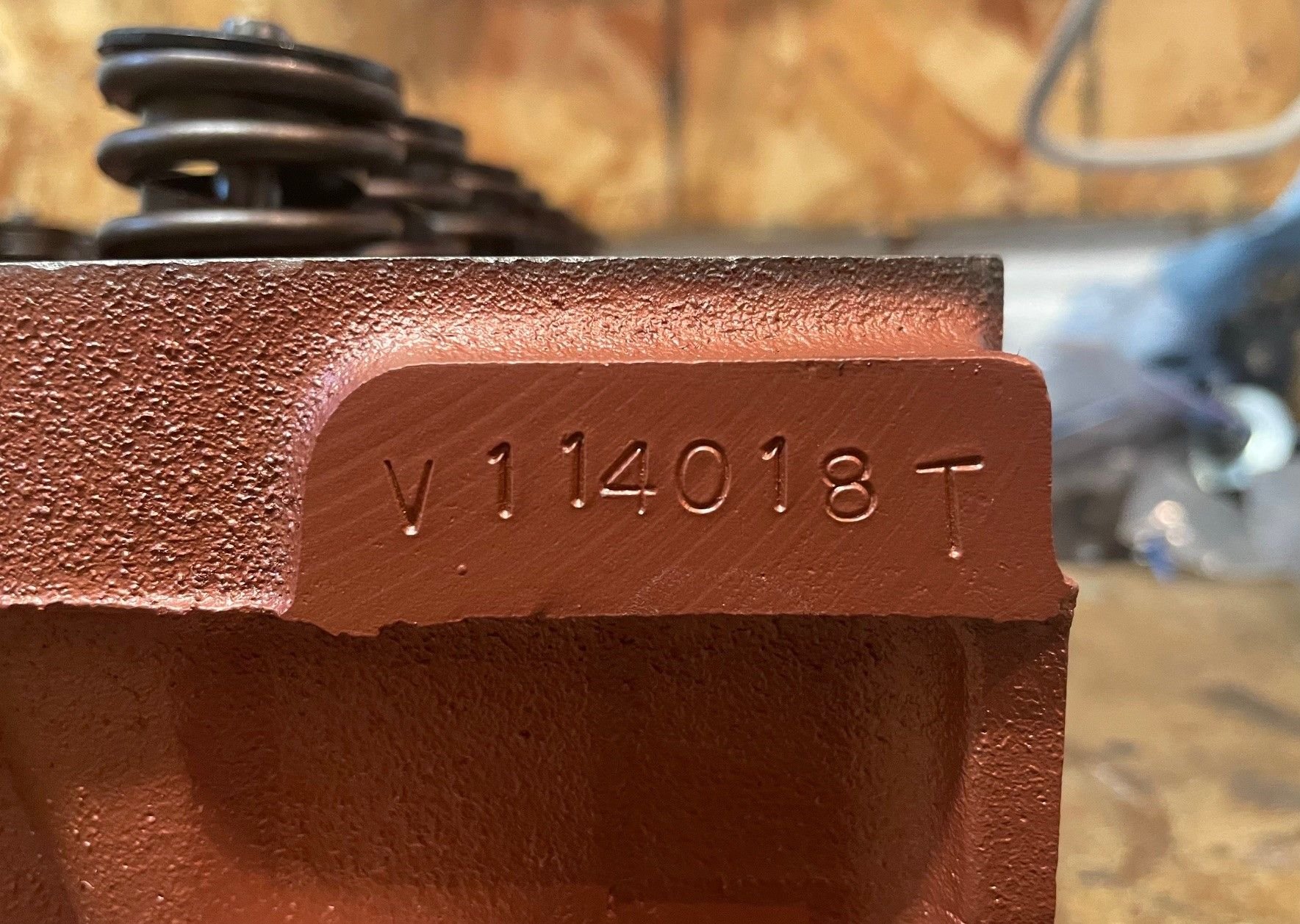

I'll clarify: "That would be funny if it weren't for the fact that it's true".
Joe, need your wisdom on a different year stamp. The 66 head stamp showing a V the numerals and then a T or no T for a 442 car never look gang stamped, very random..the V and T look bigger. Any wisdom on this? Obviously this was pre- vin derivative stamps on the block.
‘thank you
Old Dec 24, 2025 | 05:59 PM
Posts: 12,847
I can field that one. Heads were made and set aside for the engine lines. So, it was a turbo 442 right side head, but not yet assigned to an engine. Once bolted on, the rest got stamped.
‘thank you
I'll add that the factory engine unit number stamps I've seen on 67-earlier heads are often misaligned and usually the prefix and suffix letters are larger than the digits.
