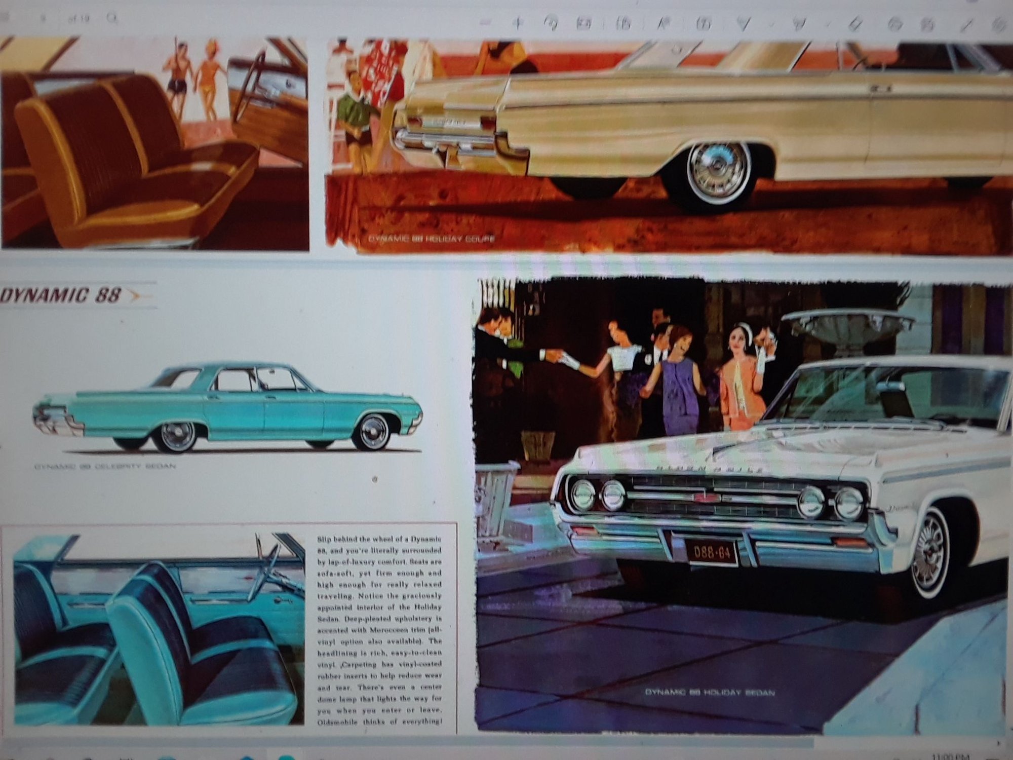

Thank you guys for your input.
I bought the car as a started project and the previous owner stripped the seats.
As I said I am from Australia and while we have very good upholsterers they would like a pattern to work from.
Would anyone know of or have a pattern I could purchase?
Again thanks for the input.

This is a screenshot of a 1964 Oldsmobile brochure.
It shows the pattern used in the upholstery.
If you can get a copy of the brochure, you can see it much better.
You can get one here;
Original 1964 Oldsmobile Full Line Foldout Sales Brochure 64 Ninety Eight 88 | eBay
